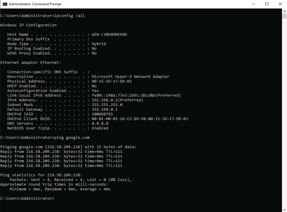

At this point, the network will be correctly set for this validation. Create a new Windows Server 2019 Standard VM (We have used the evaluation ISO downloadable from the official Microsoft website). Once installed, configure your virtual machine with an IP of the range configured on the virtual switch (for example: 192.168.0.2/24):
VM Configuration
