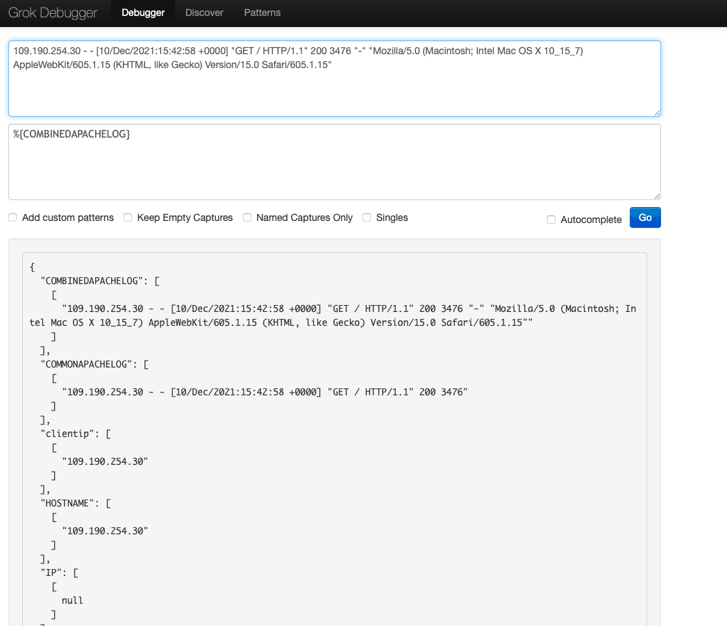

Grok patterns and debugger
As an example of the main pattern matching that are currently used, or to test some more specific ones, you can use some tools like Grok Debugger :
Grok Debugger

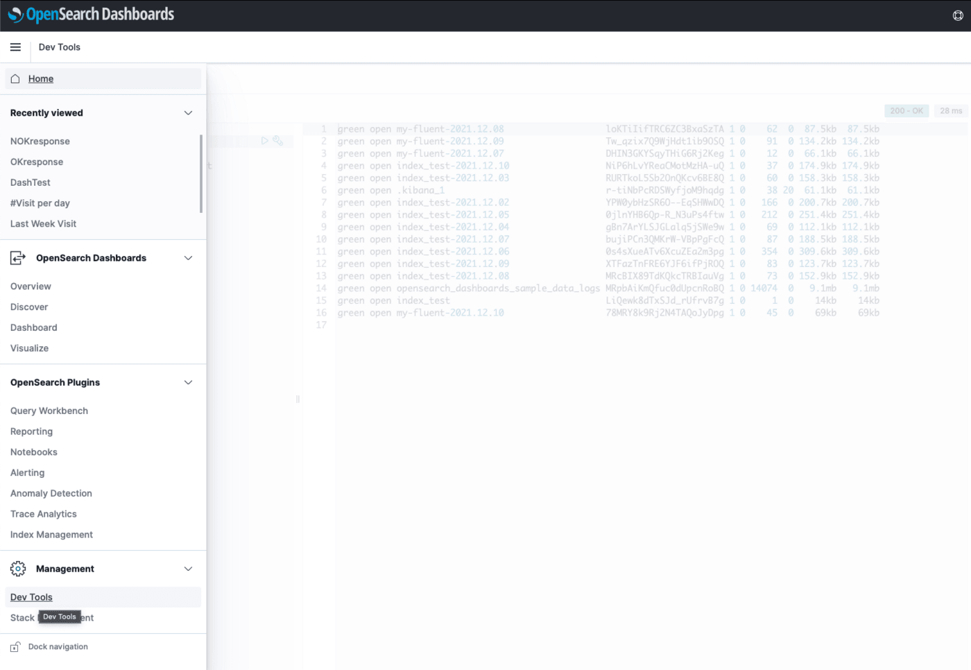

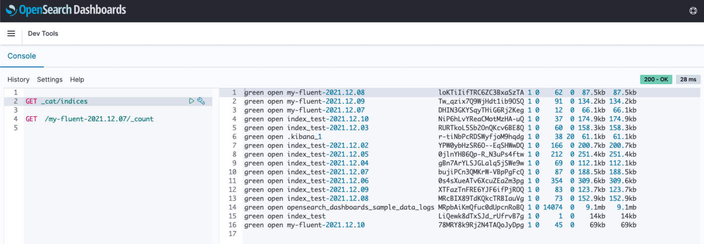

Use the Dev Tools to query the indices:
Dev Tools in OpenSearch Dashboard
Then, in the console, execute a GET /_cat/indices command to get the index list with the number of documents for each:
GET the index list and number of docs

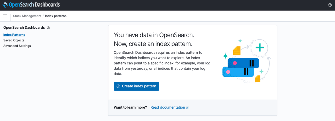

To create the first index pattern:
First index pattern

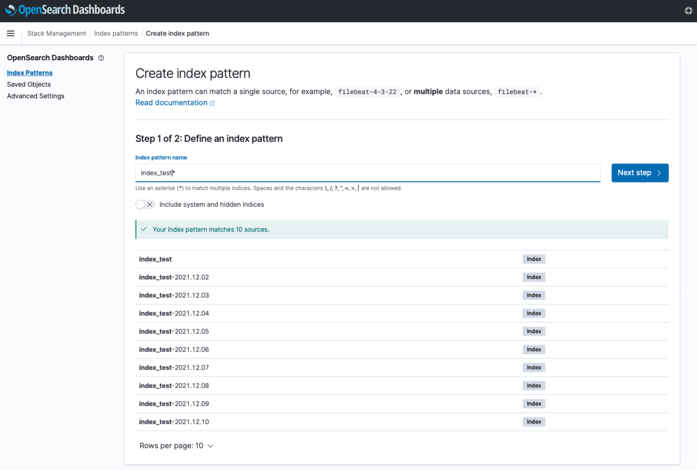

As we want to consolidate all our daily indices, let define the pattern as index_test:
Index_test pattern

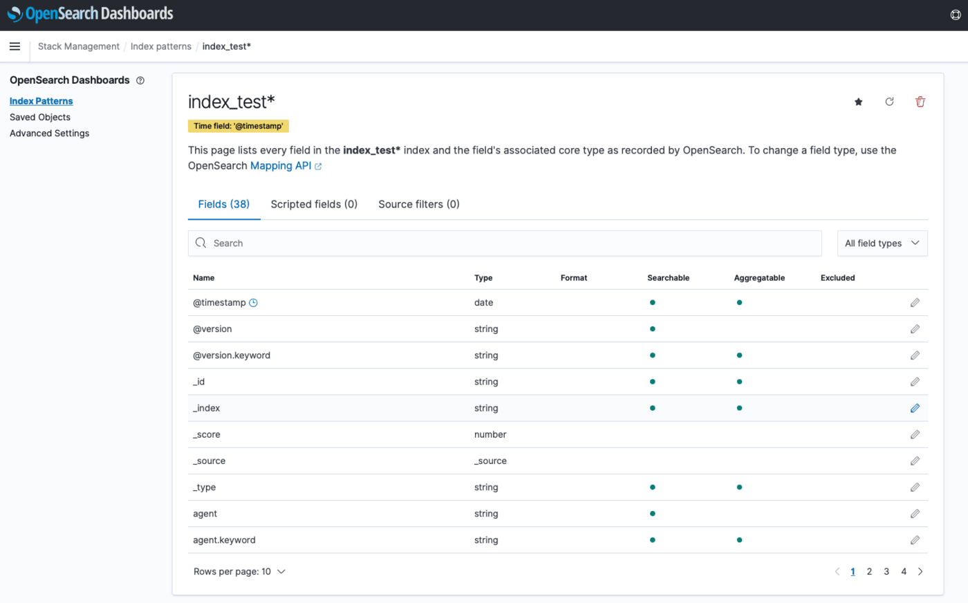

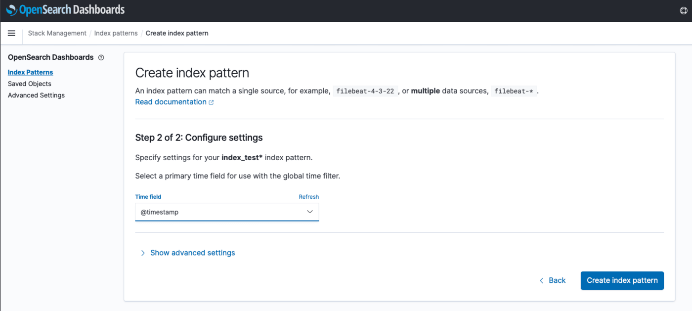

Then define the timestamp:
index_test timestamp
OpenSearch will then define all fields available and their type directly from stored documents in the index:
index_test ready

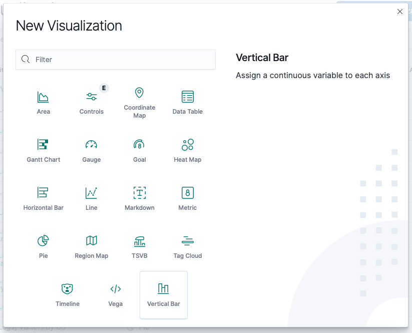

Select the visualization type:
index_test ready

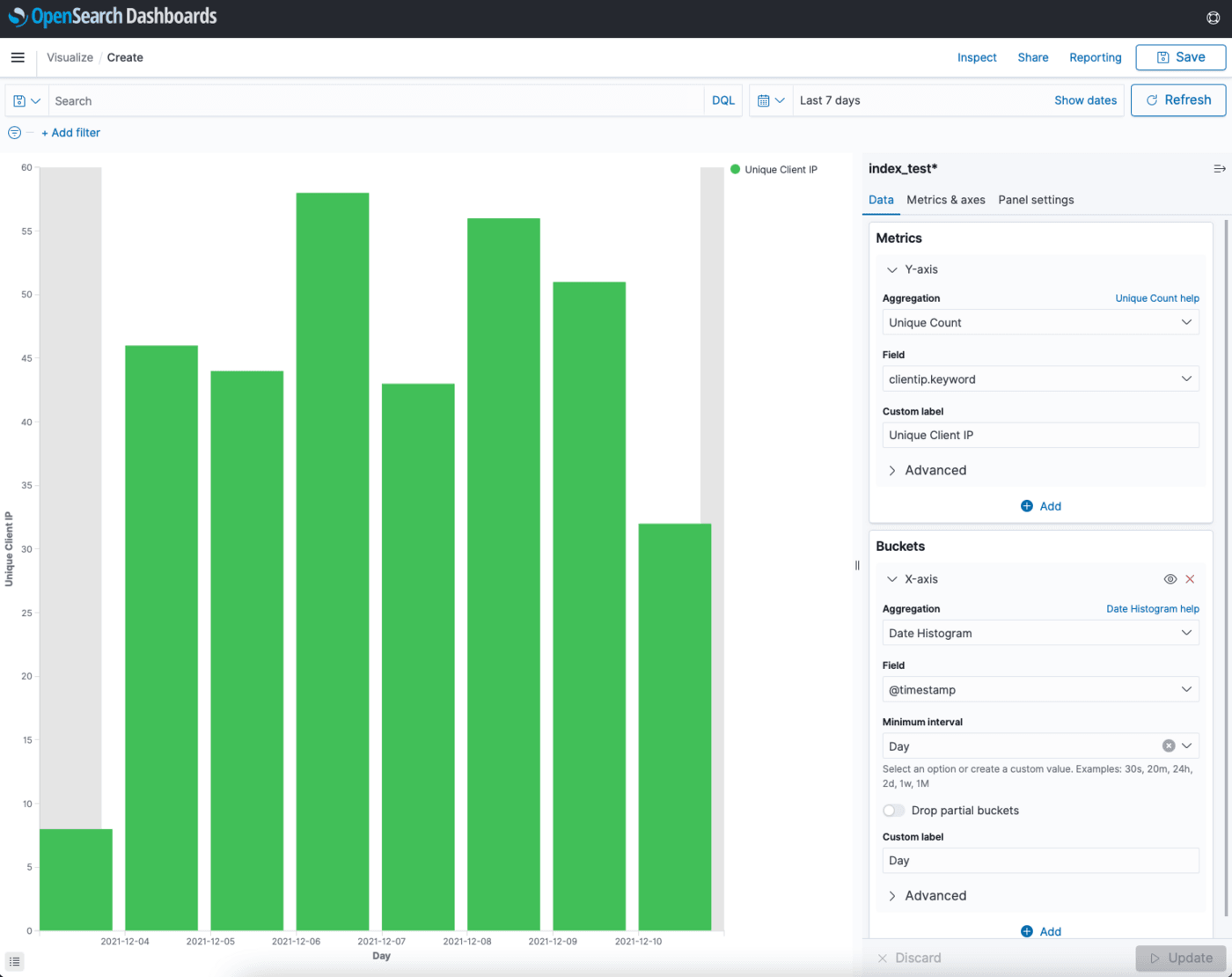

You now have to define all criteria that you need to visualize:
  • the period (last 7 days in our example);
  • for the metrics, the Y-axis data (aggregation/field);
  • and same for Buckets with time interval in case of date aggregation.
Click on update if there are any changes in the data definition, or refresh if you change the data time scale.
index_test ready

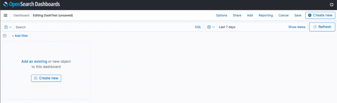

Let's make a dashboard with the visualization you've just saved.
Create a new dashboard :
As we have already created a visualization, Add an existing object:

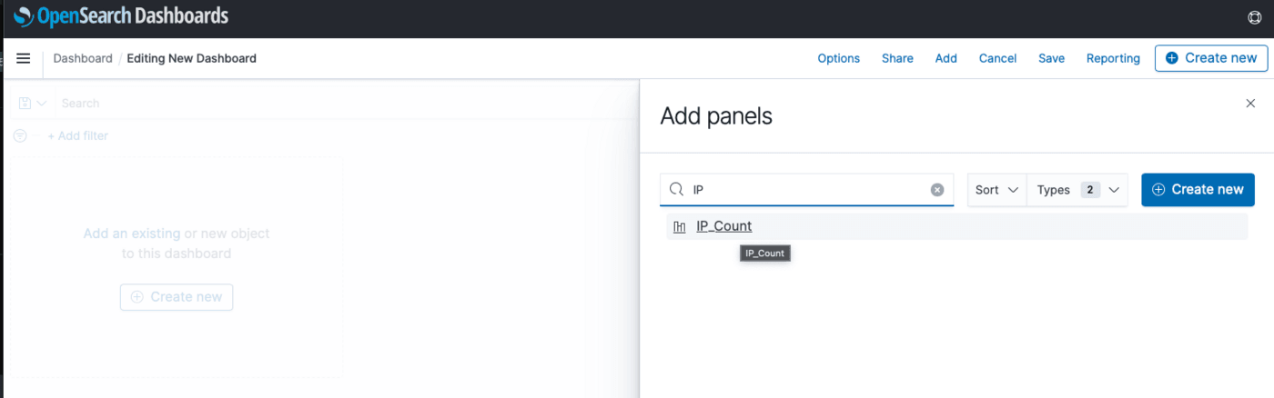

Search and select the one we just created:
Reuse the created visualization
Reorganize your panels, add new or existing ones as wanted:

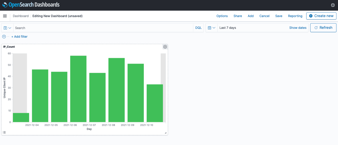

Dashboard saved
We now have a real time dashboard showing us the unique IP address per day, found in Apache logs.

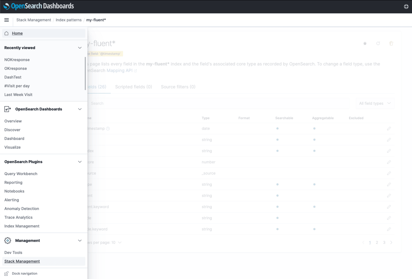

Step 4: Visualize Fluent Bit data in OpenSearch Dashboard
As we did for Logstash, you can create an index pattern to aggregate all the daily data logs stored in OpenSearch then visualize those data or create dashboards. In this example, the indices will be my-fluent-YYYY.MM.DD , so you can define a pattern like : *my-fluent-**.
