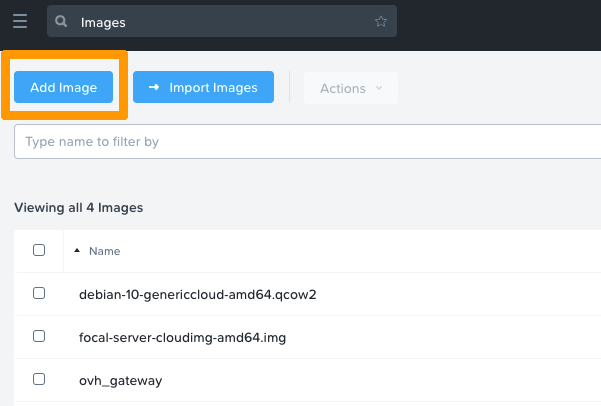

Connect to Prism Central and go to Compute & Storage, then Images.
Click on the Add Image button.
clic add image

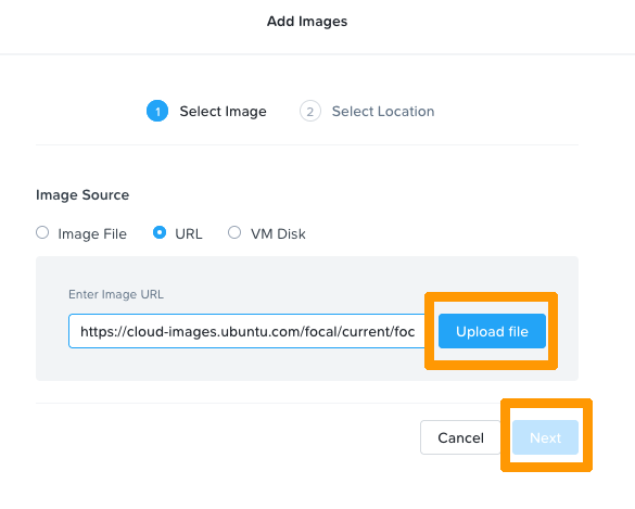

Paste the URL of a compatible cloud image, for example:
https://cloud-images.ubuntu.com/focal/current/focal-server-cloudimg-amd64.img
Click on Upload file then Next.
clic add image

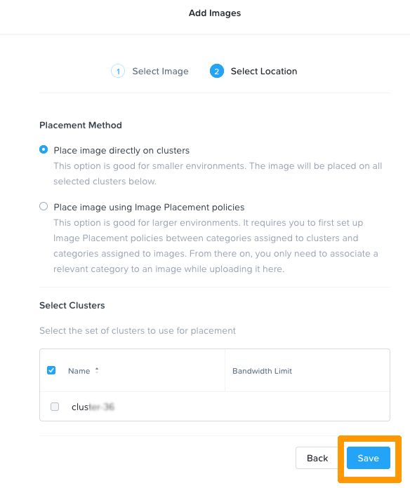

Select Place image directly on clusters, then select your cluster and Save.
clic add image
