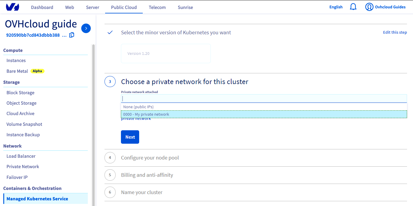

Integrating a cluster into a vRack private network must be done when creating the cluster, in the Network settings section of the Create a Kubernetes cluster page, where you can choose an existing private network and subnet for the cluster.
Your new cluster will be created inside the vRack private network you have chosen.
Once the cluster is created, click its name in the Managed Kubernetes Service list and open its Network tab: it shows the chosen private network.
