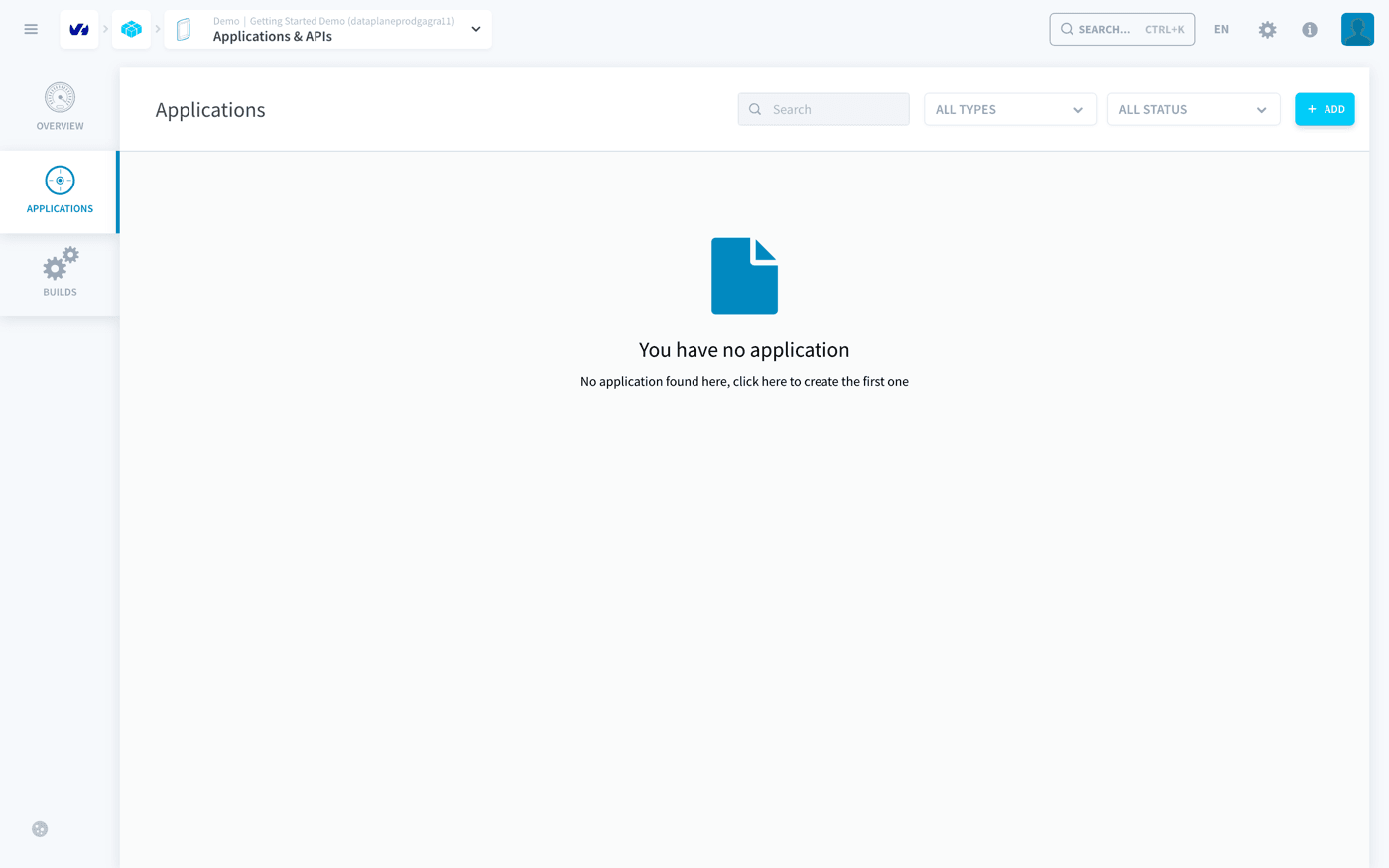

From your Project, open Applications & APIs. The list shows every application and API deployed in the Project, with its type, its URL and its status.
Click + ADD.
The empty Applications list of the Project, with the Add button at the top right

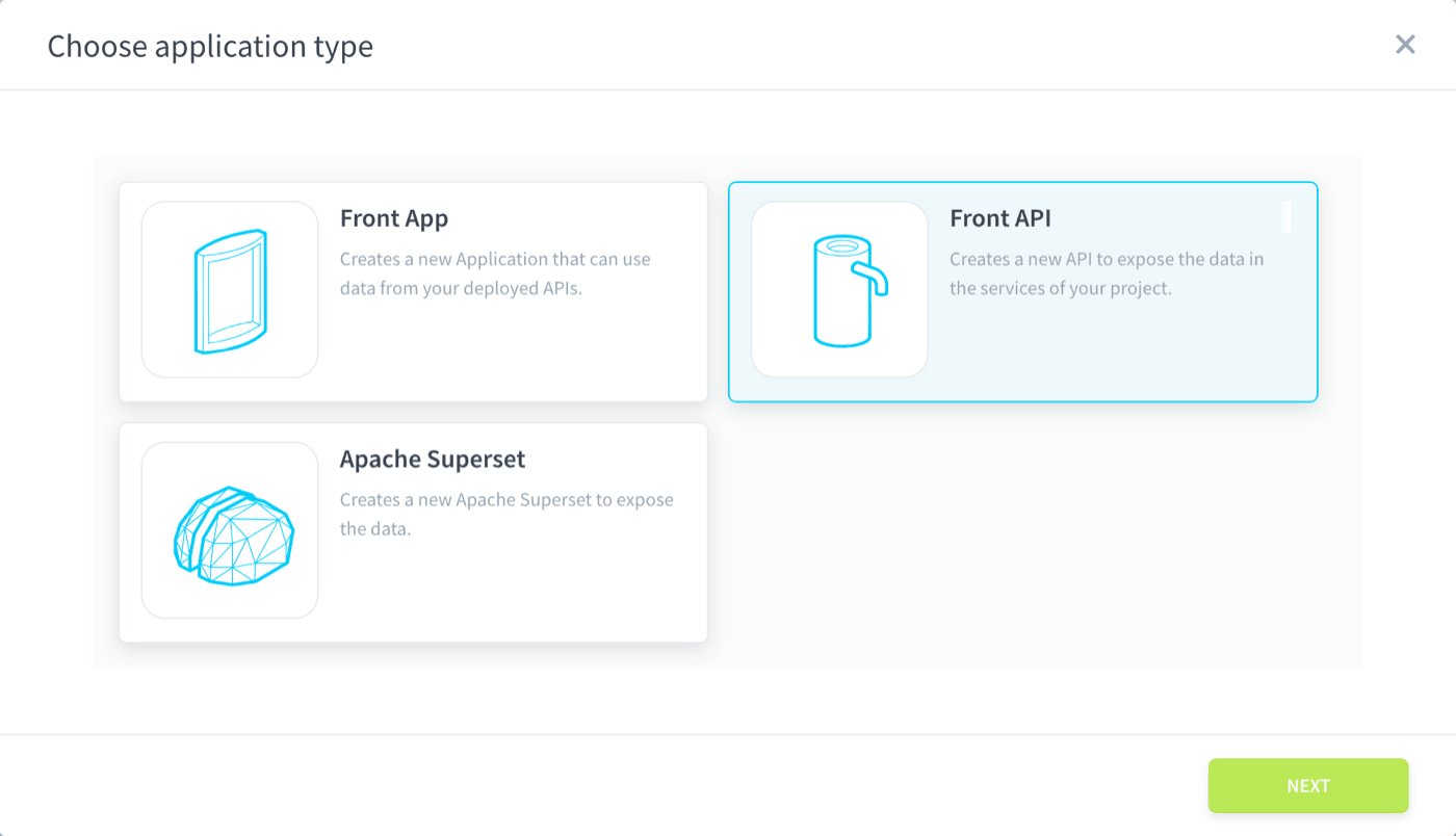

The Choose application type dialog offers three kinds of application:
  • Front App: a front-end application that uses the data your APIs expose.
  • Front API: an API that exposes the data of the services of your Project.
  • Apache Superset: a ready-made Apache Superset instance.
Select Front API, then click NEXT.
The Choose application type dialog with Front API selected

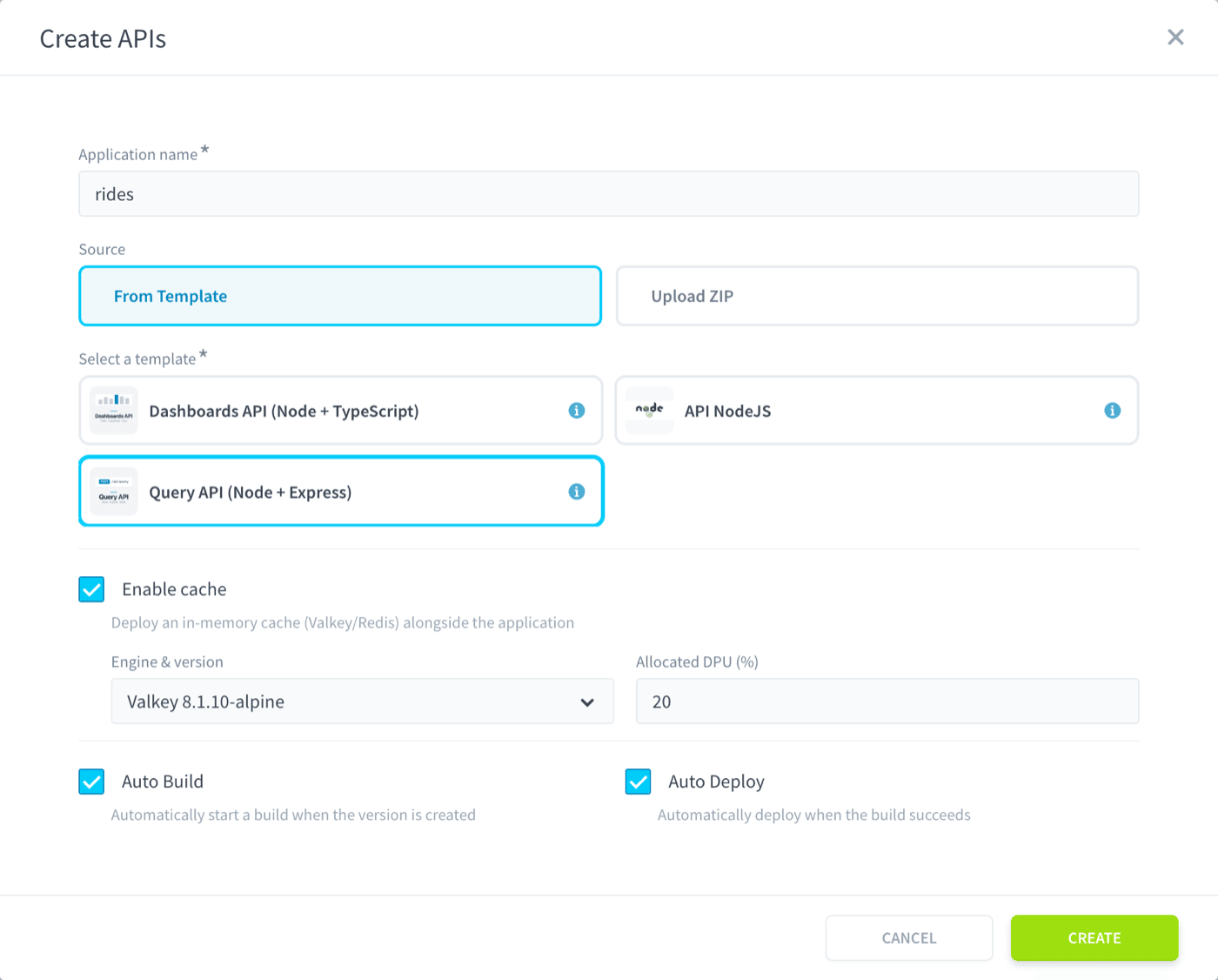

In Application name, enter rides. Data Platform derives the technical name and the URL from it, so your API is served at /rides-api/.
Leave Source on From Template. There is no version name to choose: the first version of an application is always v1. A version is a deployable snapshot of your API: you can add a v2 later without ever taking v1 down.
Under Select a template, choose Query API (Node + Express). This template lets your applications run queries on your data over HTTP, including the queries saved in your Analytics Manager.
Then tick the 3 options:
  • Enable cache: deploy an in-memory cache (Valkey) alongside the API, so that repeated calls do not query your data warehouse again. The default values of Engine & version and Allocated DPU (%), Valkey 8.1.10-alpine and 20%, are enough for this guide.
  • Auto Build: start a build as soon as the version is created.
  • Auto Deploy: deploy the version as soon as the build succeeds.
With the last two options, a single click downloads, builds and deploys your API. Click CREATE.
The Create APIs form with rides, the Query API template and three options ticked

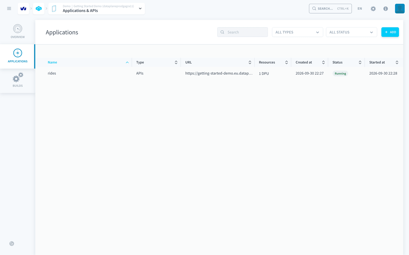

When the build succeeds, Auto Deploy takes over. Back in Applications & APIs, your API is listed as Running.
The Applications list showing the rides API with the Running status

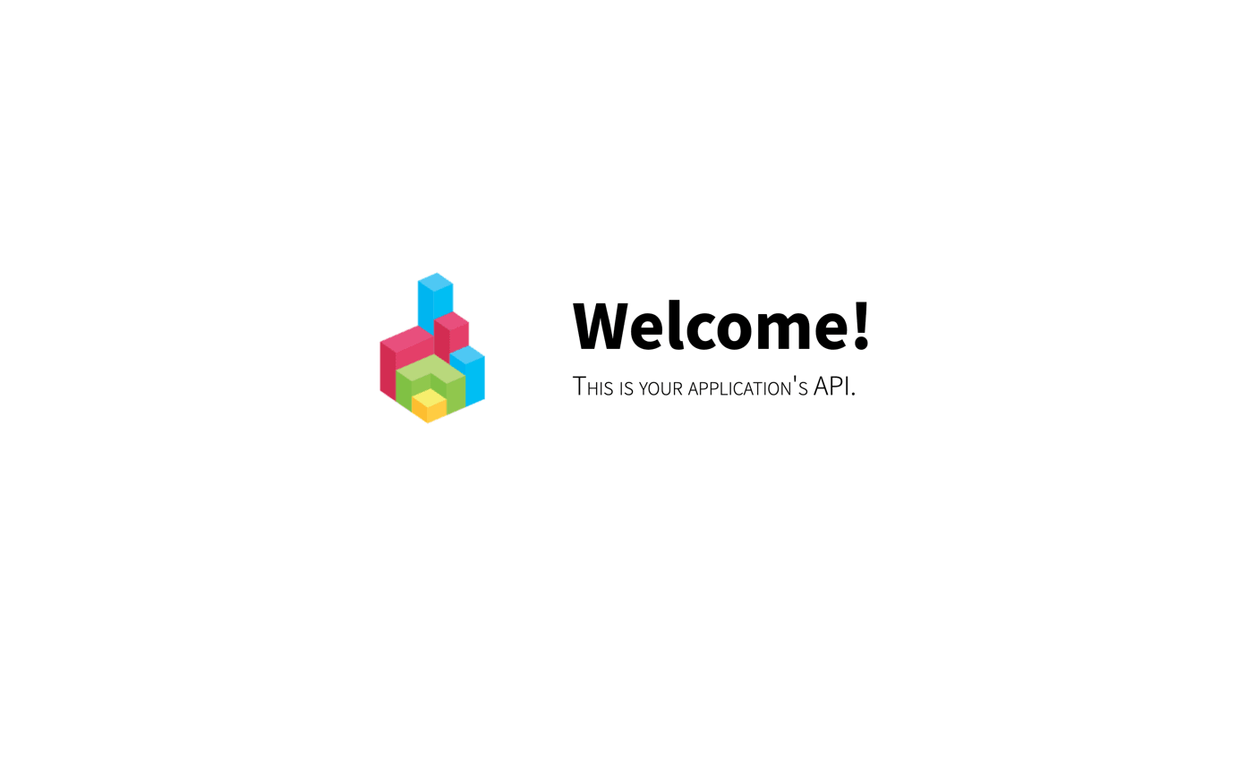

Open your API: click its URL in the URL column of the list, or Open app on the Deployed version card of its overview. Your API answers with a welcome page.
The welcome page returned by the deployed API
Your API is deployed and reachable.

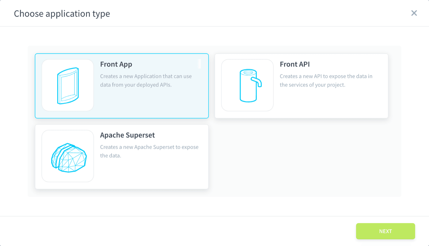

Back in Applications & APIs, click + ADD, select Front App and click NEXT.
The Choose application type dialog with Front App selected

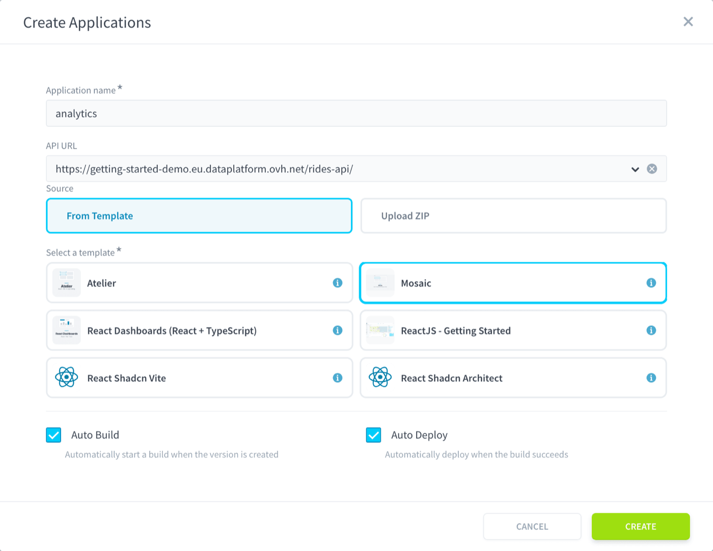

Fill in the form:
  • Application name: analytics. Data Platform derives the URL from it, so your application is served at /analytics-app/.
  • API URL: select the URL of the rides API you have just deployed. This field is what connects your application to your API.
  • Select a template: Mosaic.
  • Tick Auto Build and Auto Deploy, so that the version builds and goes live on its own.
As for your API, the first version is named v1. A Front App offers no cache: it serves the pages your users open, while the data and its cache stay with the API.
Click CREATE.
The Create Applications form with analytics, the rides API URL, the Mosaic template and both options ticked

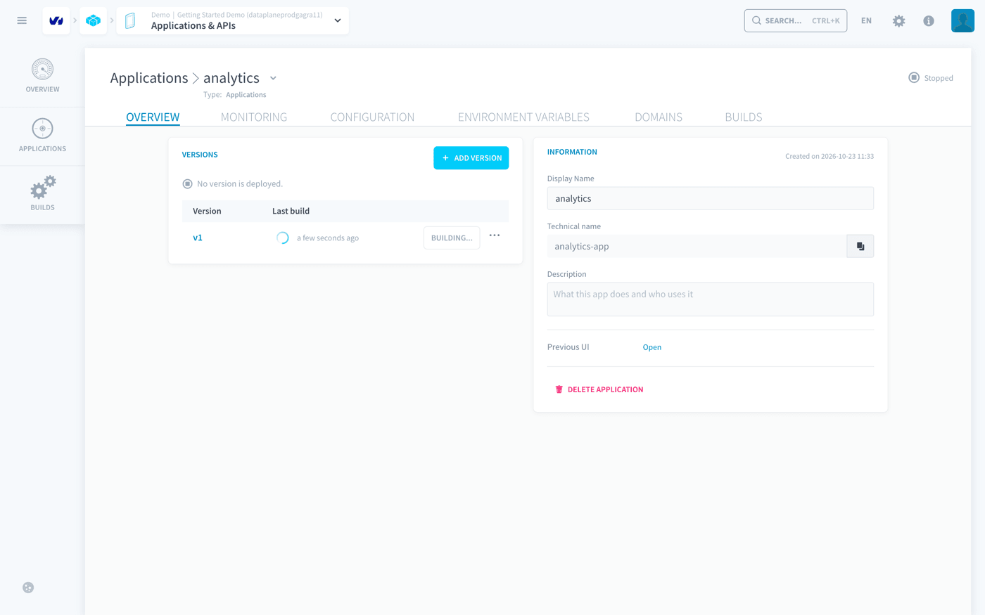

Data Platform opens the new application while its first version builds. The build takes a couple of minutes.
The overview of the analytics application while version v1 builds

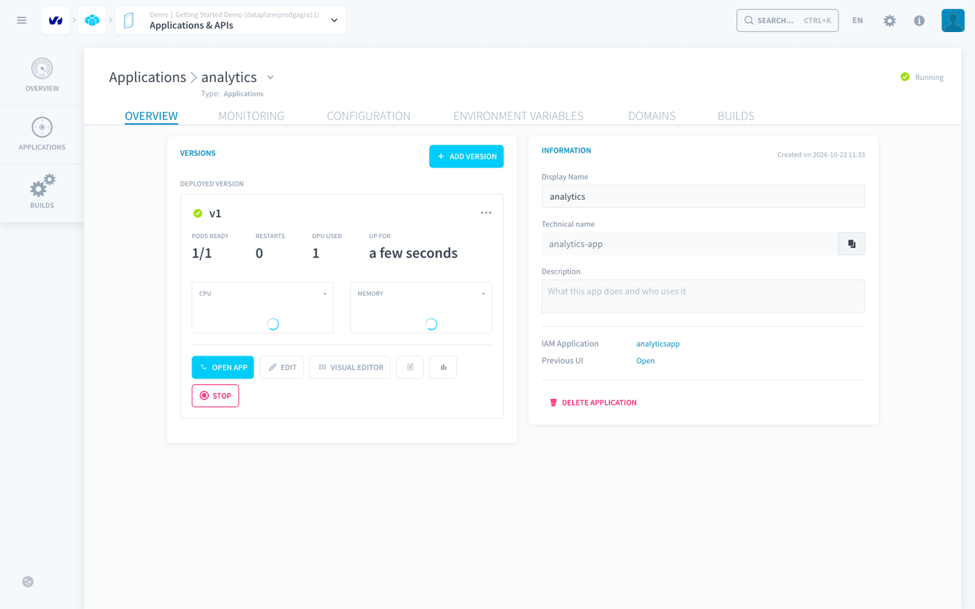

When the build succeeds, Auto Deploy takes over. On the overview, the Deployed version card now shows v1 running, with the buttons that act on it: Open app, Edit and Visual Editor.
The overview of the analytics application, with v1 running in the Deployed version card and its Visual Editor button

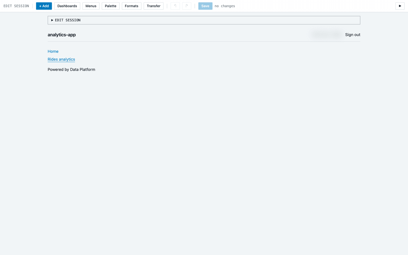

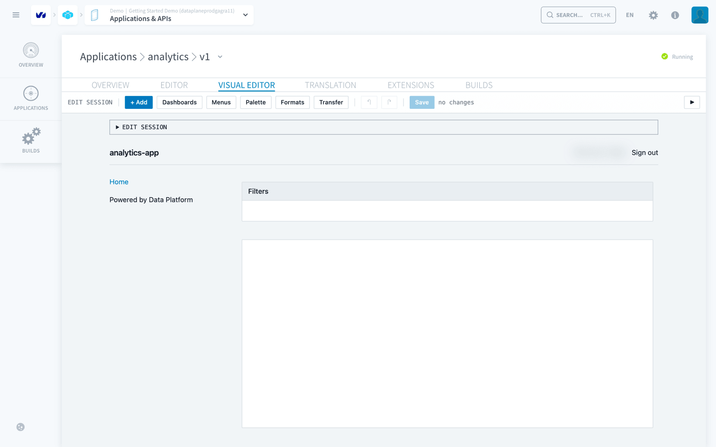

Opening the Visual Editor
Click Visual Editor on the Deployed version card.
Data Platform opens the Visual Editor tab of v1, with your application inside the console, signed in as an administrator. The toolbar across the top only appears in the Visual Editor: your users never see it. From now on, you build everything (pages, charts, filters, menus, number formats) inside the application itself.
The analytics application in the Visual Editor tab, with the editing toolbar at the top
The Visual Editor button, like the tab of the same name on the version page, only appears on a running version. The editor is served by the application itself, so a stopped version has nothing to open.

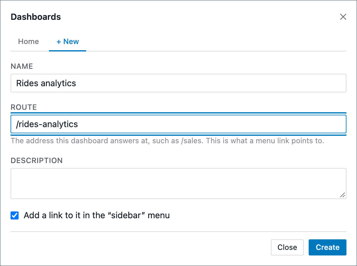

Click Dashboards in the toolbar, then the + New tab, and fill in:
  • Name: Rides analytics
  • Route: /rides-analytics
Leave the description empty, and leave Add a link to it in the "sidebar" menu ticked: your users need to reach this page, and the option adds the link to the sidebar for you.
The Dashboards dialog with the new Rides analytics page filled in
Click Create, then Close.

Click Rides analytics in the sidebar to open your new page, which is still empty.
The empty Rides analytics page, reached from its new link in the sidebar

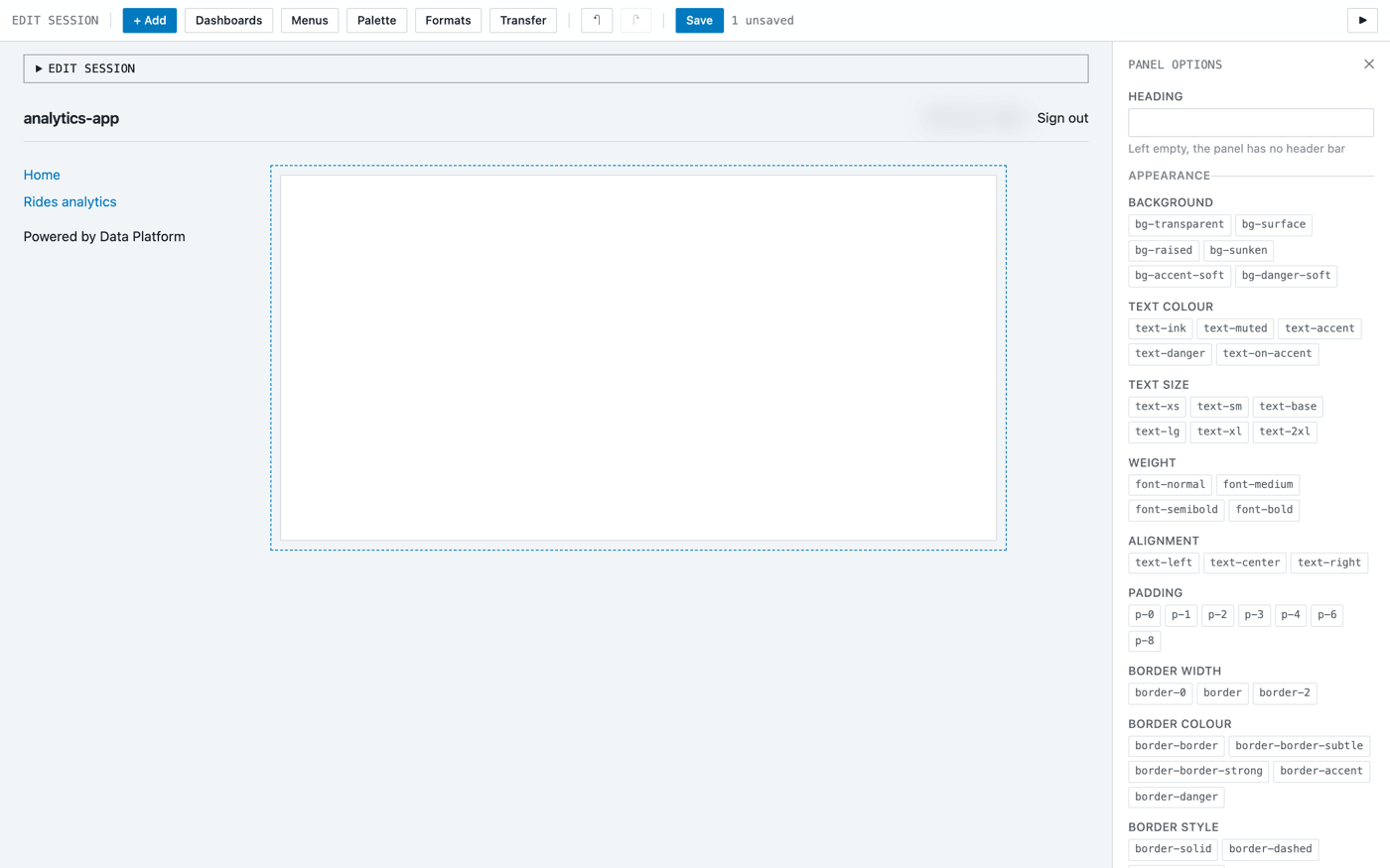

Click + Add in the toolbar and select Containers > Panel. A panel is a container for the other components. Resize it by dragging its bottom-right corner.
An empty panel added to the page, with its options open on the right

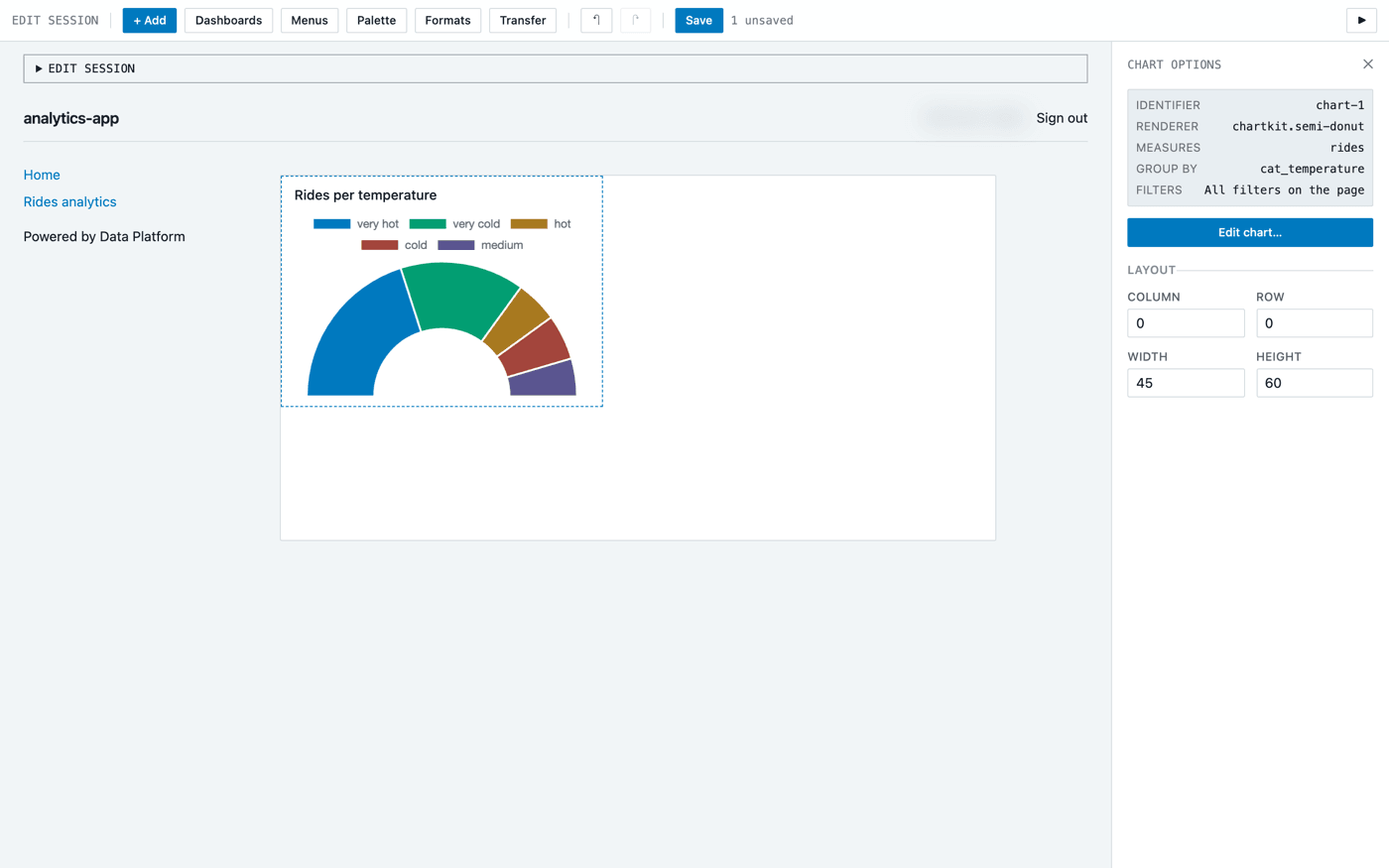

Inside the panel, click its + button and select Charts > Semi donut.

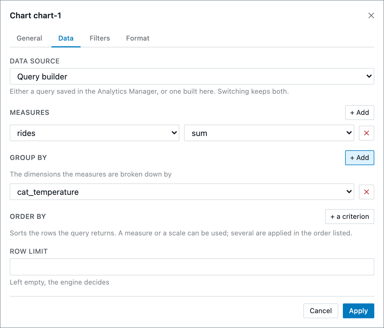

In the General tab, name the chart Rides per temperature.
Then open the Data tab, where you describe the data to display rather than the drawing. Leave Data source on Query builder, which builds the query right here, then:
  • under Measures, click + Add and select rides with the sum aggregation.
  • under Group by, click + Add and select cat_temperature.
The Data tab of the chart dialog, with rides summed and grouped by cat_temperature
Click Apply. The chart queries your data through the API you deployed in Part 1 and displays one slice per temperature category: the total number of rides in each.
The Rides per temperature semi donut chart, with its options on the right

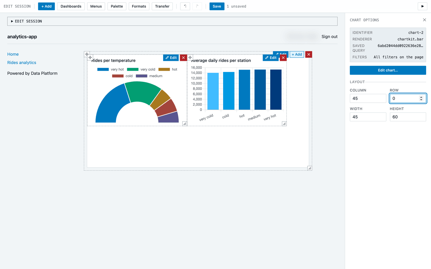

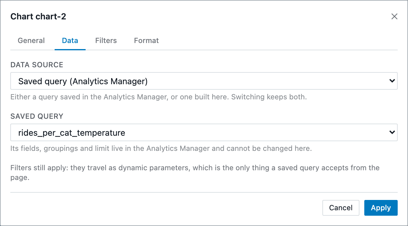

Click the + button of the panel again and select Charts > Bar: these are averages, not the parts of a whole.
In the General tab, name the chart Average daily rides per station.
In the Data tab, set Data source to Saved query (Analytics Manager), then select rides_per_cat_temperature in Saved query. There is nothing else to fill in: the fields, the grouping and the order of a saved query live in the Analytics Manager, and you change them there.
The Data tab of the chart dialog, with the rides_per_cat_temperature saved query selected
Click Apply. The chart lands under the first one, where the panel has no room left for it. Put it beside the semi donut instead: in the chart options on the right, under Layout, set Column to 45 and Row to 0.
The bars show the average for each temperature category, in the order the saved query sorts them.
The Average daily rides per station bar chart beside the semi donut chart, with its layout options on the right
The Analytics Manager is where your team keeps the queries it shares. A chart built on one of them stays in step with it: change the query there, and every chart that uses it follows.

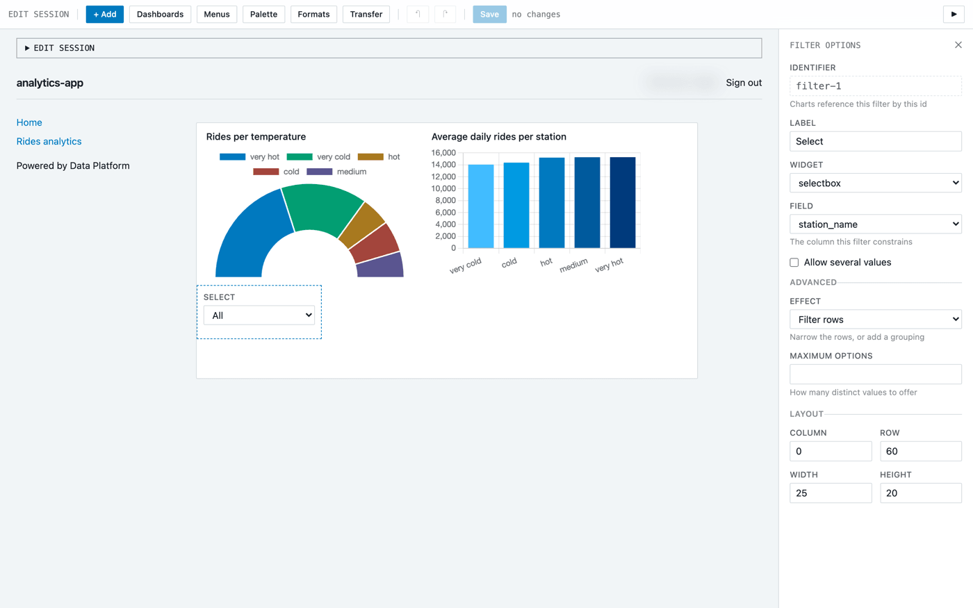

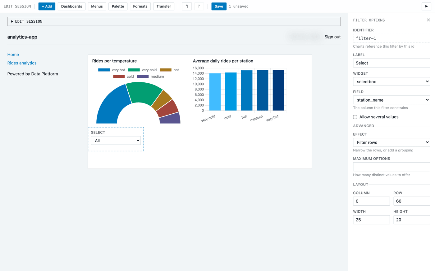

A filter lets your users narrow the charts down. Click the + button of the panel again and select Filters > Select.
The filter is added immediately and its options open on the right. Set Field to station_name, the column the filter constrains.
The options of each chart list All filters on the page under Filters, so both charts respond to this filter without any further setting. A saved query receives it as a dynamic parameter.
The filter options panel with the Field set to station_name
Click Save in the toolbar. The counter next to it goes back to no changes: your dashboard is saved in the sources of the version.
The saved dashboard, with the toolbar counter showing no changes

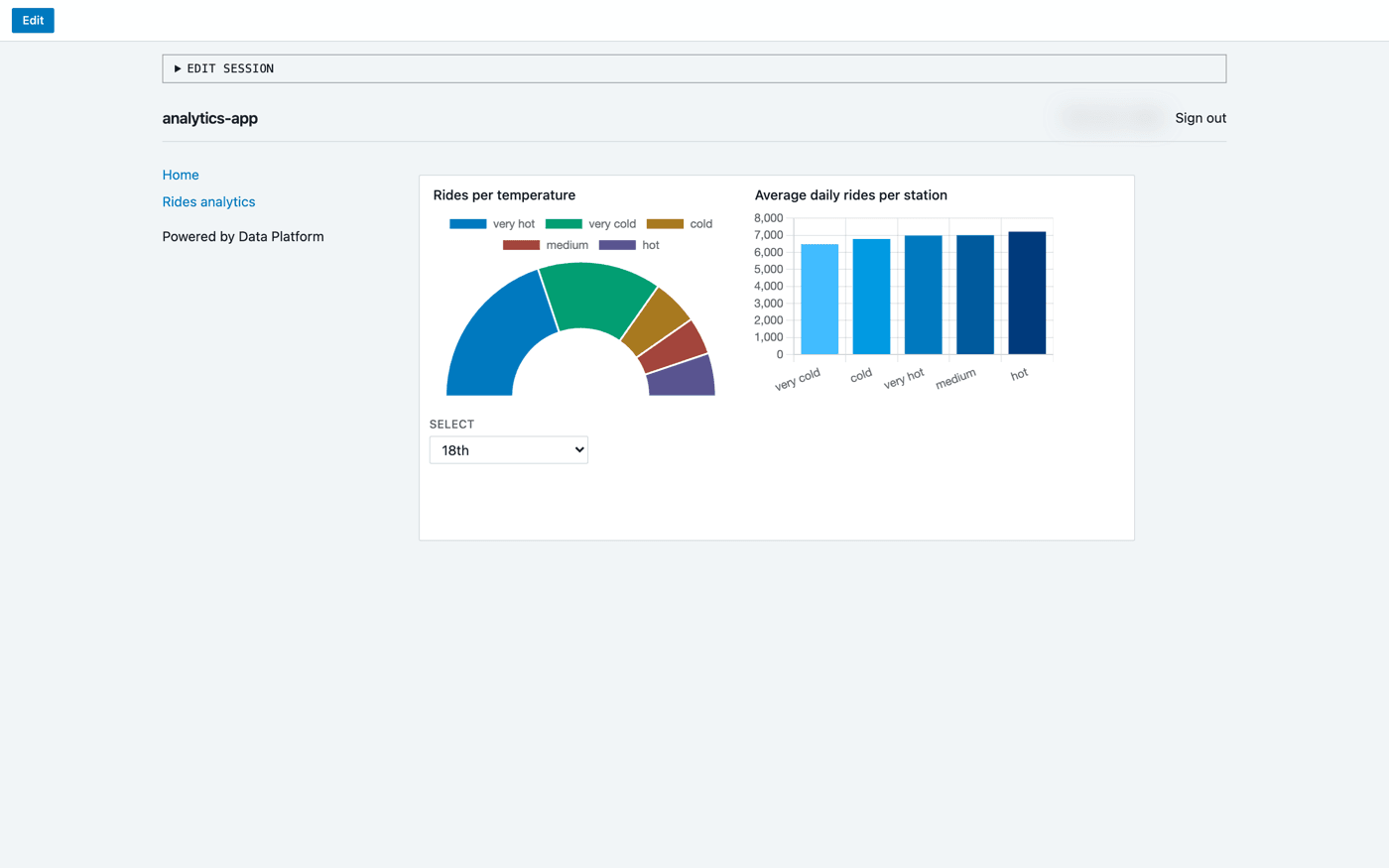

Click the ▶ button at the right end of the toolbar to leave edit mode. The toolbar collapses into a single Edit button, and you see your application as your users do.
Select a station in the filter: both charts redraw for that station only.
The dashboard in preview, filtered on one station

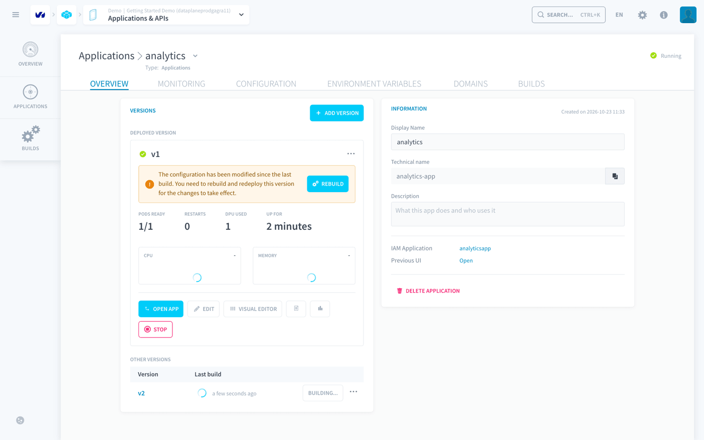

Go back to the overview of your application. The Deployed version card indicates that the configuration has been modified since the last build: your users are still served the version deployed earlier, which does not include the dashboard you have just built.
The card offers to rebuild that version in place. Copy it instead, so that v1 stays as it was, a version you can go back to: open the … menu of the Deployed version card and select Copy.
In the Copy Version dialog, name the copy v2, tick Auto Build and Auto Deploy, and click CREATE.

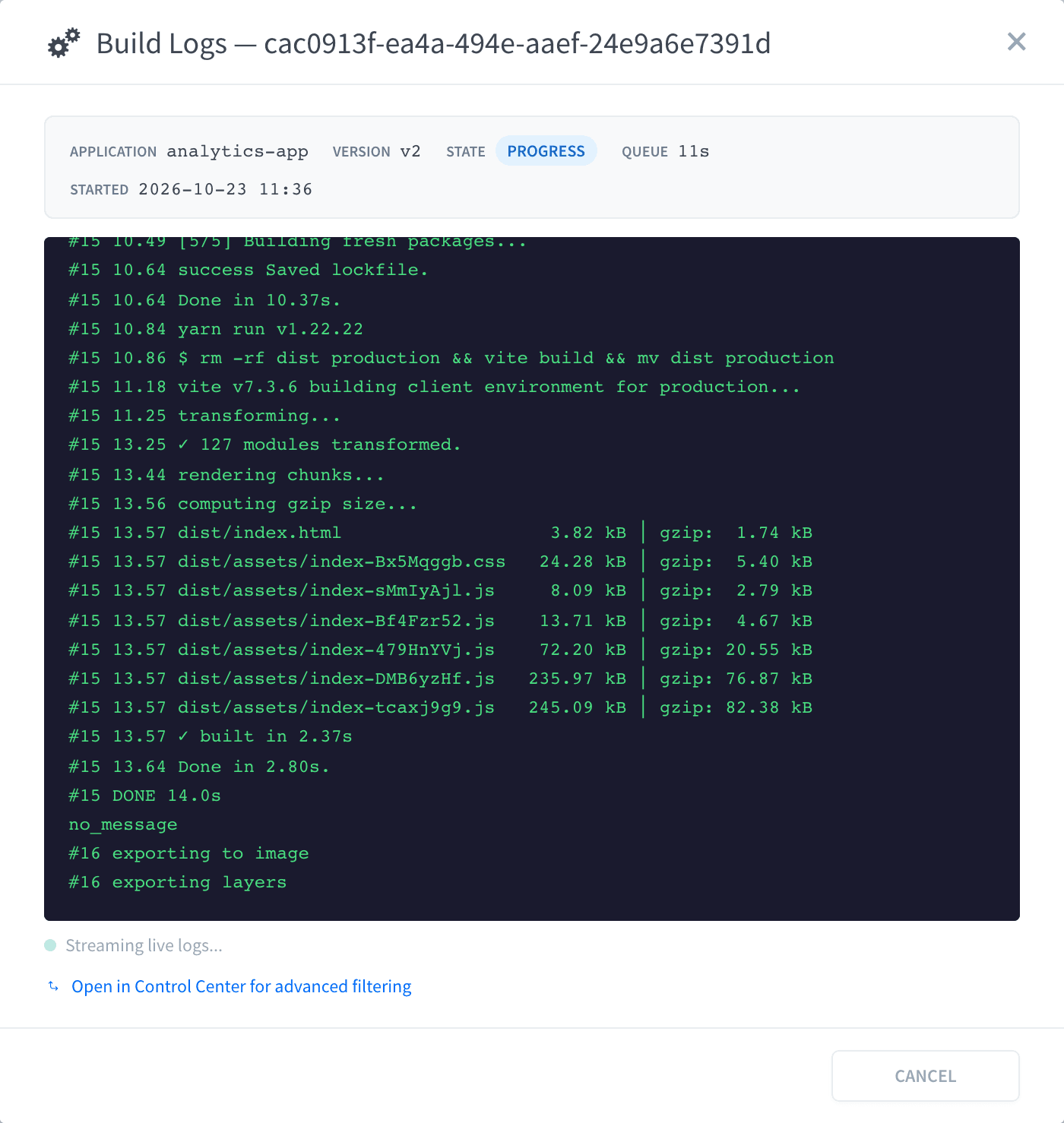

The overview with v2 building while v1 is still deployed and marked as needing a rebuild
The same blue-green deployment as for your API applies: v1 keeps serving your users while v2 builds and deploys. The switch happens once the new version is ready, with no interruption.
The build takes a couple of minutes. To follow it, or to investigate a failed build, open the Builds tab of the version and click the logs icon. The Build Logs dialog shows the state of the build, its time in the queue and each step as it runs, with a link to the Control Center for advanced filtering.
The Build Logs dialog of version v2, streaming the build steps

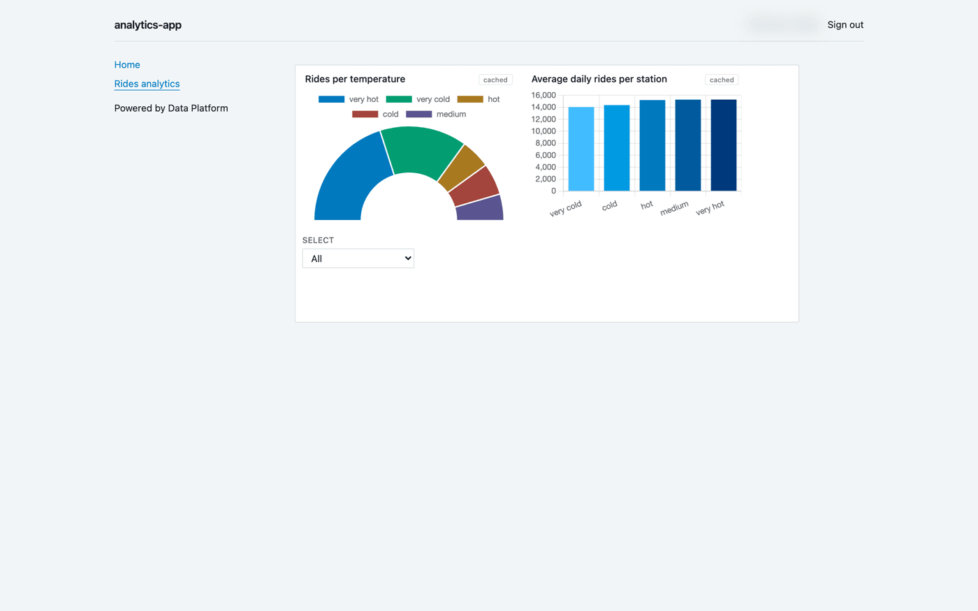

Your application opens. Rides analytics, the menu entry you added, is in the sidebar, and it leads to your two charts, live and filterable.
The deployed analytics application showing both charts and the station filter
Your dashboard is online and reads its data through your own API. Nothing refreshes on a timer: each chart queries the API when a page opens and when a filter changes.
