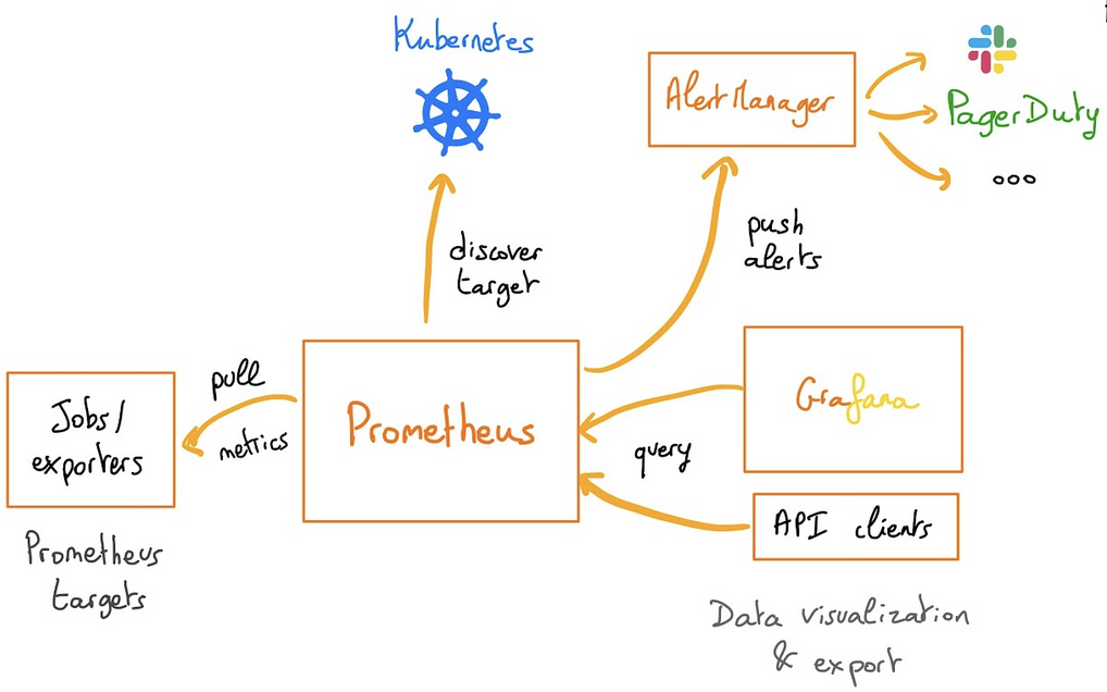

Prometheus operator
The Prometheus Operator provides Kubernetes native deployment and management of Prometheus and related monitoring components.
Prometheus Architecture
The purpose of this project is to simplify and automate the configuration of a Prometheus based monitoring stack for Kubernetes clusters. The Prometheus operator also deploys a Grafana dashboard, to visualize our metrics in a user-friendly way.
If you are interested about the operator, feel free to read the Prometheus operator official documentation.

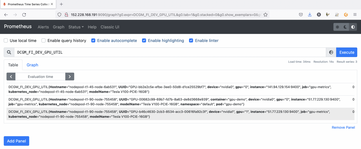

Open your browser and go to the Prometheus interface.
As you already deployed DCGM with NVIDIA GPU Operator, DCGM should already have started publishing metrics to Prometheus. The metrics availability can be verified by typing DCGM_FI_DEV_GPU_UTIL in the search bar. Click on the Execute button to determine if the GPU metrics are visible:
Prometheus
You can check the GPU usage with several metrics in Prometheus:
  • DCGM_FI_DEV_GPU_UTIL: GPU utilization.
  • DCGM_FI_DEV_SM_CLOCK: SM clock frequency (in MHz).
  • DCGM_FI_DEV_MEM_CLOCK: Memory clock frequency (in MHz).
  • DCGM_FI_DEV_MEMORY_TEMP: Memory temperature (in C).
You can find the full list of metrics exported by DCGM-exporter in the NVIDIA website.

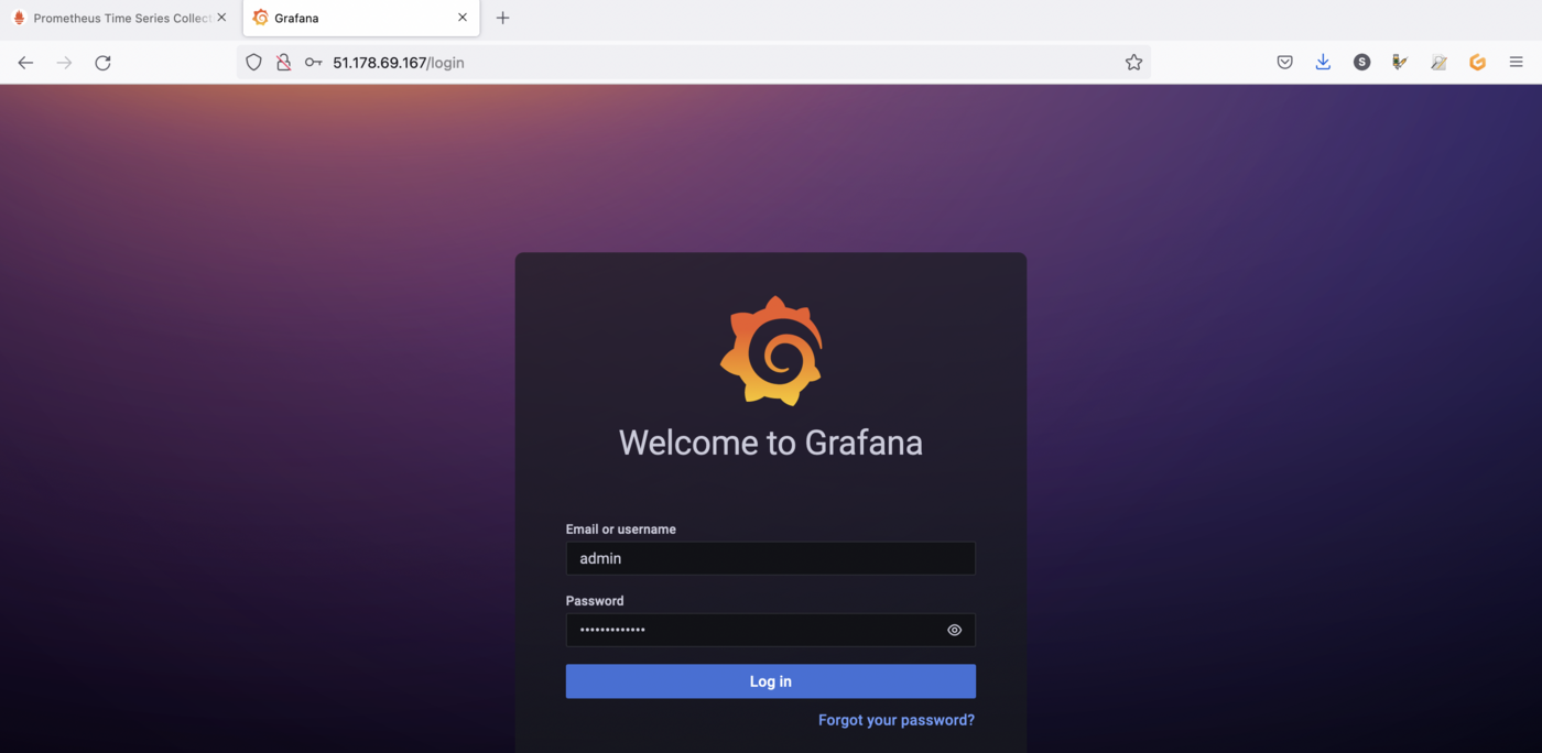

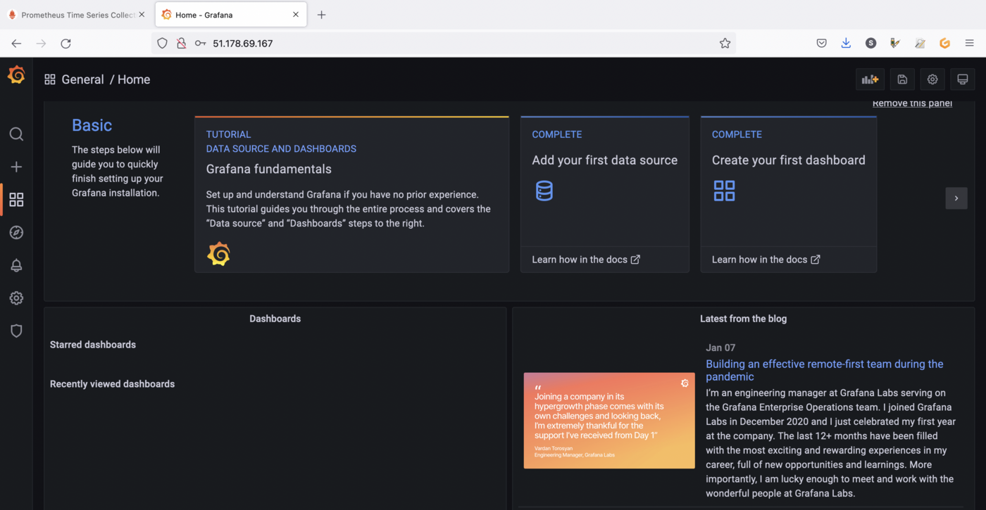

You can also go to the Grafana interface. Open your browser and point to http://$GRAFANA_URL value using the credentials bellow:
  • Login: admin
  • Password: prom-operator (by default)
Grafana Grafana Home Page

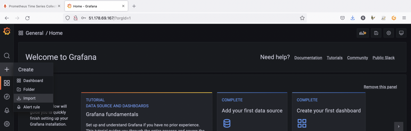

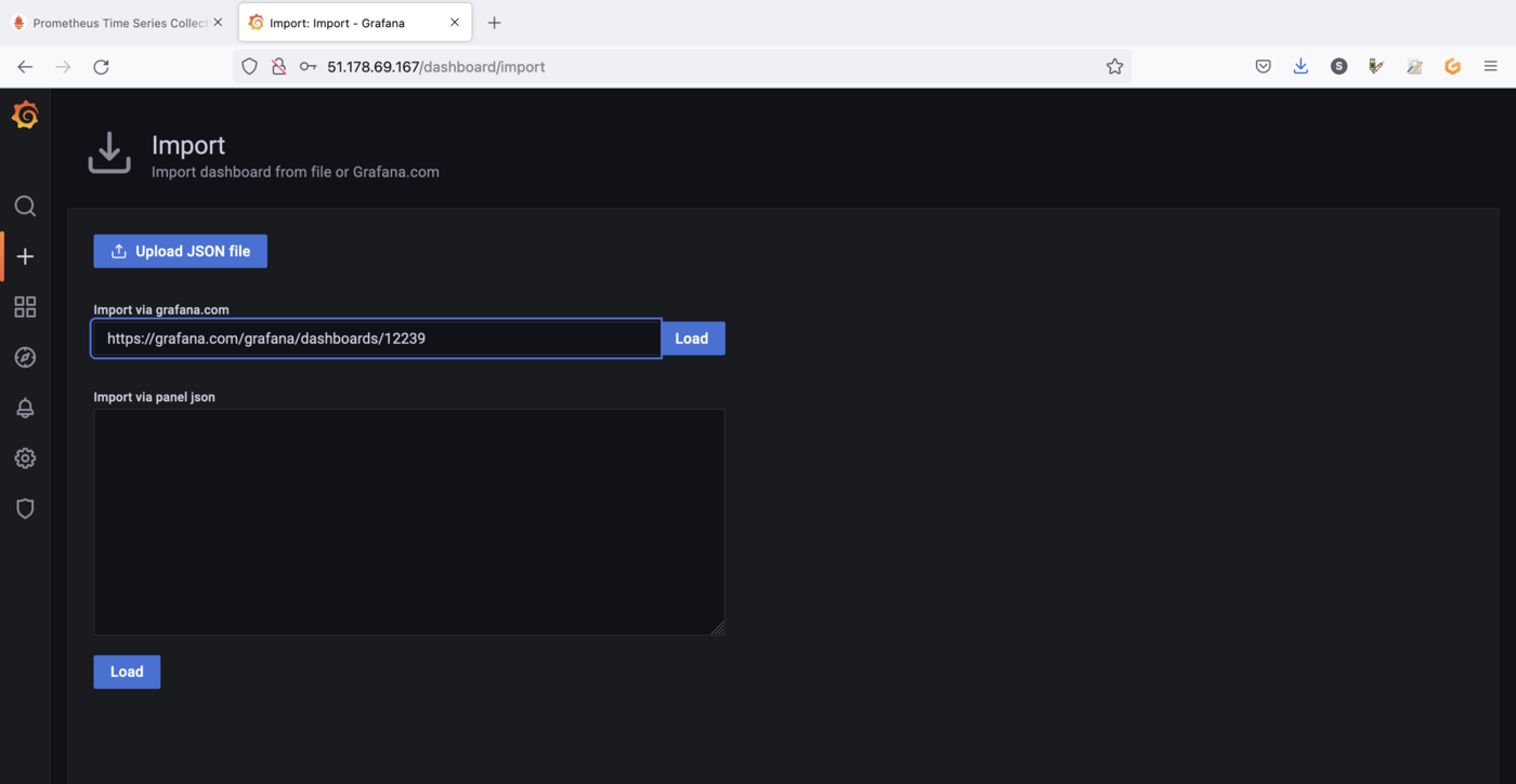

You have a running Prometheus and Grafana, now you need to add a dashboard for DCGM. To do that, you can use a standard dashboard that NVIDIA released, which can also be customized.
To add the dashboard, in the Grafana sidebar, click on + -> Import:
Grafana Import menu

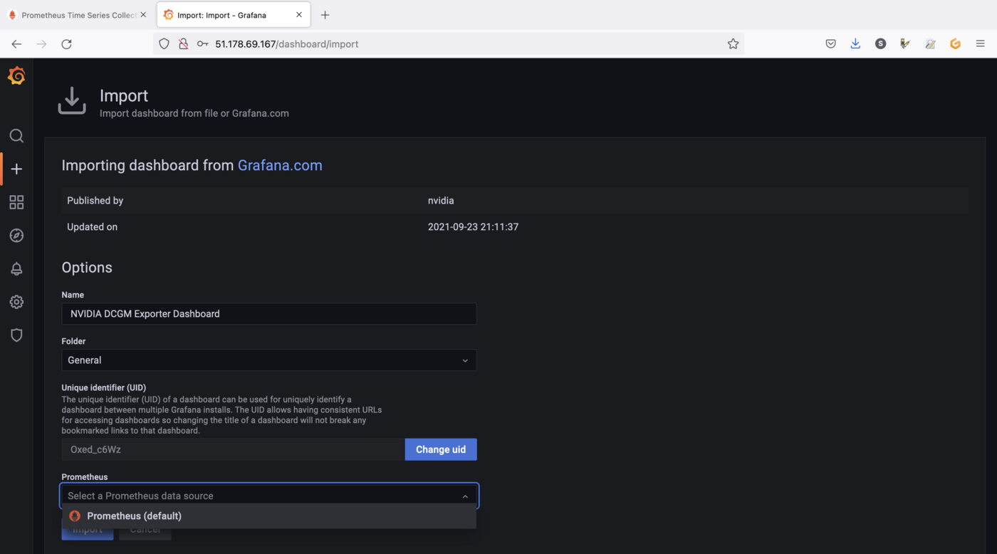

Import the NVIDIA dashboard from https://grafana.com/grafana/dashboards/12239, click on the Load button:
Grafana Import menu
Then choose Prometheus as the data source in the drop down menu and click on the Import button:
Grafana Import menu

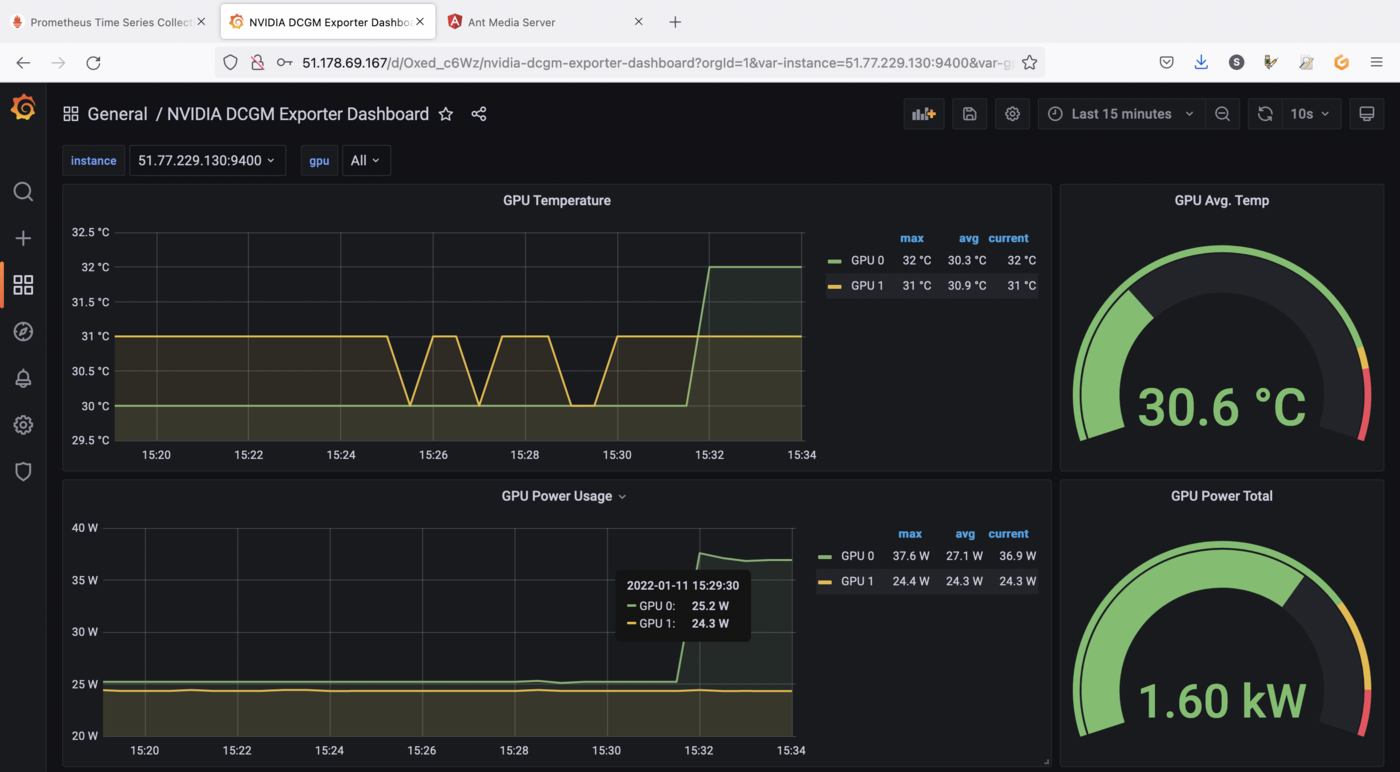

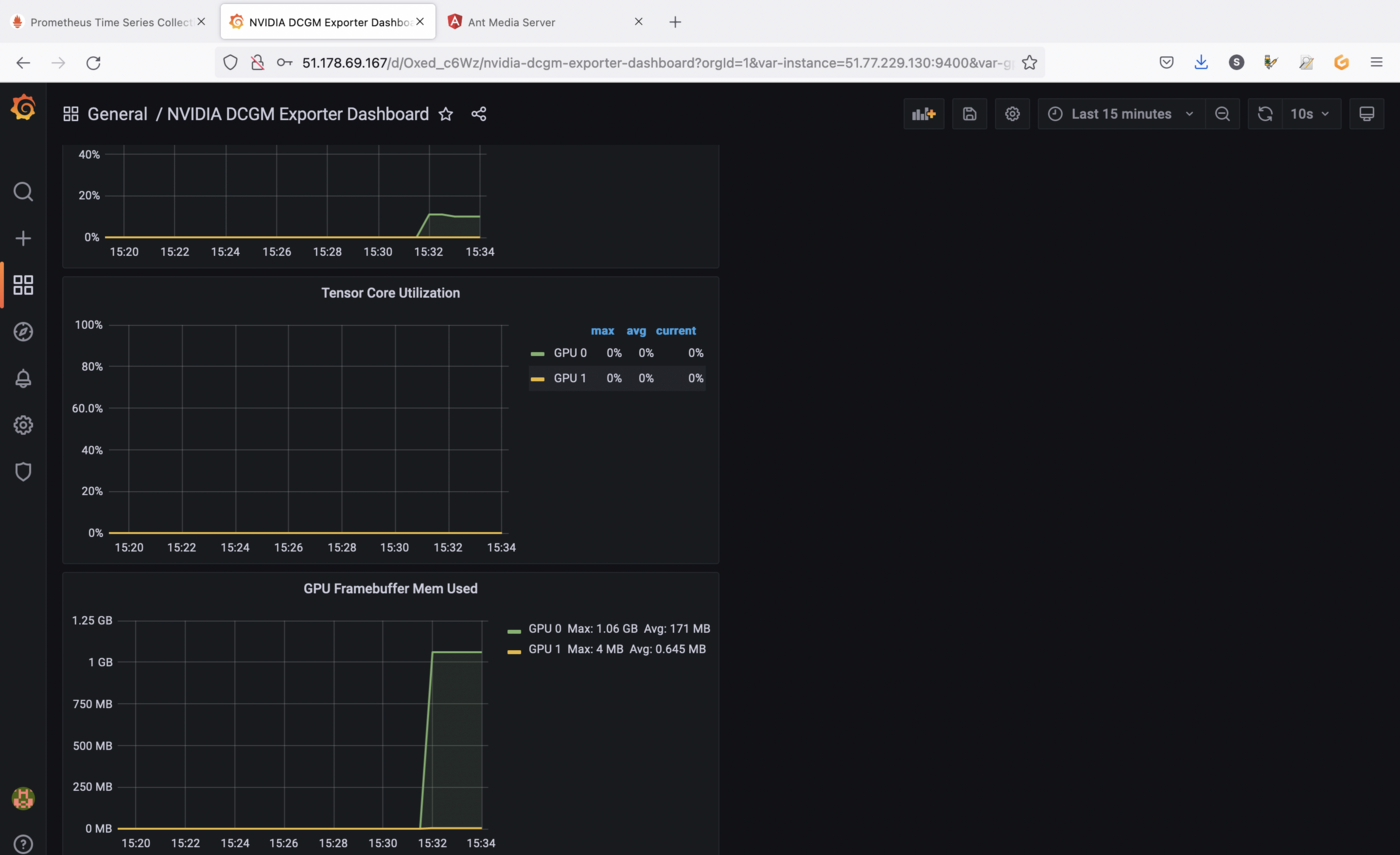

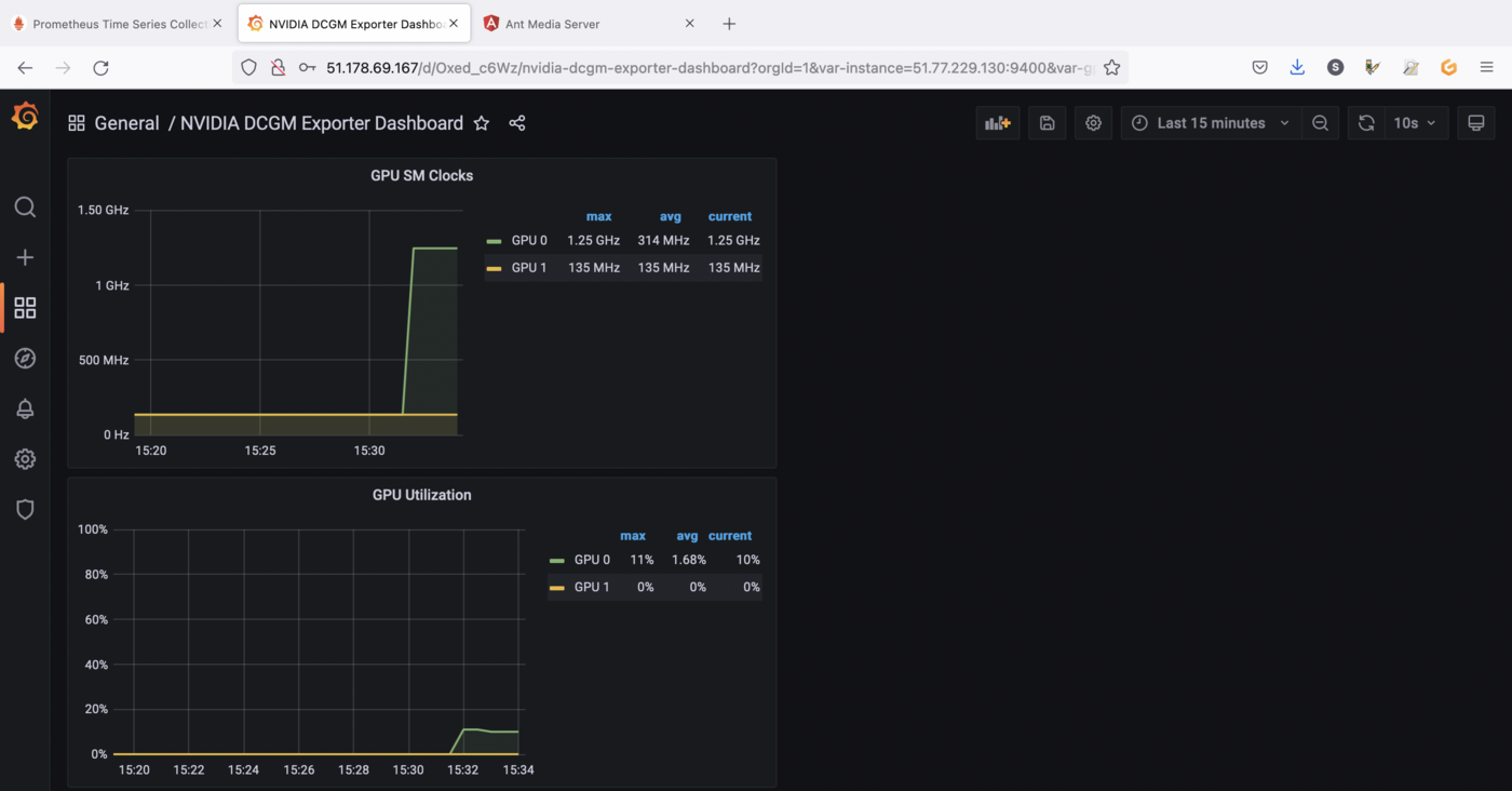

You should now see your new dashboard:
Grafana NVIDIA DCGM Exporter Dashboard

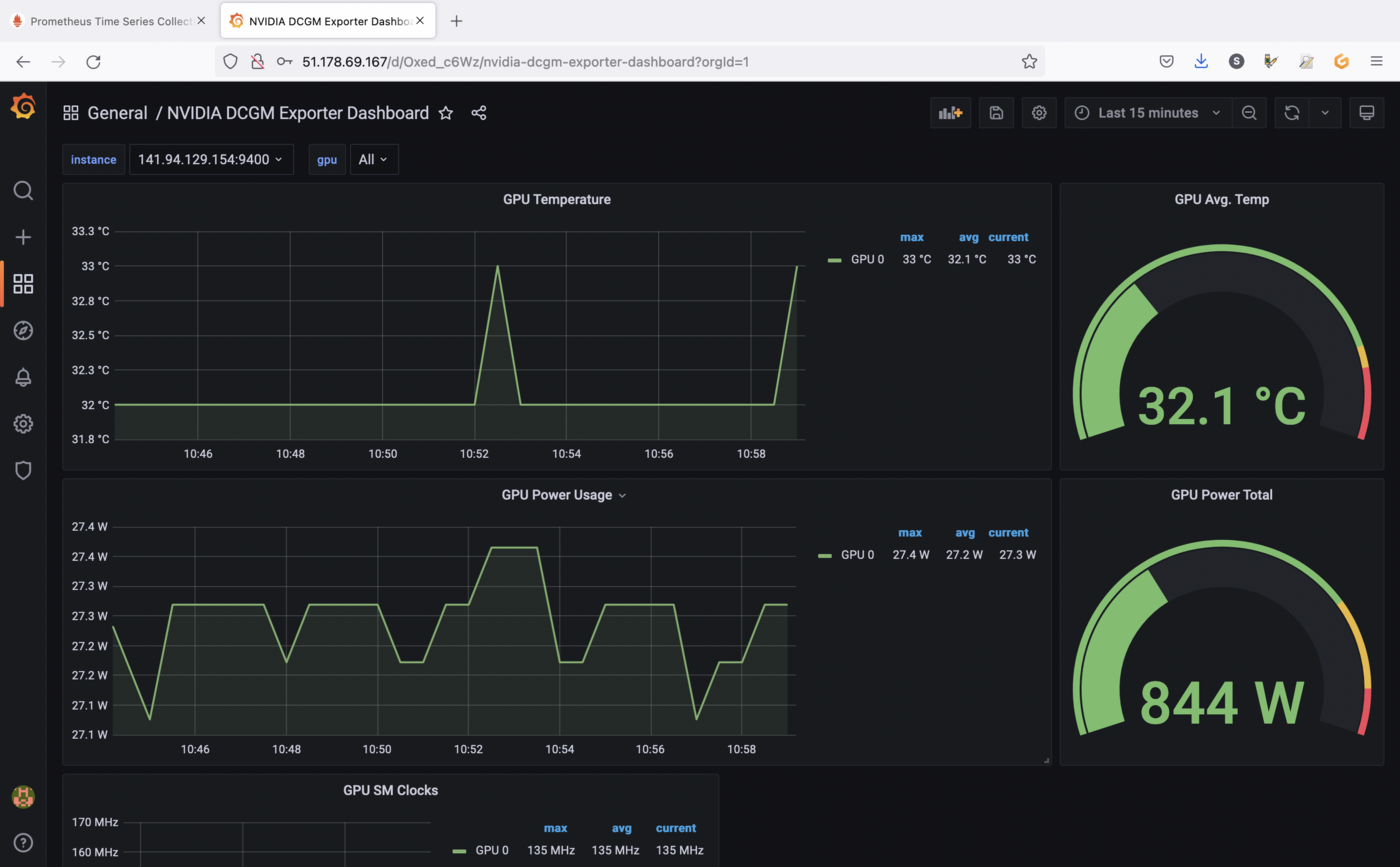

If you followed the Deploying a GPU application on OVHcloud Managed Kubernetes tutorial, you should see metrics like in our example.

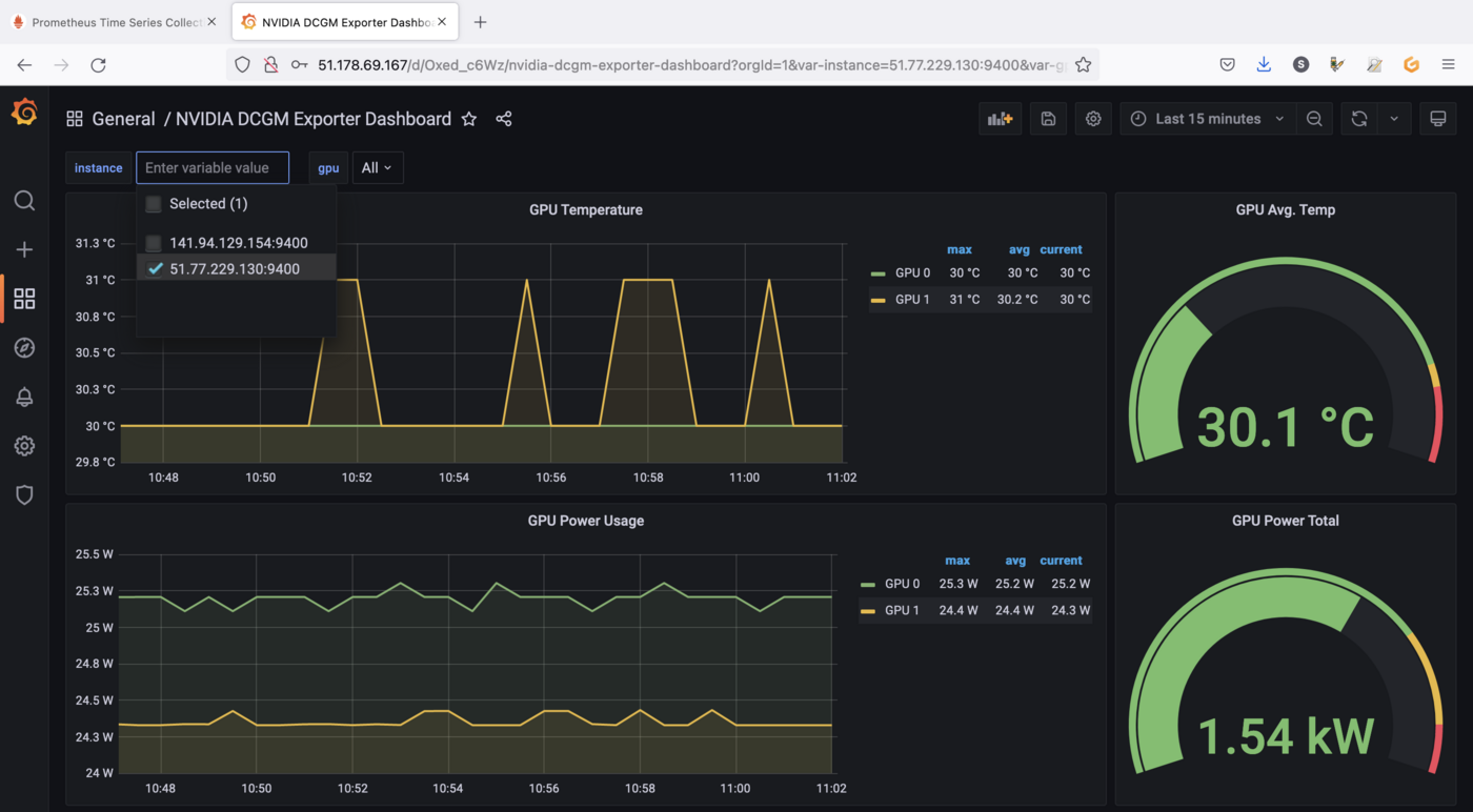

You can click on the instance drop down menu in order to visualize GPU metrics for another Node for example:
Grafana NVIDIA DCGM Exporter Dashboard other node

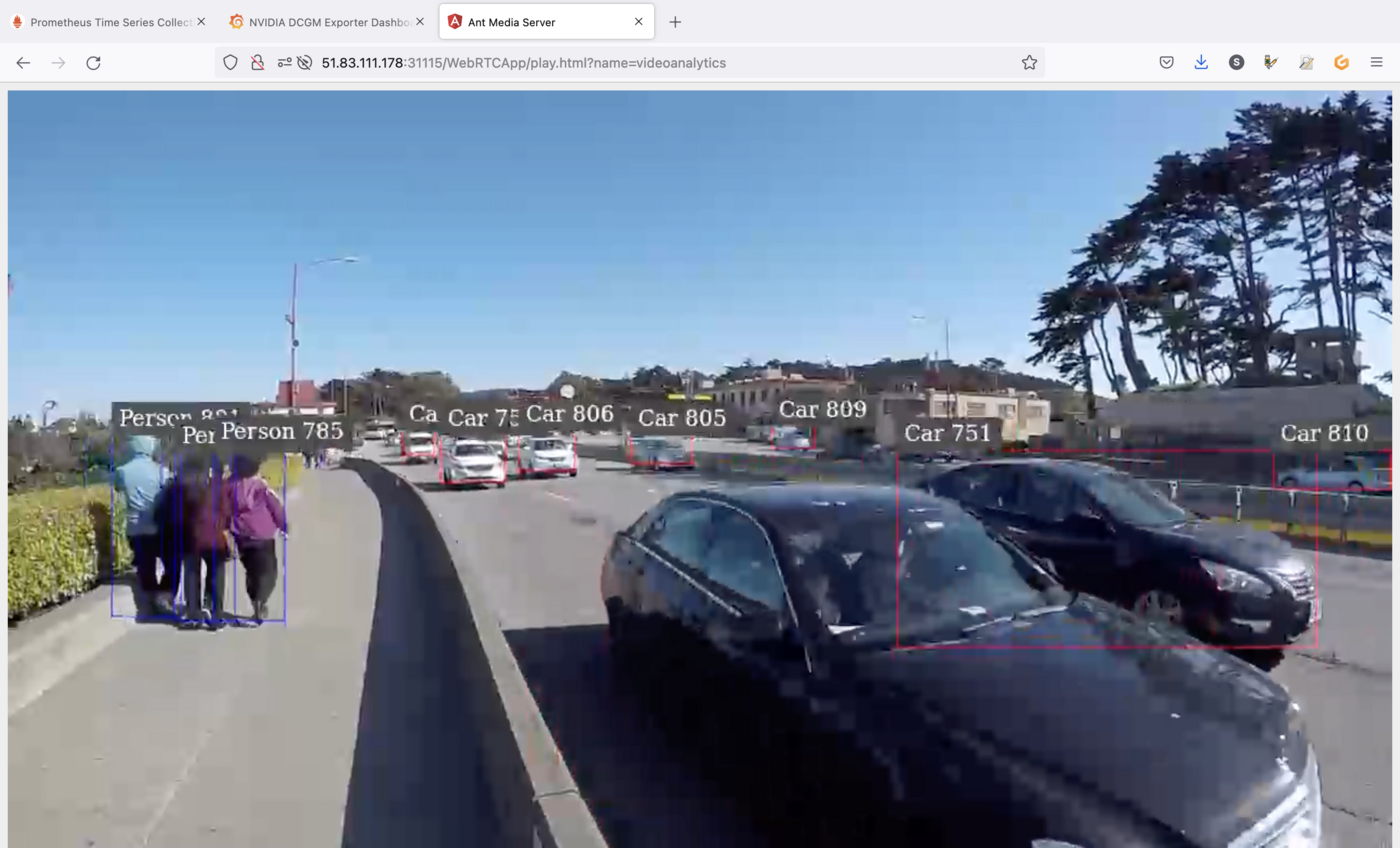

Now we have a monitoring working stack and a dashboard to visualize our data, it's time to run an application in order to retrieve GPU metrics and viualize interesting data.
As a complex and interesting application using GPU, you can use the standard DeepStream Intelligent Video Analytics Demo available on the NVIDIA NGC registry.
This is an easy to deploy video analytics demo that allows you to demo GPU accelerated video analytics. The container is based on the NVIDIA DeepStream container and leverages its built-in SEnet with resnet18 backend.
The Intelligent Video Analytics demo:
  • is an easy to use demo to demonstrate GPU accelerated Inference
  • is based on the NGC Deepstream Container
  • leverages Kubernetes, Helm, NGC & DeepStream
  • does not require a Video Management System (VMS)

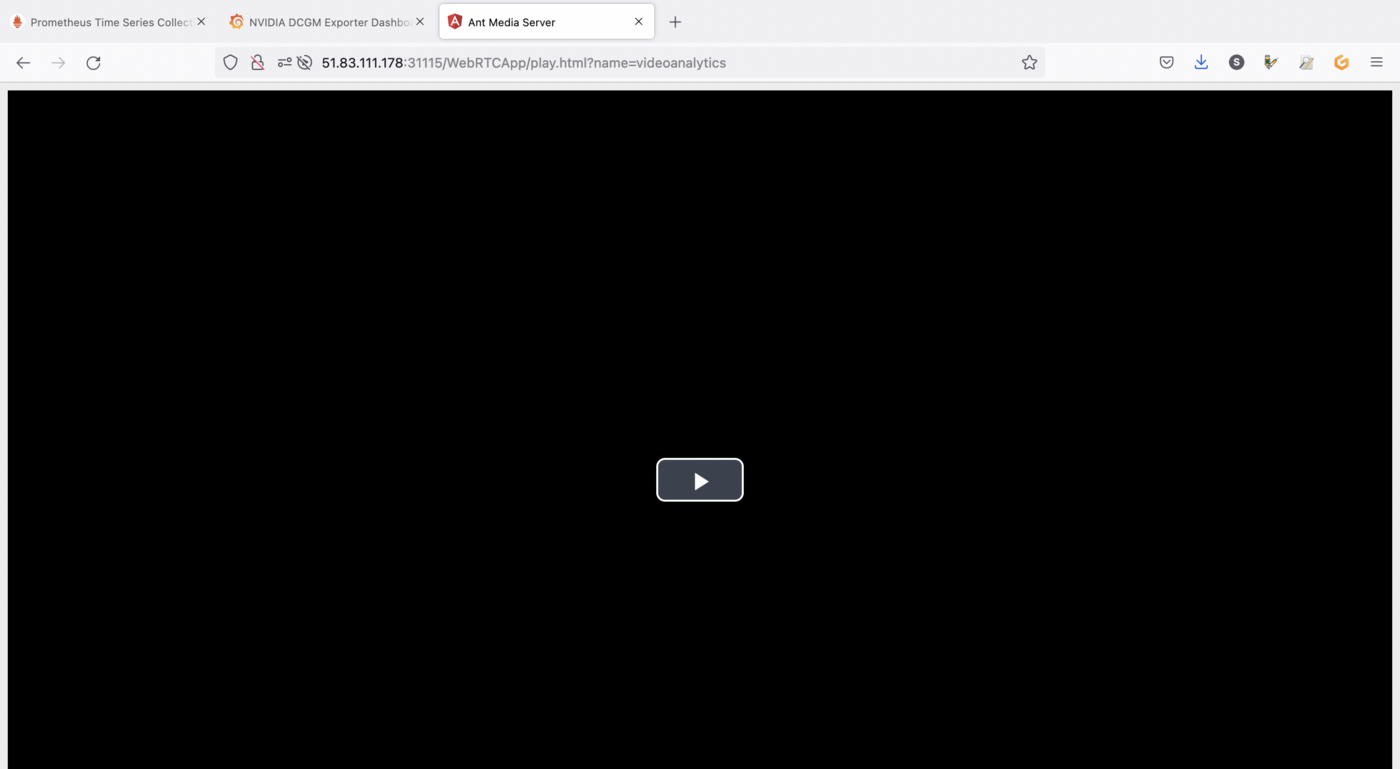

You can deploy the application through NVIDIA Helm chart:
helm fetch https://helm.ngc.nvidia.com/nvidia/charts/video-analytics-demo-0.1.4.tgz && \
helm install video-analytics-demo-0.1.4.tgz --generate-name
You should have a result like this:
$ helm fetch https://helm.ngc.nvidia.com/nvidia/charts/video-analytics-demo-0.1.4.tgz && \
LAST DEPLOYED: Tue May  2 09:21:15 2023
NAMESPACE: default
STATUS: deployed
REVISION: 1
NOTES:
1. Get the RTSP URL by running these commands:
  export NODE_PORT=$(kubectl get --namespace default -o jsonpath="{.spec.ports[0].nodePort}" services video-analytics-demo-0-1683012074)
  export NODE_IP=$(kubectl get nodes --namespace default -o jsonpath="{.items[0].status.addresses[0].address}")
  echo rtsp://$NODE_IP:$NODE_PORT/ds-test
2.Get the WebUI URL by running these commands:
  export ANT_NODE_PORT=$(kubectl get --namespace default -o jsonpath="{.spec.ports[0].nodePort}" services video-analytics-demo-0-1683012074-webui)
  echo http://$NODE_IP:$ANT_NODE_PORT/WebRTCApp/play.html?name=videoanalytics

The demo can be viewed in the browser by pointing to the address given in the following instructions:
echo Demo URL: http://$NODE_IP:$ANT_NODE_PORT/WebRTCApp/play.html\?name\=videoanalytics
Result:
$ export ANT_NODE_PORT=$(kubectl get --namespace default -o jsonpath="{.spec.ports[0].nodePort}" services video-analytics-demo-0-1683012074-webui)
$ export NODE_IP=$(kubectl get nodes --namespace default -o jsonpath="{.items[0].status.addresses[0].address}")
$ echo Demo URL: http://$NODE_IP:$ANT_NODE_PORT/WebRTCApp/play.html\?name\=videoanalytics\~
Video Demo: http://51.83.111.178:31115/WebRTCApp/play.html?name=videoanalytics~
Open the application URL in your browser:
GPU Demo
Click on the play button (the button with a triangle) to start the application:
GPU Demo Started
As you can see, the application, that can be used for smart cities use cases, uses the power of GPU in order to detect objects like persons and cars.
Now you can check the metrics in Grafana and watch the evolution of the charts:
Grafana Demo GPU metrics Grafana Demo GPU metrics Grafana Demo GPU metrics
The screenshots are showing GPU utilization and memory allocation on the GPU as long as the application is running.
