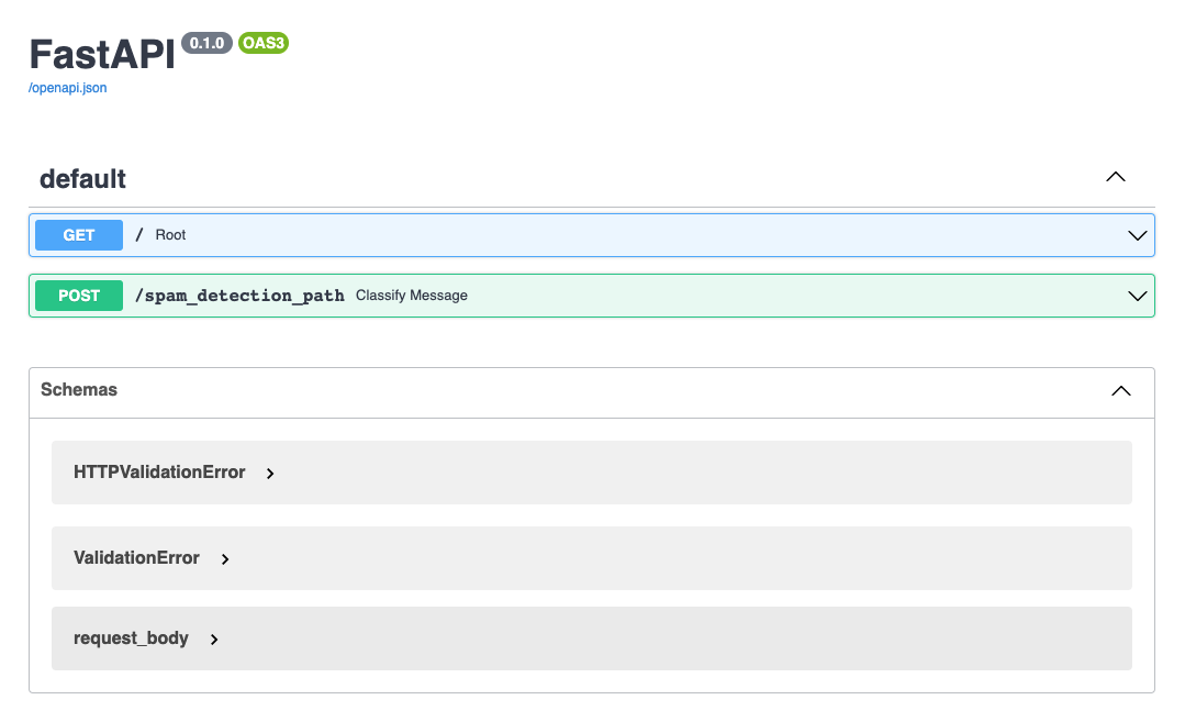

How to interact with your API?
You can add /docs at the end of the url of your app.
In our example, the url is as follows: https://ba2ef330-3e95-444a-a81b-7ca83dff5836.app.gra.ai.cloud.ovh.net/docs
It provides a complete dashboard for interacting with the API!
Overview

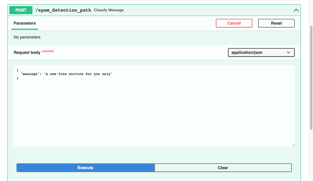

To be able to send a message for classification, select /spam_detection_path in the green box. Click on Try it out and type the message of your choice in the dedicated zone.
Overview

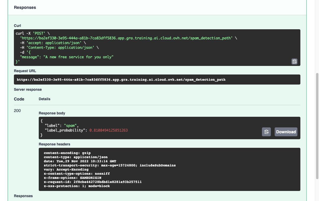

To get the result of the prediction, click on the Execute button.
Overview
Congratulations! You have obtained the result of the prediction with the label and the confidence score.
