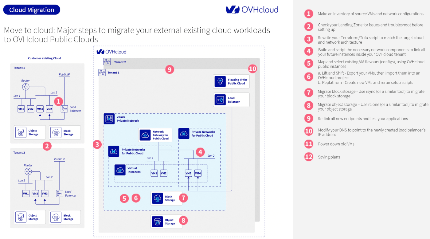

Before going into detail on the major steps, the diagram below provides an overview of the main phases of a migration to OVHcloud Public Cloud.
IAAS migration schema
1. Inventory your source VMs, storage and network configuration
Before starting your cloud migration, it’s crucial to create a detailed inventory of all your current resources:
  • Virtual Machines (VMs): List all your VMs, grouping those that belong to the same application (for example: a web server, an application server, and a database). This approach helps you migrate applications one at a time, minimizing service disruptions.
  • Storage: Identify your block storage volumes as well as your object storage buckets.
  • Network resources: Map out your entire network topology, including Layer 2 (L2) and Layer 3 (L3) network layouts, routers, load balancers, and firewalls.
Also, list your subnets and associated VLAN IDs. This information will be essential to correctly set up your target network within the OVHcloud Public Cloud environment.
With OVHcloud’s vRack feature, you can create over 4000 VLANs and keep your existing IP addressing plan. This greatly simplifies network migration and avoids potential conflicts or the need to renumber IPs.
