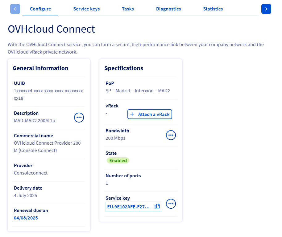

Once you have ordered your OVHcloud Connect Provider solution, you will receive an order confirmation via email, along with a service key.
Depending on the provider you have chosen, go to their portal to log in via the link provided in the order confirmation email. Then enter your service key and confirm the order presented to you.
Next, check the activation status of your solution in the . Your solution's status should have changed to “Active”.

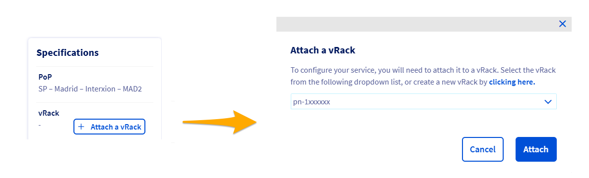

You will need to link a vRack to your solution first. Click the Attach a vRack button and select an existing vRack from the drop-down menu.
vRack association
A message will confirm the vRack association.
vRack association

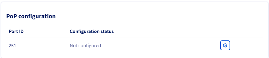

Step 3: Adding a PoP configuration
The OVHcloud Connect Provider solution requires an L3 level configuration.

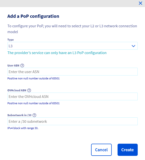

Once you have connected your vRack, click the cogwheel button in the PoP configuration section and select the L3 configuration from the drop-down menu.
PoP addition
You will then need to enter the following:
InformationDescription
Customer ASNYour AS BGP number, which is configured on your router located in the PoP
OVHcloud ASNThe OVHcloud AS number that will be configured on the OVHcloud Connect routers located in the PoP
Subnetwork in /30A size /30 IPv4 block, used for the link between your router and the OVHcloud Connect router located in the PoP

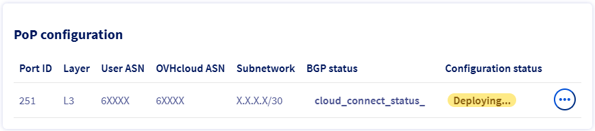

PoP addition

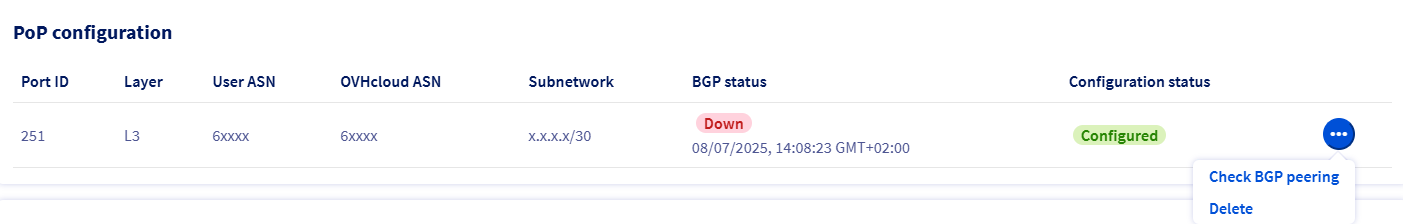

The PoP configuration menu will then appear.
PoP addition

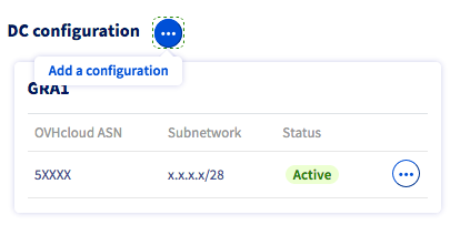

Step 4: Adding an availability zone configuration
When your PoP configuration has been set, click Add a configuration under the AZ configuration menu.
adding AZ

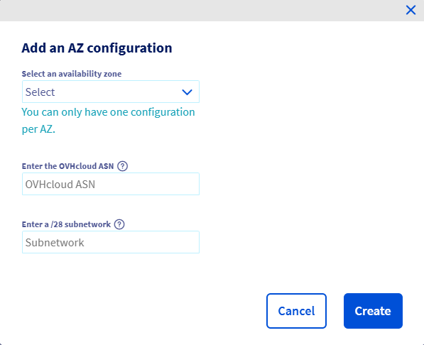

Select an availability zone from the dropdown menu, then enter the information required.
OVHcloud ASNThe OVHcloud AS number that will be configured on the OVHcloud Connect routers located in the AZ. This number may be different from the ASN chosen for the PoP
A /28 subnetworkA private subnetwork configured in your vRack in the selected AZ. This can be an IPv4 block of size /28 or higher
adding AZ

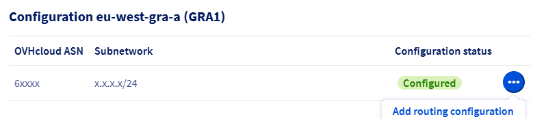

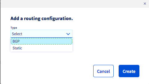

You must also add a routing configuration.

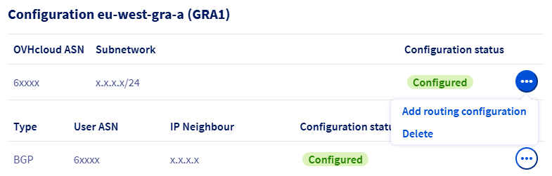

Adding a routing configuration
Click on the ... button on the desired availability zone then on Add routing configuration.
add AZ

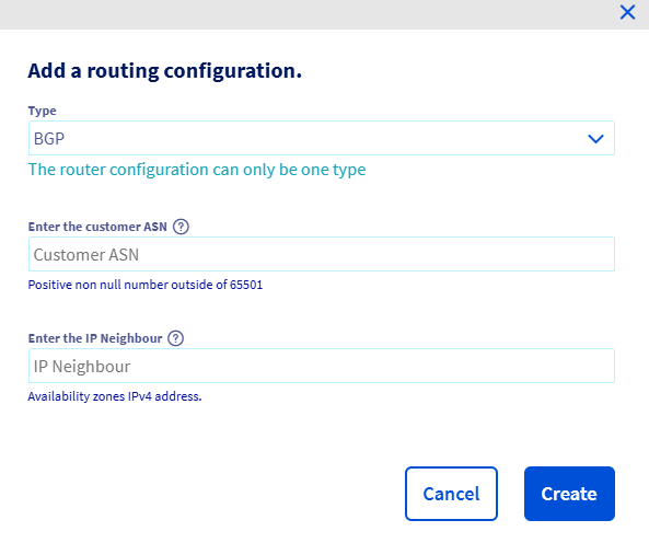

Then choose the routing type between Static and BGP.
add AZ

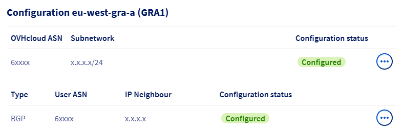

If you choose the BGP type, then enter the required information:
Customer ASNYour AS BGP number, which is configured on your router located in the AZ
IP NeighbourIP address of the BGP neighbour of your router in the AZ. This address must be part of the subnet specified in the AZ Configuration menu
add AZ

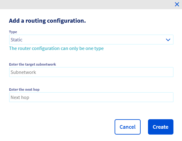

If you choose the Static type, enter the required information:
SubnetworkA prefix using CIDR notation
Next hopIP address acting as gateway in the subnet range
add AZ

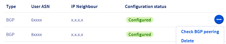

You can add multiple routing configurations within the same availability zone. The configuration type (BGP or Static) chosen for your first configuration will then apply to the next configuration in the same availability zone.
add AZ
