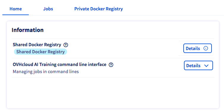

Push the image in the registry of our choice
Pushing our image to a registry is needed in order for AI Training to pull it.
AI Training provides, for each Public Cloud project, a default registry called shared registry where all users of a same Public Cloud project are able to push their custom images.
This shared registry can help you perform your tests, but should not be used in production, as we reserve the right to delete its content if deemed necessary. The images pushed to this registry are for AI Tools workloads only, and will not be accessible for external uses. This is why it can be interesting to add other registries. Learn how to do it by following this documentation.
Here are the basic commands to push a Docker image to a registry:
    docker login -u `<registry-user>` -p <registry-password> `<registry-address>`
    docker tag `<image-identifier>` <registry-address>/<image-identifier>:`<tag-name>`
    docker push `<registry-address>`/<image-identifier>:`<tag-name>`
For example, if we want to push a first version of our built image named cnn_image_segmentation_project inside a registry registry.gra.ai.cloud.ovh.net, we would use:
    docker login -u <registry-user> -p <registry-password> my-registry.ai.cloud.ovh.net
    docker tag cnn_image_segmentation_project:v1.0.0 my-registry.ai.cloud.ovh.net/cnn_image_segmentation_project:v1.0.0
    docker push my-registry.ai.cloud.ovh.net/cnn_image_segmentation_project:v1.0.0
If you want to know the exact commands to push to your shared registry, please consult the lower part of the Docker registries tab of the Configuration page (AI Notebooks, AI Training or AI Deploy): select a region to display the Registry URL and the commands to log in, tag and push an image.
