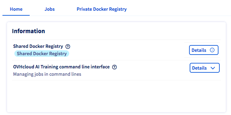

Pushing our image to a registry is needed in order for AI Training to pull it.
AI Training provides, for each Public Cloud project, a default registry called shared registry where all users of a same Public Cloud project are able to push their custom images.
This shared registry can help you perform your tests, but should not be used in production, as we reserve the right to delete its content if deemed necessary. The images pushed to this registry are for AI Tools workloads only, and will not be accessible for external uses. This is why it can be interesting to add other registries. Learn how to do it by following this documentation.

If you want to know the exact commands to push to your shared registry, please consult the lower part of the Docker registries tab of the Configuration page (AI Notebooks, AI Training or AI Deploy): select a region to display the Registry URL and the commands to log in, tag and push an image.
