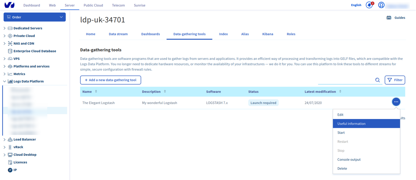

Exploit a dedicated Logstash Data-Gathering tool

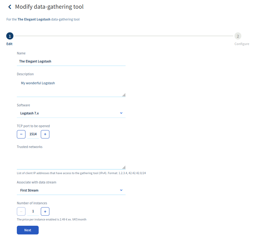

Once you have activated the tcp or http logs of your HAProxy instance, you must then send them and transform them. For this part of the tutorial you will need your own dedicated Logstash collector. Logstash is one of the most powerful tool to transform logs. Create a Logstash data-gathering tool as described in the Logstash tutorial, and configure the port 1514 (or the port of your choice) as the exposed port.
edit\_logstash
Logstash collector configuration
As you may guess we have to configure the Logstash collector with some clever Grok filters to make the collector be aware of our field naming convention. The collector will accept logs in a generic TCP input and use grok filters to extract the information. Thanks to the wizard feature, you won't even need to copy and paste the following configuration snippets, but they are still given for reference purpose.
Here is the Logstash input configuration:
tcp {
  port => 1514
  type => haproxy
  ssl_enable => true
  ssl_verify => false
  ssl_extra_chain_certs => ["/etc/ssl/private/ca.crt"]
  ssl_cert => "/etc/ssl/private/server.crt"
  ssl_key => "/etc/ssl/private/server.key"
This configuration should be familiar, we set the port, the ssl parameter and the ssl configuration with our provided certificates. Let's continue with the filter part. The custom grok used will be described hereafter:

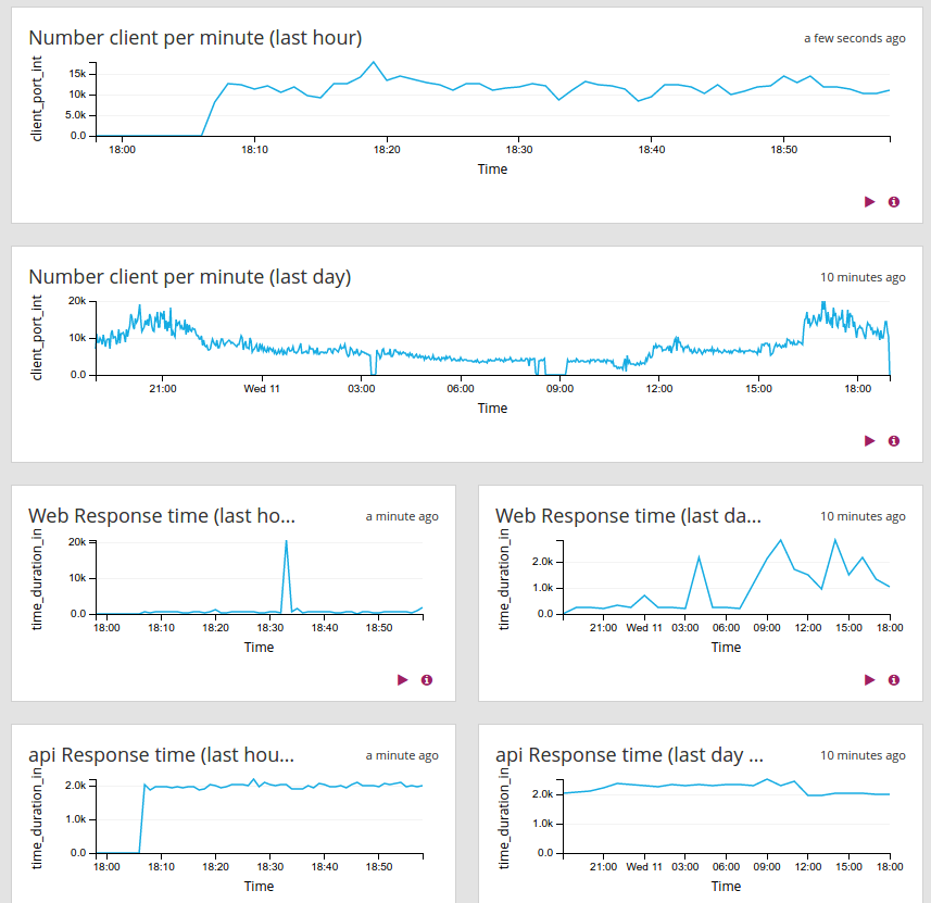

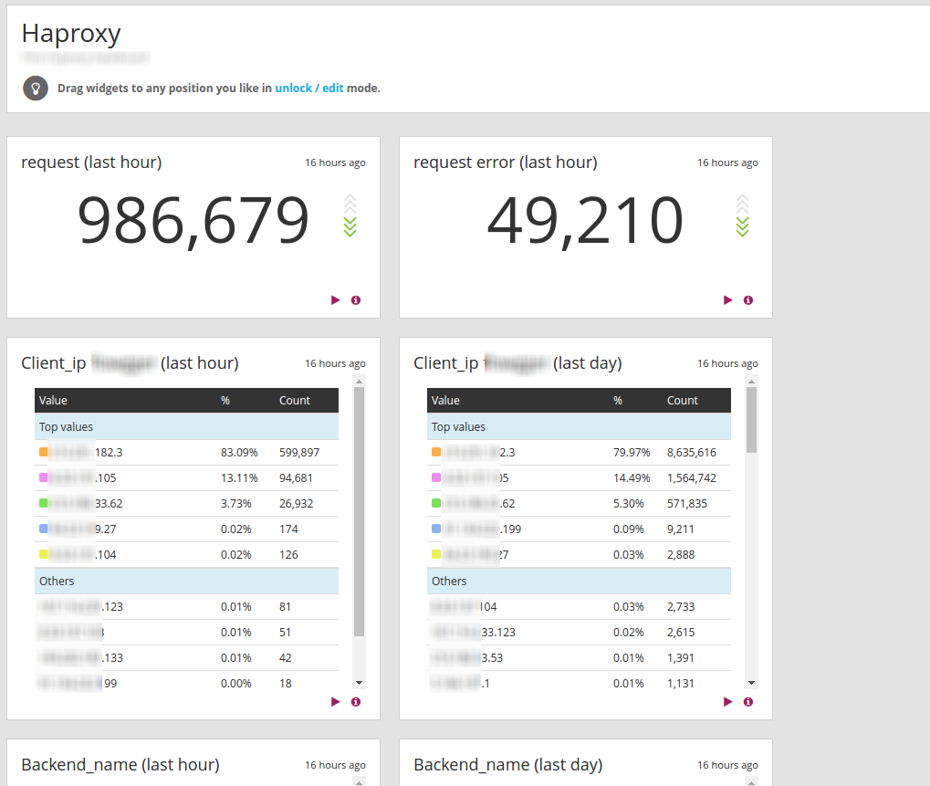

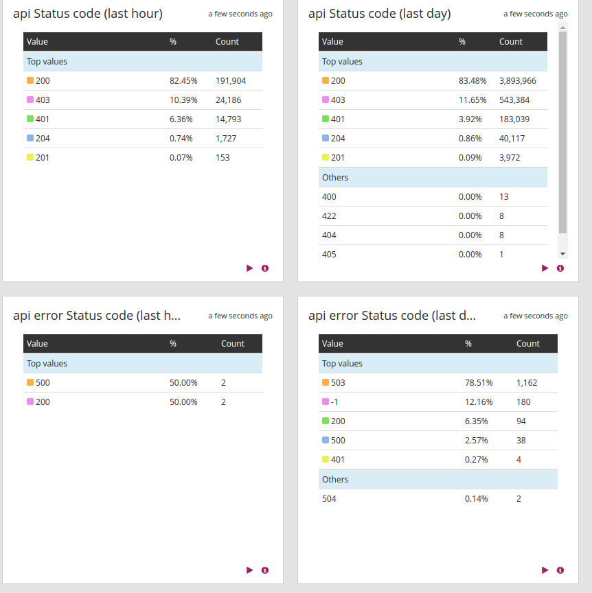

Dashboard and alerts
Here is an example of a dashboard that you can craft from the HAProxy logs. HAProxy logs give you a lot of information about your application and infrastructure. It's up to you to exploit them in whichever way suits you best. You can also configure some alerts to warn you when a backend is down or is not responding properly.
dashboard\_1 dashboard\_2 dashboard\_3
