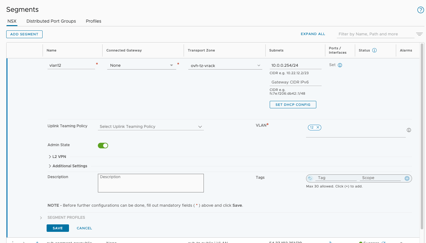

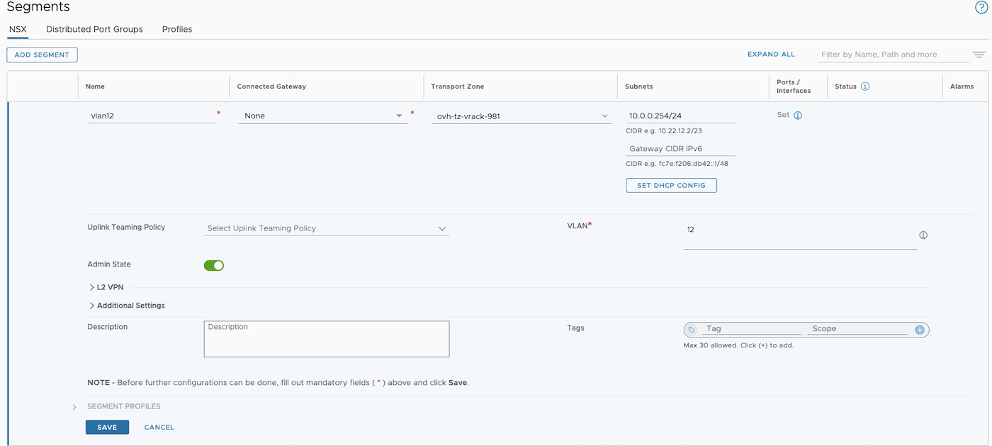

Segment Creation
In the Segments > Add Segment section, create a segment in the transport region ovh-tz-vrack on VLAN 12. Assign any IP address to the gateway, as we do not intend to use it.
De
UK
SegmentCreationDE

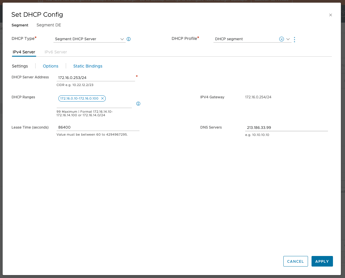

Overlay Segment

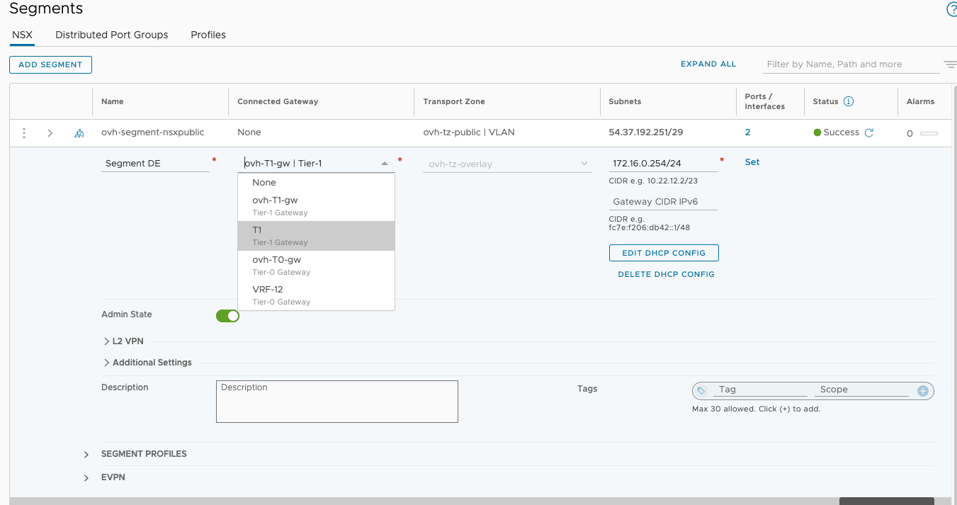

Create an overlay segment in the location where we plan to deploy our virtual machine. Use 172.16.0.254 (DE) or 192.168.0.254 (UK) as the gateway IP address on this segment. Optionally, configure a DHCP server to simplify deployment, although this is not required. Please note that we are currently connecting our segment to the ovh-T1-gw T1, but this configuration will be modified later.
DE
UK
OverlaySegmentDEOverlaySegmentDE2

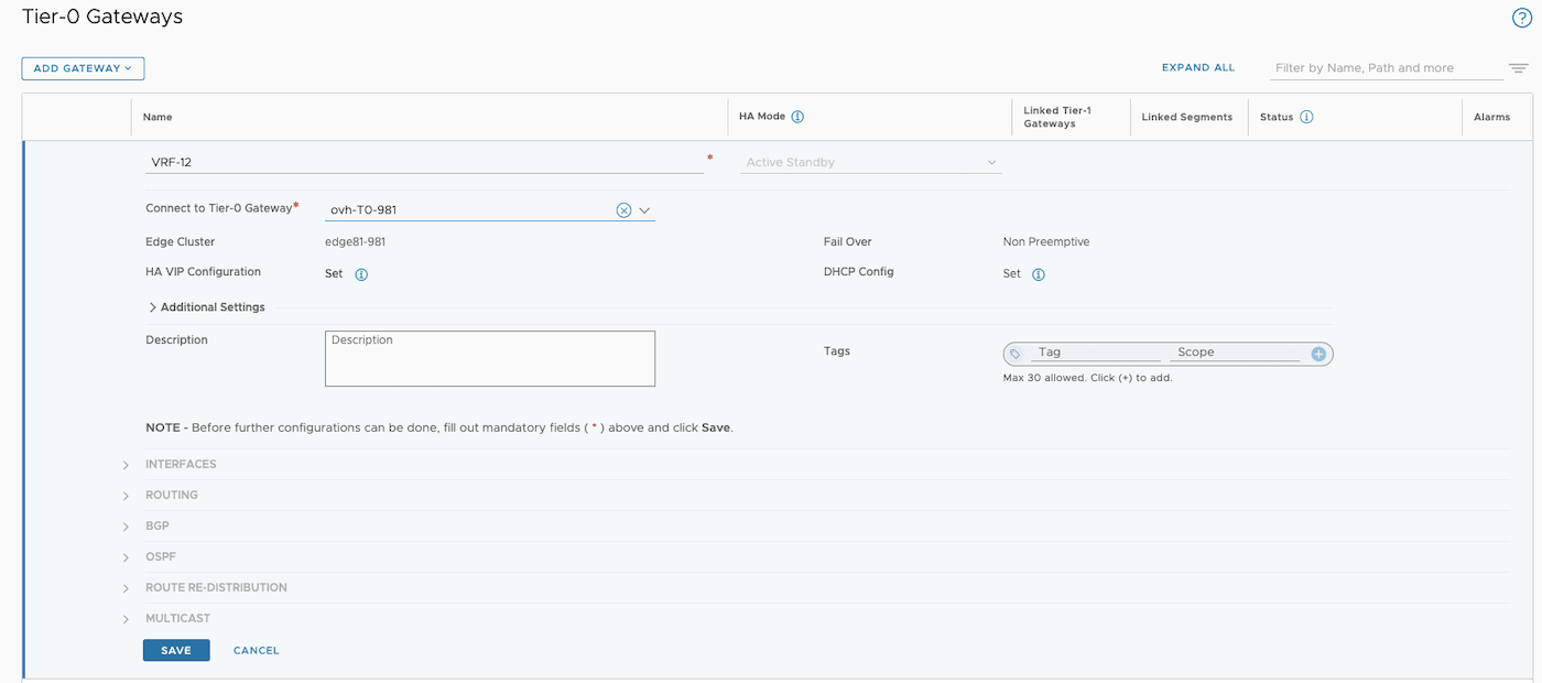

VRF Creation DE

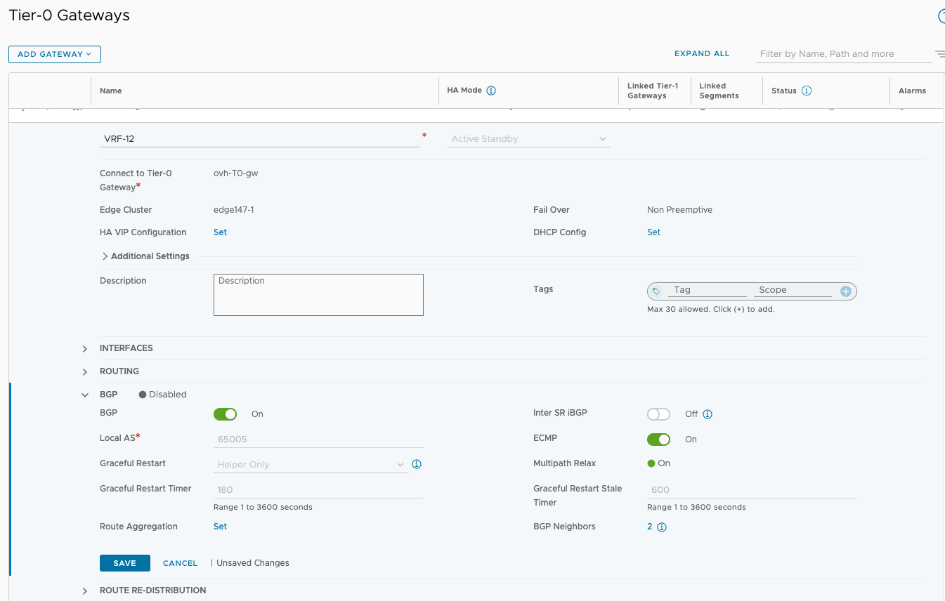

1. To create a Virtual Routing Firewall (VRF), go to Connectivity > Tier-0 Gateways > Add Gateway > VRF.
DE
UK
VRFCreationDE
2. Name your VRF as needed and connect it to the gateway ovh-T0-gw, save and continue the configuration.
DE
UK
VRFCreationDE2VRFCreationDE3

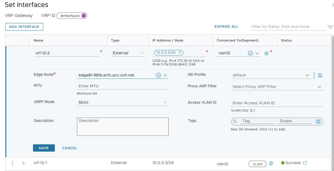

3. Configure two interfaces, one for each edge. Choose two free addresses from your VLAN IP range (for example, we will take 10.0.0.1/.2/.3/.4), then connect them to the VLAN12 segment you have created.
DE
UK
VRFCreationDE4VRFCreationDE5
4. Verify that your two interfaces are created and that their status is in Success (section Tier-0 Gateway).
DE
UK
VRFCreationDE6

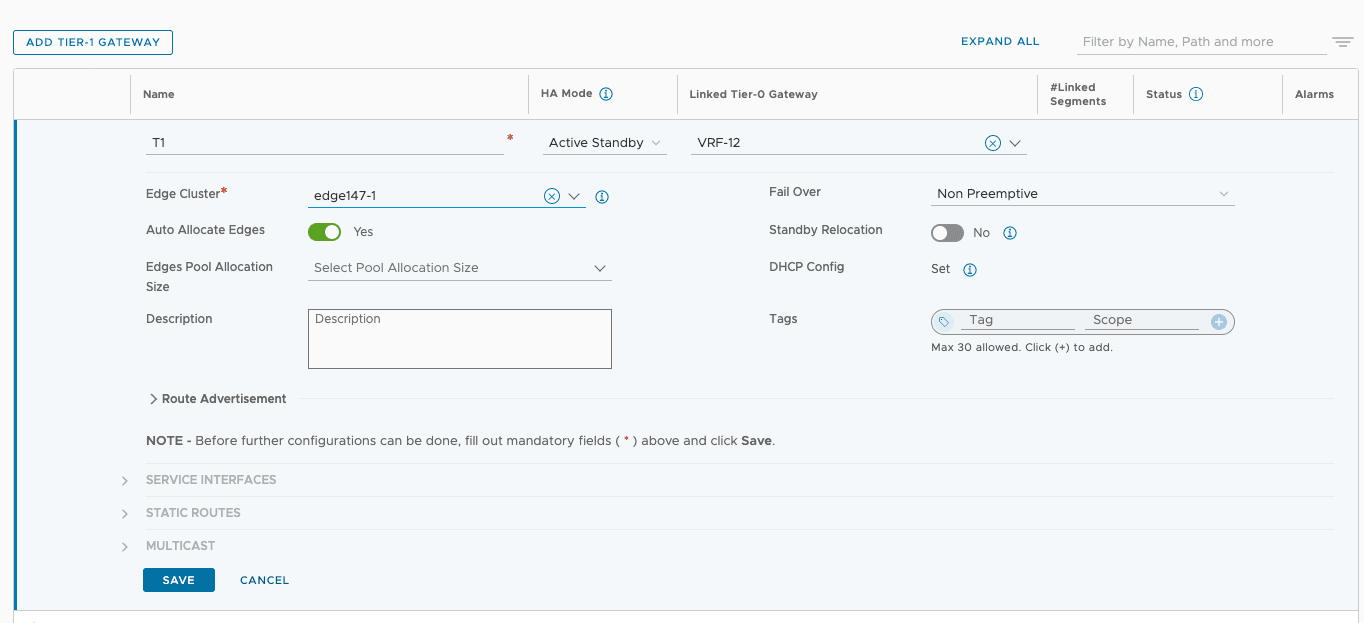

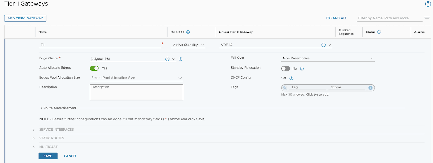

T1 Creation
In the Tier-1 Gateways > Add Tier-1 Gateway section, create a new T1 gateway. Choose a name that suits your needs, then connect it to the VRF you have created and finally, connect it to your Edge cluster.
DE
UK
T1CreationDE
Connection Segment & T1
Change the DE Segment you just created and change the gateway GW to T1.
You should get that result:
DE
UK
ConnectionSegmentT1DE.
ResultSegmentDE

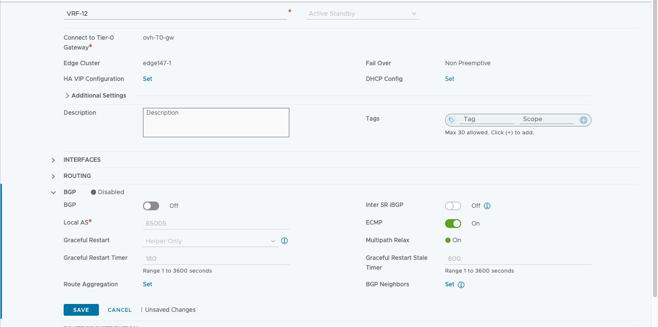

VRF configuration
Still on your VRF edition, enable BGP and add the environment to attach.
DE
UK
UPBGPDEBGPNeighborsDE

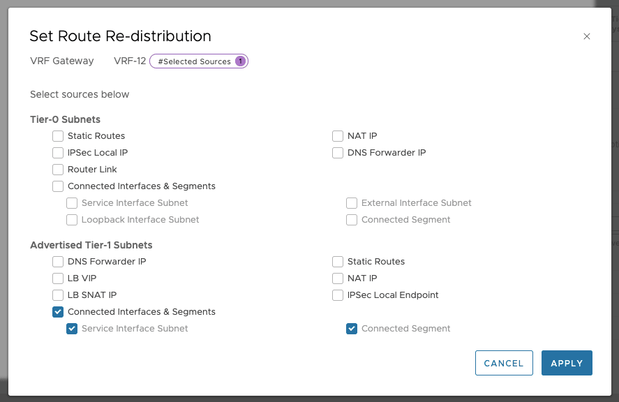

Configure a route redistribution
You need to redistribute the routes of the connected segments. To do this, go to the Route Redistribution section of your VRF (below that of the BGP).
BGPRouteRedistribution
Add a redistribution route rule that will be connected to your T1 segment.
DE
UK
BGPRouteRedistributionDEBGPRouteRedistributionDE2BGPRouteRedistributionDE3

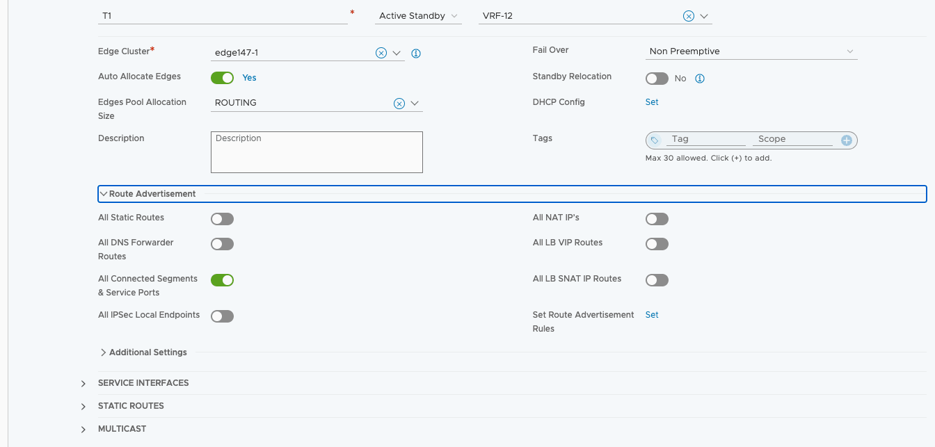

On your T1 Gateway
In the Route Advertisement section of your T1 gateway, authorize All Connected Segments & Service Ports.
DE
UK
RouteAdvertisementDE
