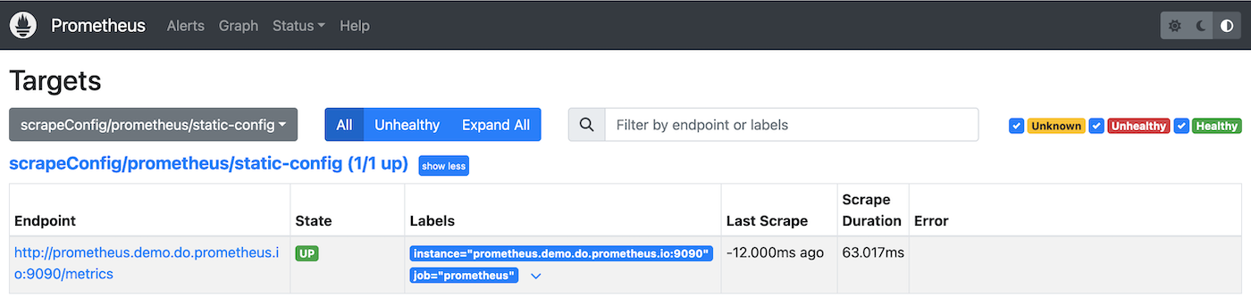

It could take a couple of minutes before reloading the Prometheus configuration automatically.
After a few minutes, by checking the Prometheus targets HTTP interface, you should be able to observe something like this inside the Prometheus User Interface (UI):
Prometheus static target

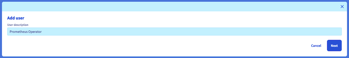

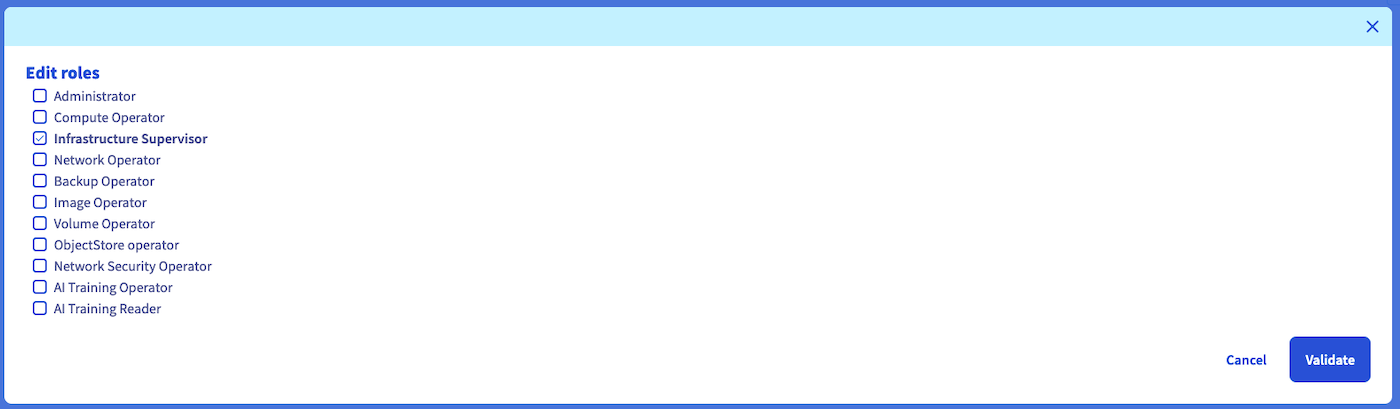

Create a dedicated user inside your Public Cloud project with the Infrastructure Supervisor role (refer to the Managing OpenStack users guide).

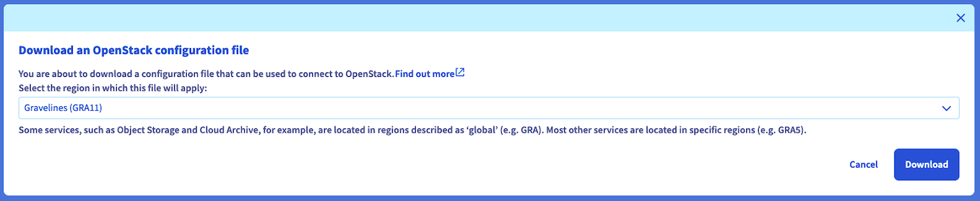

Retrieve your OpenStack user info from the command-line tool (refer to the Setting OpenStack environment variables guide) for the region you want to scrape.
This example uses the GRA11 region.
Download the user's OpenRC file as described in that guide, choosing the region you want to scrape (this example uses GRA11).

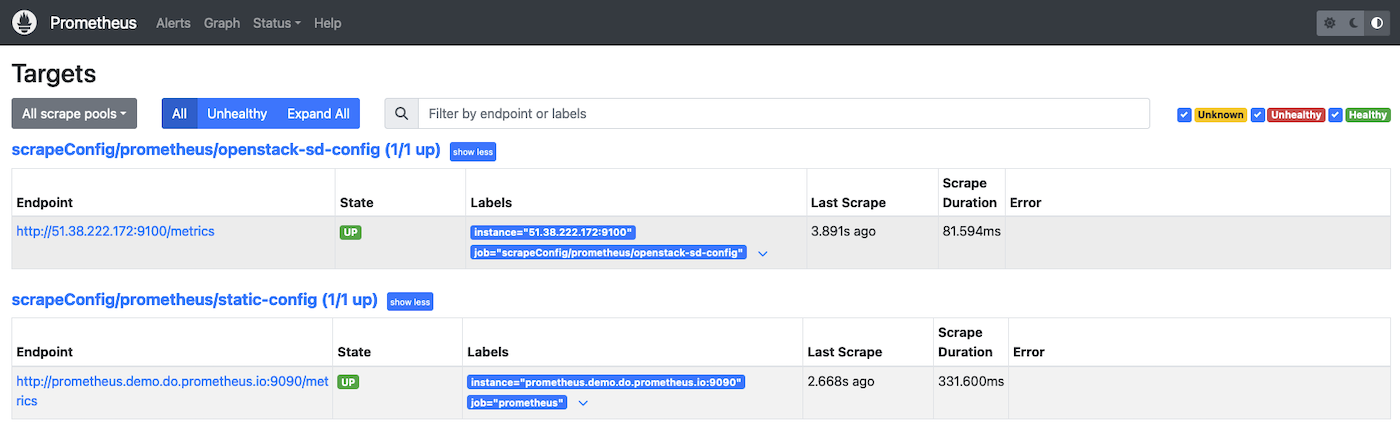

After a few minutes, by checking the Prometheus targets HTTP interface, you should be able to observe something like this inside the Prometheus UI:
Prometheus OpenStack targets

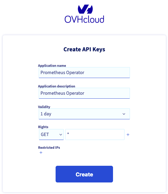

Create dedicated script credentials (as described here). Follow our First steps with the OVHcloud APIs tutorial to generate them via the , then note the application key, application secret, and consumer key — you will need them in the next step.
Important information:
This subject is not covered in this tutorial but you should restrict the API routes the token has access to.

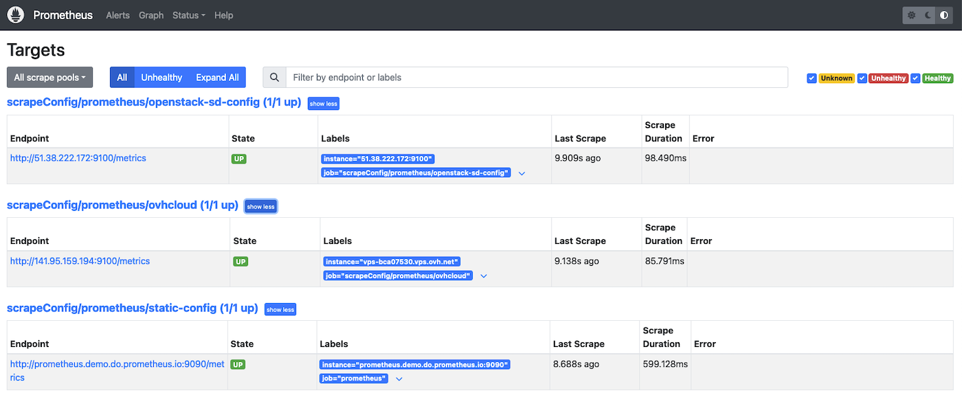

Prometheus OVHcloud targets
