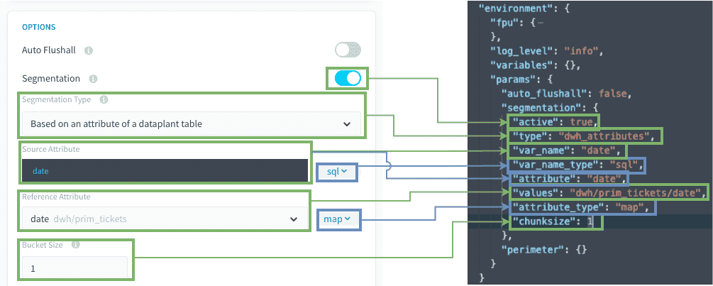

Before going further, here is how the Preferences tab matches with the JSON fields in Advanced mode.
For the sake of clarity, we will use the technical JSON names below.
links
Please note that the blue squares are only used by the UI for clarity. The green parameters are the ones used by the DPE.
Source's attribute / var_name: SQL attribute that will be used for the filtering of the source.
Reference Attribute / Values: The address from where the set of values is taken. must be formatted as "dwh/TABLE_NAME/ATTRIBUTE_NAME" if from a dataset table. or "dwh/SOURCE_NAME/TABLE_NAME/ATTRIBUTE_NAME" if from a source.
Bucket size / Chunksize: Number of values to be filtered for each task.
