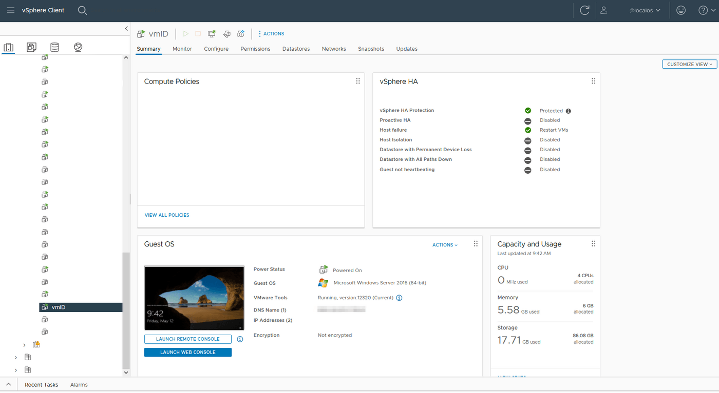

First, connect to your vsphere and select the VM from the list of VMs in the left tab:
select VM

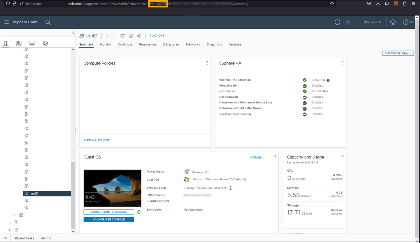

Once done, you can retrieve the vmId from the URL:
retrieve vmid

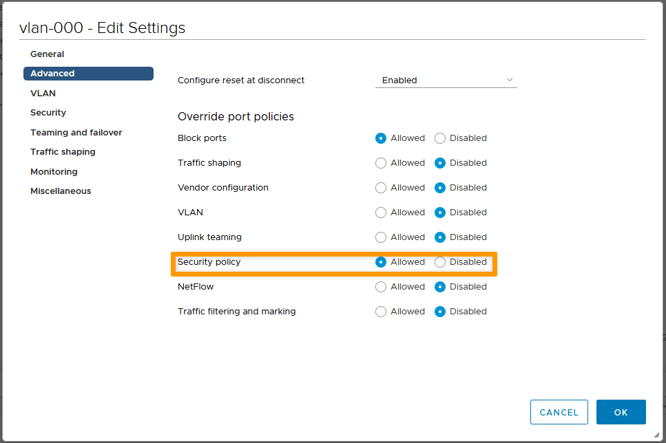

To begin, you need to check that the DVS allows the possibility of having a different configuration on the port (by default the DVS one is applied).
To do this, right-click on the portgroup, click Edit Settings, then on Advanced and check that the Security Policy line is set to Allowed.

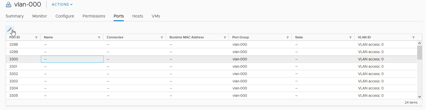

You can then select the port where the VM is connected and click on the pencil icon at the top left.
port

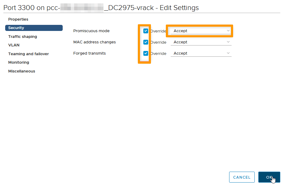

In the Security section, check Replace and change the security policy to Accept for all three options, if it is not already the case.
