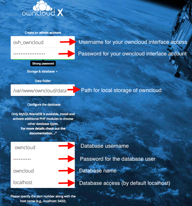

Step 2: Fill out the form
Just fill out the form that appears on your screen, as in the annotated example below:
Setup screen
You have now installed ownCloud on your OVHcloud Public Cloud Instance!
