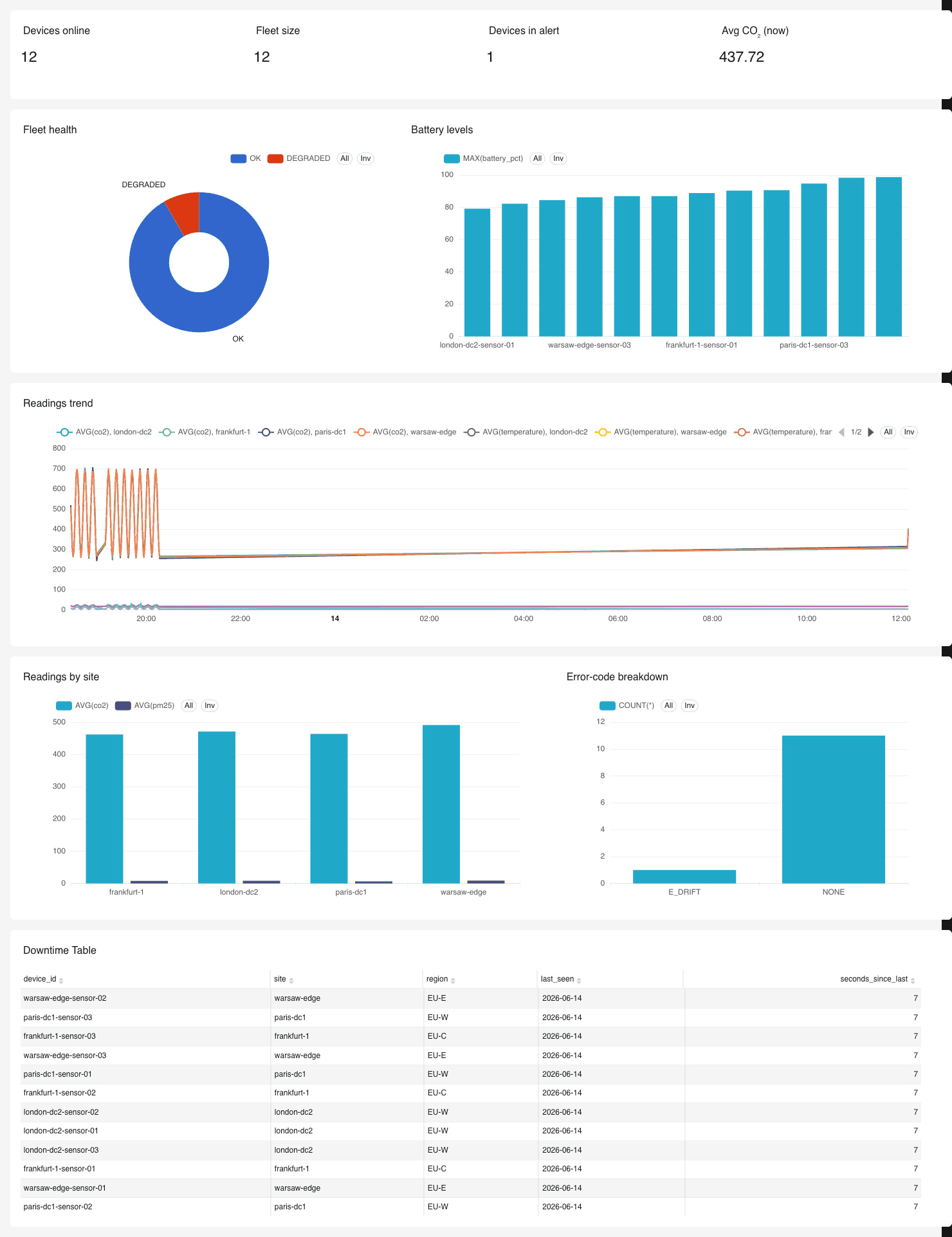

Step 7: Build the dashboards
The finished dashboard is a single-screen view of the whole fleet.
IoT fleet-monitoring dashboard
A practical set of panels:
PanelChart typeWhat it shows
KPI rowBig NumberDevices online, fleet size, devices in alert, average CO₂ now
Fleet healthDonutLive status split across the fleet
Battery levelsBarPer-device battery, lowest first, for predictive maintenance
Readings trendLine (time-series)CO₂, temperature, PM2.5 over time, per site
Readings by siteBarAverage CO₂ and PM2.5 compared across sites
Error-code breakdownBarWhich fault types are occurring
Downtime tableTableDevices whose latest reading is stale, highlighted
For the full virtual datasets and the exact Trino SQL and configuration of every panel, follow the companion page:
Build the Superset dashboards
A few Superset tips that save time:
  • On bar charts, put the category in the X-axis and leave the Dimensions box empty. Dimensions is only for splitting each bar into sub-series.
  • Threshold lines, such as a battery warning level, are available on time-series charts through annotation layers. On a categorical bar chart, sort ascending instead. On a table, use conditional formatting.
  • CO₂ values (around 480) dwarf temperature (around 21) and PM2.5 (around 9) on a shared axis. Chart CO₂ separately, or use a secondary axis, so the small metrics stay readable.
  • The downtime table is empty when the fleet is healthy, which is correct. Build it without a filter so it lists every device, then highlight stale rows with conditional formatting, so the panel never looks broken.
