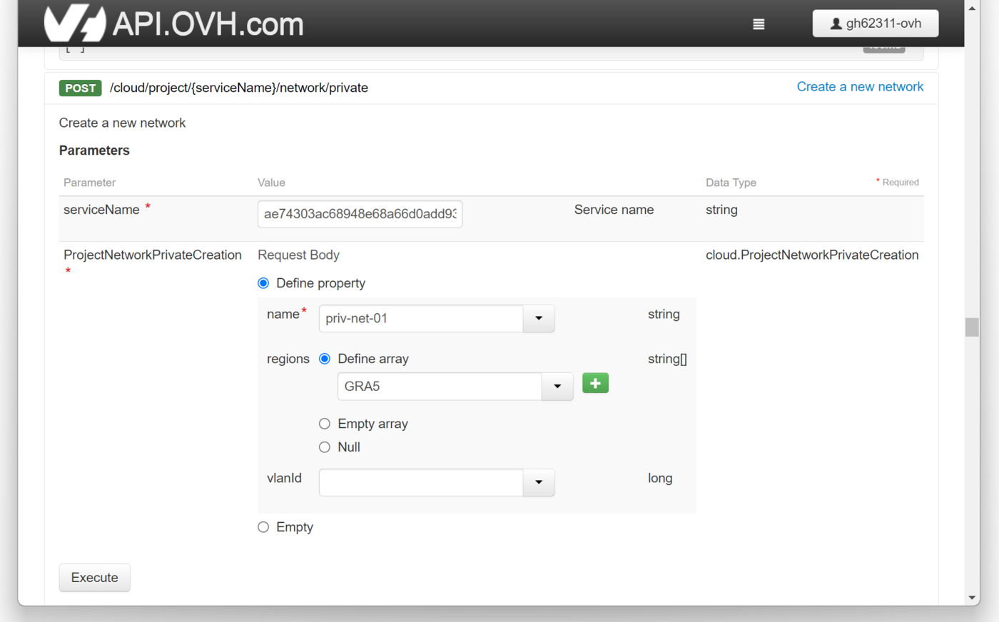

Once we have created a vRack, we need to create two different Private Networks enabled at least on the region of our cluster (GRA5 in our example). The private networks created via the OVHcloud Console have default ranges that cannot easily be modified. We are thus creating the private networks using the .
For this example we are creating two private networks, priv-net-01 & priv-net-02, with DHCP subnets with ranges of 10.0.1.0/24 et 10.0.2.0/24.
We will use the following endpoint to create the private networks:
For example, to create priv-net-01, set the request body to:
  "name": "priv-net-01",
  "regions": ["GRA5"]

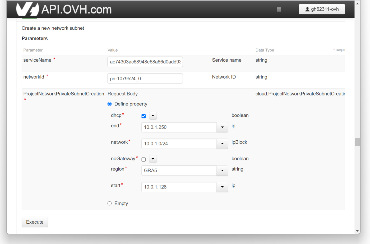

And then we assign them the subnets using this endpoint, with the network ID returned by the previous call as the networkId path parameter:
  "dhcp": true,
  "network": "10.0.1.0/24",
  "start": "10.0.1.128",
  "end": "10.0.1.250",
  "region": "GRA5",
  "noGateway": false

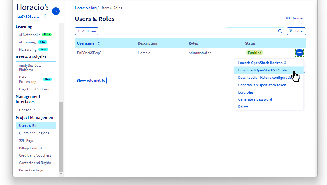

Retrieving the Openstack configuration file

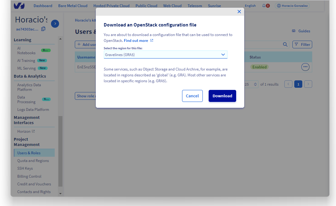

Now we need to download the openrc.sh configuration file, as explained in the Setting OpenStack environment variables guide.

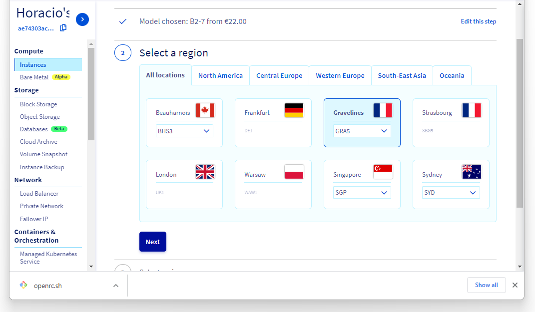

We will be working in the GRA5 region, so we select it when downloading the file.
Following the steps on the Setting OpenStack environment variables guide to be sure that the Openstack CLI is working on our workstation.

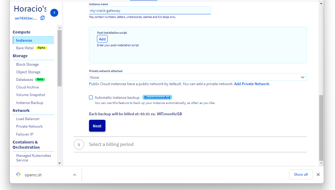

Now we are going to create a Public Cloud instance in GRA5, to act as a gateway for our vRack.
We are going to create an Ubuntu instance.
We do NOT attach the instance to a private network yet, as you can unfortunately configure only one private network at the creation stage in the OVHcloud Console.

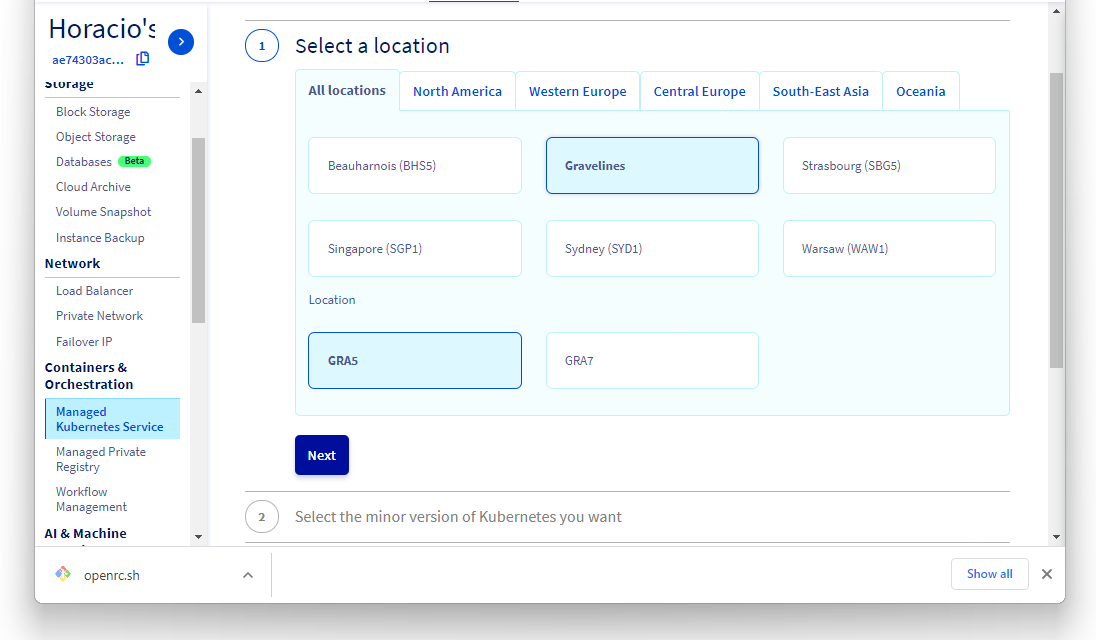

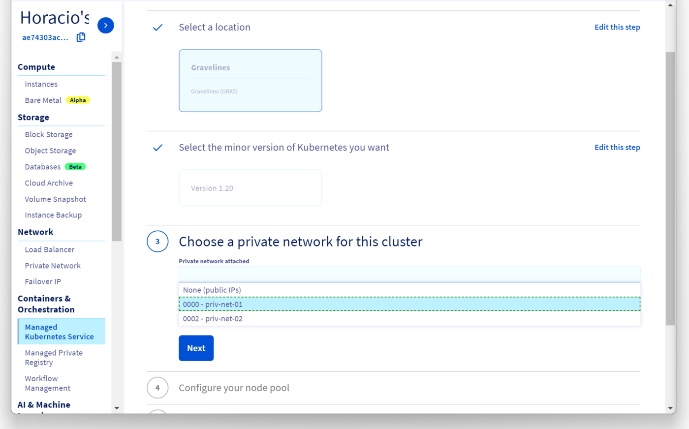

Setting up the Managed Kubernetes attached to priv_net_01
Then we create a Kubernetes cluster in GRA5 region, attached topriv_net_01, as explained in the Create a cluster guide.
Integrating a cluster into a vRack Private Network must be done when creating the cluster, in the Network settings section, where we can choose an existing private network and subnet for the cluster.
Our new cluster will be created inside priv_net_01.

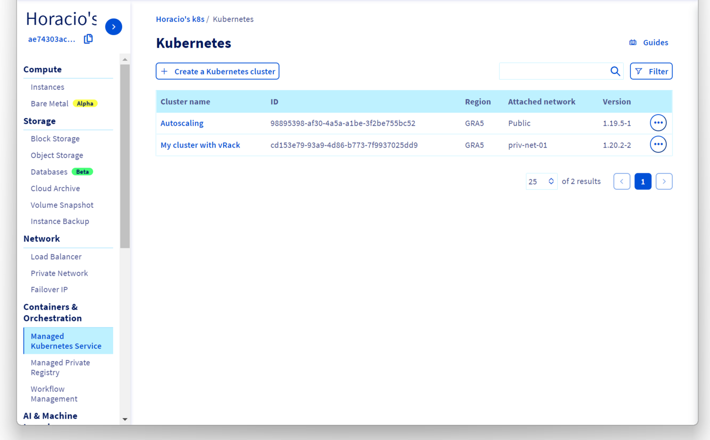

Once the cluster is created, click its name in the Managed Kubernetes Service list and open its Network tab: it shows the chosen private network.
Don't forget to grab your kubeconfig and configure kubectl to use it, as explained in the Configuring kubectl on an OVHcloud Managed Kubernetes cluster guide.

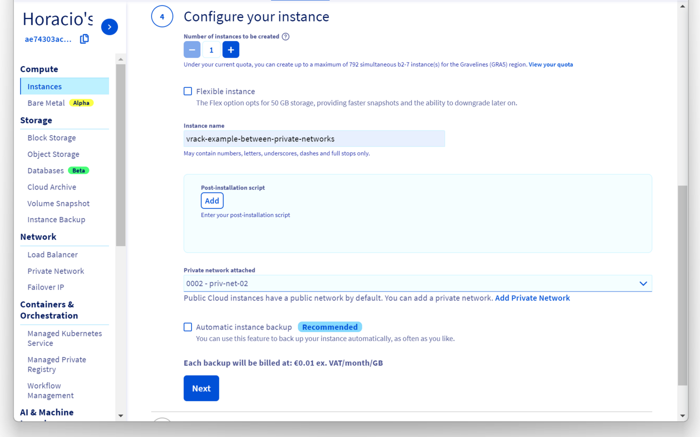

Setting up a PCI attached to priv_net_02

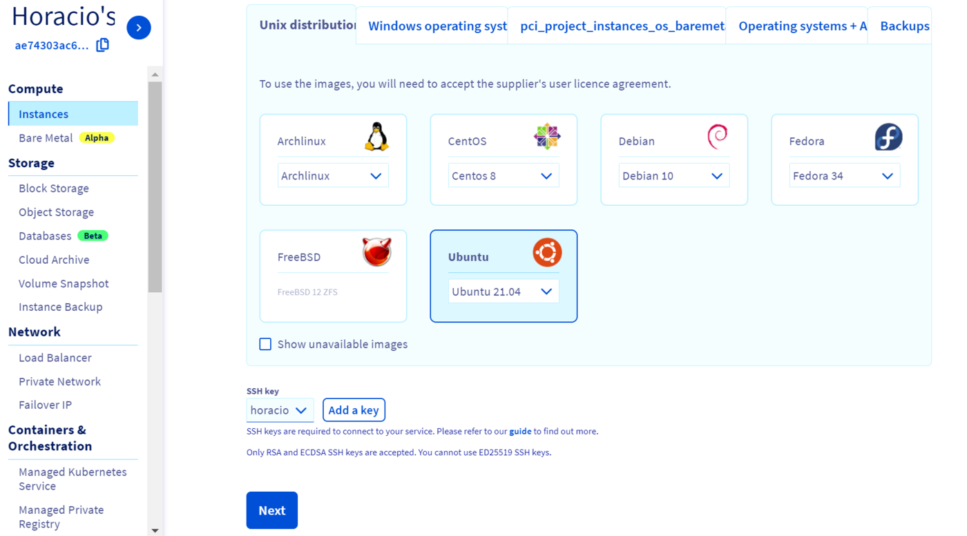

Now we can create a new Public Cloud instance, also in GRA5 region, and attach it to priv_net_02 by following the Integrating an instance into vRack guide.
In the instance creation page, we call it vrack-example-between-private-networks and, in the Network settings section, we attach it to priv_net_02.
After the instance creation, the connection details are displayed in the Connection details card of its Overview tab in the OVHcloud Console.
If we log in to the instance using SSH, we can see that it has two network interfaces, one attached to the public IP address we use to log in, the other attached to the private network:
