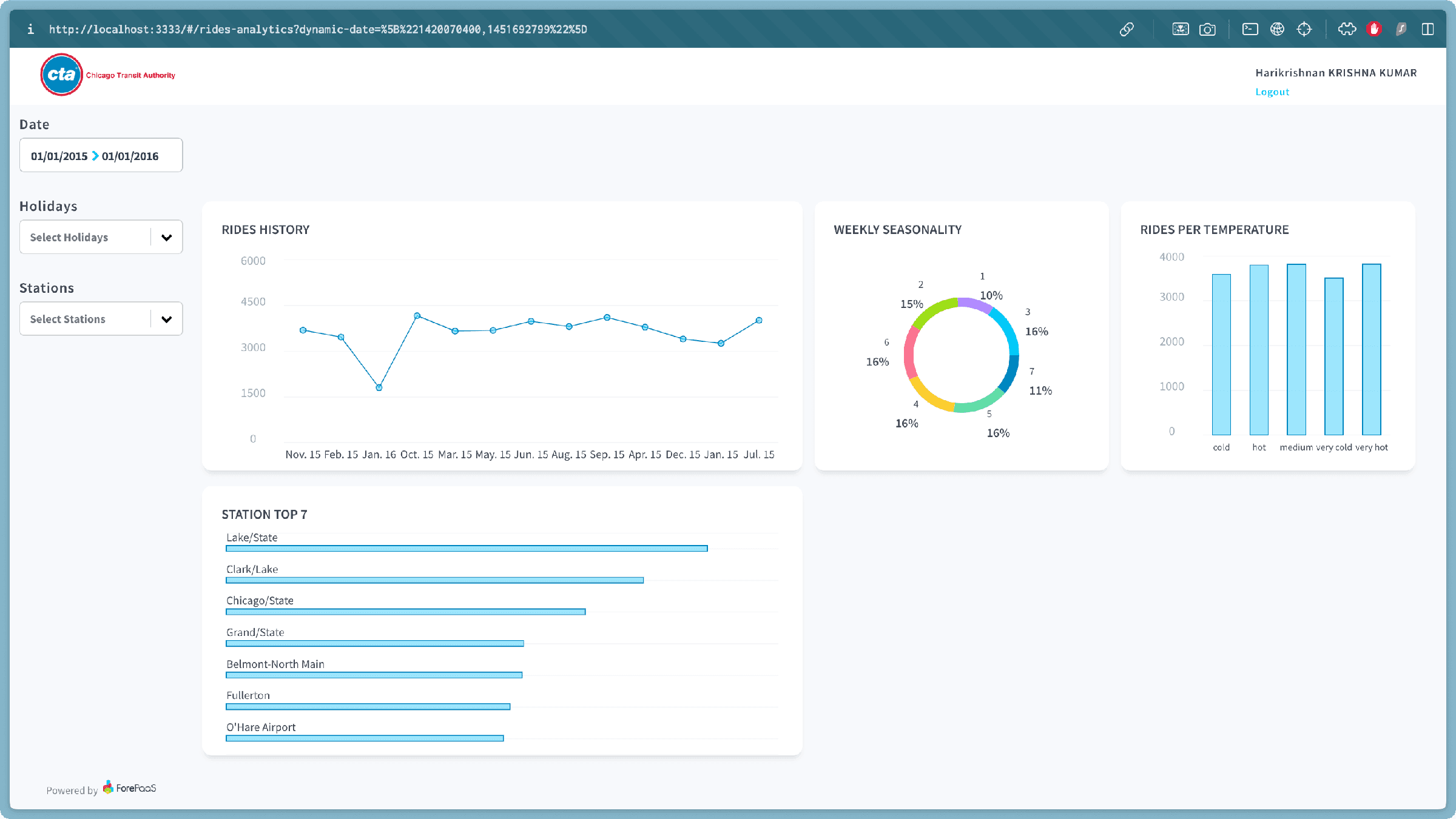

You have now a complete application. Your app tree should look like this:
├── config
├── node_modules
├── forepaas
├── public
├── scripts
└── src

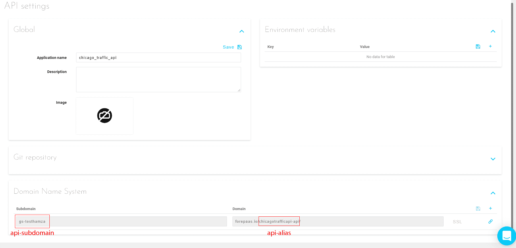

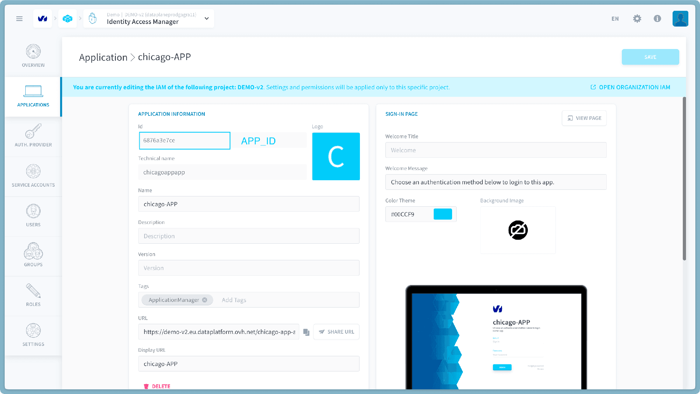

There are three variables that you need to replace:
  • {api-subdomain} : Log into the platform, go to your API settings, this variable is referred to as the "Subdomain" in the Domain Name System panel
  • {api-alias} : This variable can be extracted from the "Domain" by removing eu.dataplatform.ovh.net/

  • app_id : Go to the Identity Access Manager page. In the Application tab, go to edit your app. This variable is referred to as "Id" in the application information.
alt text
Remember that it is necessary to modify authentication privileges to allow to fetch your online data from your local build. Do it by adding your local host (http://localhost:3333 by default) to the CORS origin in Identity Access Manager > Settings > CORS origin > Add.

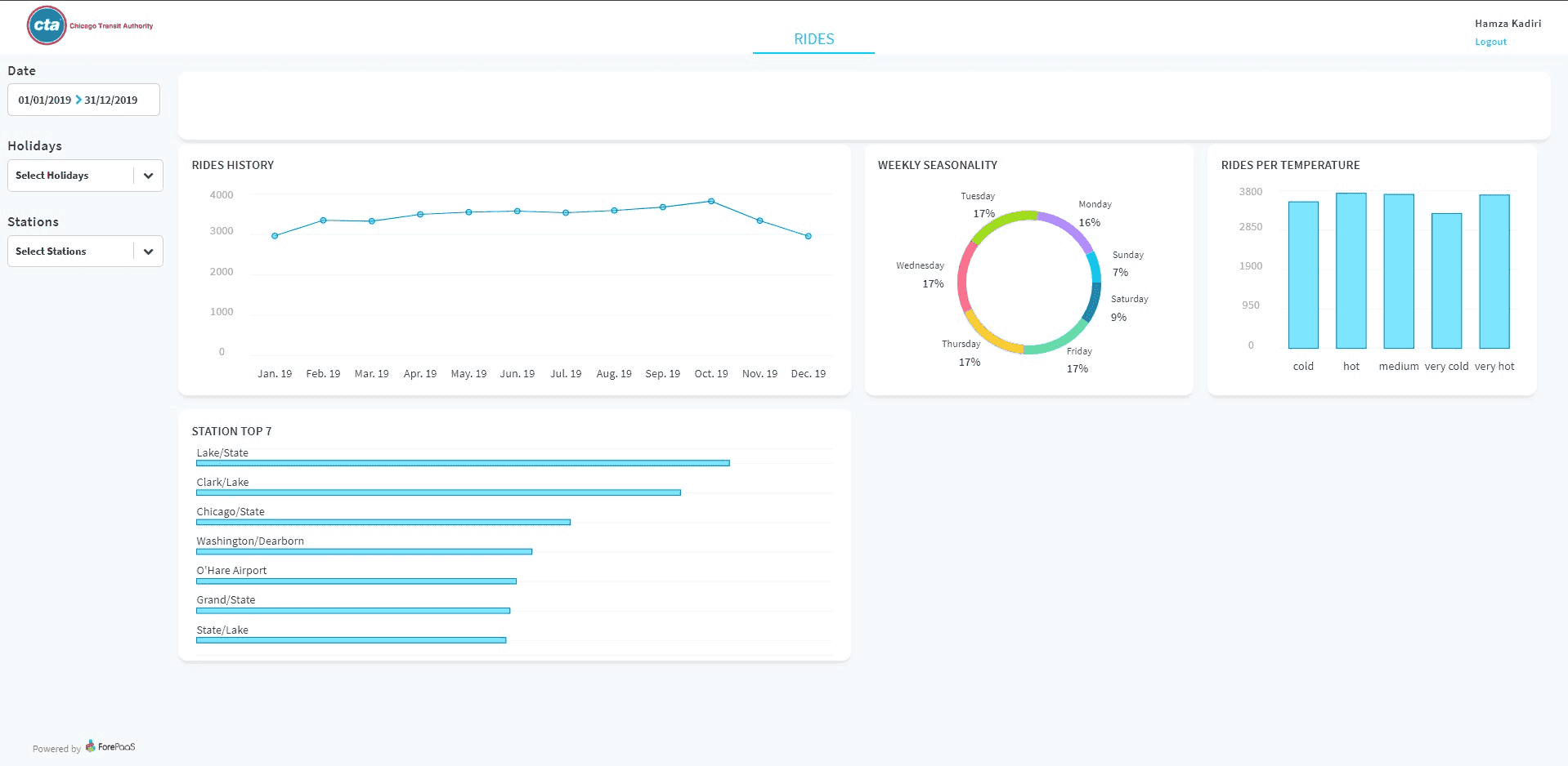

Save all files. The locally running app now displays a bit more of an advanced view of what you had at the end of the Getting Started guide.

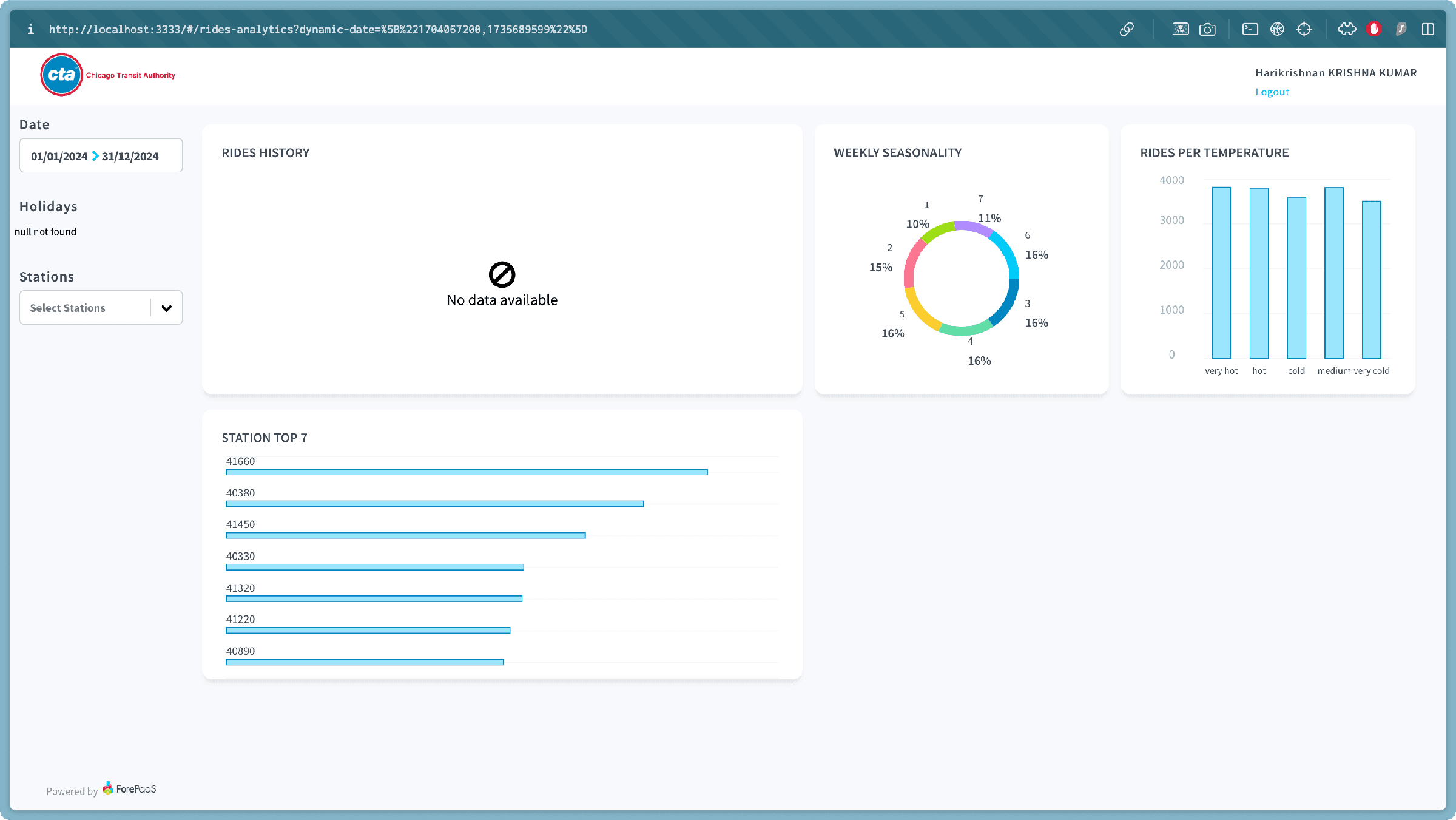

The following image shows how it will look on the first start after configuring the global-override.json but as you can see there seems to be an issue with the holiday select box and the rides history data display. The following section explains how to resolve these problems.
alt text
Add the cat_holiday attribute to your API
You may notice that in the sidebar the holidays selector isn't displayed correctly. That is the case because you have no exposed attribute related to holidays as part of the getting-started guide.
In the app template provided to you, that attribute is named cat_holiday. We encourage you to try to understand why this problem appears by looking into the sidebar.json file for mentions of the dictionary name.

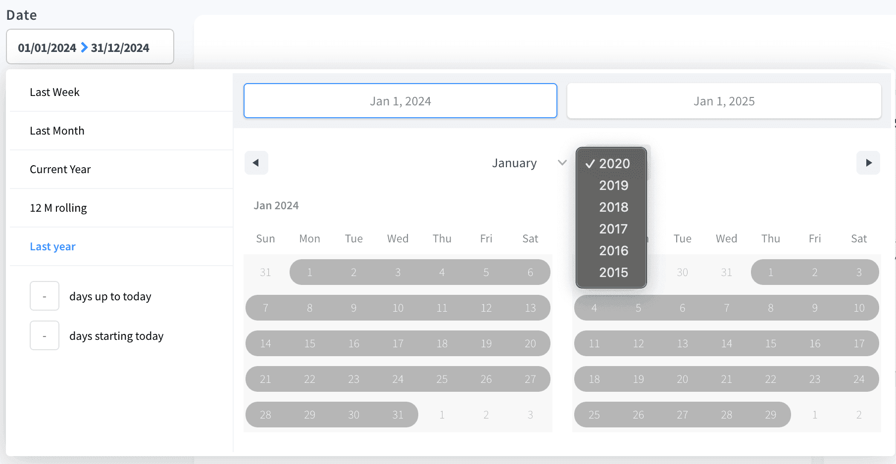

Edit the range of the date-picker in sidebar.json
The reason the rides-history chart shows "no data" is that the date-picker is not set to match the dataset’s actual range. Currently, the sidebar’s date-picker only displays a date range from today to one year ago because of its configuration. Since our Chicago files dataset covers the years 2015 to 2020, we need to update the sidebar.json file by modifying specific fields to ensure the date-picker includes the full range of our data.
alt text
To address this, you have to:
  • go to sidebar.json
  • find the fields for startAt, minDate, maxDate, endAt.

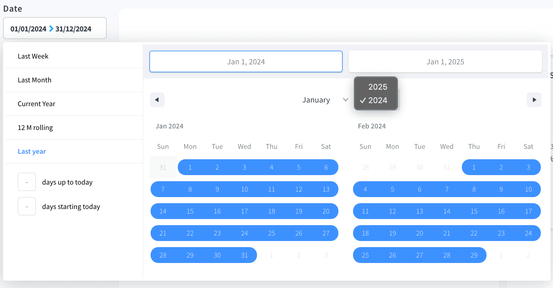

"startAt": "2015-01-01",
"minDate": "2015-01-01",
"maxDate": "2020-12-31",
"endAt": "2020-12-31"
Now, just save and rerun your app and the data-picker should be having the range between 2015 and 2020.
alt text
Now that the date picker is fixed, let's test it out! Select a range, for example, from January 1st, 2015, to January 1st, 2016.
You should now see the rides-history chart populate with data. If the chart looks scattered or incorrect, it's probably because the data isn't ordered by date. To sort this, open rides-analytics.json and add the following snippet to the rides-history request definition:

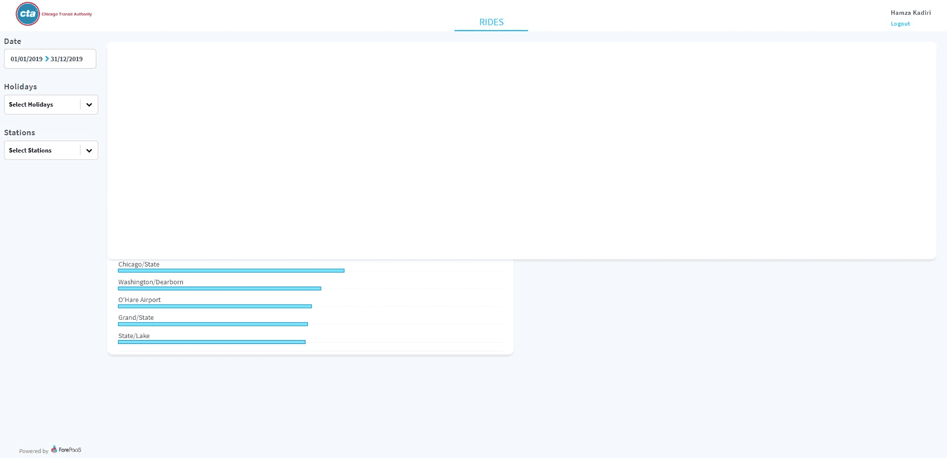

After adding the panel, the application looks like this:
alt text
Now, edit the panel to reduce its height by changing the value of sizeY to 19.
After that, move all the other panels to the bottom by changing the value of row for each of them. Add 20 to the current value to push down the other panels.
alt text

The layout of your rides analytics page is now ready.
Now we'll learn how to add a new dashboard to our application.

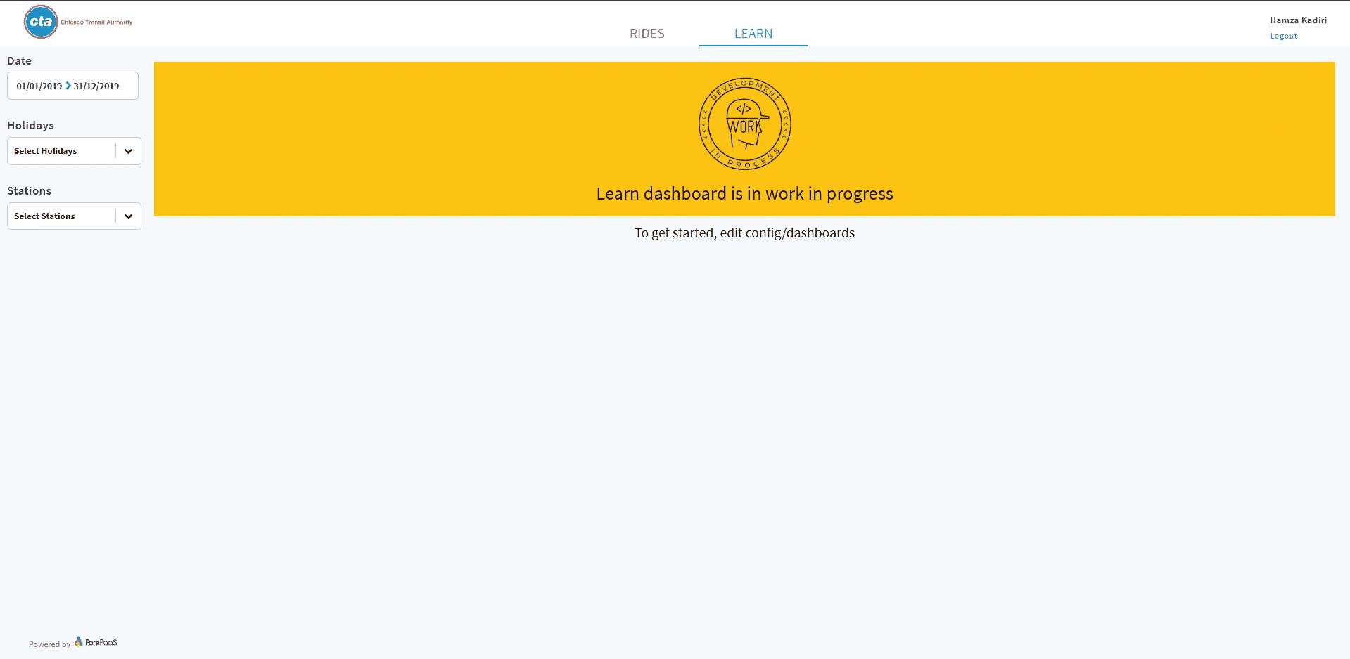

Generate a dashboard
To generate a new dashboard, create a new json file in config/dashboards.

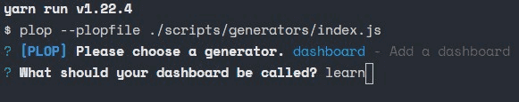

You can speed up the process by using our script
yarn generate
Using the arrow keys choose dashboard, then type the name of your new dashboard ("learn" in this case)
alt text

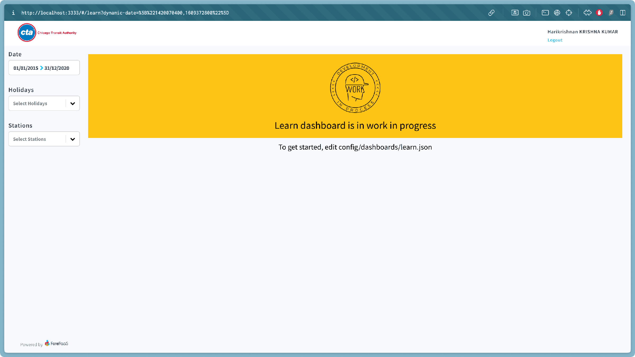

To link your dashboard to your app, edit global.json by adding a new entry in the dashboarding section.
"/learn": "file://config/dashboards/learn.json"
The key represents the url path of your new dashboard.
The value represents the path to the .json file associated with this dashboard.
Your new dashboard page should now be accessible at http://localhost:3333/#/learn.
alt text
As a last step, we will need to enable access to this dashboard from the UI.
To do so, go to config/menus/header.json and add this entry in the items array of the tabs container:
  "type":"link",
  "text":"Rides",
  "url":"/rides-analytics"
  "type": "link",
  "text": "Learn",
  "url": "/learn"
This will allow us to easily switch between the two dashboards we have.
alt text
