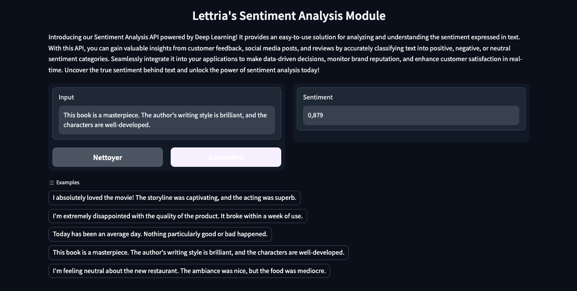

Sentiment
Lettria gives you the possibility to analyze the sentiments of a text. The principle is to automatically classify textual data as positive, negative or neutral based on the underlying sentiment expressed in the text.
Input example:
I love Lettria and OVHcloud!
Output example:
{"type":"positive","score":0.893}
LettriaSentimentExample
To learn more about Lettria's sentiment analysis model, please refer to this documentation.

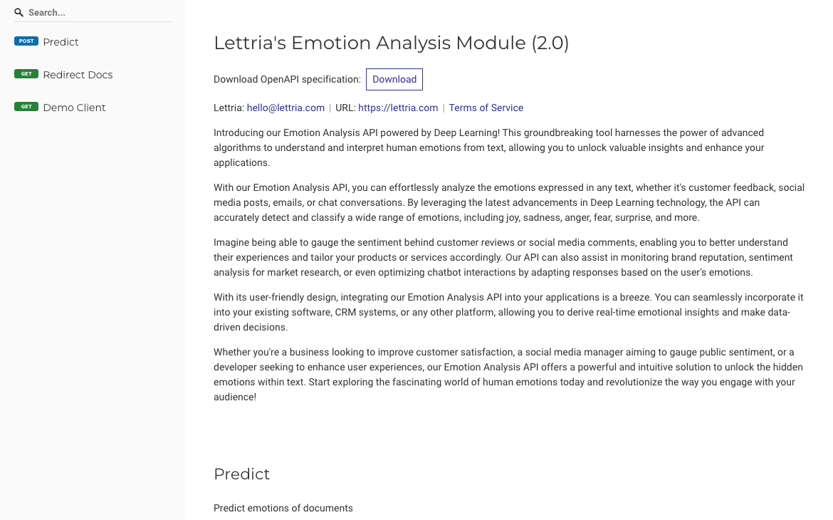

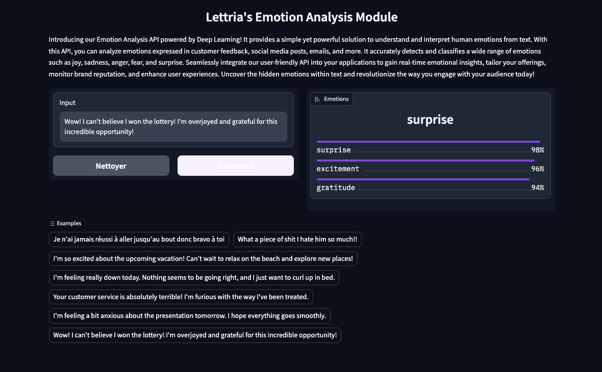

Emotion
Lettria allows you to extract emotion from text data. The goal is to automatically classify text data according to the emotions it conveys: happiness, sadness, anger, fear, ...
Input example:
Output example:
{"type":"love","confidence":0.99}
{"type":"admiration","confidence":0.65}
{"type":"joy","confidence":0.585}
LettriaEmotionExample
To learn more about Lettria's emotion extraction model, please refer to this documentation.

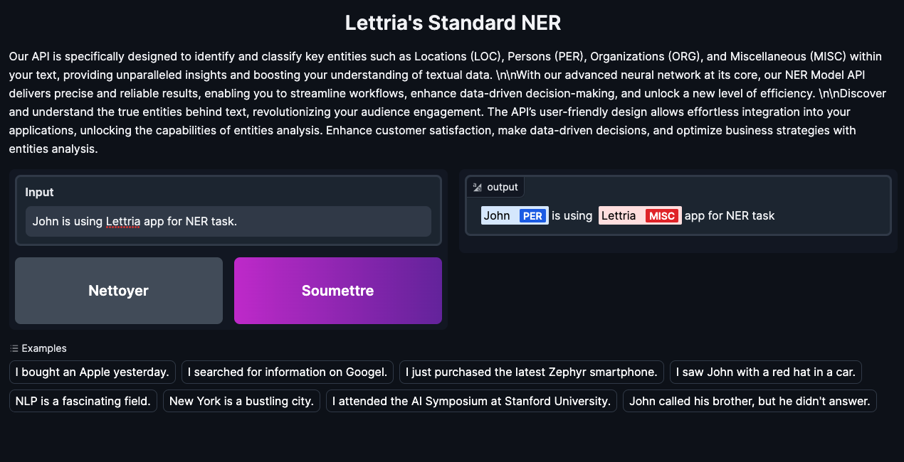

Name Entity Recognition
Lettria gives you the possibility to extract entities from a text. The principle is to automatically identify and classify key entities such as Locations (LOC), Persons (PER), Organizations (ORG) and Miscellaneous (MISC) within a text.
Input example:
John is using Lettria app for NER task.
Output example:
   "predictions":[
            "entity":"PER",
            "score":0.834,
            "confidence":0.673,
            "words":"John",
            "start":0,
            "end":4
            "entity":"MISC",
            "score":0.941,
            "confidence":0.919,
            "words":"Lettria",
            "start":14,
            "end":21
   "analysed_chars":32
LettriaNERExample
To learn more about Lettria's NER model, please refer to this documentation.

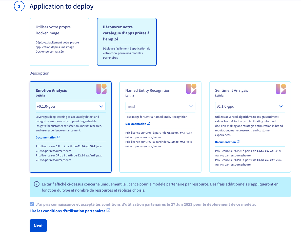

Launch an app from the OVHcloud Control Panel
To launch your Lettria app from the UI, you have to fill in some information:
  • Location
  • Application to deploy - in this example, we choose the "emotions" image with gpu compliance
LettriaDeployment
Please be careful when choosing the image, depending on the required resources.
For a GPU app, choose the Lettria image containing gpu in its tag, then choose one or more GPUs as resources. The same principle of operation also applies for CPU apps.
  • Resources - we advise you to use 1 GPU
  • Configure your app - add a label if you have chosen a restricted access
To know how to launch an app from the , refer to this guide.
