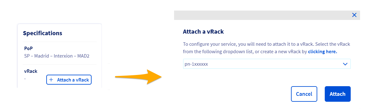

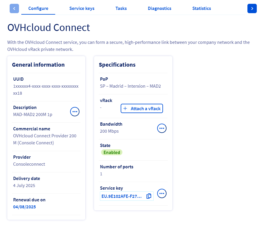

Step 1: Associating a vRack
You will need to link a vRack to your solution first. Click the Attach a vRack button and select an existing vRack from the drop-down menu.
vRack association
A message will confirm the vRack association.
vRack association

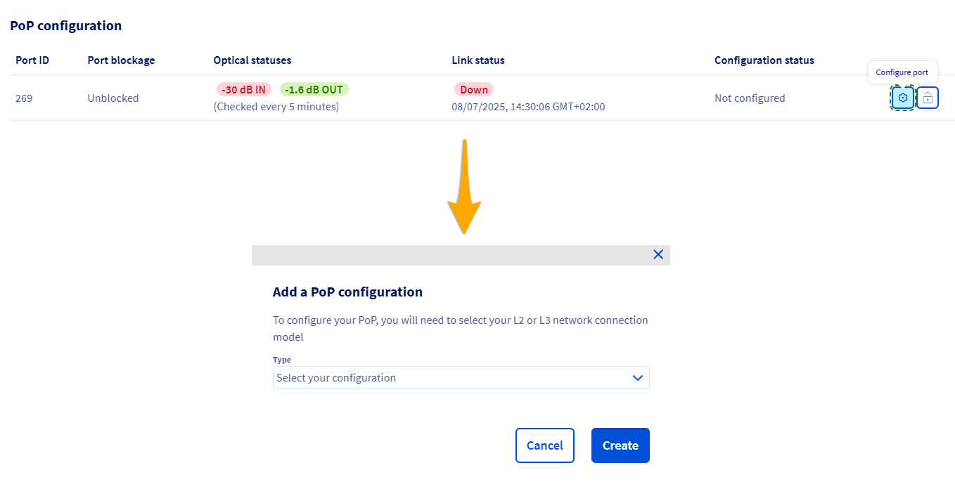

Step 2: Adding a PoP configuration
Changing the PoP configuration from L2 to L3, or vice versa, would require deleting the entire configuration. We advise you to think carefully about your configuration choice before going any further.
For more details on the differences between levels L2 and L3, see our FAQ.
Configuration

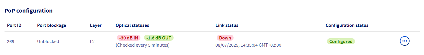

Once you have linked your vRack, two PoP configuration menus will appear. Click the Add a PoP configuration button in the first menu, select L2 from the drop-down menu, then confirm.
adding PoP L2
The L2 configuration will then be enabled in the PoP configuration menu.
adding PoP L2

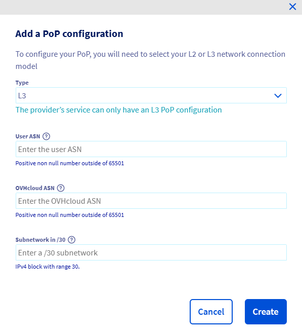

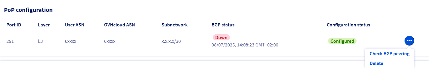

Configuration L3
Once you have connected your vRack, click Add a PoP configuration and select the L3 configuration from the drop-down menu.
adding PoP L3
You will then need to enter the following:
InformationDescription
Customer ASNYour AS BGP number, which is configured on your router located in the PoP
OVHcloud ASNThe OVHcloud AS number that will be configured on the OVHcloud Connect routers located in the PoP
Subnetwork in /30A size /30 IPv4 block, used for the link between your router and the OVHcloud Connect router located in the PoP
adding PoP L3

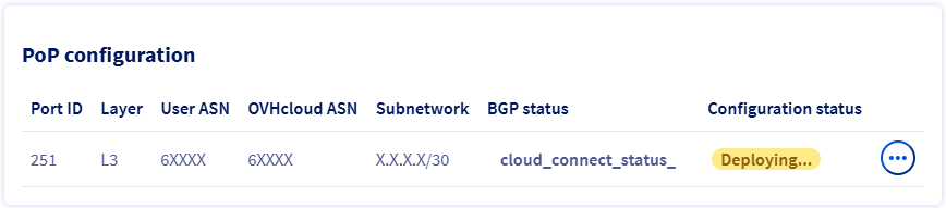

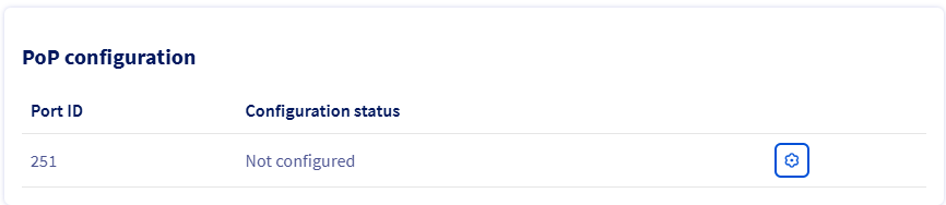

The PoP configuration menu will then appear.
ajout PoP
You can also add a second PoP L3 configuration via the second PoP configuration menu.

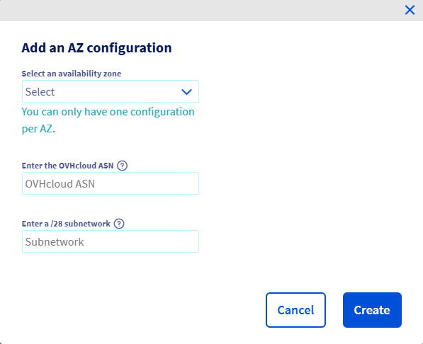

Step 3: Adding an availability zone configuration
Configuration

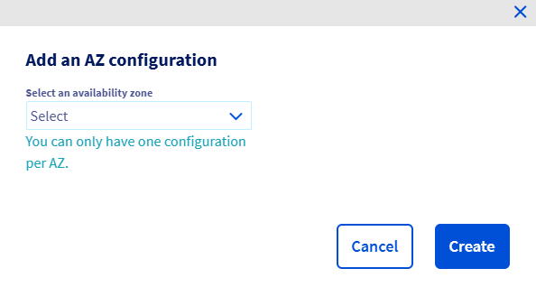

When your PoP configuration is active, click Add a configuration under the AZ configuration menu. Select an availability zone from the drop-down menu and confirm.
add AZ add AZ

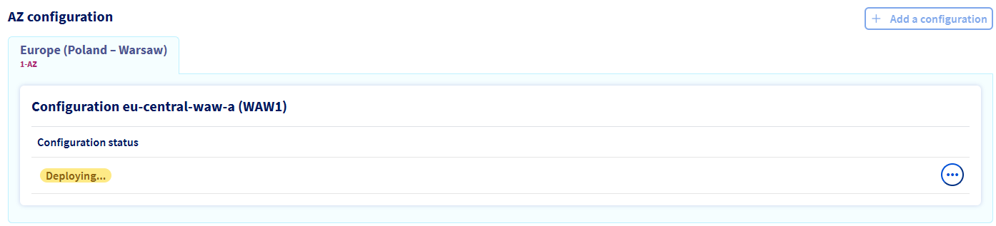

The AZ configuration will then begin.
add AZ
Configuration L3

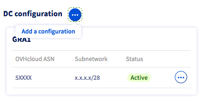

When your PoP configuration has been set, click Add a configuration under the AZ configuration menu.
add AZ
Select an availability zone from the drop-down menu, then enter the information required.
OVHcloud ASNThe OVHcloud AS number that will be configured on the OVHcloud Connect routers located in the AZ. This number may be different from the ASN chosen for the PoP
A /28 subnetworkA private subnetwork configured in your vRack in the selected AZ. This can be an IPv4 block of size /28 or higher
add AZ

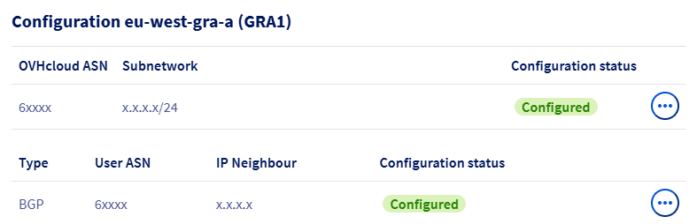

You can add additional availability zone configurations by clicking on the + Add a configuration button.
add AZ

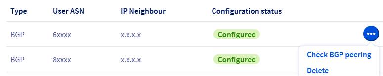

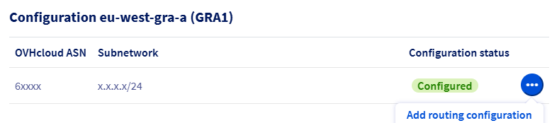

You must also add a routing configuration.
Adding a routing configuration

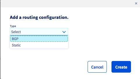

Click on the (...) button on the desired availability zone then on Add routing configuration.
add routing configuration

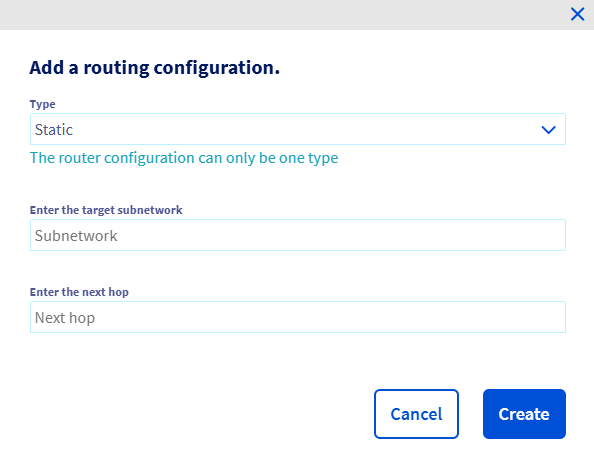

Then choose the routing type between Static and BGP.

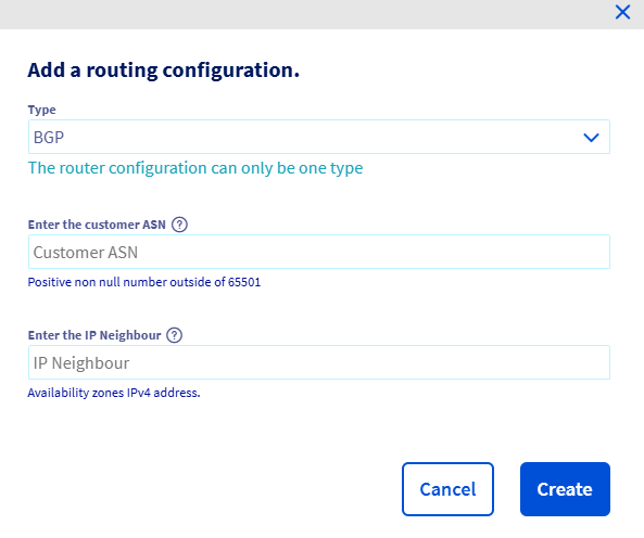

If you choose the type BGP, then enter the required information.
Customer ASNYour AS BGP number, which is configured on your router located in the AZ
IP NeighbourIP address of the BGP neighbour of your router in the AZ. This address must be part of the subnetwork specified in the AZ Configuration section
If you choose the Static type, enter the required information:
Network FocusA prefix using CIDR notation
Next hopAn IP address acting as gateway in the subnetwork range

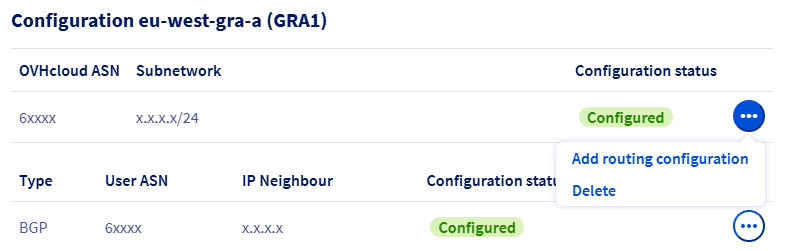

You can add multiple routing configurations within the same availability zone. The configuration type (BGP or Static) chosen for your first routing configuration will then apply to the next configuration on the same availability zone.

Deleting a routing Configuration
To delete a routing configuration, click the ... button on the routing configuration to delete, then click Delete.
deleting routing configuration
