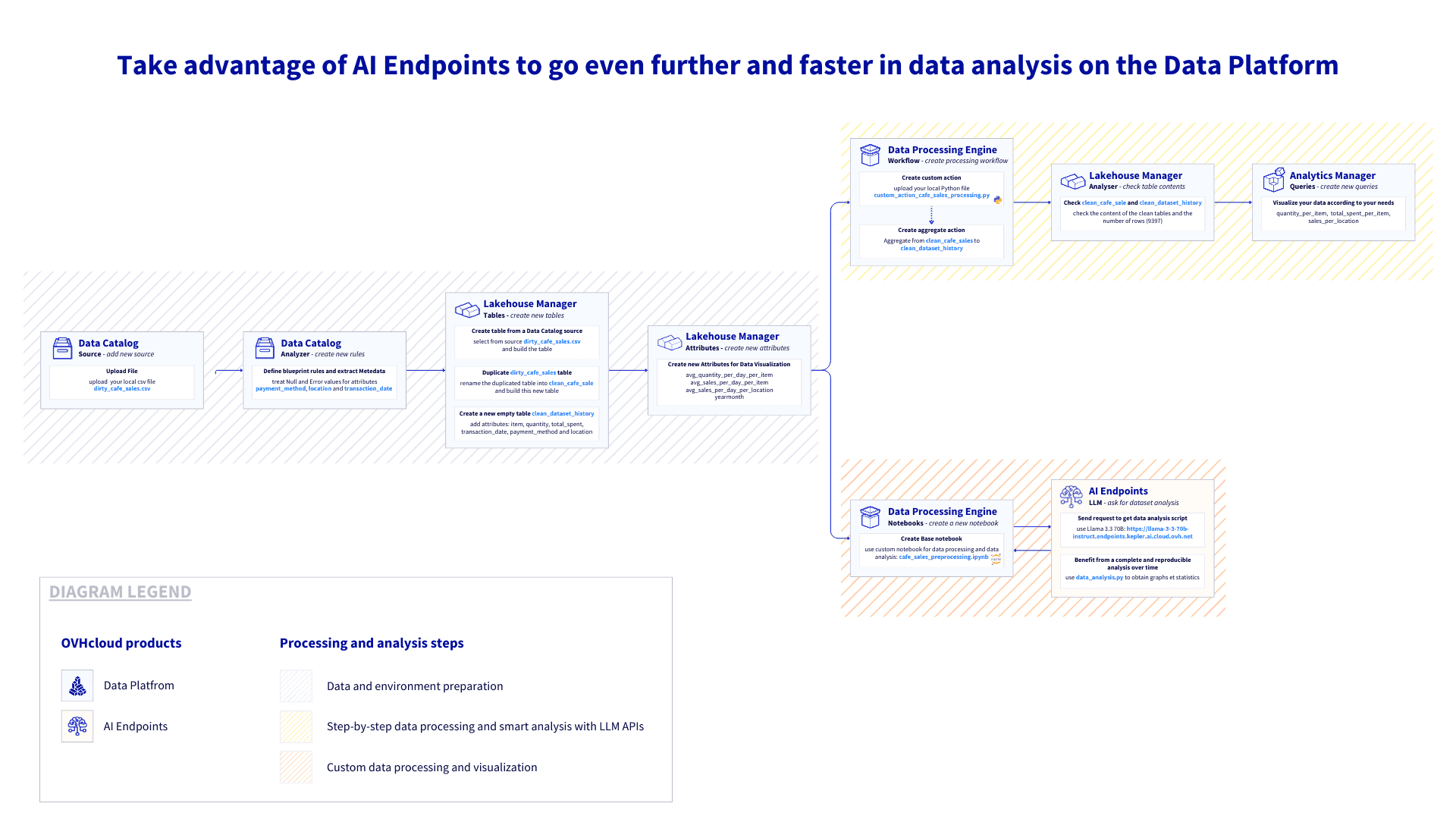

Introduction — Process overview
Tutorial Steps

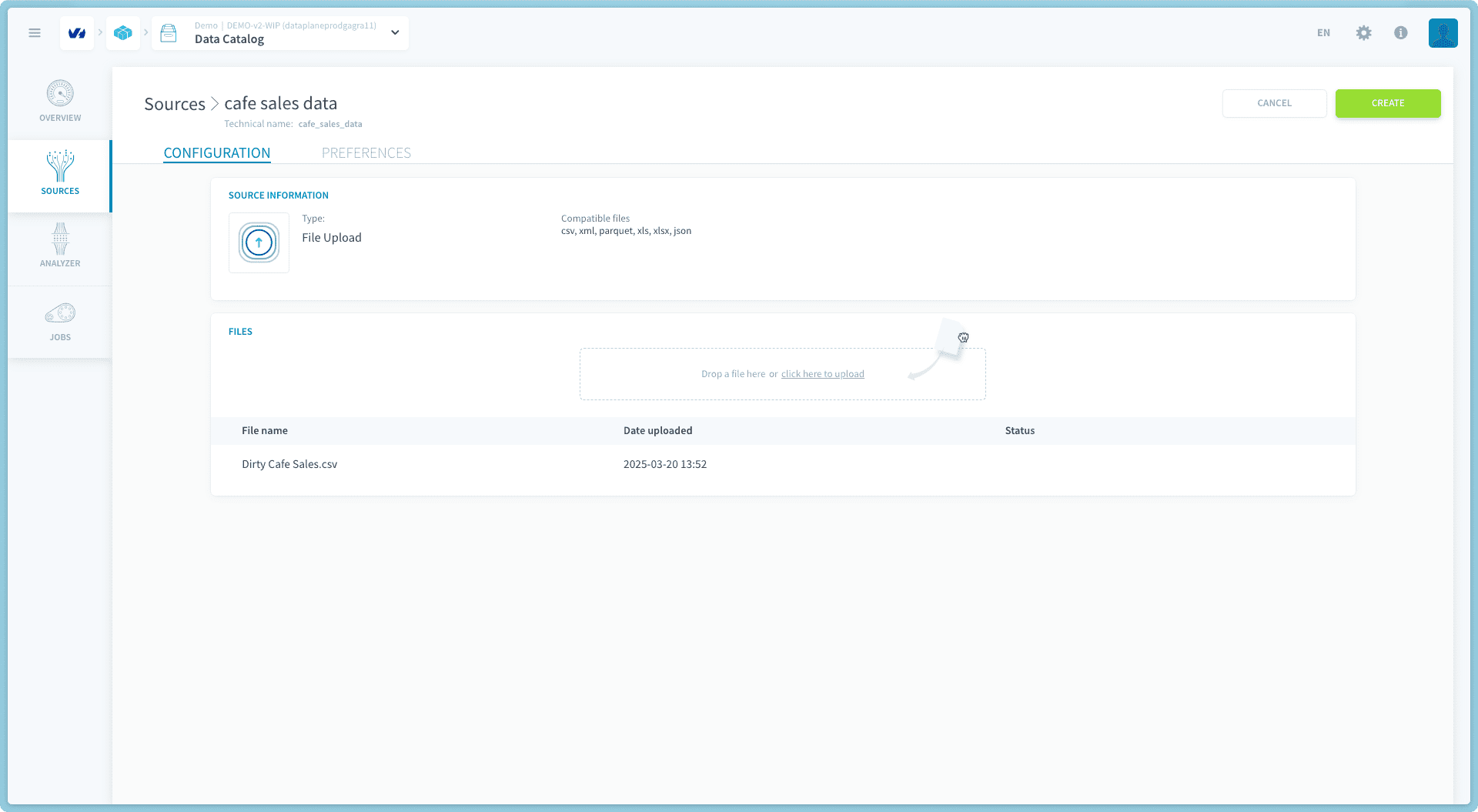

step 1 - Upload CSV file
The first step is to access the Connectors, create a new source, and choose File Upload to upload the CSV file. For the purpose of this guide we will be using the - Dirty Cafe Sales Dataset

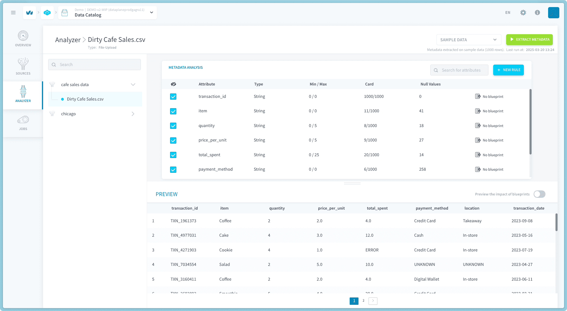

step 2 - Analyze the source and define blueprint rules
Access the Analyser from the Connectors and click on the newly added source to extract the metadata.
step 2 - Analyze the source and define blueprint rules — Ai endpoints step

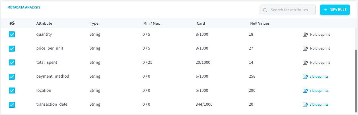

Once complete you can start to define the following blueprint rules for each of the mentioned attributes:
AttributeBlueprint rule
payment_method- Skip line if Is null - Skip line if Equal "ERROR" - Skip line if Equal "UNKNOWN"
location- Skip line if Is null - Skip line if Equal "ERROR" - Skip line if Equal "UNKNOWN"
transaction_date- Skip line if Is null - Skip line if Equal "ERROR" - Skip line if Equal "UNKNOWN"

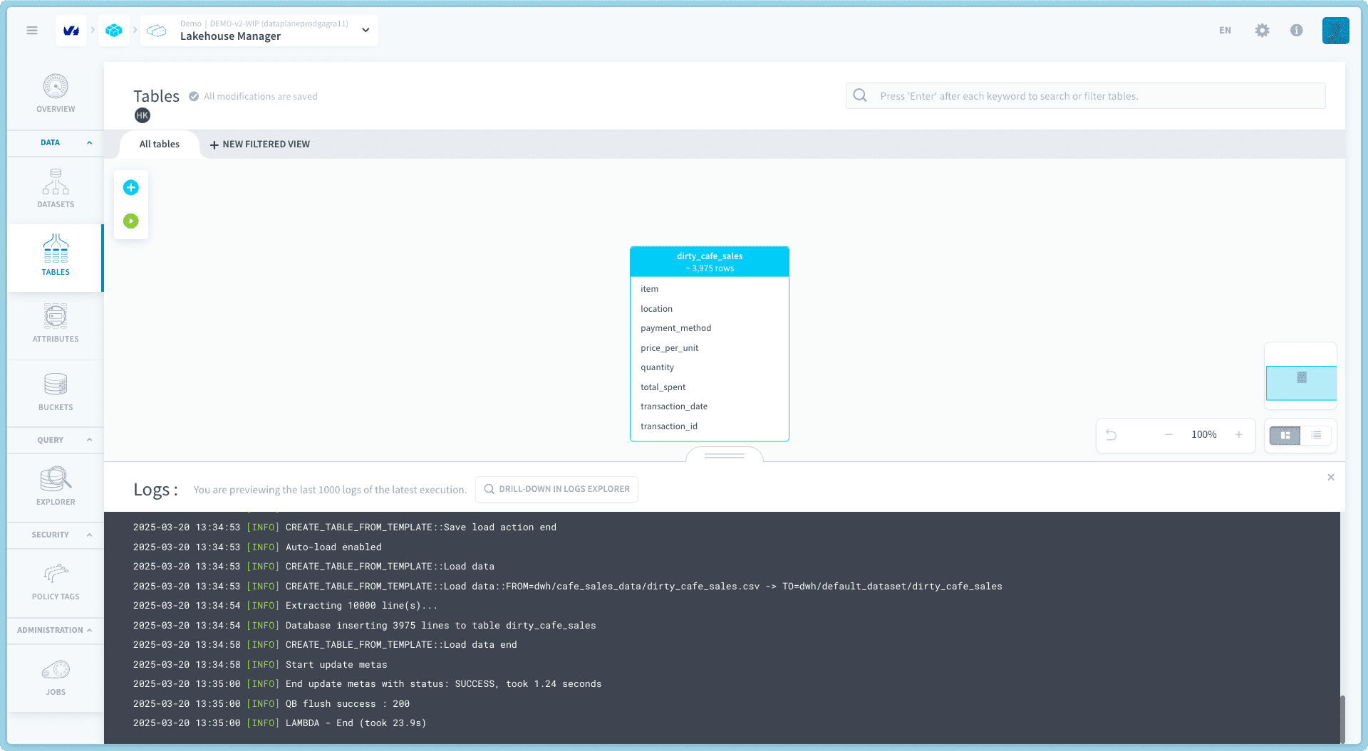

  1. Open the tables section by going to the Lakehouse Manager.
  2. Click on Create from a Connectors source and select the source dirty cafe sales.csv.
  3. Name it dirty_cafe_sales (default name)
  4. Click on Create to build and create the table.
  5. Verify that the table has been created correctly. If there are any issues, check the logs for errors.

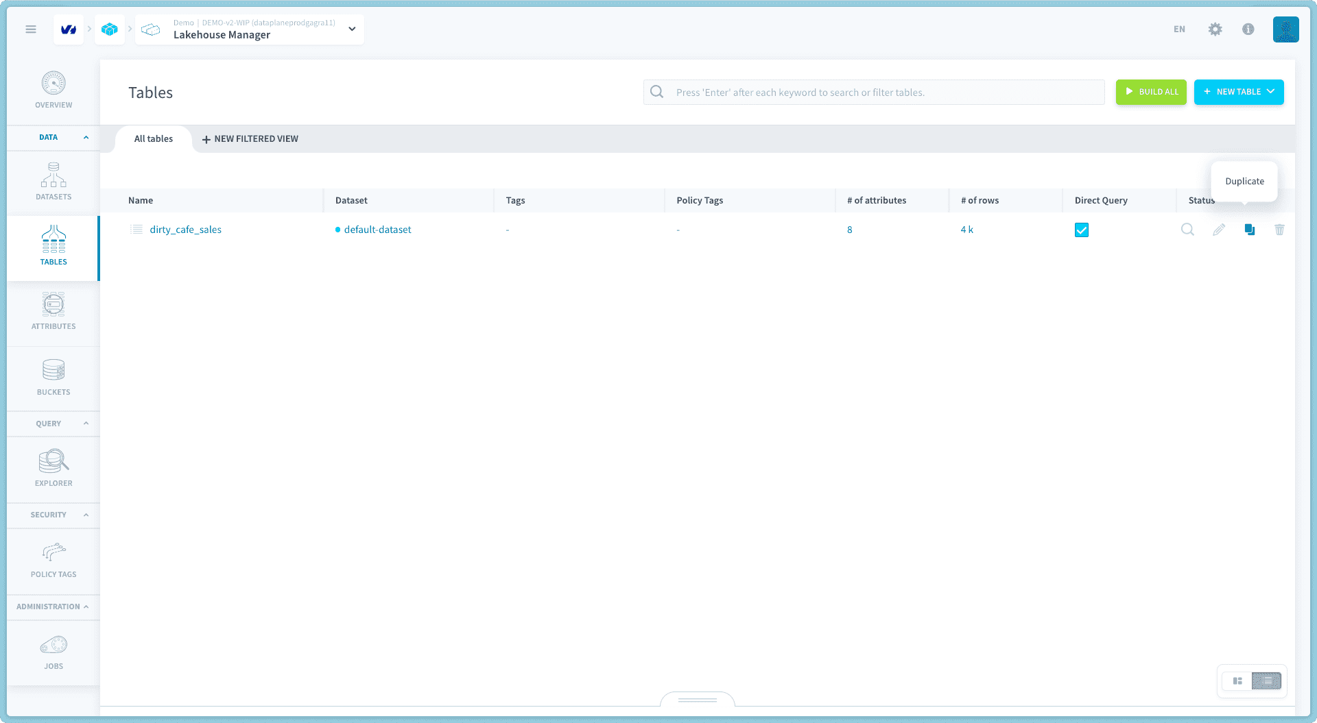

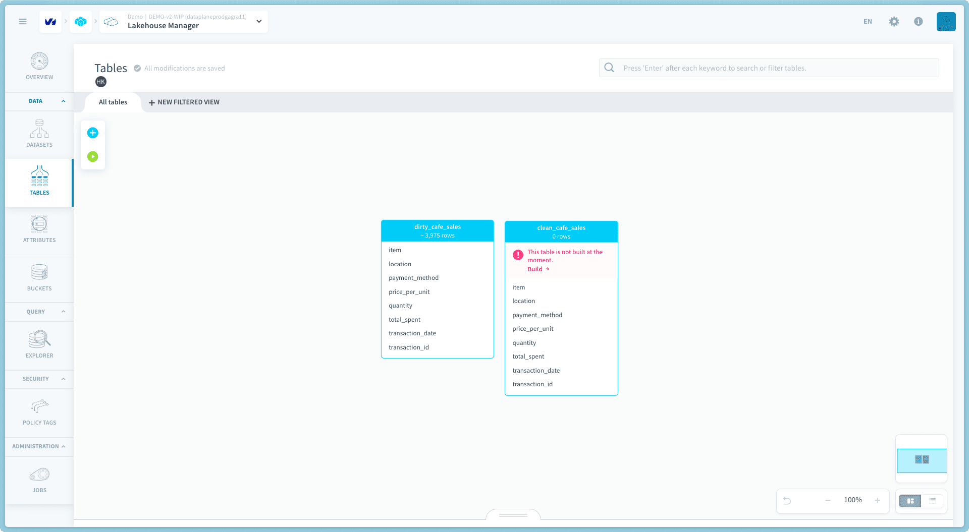

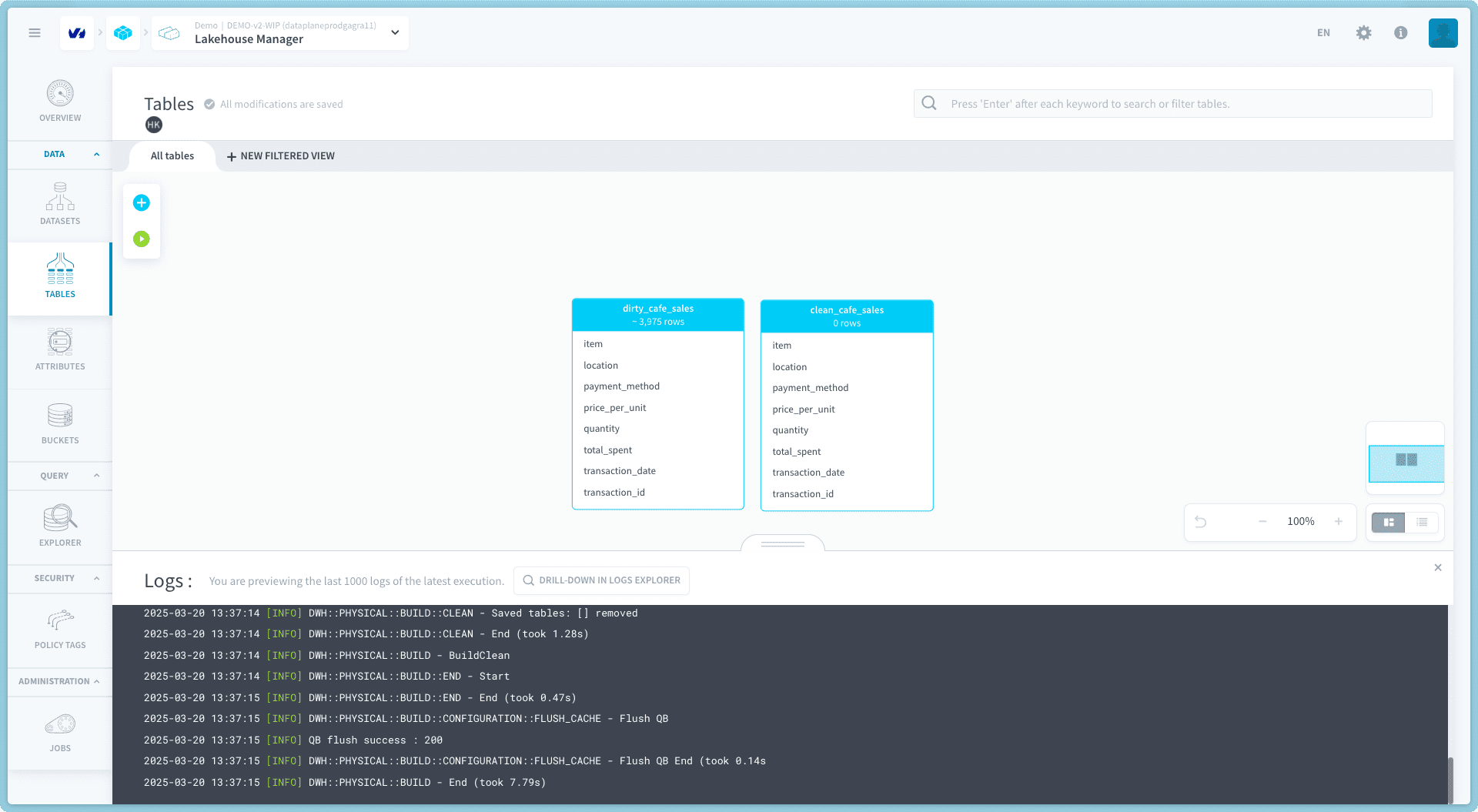

step 4 - Duplicate the table
Duplicate this table to get a new empty table with the same attributes and name it clean_cafe_sales. Launch the "Build" and check that everything's okay after completion.
step 4 - Duplicate the table — Ai endpoints step step 4 - Duplicate the table — Ai endpoints step (2) step 4 - Duplicate the table — Ai endpoints step (3)
As noted, the duplicated table is currently empty. This occurs because only the table attributes have been duplicated, while the corresponding data still needs to be loaded separately.

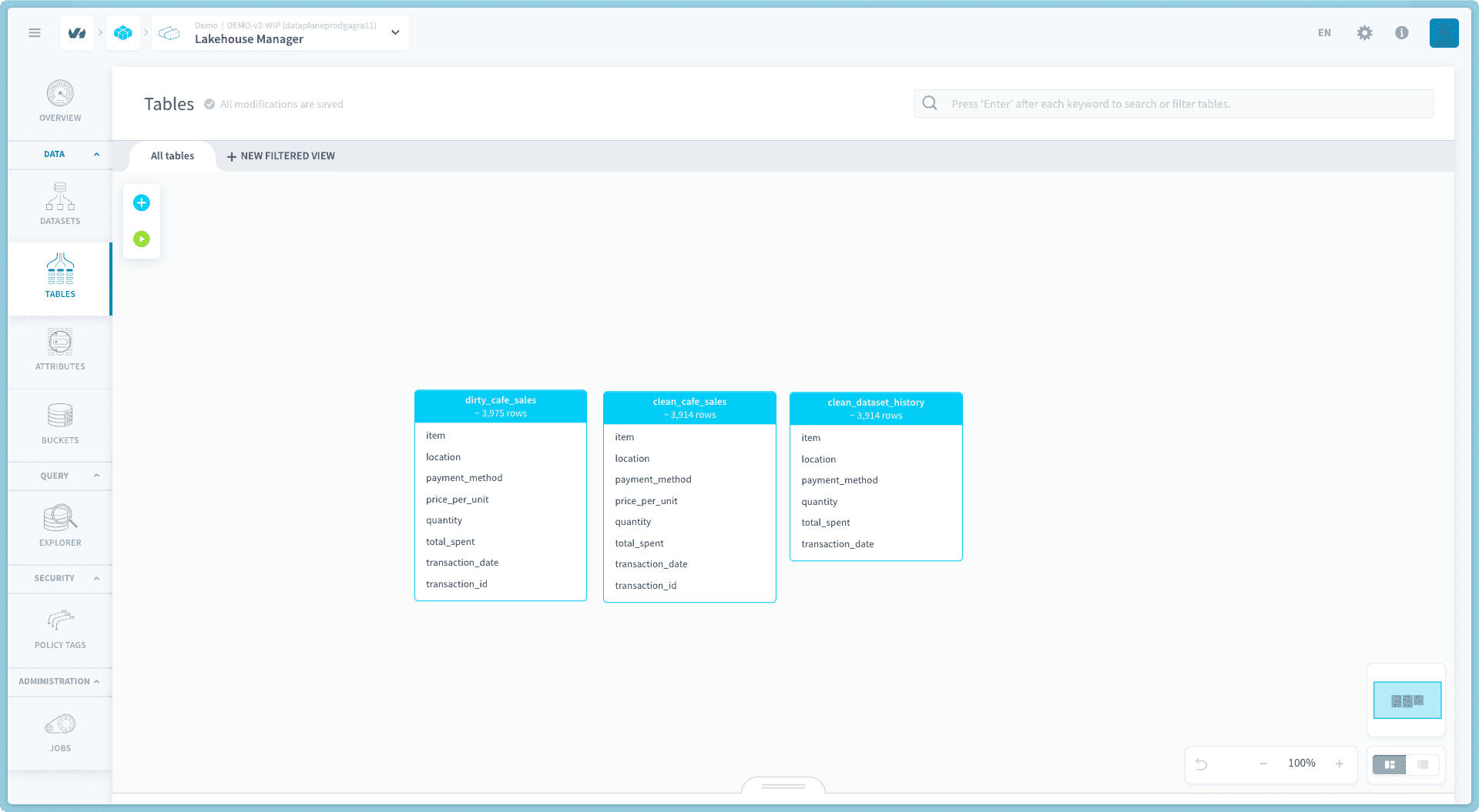

step 5 - Create an empty table for future data visualization
Create a new empty table called clean_dataset_history and add the following attributes:
Tip: You can switch to the Canvas view to easily drag and drop the attributes, instead of creating them individually.
  • item
  • location
  • payment_method
  • quantity
  • total_spent
  • transaction_date

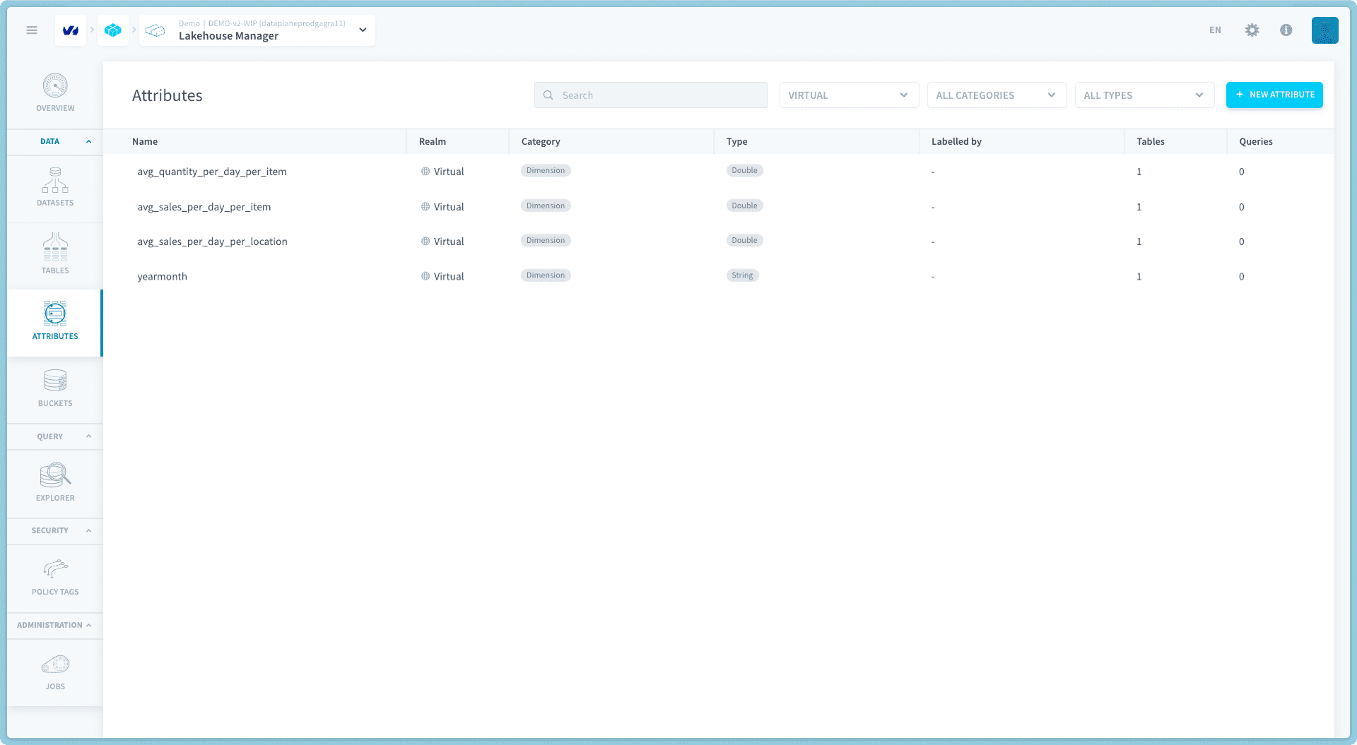

Head to the Attributes in the Lakehouse Manager, create new Virtual Attributes for data visualization:
Attribute NameVirtual Attribute Definition
avg_quantity_per_day_per_itemSUM(CAST(quantity AS DECIMAL(10,2))) / COUNT(DISTINCT CONCAT(CAST(transaction_date AS VARCHAR), CAST(item AS VARCHAR)))
avg_sales_per_day_per_itemSUM(CAST(total_spent AS DECIMAL(10,2))) / COUNT(DISTINCT CONCAT(CAST(transaction_date AS VARCHAR), CAST(item AS VARCHAR)))
avg_sales_per_day_per_locationSUM(CAST(total_spent AS DECIMAL(10,2))) / COUNT(DISTINCT CONCAT(CAST(transaction_date AS VARCHAR), CAST(location AS VARCHAR)))
yearmonthSUBSTR(CAST(transaction_date AS VARCHAR), 1, 7)
it should look like so:
step 6 - Create new attributes — Ai endpoints step

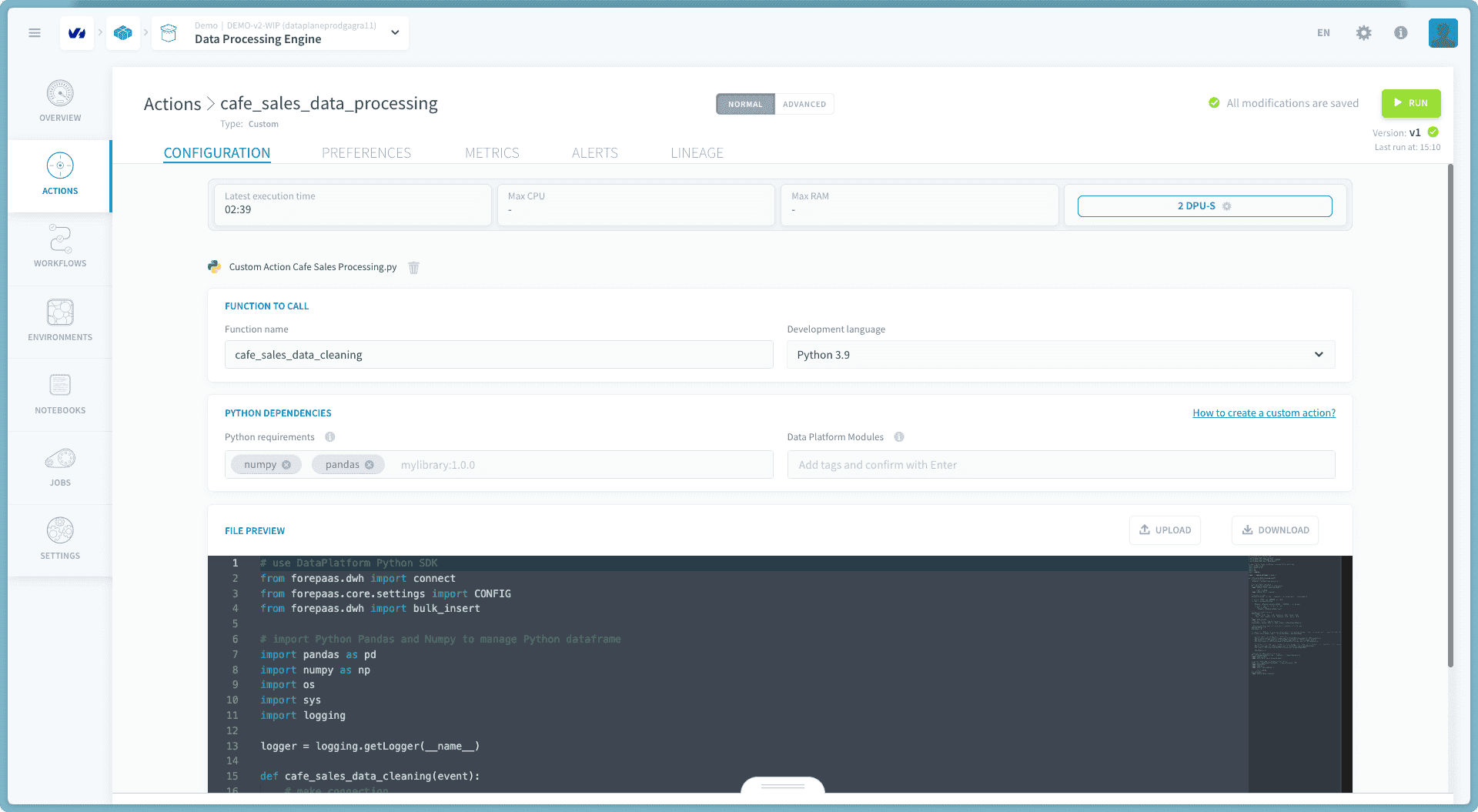

  1. First, create a new "Custom" action:
  • Upload your Python file custom_action_cafe_sales_processing.py
  • name the custom action as cafe_sales_data_processing
  • Choose Python 3.9 version
  • Add numpy and pandas dependencies (type in the library name and press enter) and click on Create
  • Now you can RUN the custom action.
step 7 - Clean dataset using your own data processing workflow — Ai endpoints step
Also, you should see logs similar to below to double check if what you have done is correct:
2025-02-27 08:59:09 [NOTICE] "cafe_sales_data_processing" SUBMITTED
2025-02-27 08:59:09 [NOTICE] "cafe_sales_data_processing" QUEUED
2025-02-27 08:59:10 [NOTICE] "cafe_sales_data_processing" BUILD SUBMITTED
2025-02-27 09:00:41 [NOTICE] "cafe_sales_data_processing" Stop cleaning
2025-02-27 09:00:41 [NOTICE] "cafe_sales_data_processing" END (custom) action. Duration: 6.65 sec
2025-02-27 09:00:44 [NOTICE] "Flush dataplant cache" END (forepaas-flushall) action. Duration: 2.14 sec

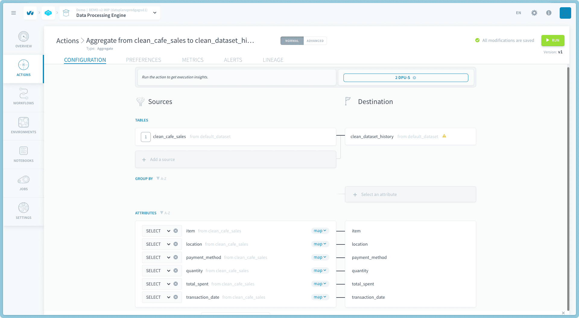

  1. Then, create the "Aggregate" action as follows:
    • Configure the aggregate action settings according to your requirements
    step 7 - Clean dataset using your own data processing workflow — Ai endpoints step (2)

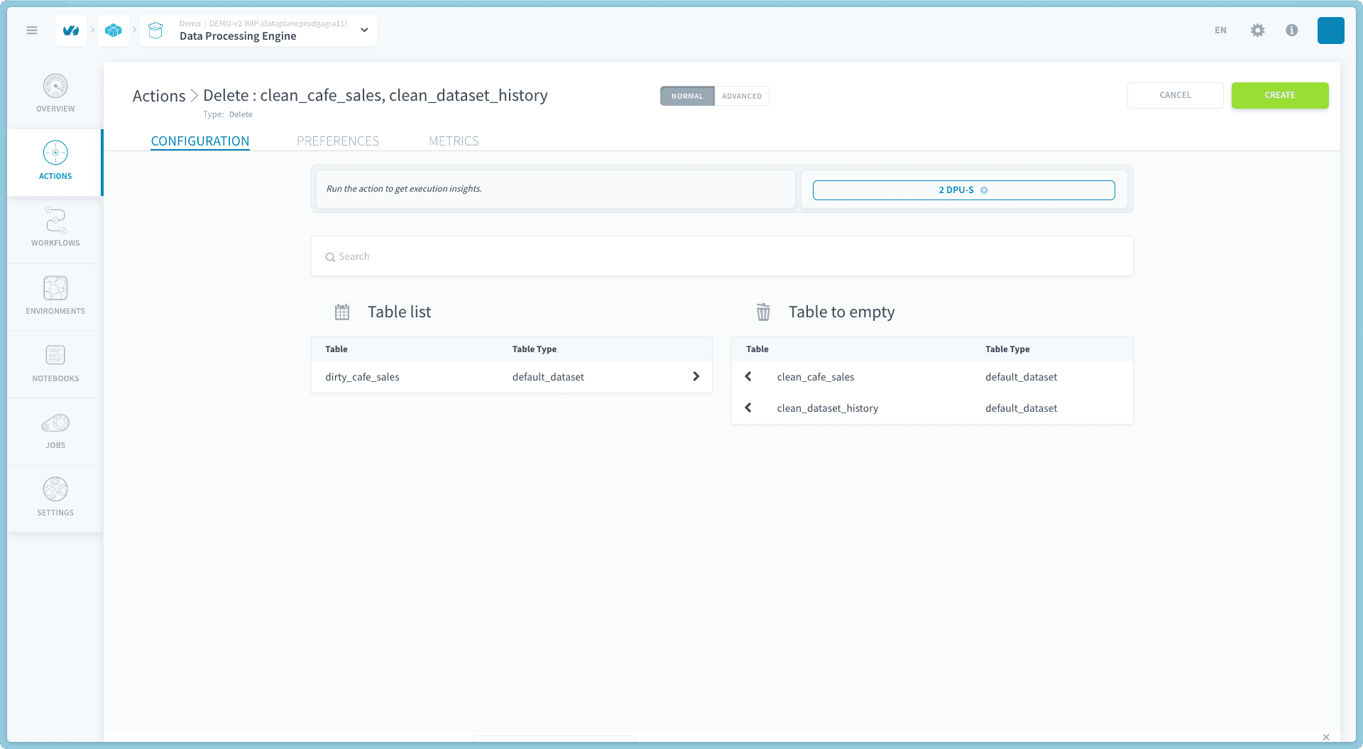

  2. Then, create the "Delete" action as follows:
    • Configure the delete action settings according to your requirements (this action will ensure you are using a clean table every time)
    step 7 - Clean dataset using your own data processing workflow — Ai endpoints step (3)

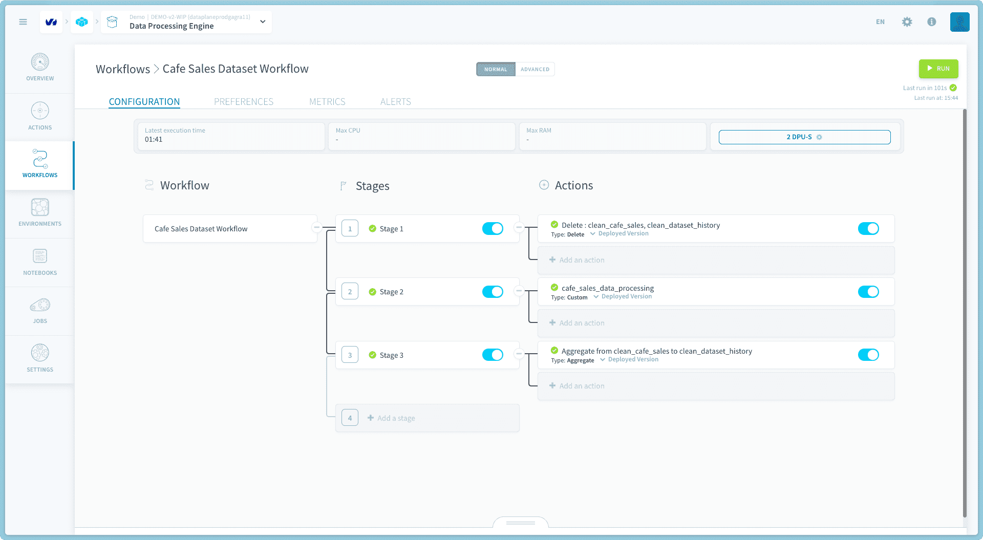

  3. Finally, define the processing workflow:
    • Set up your workflow to connect the delete, custom action and aggregate action
    step 7 - Clean dataset using your own data processing workflow — Ai endpoints step (4)
Your dataset is now clean.

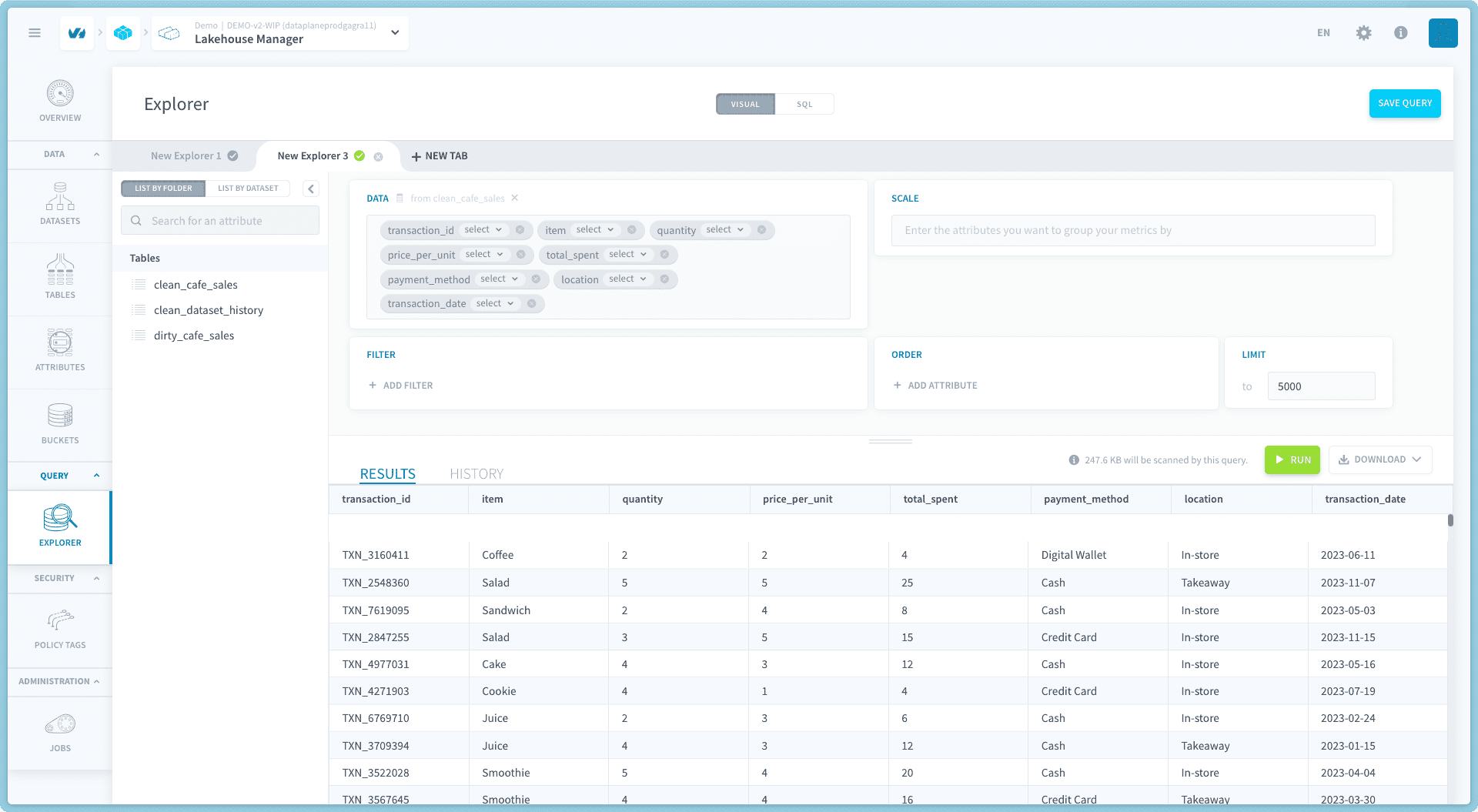

  2. From the Lakehouse Manager Explorer, you can explore the clean_cafe_sales table
    step 8 - Explore clean tables — Ai endpoints step (2)

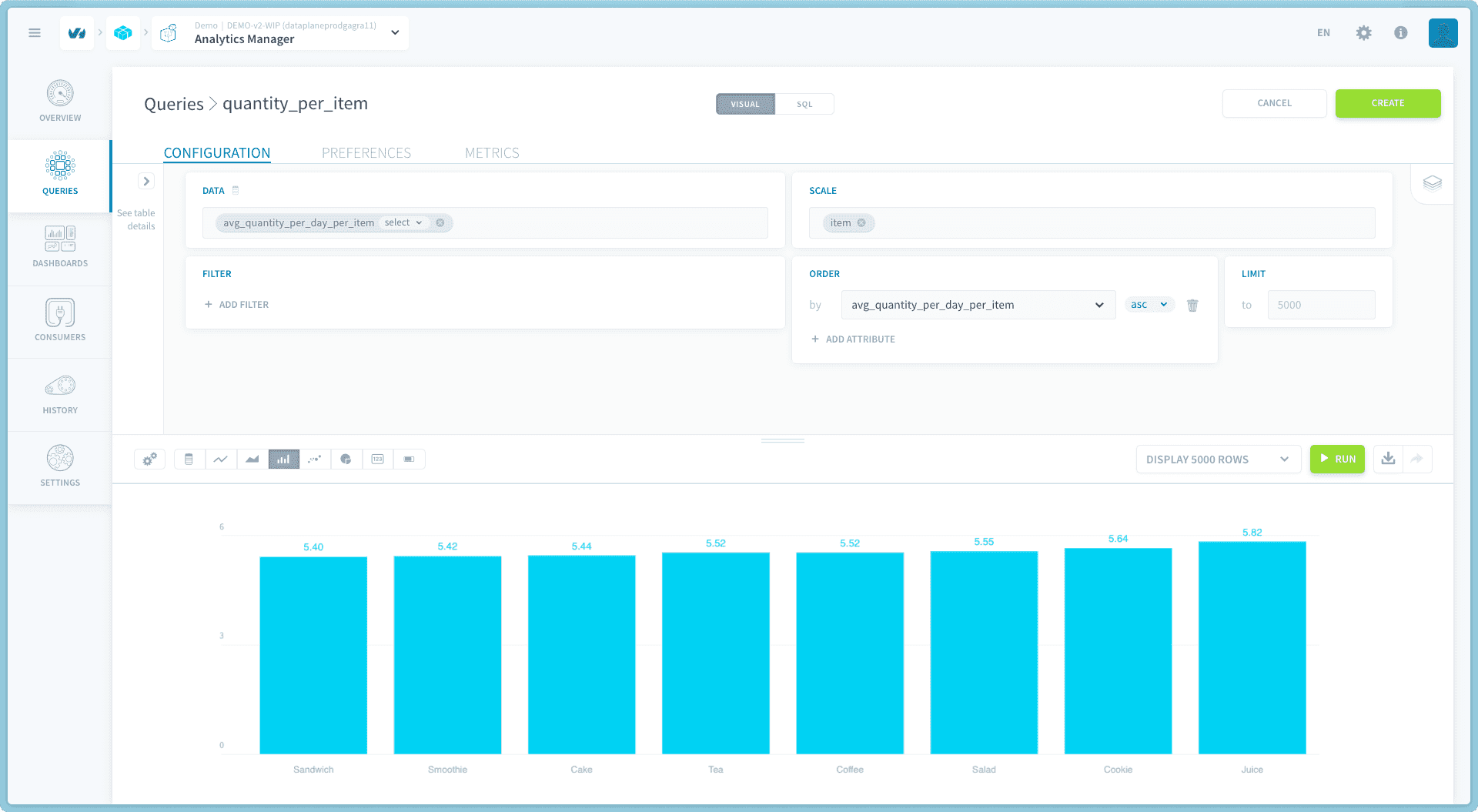

  1. Create quantity_per_item query
    • You should see the average quantity sold per day for each item
    step 9 - Data visualization using custom attributes — Ai endpoints step

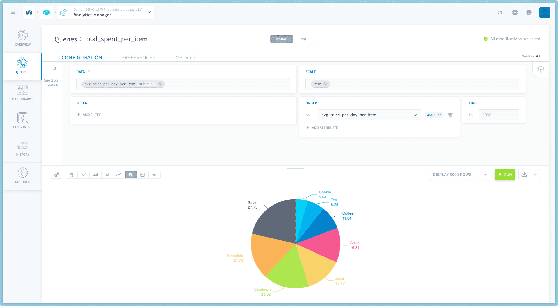

  2. Create total_spent_per_item query
    • You could see the average total amount sold per day for each item
    step 9 - Data visualization using custom attributes — Ai endpoints step (2)

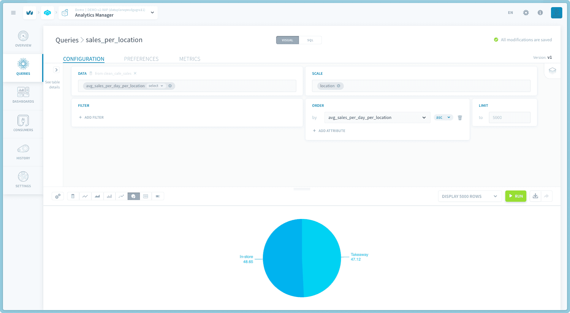

  3. Create sales_per_location query
    • You could see the average total amount sold per day for each location
    step 9 - Data visualization using custom attributes — Ai endpoints step (3)

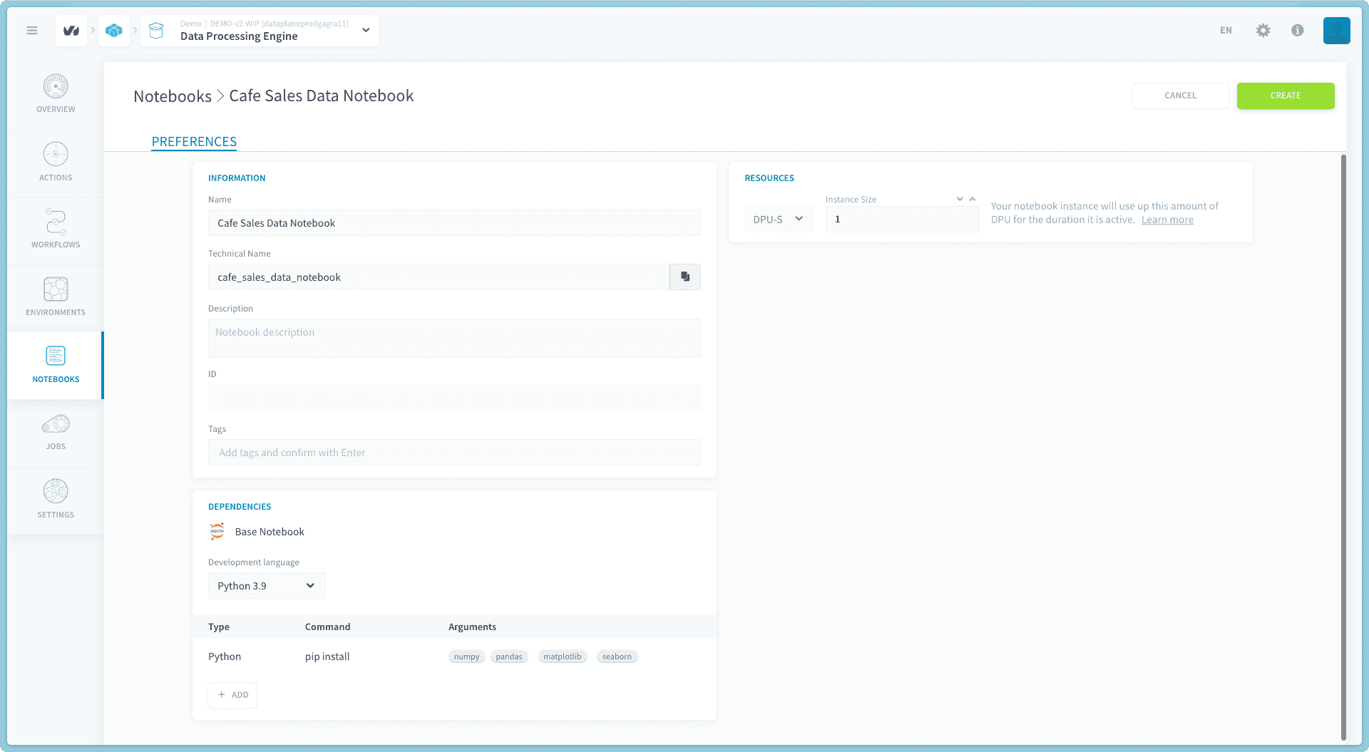

If you want to follow the data cleaning process step by step, you can create a new notebook from the Data Processing service.
  1. Create a "Base notebook" with:
    • Python 3.9 version
    • Install numpy, pandas, matplotlib, and seaborn dependencies
    step 10 - Clean dataset and save it into S3 bucket — Ai endpoints step

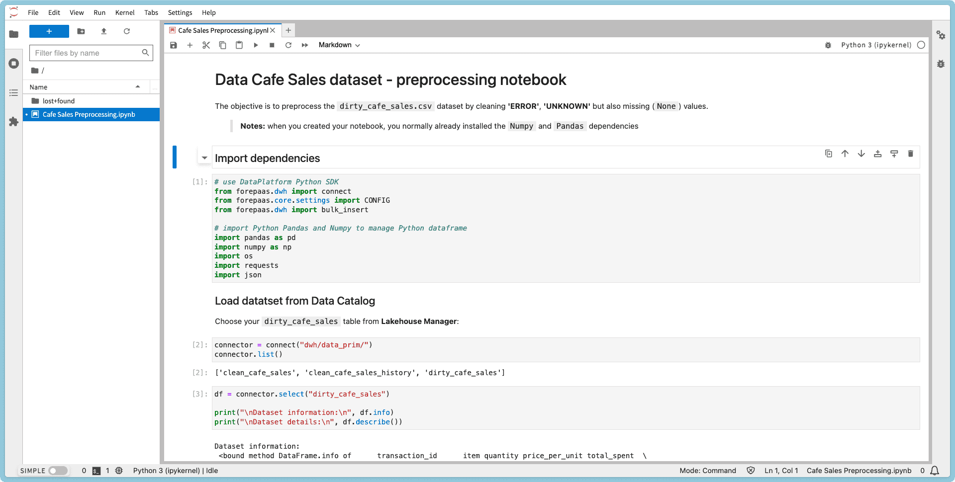

  2. Drag and drop the or click upload, to upload the file cafe_sales_preprocessing.ipynb into the jupyterhub file siebar
    step 10 - Clean dataset and save it into S3 bucket — Ai endpoints step (2)

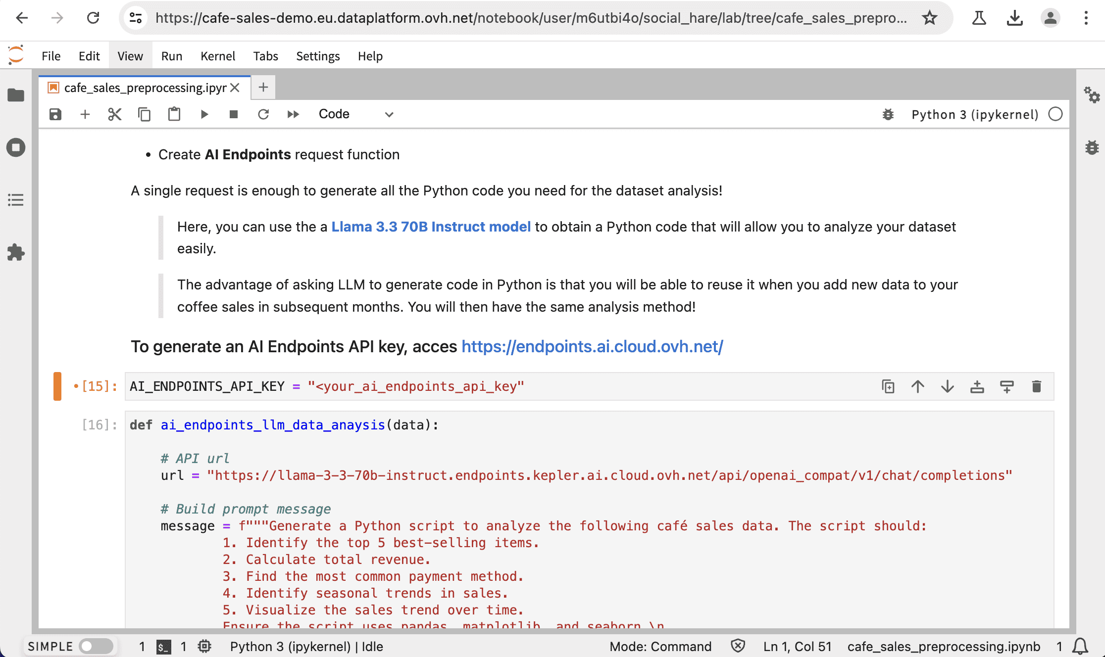

step 11 - One-shot data analysis with LLM AI Endpoints
A single request is enough to generate all the Python code you need for dataset analysis!
  1. Use the Llama 3.3 70B Instruct model with the Python code that will allow you to analyze your dataset easily
  2. Generate an AI Endpoints API key and use it in the designated line as seen below in the screenshot
    step 11 - One-shot data analysis with LLM AI Endpoints — Ai endpoints step step 11 - One-shot data analysis with LLM AI Endpoints — Ai endpoints step (2)
  3. Use the generated Python code to analyze your data and display graphs
The advantage of asking an LLM to generate code in Python is that you will be able to reuse it when you add new data to your coffee sales in subsequent months, ensuring a consistent analysis method.
