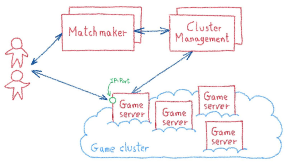

Connecting players to the right server
Every game publisher used to have their own proprietary solutions, but most on them follow a similar flow, with a matchmaking service that groups players into a match, deals with a cluster manager to provision a dedicated instance of game server and send to the players its IP address and port, to allow them to directly connect to the server and play the game.
Online gaming matchmaking and game server assignation

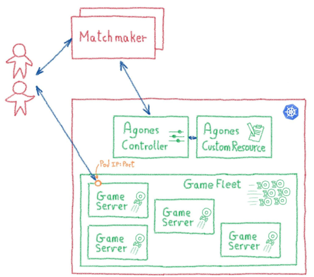

Agones and it's Custom Controller and Custom Resource Definition replaces the complex cluster management infrastructure with a standardised, Kubernetes-based tooling and APIs. The matchmaker services interact with these APIs to spawn new game server pods and get their IP address and ports to the concerned players.
Online gaming matchmaking and game server assignation with Agones

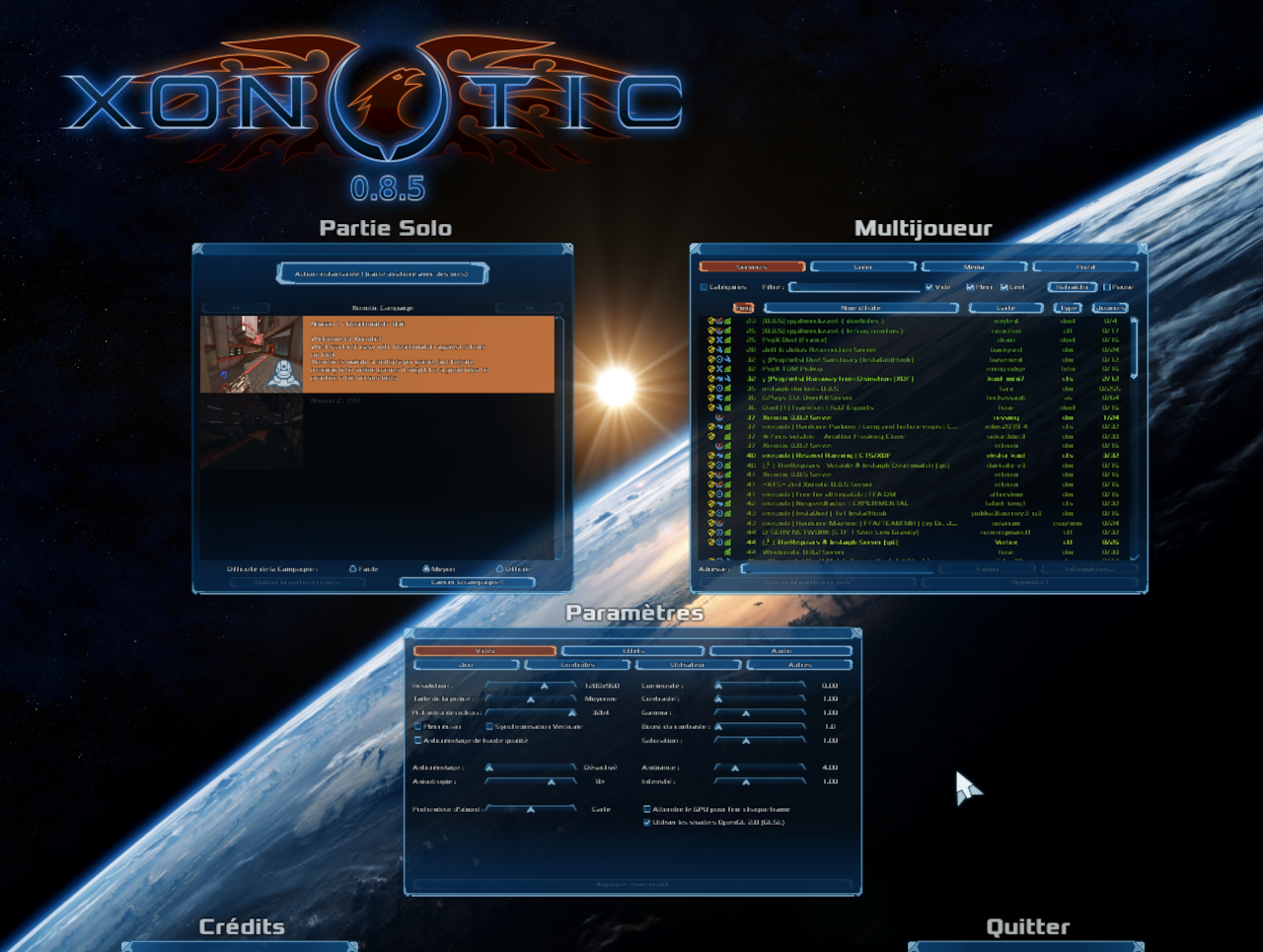

Download the Xonotic client (it runs on Windows, Linux and MacOS, so there is no excuse), and launch it:
Xonotic

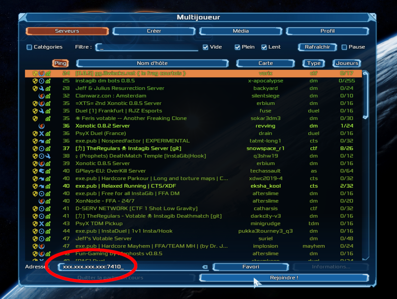

Then go to the Multiplayer menu and enter the address and port of our game server:
Multiplayer menu

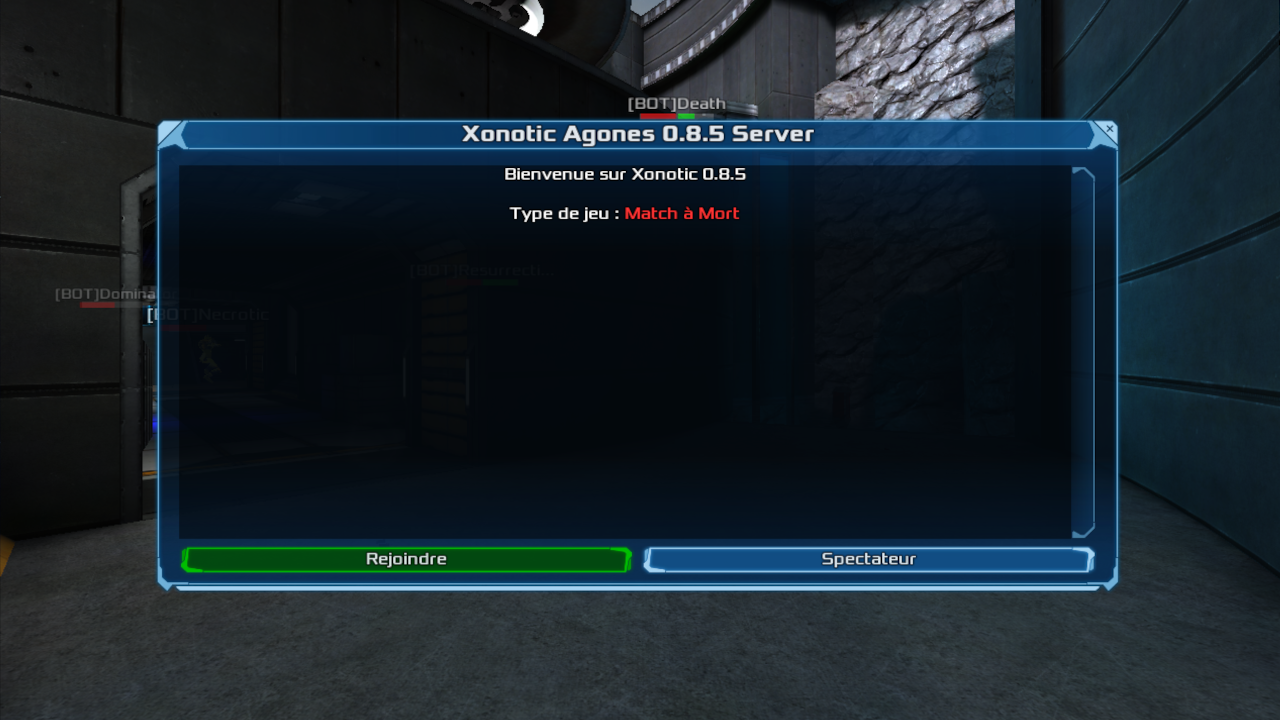

And you are ready to play!
Let's frag
