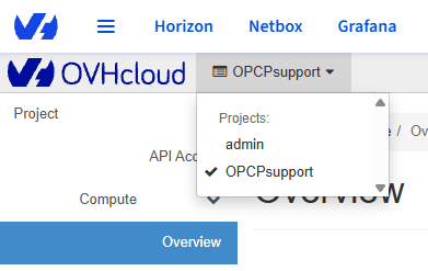

Once connected, select the project where you want to install your instance.

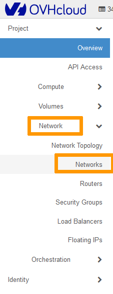

2. Creating a private network
Before deploying your instance, it is generally necessary to create a private network so that it can be accessed within your local infrastructure.

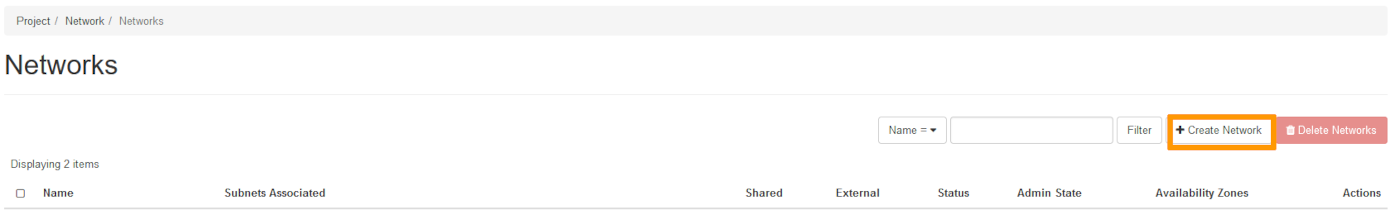

In the left-hand menu, click on Network, then on Networks.
horizon-network-networks

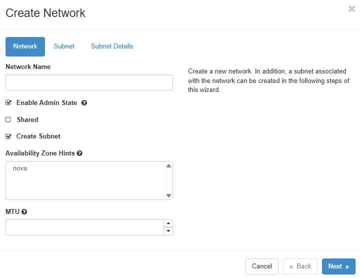

Click on Create Network.

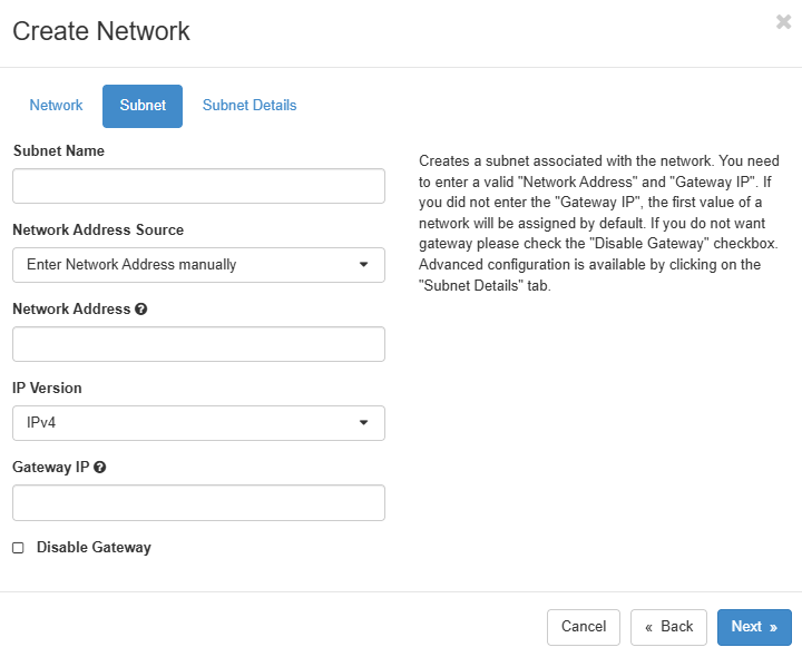

Network
Subnet

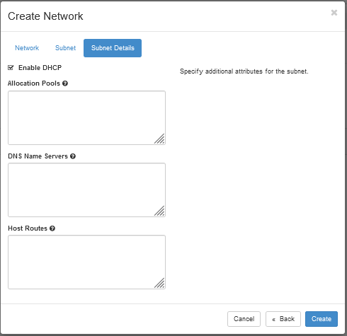

Subnet Details
horizon-network-setup-network
FieldDescription
Network NameEnter a name for your network.
Enable Admin StateLeave this option checked to activate the network.
SharedCheck this box if you want to make the network available to multiple projects.
Create SubnetLeave this option checked to create a subnet.
Availability Zone HintsLeave the default value.

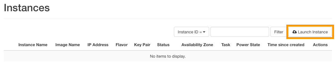

In the left-hand menu, click on Compute, then on Instances.
horizon-compute-instances
Click on Launch Instance to create a new instance.
horizon-compute-instances-launch-instance

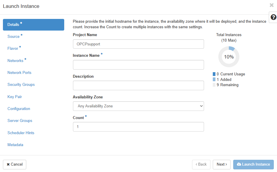

Details
horizon-compute-instances-launch-instance-details
FieldDescription
Instance NameEnter the name of the instance to create.
DescriptionOptional. Add a description if needed.
Availability ZoneLeave the default value nova.
CountSpecify the number of instances to deploy.

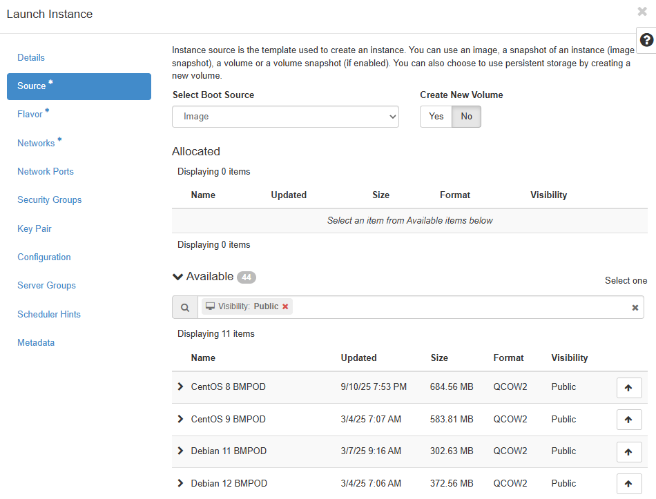

Source
horizon-compute-instances-launch-instance-source
FieldDescription
Boot SourceSelect the boot source: Image or Instance Snapshot.
Image NameChoose the image to use (e.g. Debian 12 BMPOD).

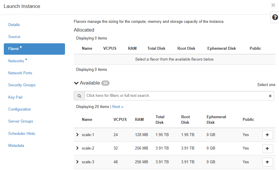

Flavor
horizon-compute-instances-launch-instance-flavor
Select the appropriate hardware configuration (vCPU, memory, storage).

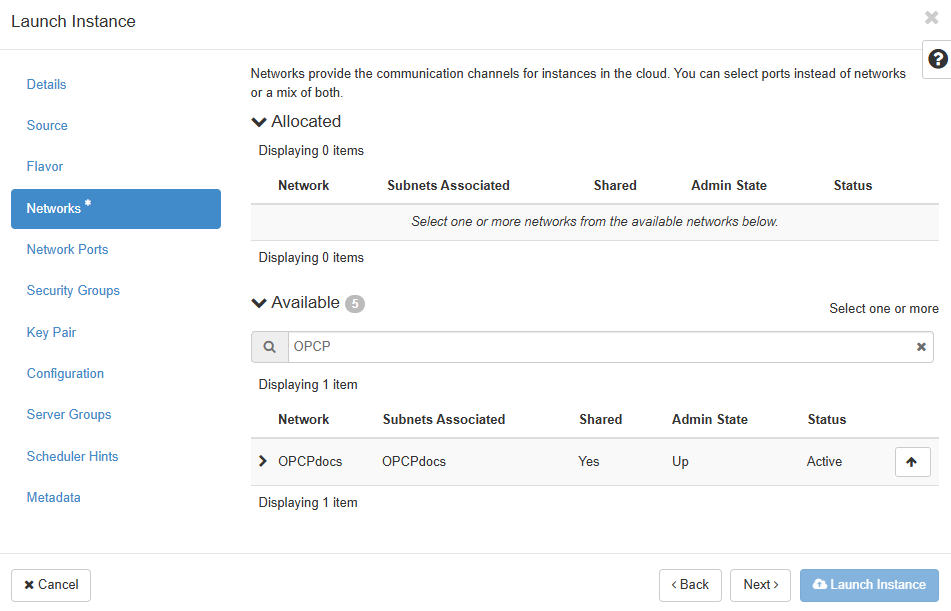

Networks
horizon-compute-instances-launch-instance-network
Select the private network previously created. You can also attach an existing network port from the Network Ports tab.

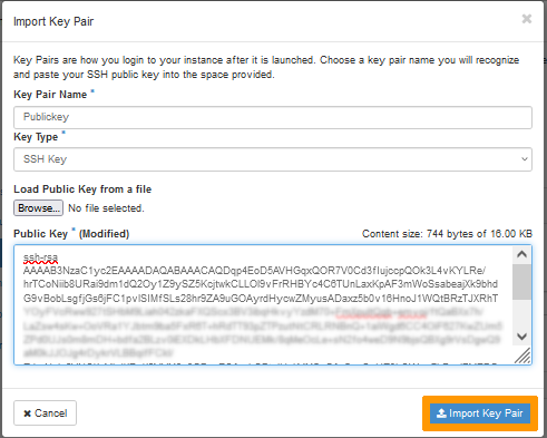

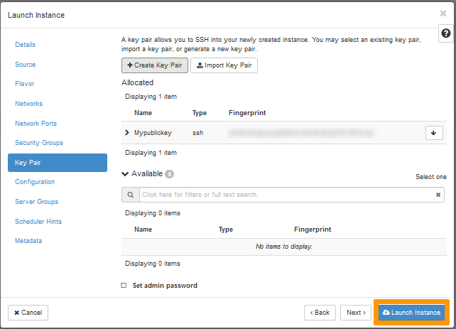

4. Managing SSH key pairs
Although selecting an SSH key in Horizon is not mandatory, it is essential for connecting to the instance once it has been created.
horizon-compute-instances-launch-instance-key-pairs
Create a new key pair
Import an existing key

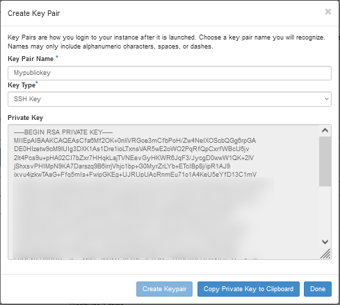

Click + Create Key Pair and fill in the following fields:
FieldDescription
Key Pair NameEnter a name for the key.
Key TypeSelect SSH Key.
Next, click on Create Keypair. Copy the private key with Copy Private Key to Clipboard, then click on Done.
horizon-compute-instances-launch-instance-key-pairs-create-step01
The key is now selected by default. Click on Launch Instance to start creating the instance.
horizon-compute-instances-launch-instance-key-pairs-create-step02
