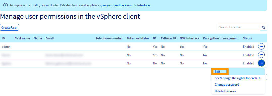

Authorising a user to administer encryption on a Hosted Private Cloud cluster powered by VMware

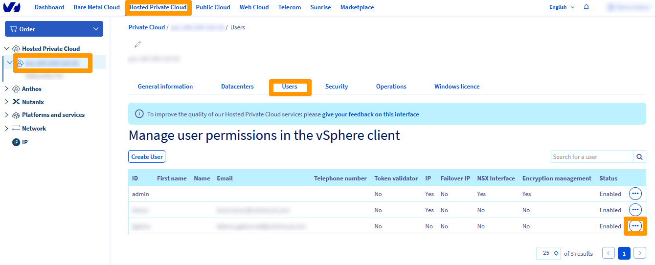

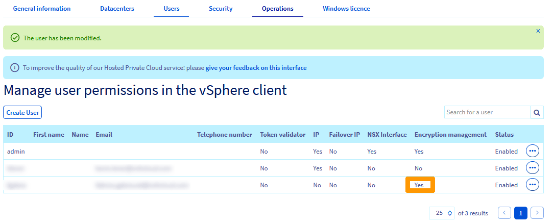

Choose your cluster. Go to Users and click the ...
00 add right from manager 01
Click Edit.
00 add right from manager 02
Enable Encryption Management and click Confirm.
00 add right from manager 03
Wait until the change window disappears.
00 add right from manager 04
Encryption management rights have been changed, as can be seen in the Encryption management column.
00 add right from manager 05

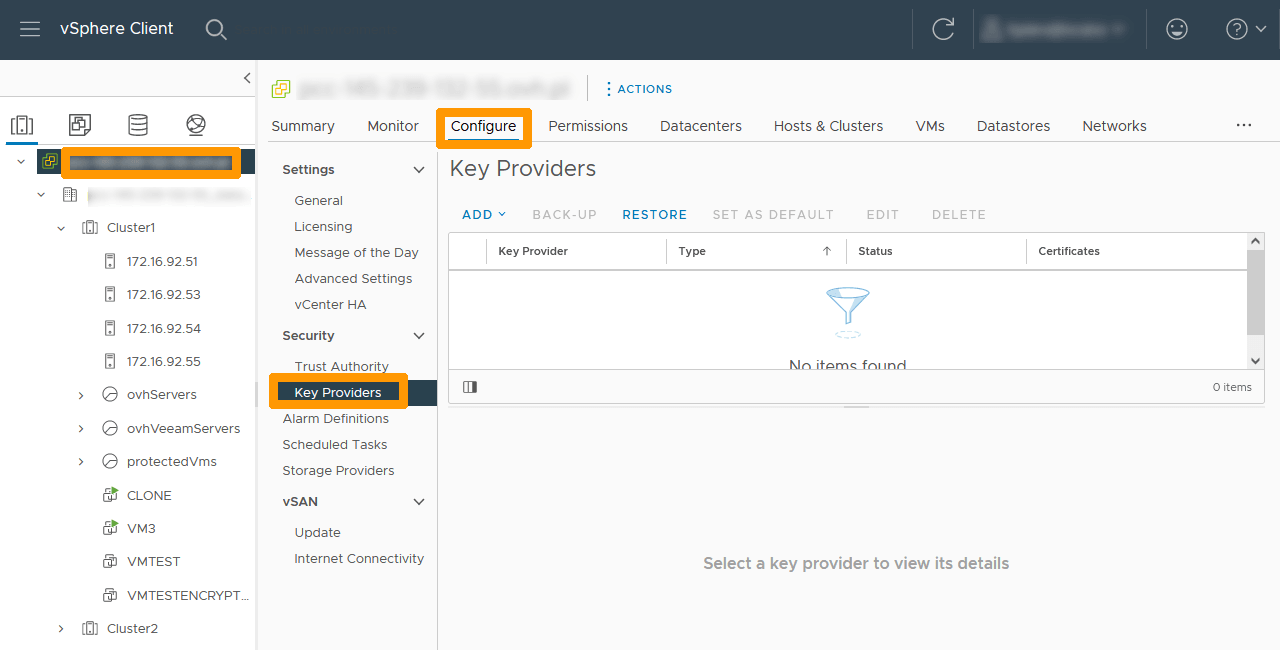

Click on the root of the cluster in the top left-hand corner, then click on the Configure tab and choose Key Providers.
01 Create KEY 01

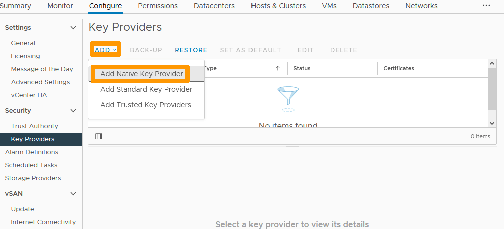

Click the ADD button and choose Add Native Key Provider from the menu.
01 Create KEY 02

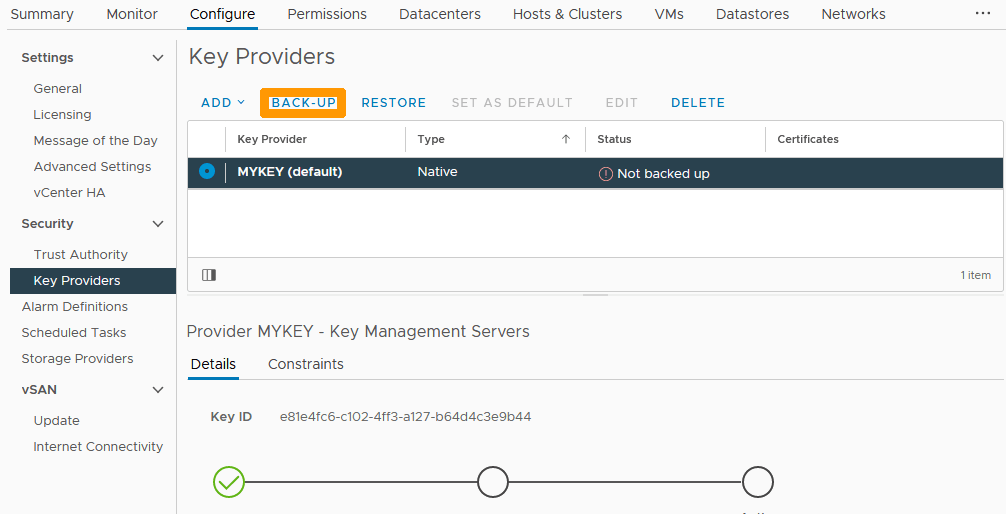

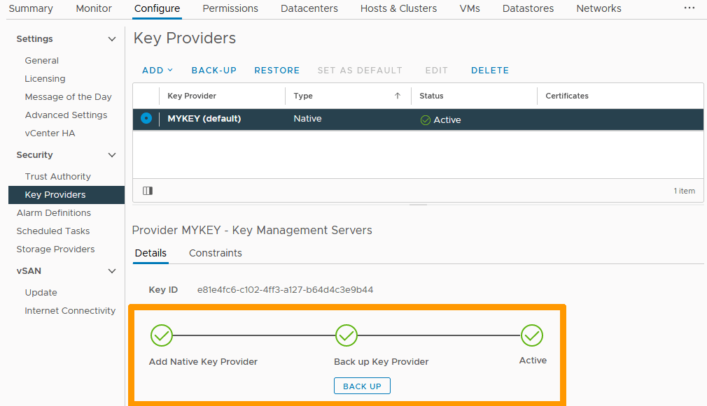

Click the BACK-UP button on the left to back up the key outside the cluster.
01 Create KEY 04

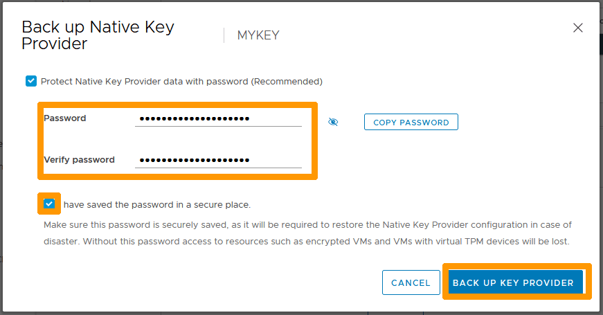

Select the checkbox on the left to password protect the backup.
01 Create KEY 05
Type a password and confirm it. Then select the I have saved the password in a secure place box and click BACK UP KEY PROVIDER.
01 Create KEY 06
The key can now be used to encrypt virtual machines.

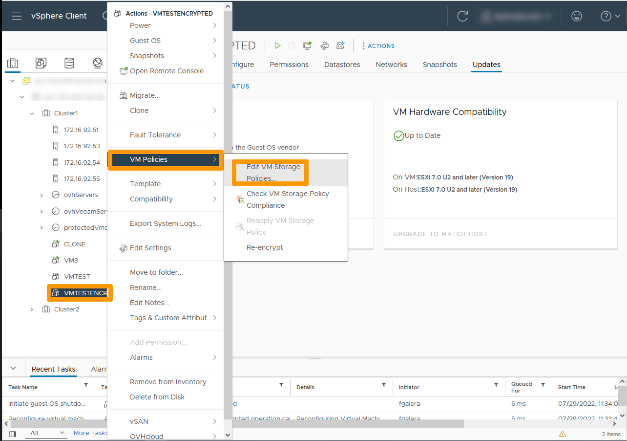

Right-click on the virtual machine and from the VM Policies menu choose Edit VM Storage Policies.
02 encrypt VM 01

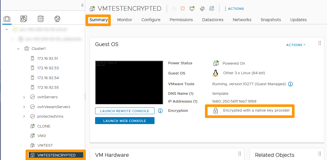

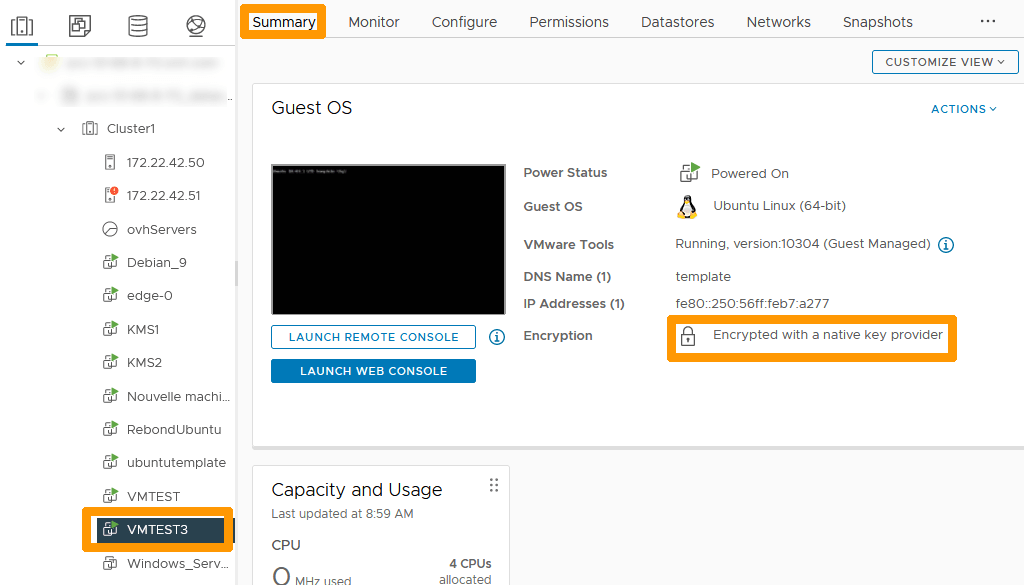

In the virtual machine properties, click the Summary tab. You will see a padlock followed by the text Encrypted with a native key provider indicating that the VM is encrypted.
02 encrypt VM 03

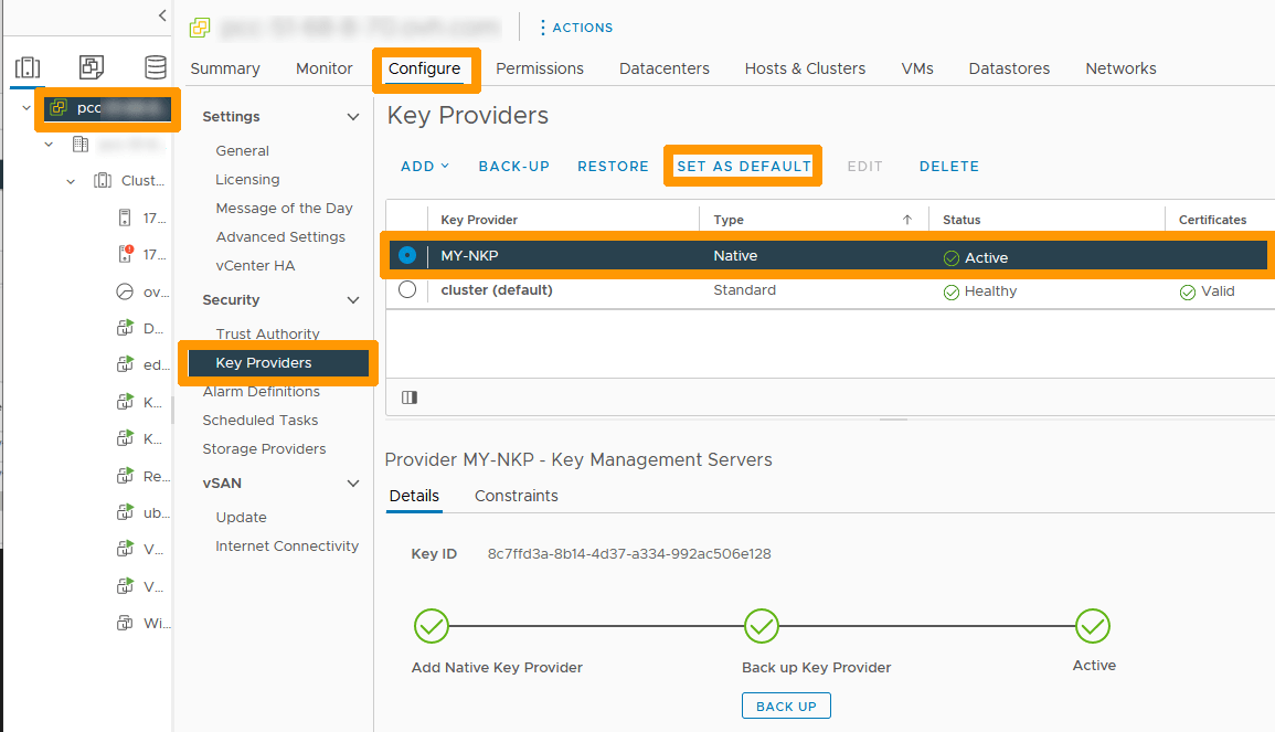

In the vSphere console for your cluster, click on the cluster root in the top left-hand corner.
Go to the top in the Configure tab.
Click Key Providers in the vertical bar, go to the vSphere Native Key provider key and click SET AS DEFAULT.
03 migrate-from-kms-to-vnkp 01
Confirm your choice by clicking SET AS DEFAULT.
03 migrate-from-kms-to-vnkp 02
The vSphere Native Key Provider key is then set by default.
03 migrate-from-kms-to-vnkp 03

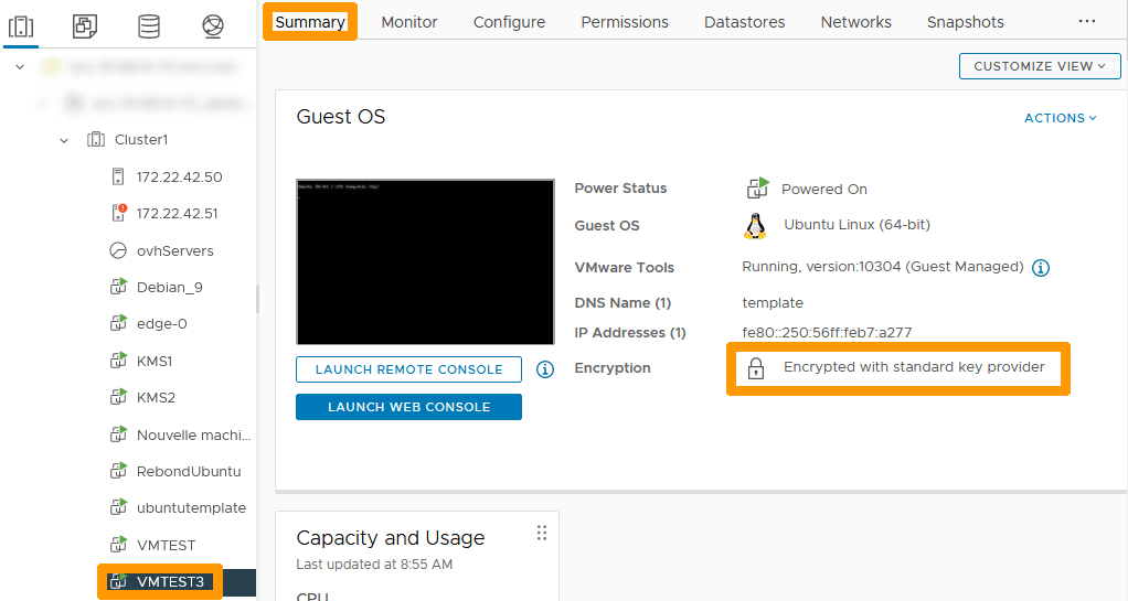

Click the virtual machine and go to Summary tab. This virtual machine uses the standard key provider. We will change the encryption of this virtual machine.
03 migrate-from-kms-to-vnkp 04

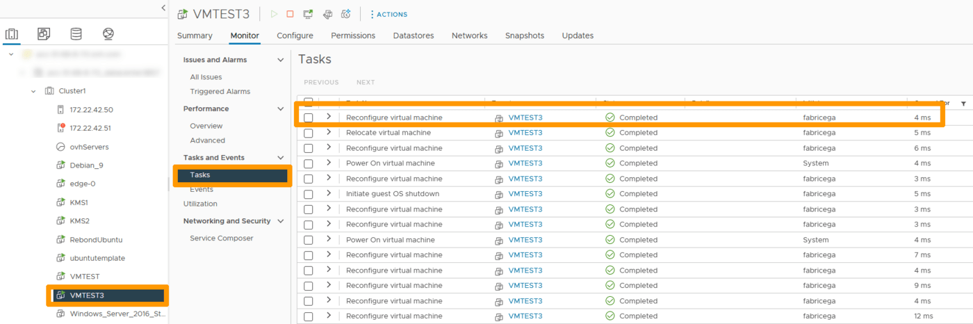

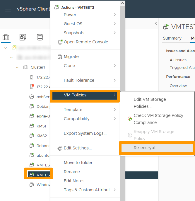

In the vSphere client, right-click on the virtual machine that needs to be encrypted again. In the VM Policies menu entry, choose Re-encrypt.
The operation related to the new encryption can be done with the virtual machine turned on because only the DEK key is encrypted again.
03 migrate-from-kms-to-vnkp 05
The new encryption takes a few milliseconds because the operation performed is only a renewal of the encryption of the DEK key. This key is now encrypted using the new vSphere Native Key Provider key.
03 migrate-from-kms-to-vnkp 06
Click the virtual machine on which the encryption has been changed and go to the Summary tab. You can see that encryption uses a native key provider next to the padlock.
