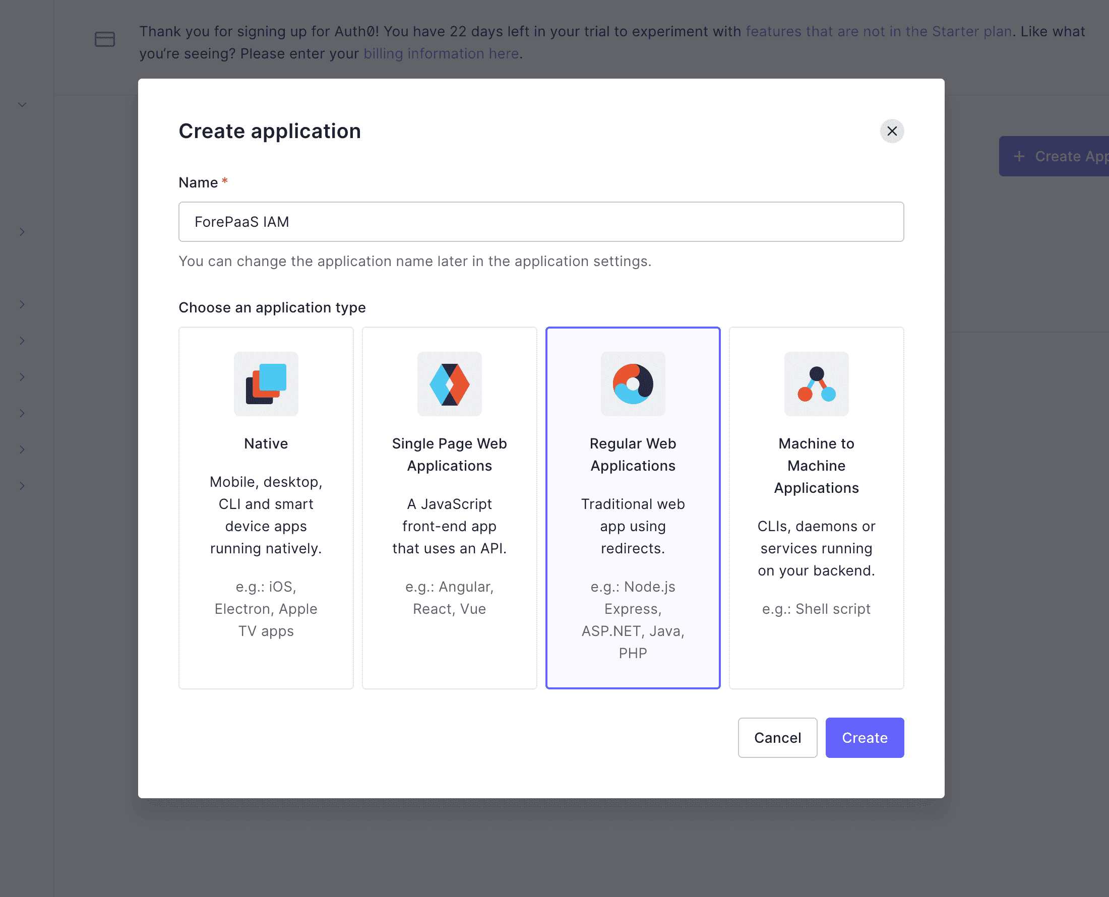

You need to register an application inside of Auth0. This works with any app you would like to connect to Auth0 but in this case, you are going to register the Data Platform IAM directly.

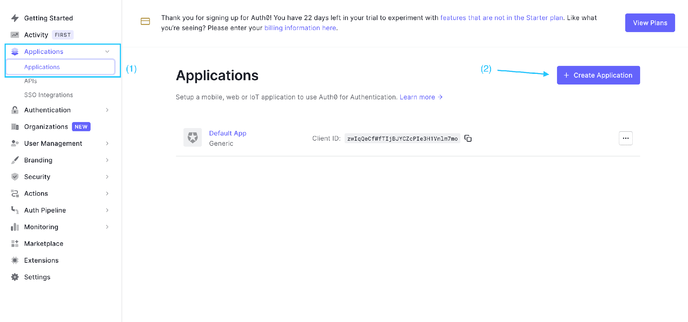

In the sidebar, select Applications. Then click on Create application.
App registration
Select Regular Web Application.
App registration

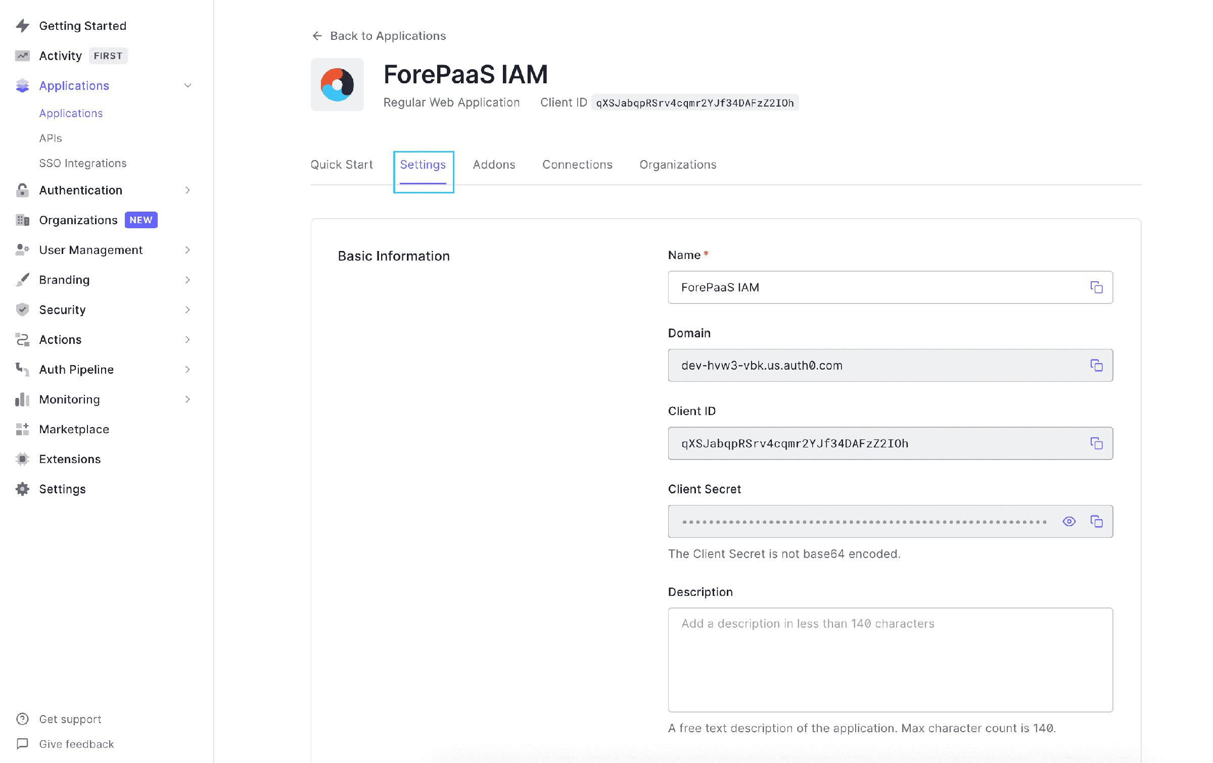

Open the Settings of the newly created application.
App registration

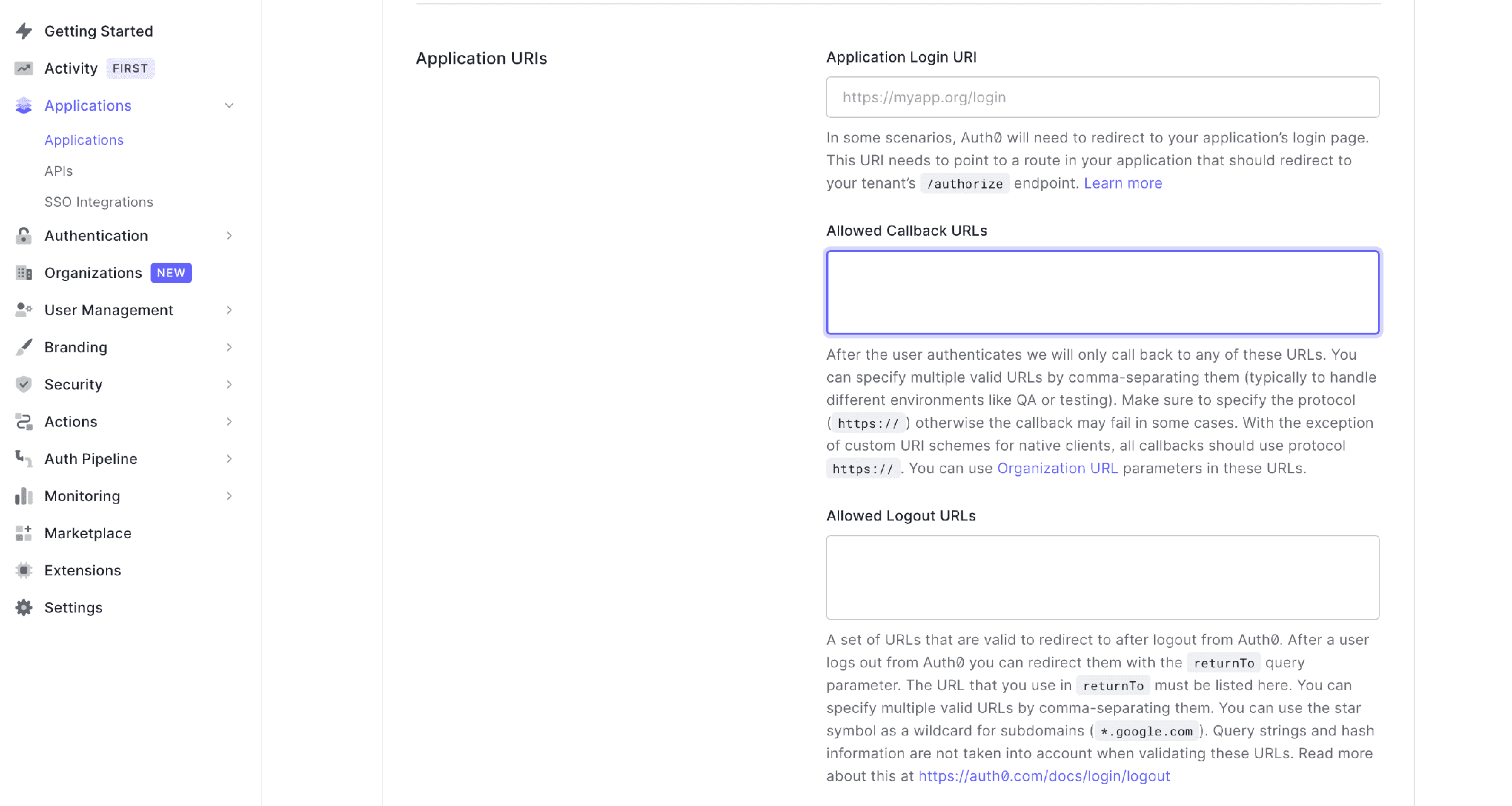

Callback URL
Scroll down to the Allowed Callback URLs section in the Settings page of the application.
App registration
In the URL field, copy and paste the Reply URL field in the new authentication provider you added on Data Platform (it is the same for the entire Data Platform IAM).
App registration

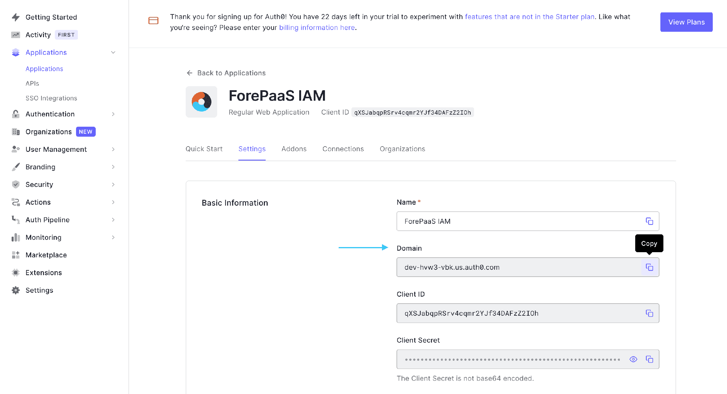

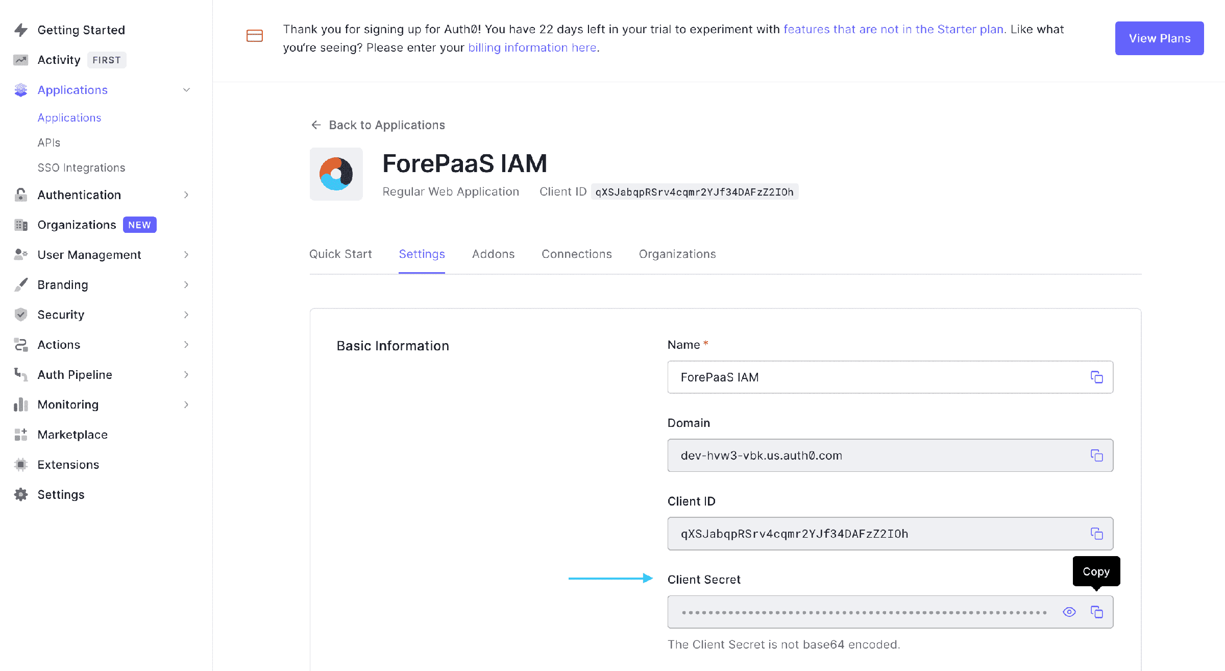

Step 2. Retrieve the Domain
The Domain is the equivalent of your tenant id on Auth0. You can find it in the Settings of the application: look for the Domain section.
App registration
Note that this Domain will be required later on during the IAM configuration.

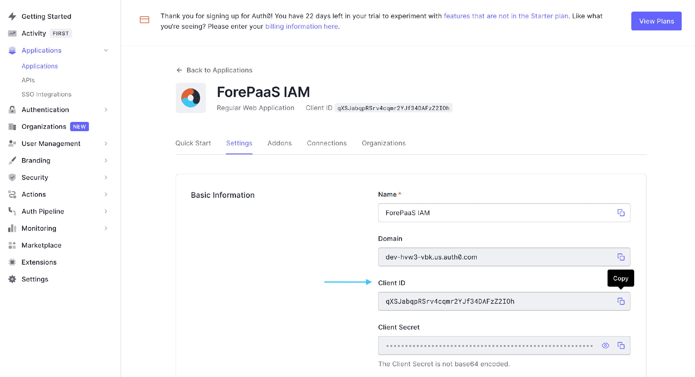

Step 3. Retrieve the Client ID
The Client ID is specific to your application. You can find it in the Settings of the application: look for the Client ID section.
App registration
Note that this Client ID will be required later on during the IAM configuration.
Step 4. Retrieve the Client Secret
The Client Secret is specific to your application. You can find it in the Settings of the application: look for the Client Secret section.
App registration
Note that this Client Secret will be required later on during the IAM configuration.

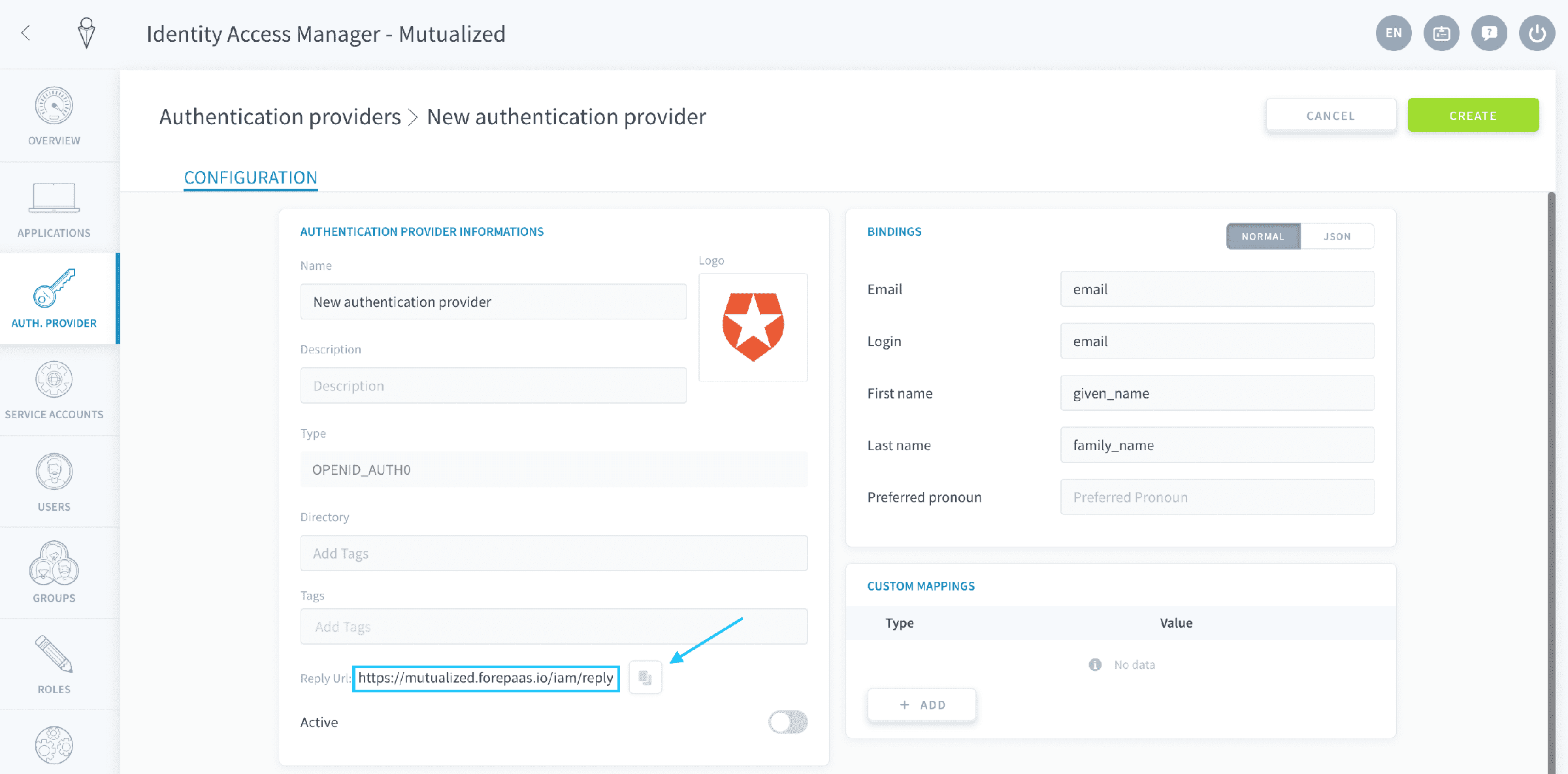

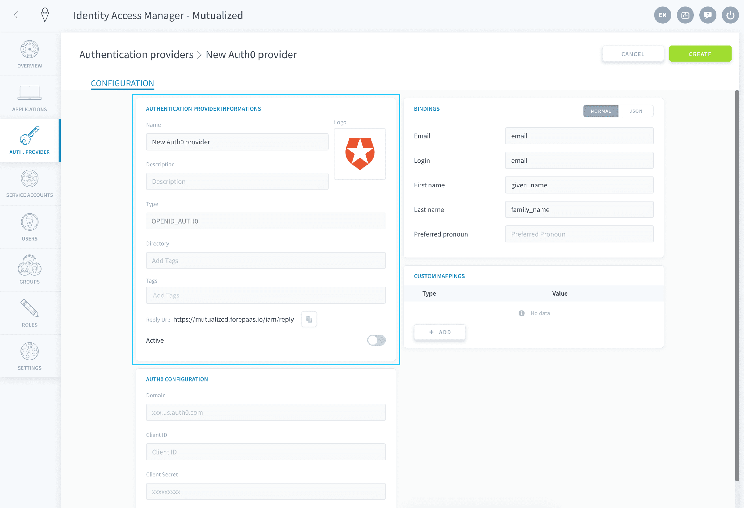

Fill in the basic information
  • Name / Description: This is the internal name and description for your new authentication method
  • Directory: This is a unified tag for all accounts that will be created from this directory. For example, you can input Auth0
  • Tags: This offers more tagging options. They are completely optional
  • Reply URL: This is the Data Platform URL where your authentication provider redirects to
  • Active: This specifies whether this authentication provider can be used to login or not

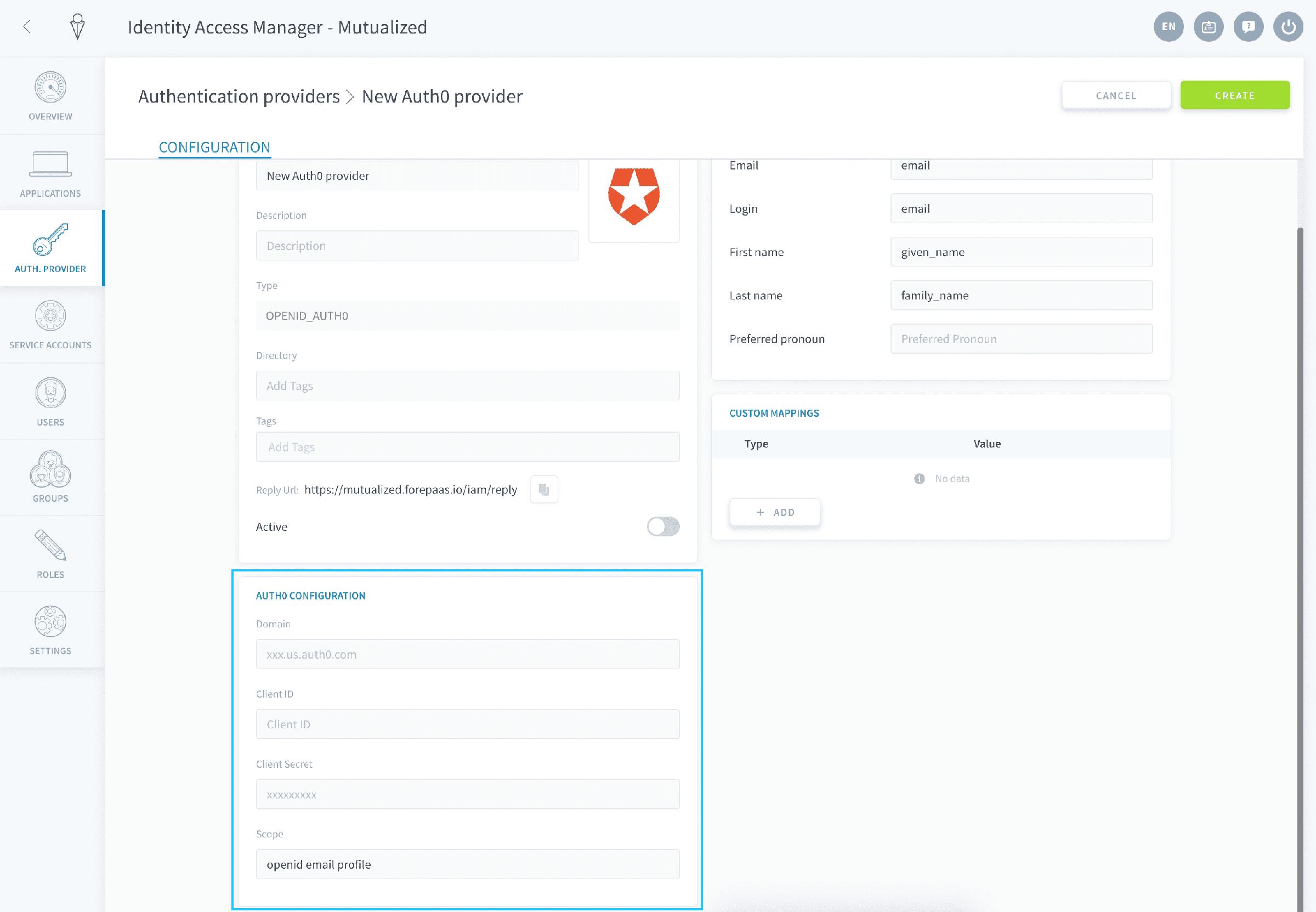

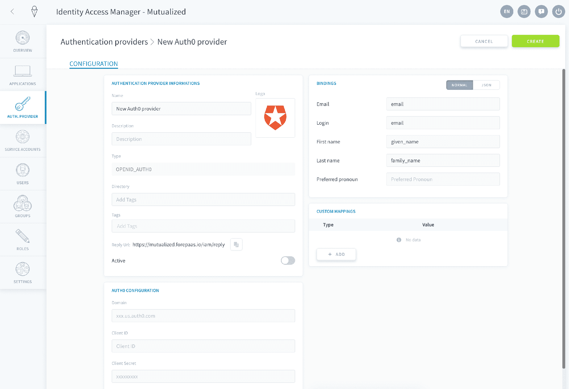

Fill in Auth0 configuration
Now locate the Auth0 Configuration panel.
Fill in Auth0 configuration — Auth0 config2
Fill in the information collected on Auth0 in the previous section, as such:
  • Domain: Domain (retrieved in step 2 of the configuration on Auth0)
  • Client ID: Client ID (retrieved in step 3 of the configuration on Auth0)
  • Client Secret: Client Secret (retrieved in step 4 of the configuration on Auth0)
  • Scope: This represents how much information Data Platform will be able to access from your Auth0. This field is optional: the default value is openid email profile

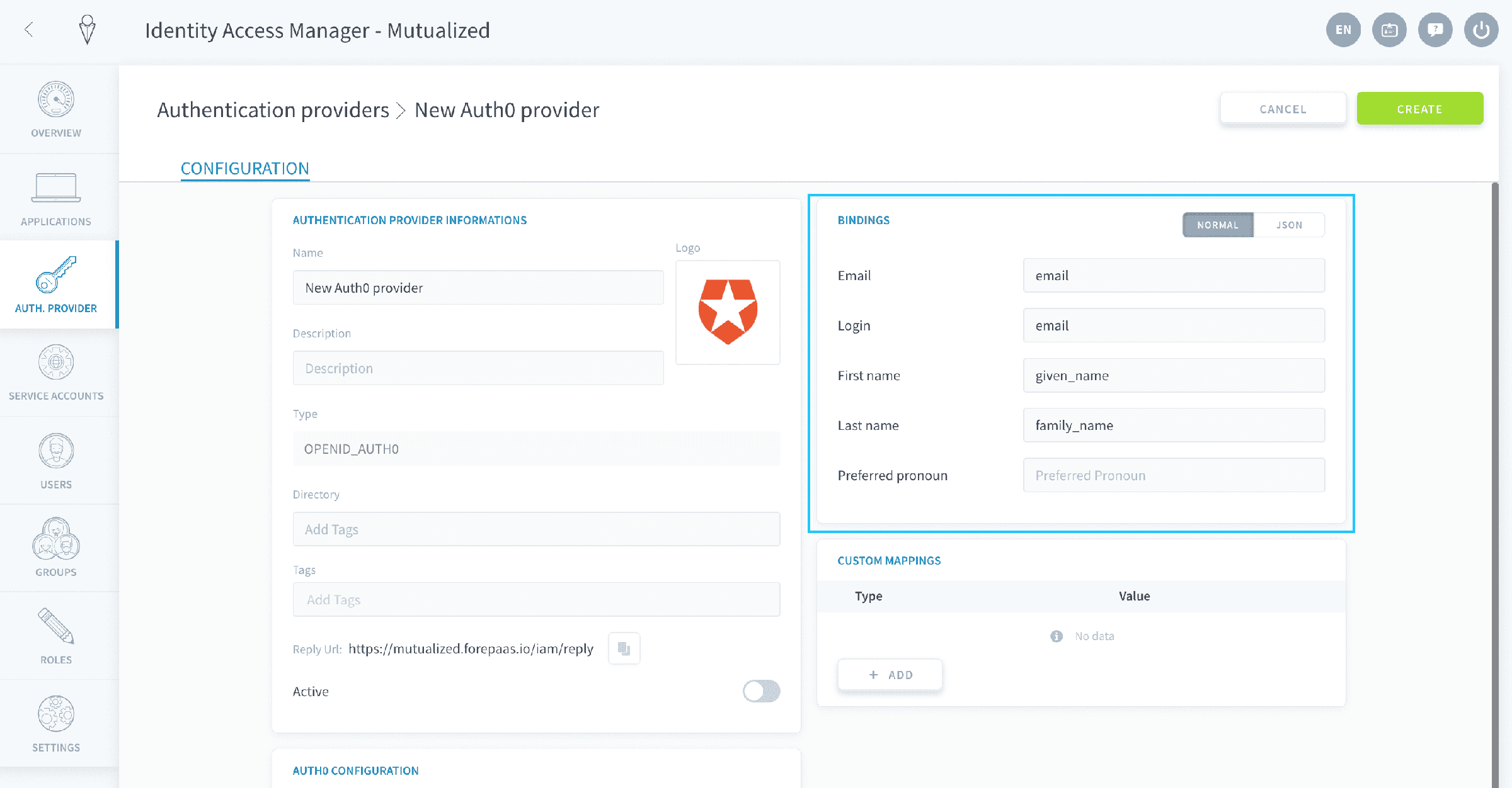

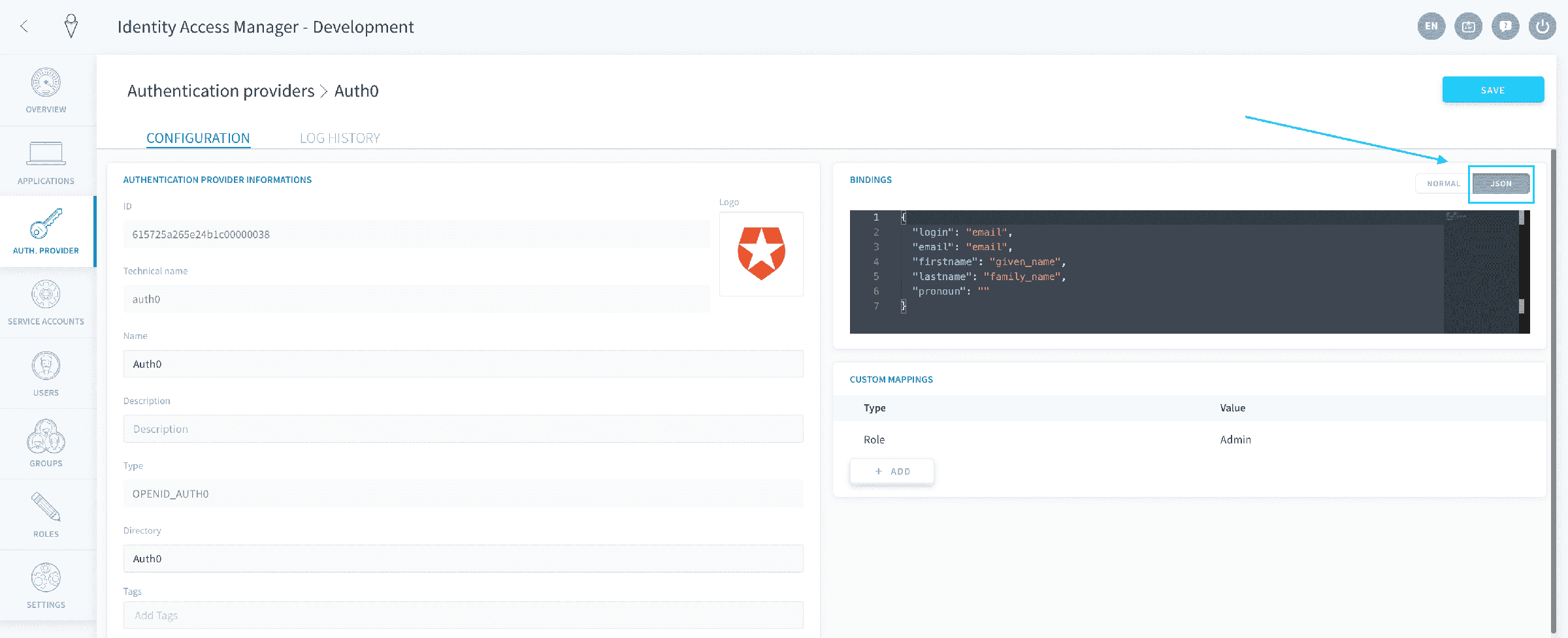

The Bindings panel allows you to customize the mapping of the fields between Auth0 and Data Platform.
Email, login, first and last name are mapped by default.
Fill in the bindings rules — Auth0 bindings
Bindings can be overriden if you need to save additional information from Auth0 into your Data Platform Identity Access Manager, like the job title.

4 - On top of the default email, login, first and last name, any additional property from Auth0 can be saved as a custom configuration.XXX field on Data Platform by using the "JSON" mode.
Fill in the bindings rules — Auth0 bindings2
For example, you can add a fullname property on Data Platform from the name field from Auth0:
  "login": "email",
  "email": "email",
  "pronoun": "",
  "firstname": "given_name",
  "lastname": "family_name",
  "configuration.fullname": "name"
Test the result of your bindings by checking the logs of further test connections in Log History: the Computed Result section of each login will show what properties have been saved in Data Platform.

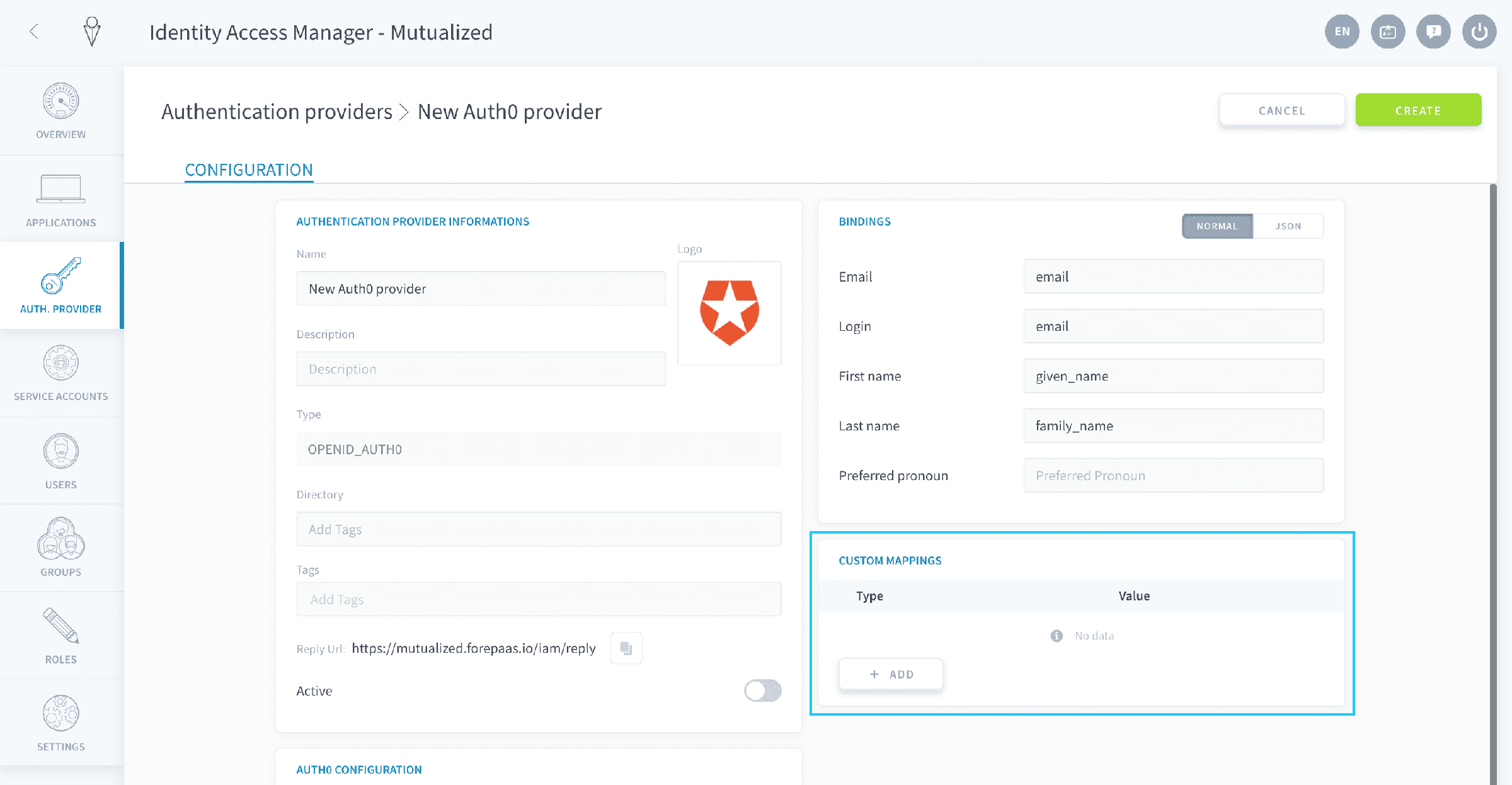

Custom mappings
The Custom mappings panel allows you to automatically assign all users logged in through this authentication provider to a role or a group.
Custom mappings — Auth0 custom mapping
Learn how to set up custom mappings.

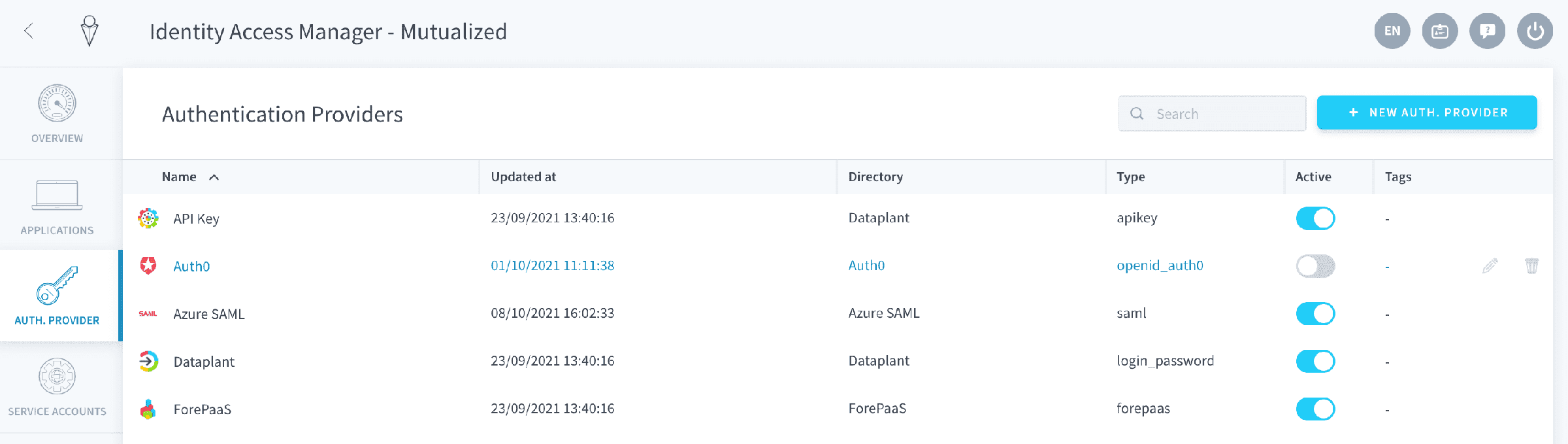

You are all set configuring your Auth0 connector! If you haven't done it already, click on Create - else make sure to Save.
In the Authentication Providers list, you now see your new method. Make sure you set it as active.
