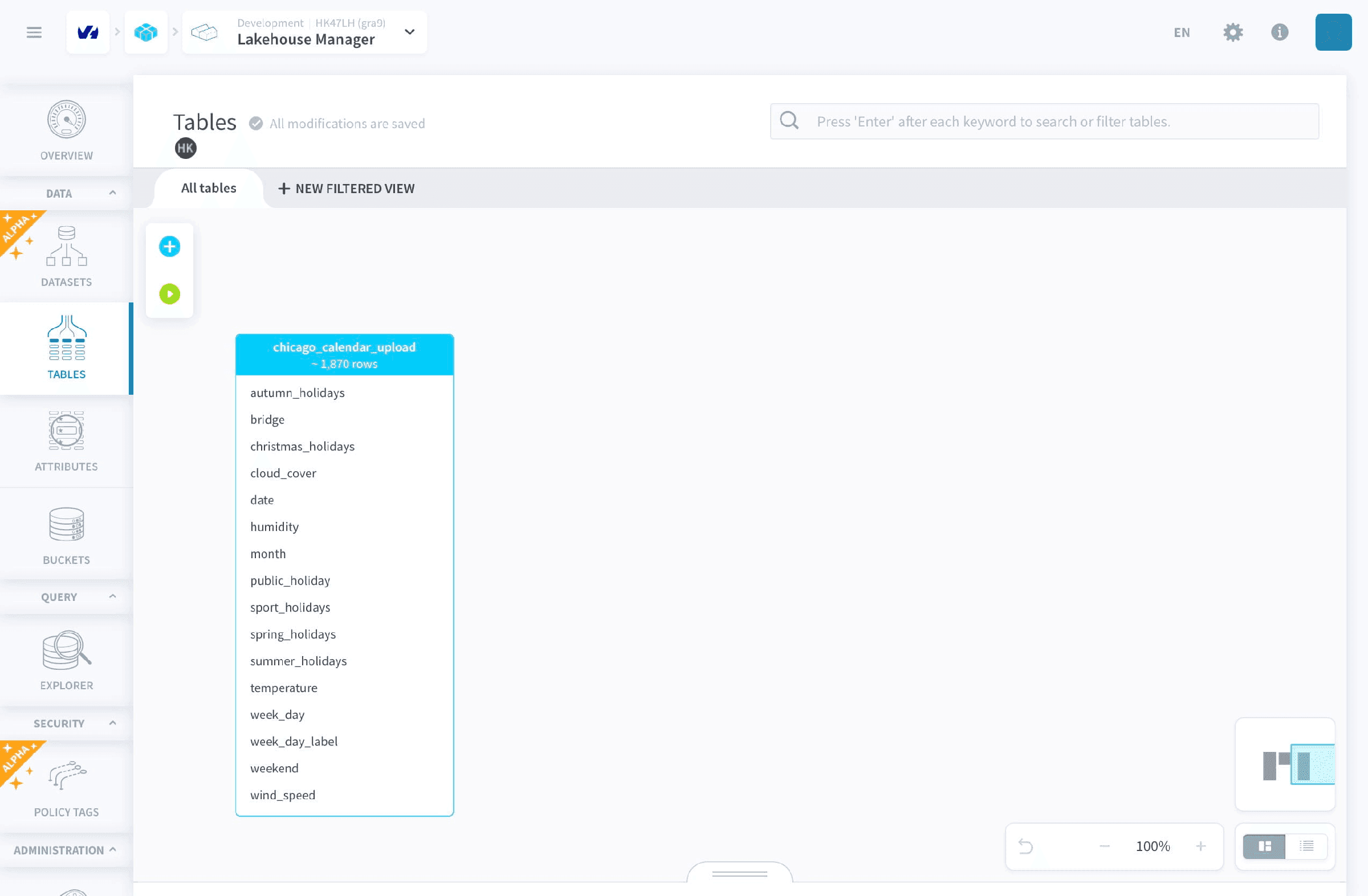

When you access the Tables tab, you will be in the Canvas view-mode, selected by default
Tables give you full control over your data lake / data warehouse (tables and attributes) by providing a visual and logical structure of tables within datasets on a single screen.
Tables3
When you access the Tables tab, you will be in the Canvas view-mode, selected by default. This view-mode is designed to provide a visual depiction of your data. However, this representation can be overwhelming if there are too many tables. That is why we also provide the List view-mode.
Note that some features are only available on one of the view-modes. For instance, linking tables of external datasets is only doable in Canvas-view.

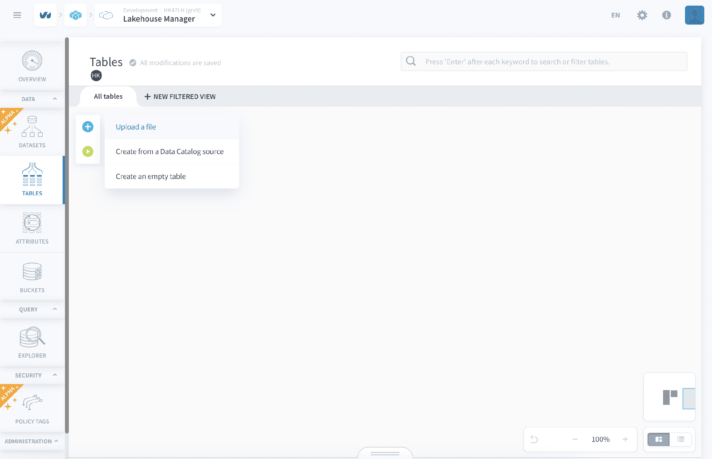

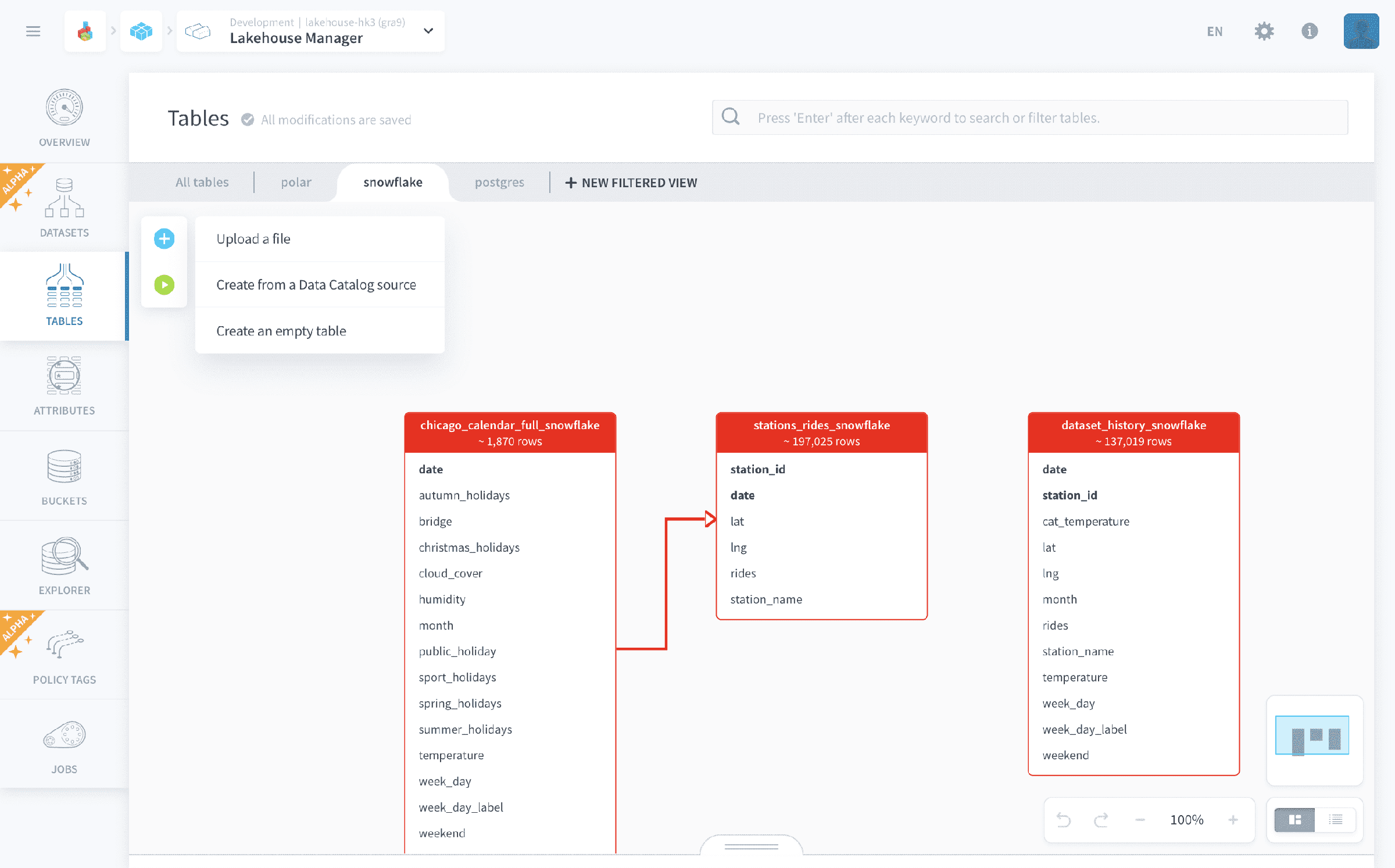

Hover over the + icon (or the New table button if you are in list mode) to see the options for creating a new table on the schema:
  • Create a table by uploading a file
  • Create a table from source
  • Create an empty table

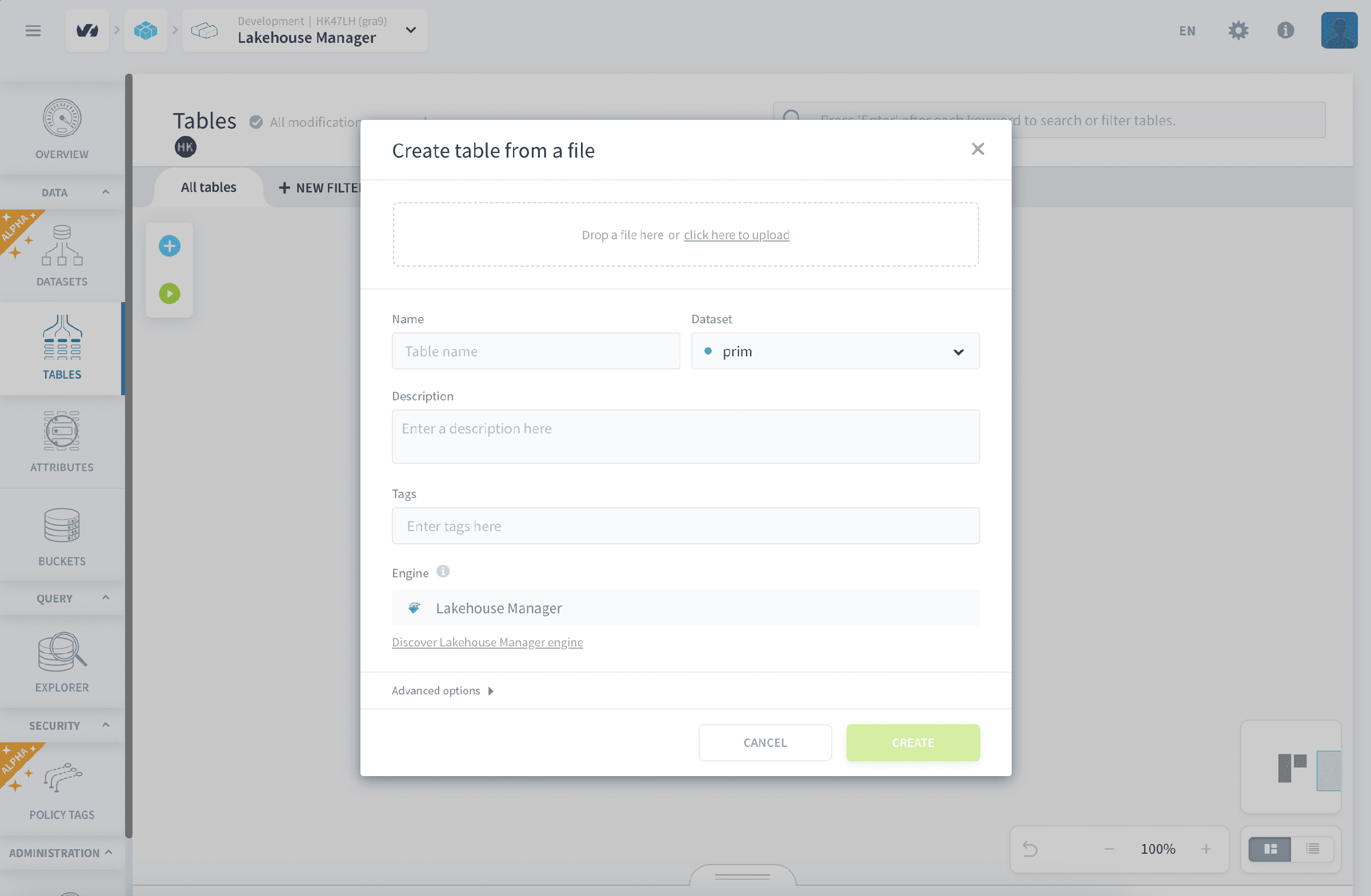

  1. Click on ➕ and select - Upload a file
Create table
  1. Upload the file using the options shown on the screen. (Currently support is present for CSV and XLSX files)

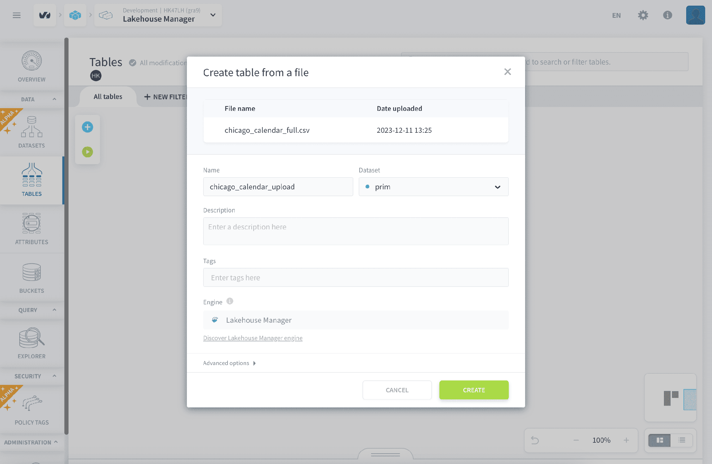

Create table
  1. Set the name and other parameters for the table and click and create.

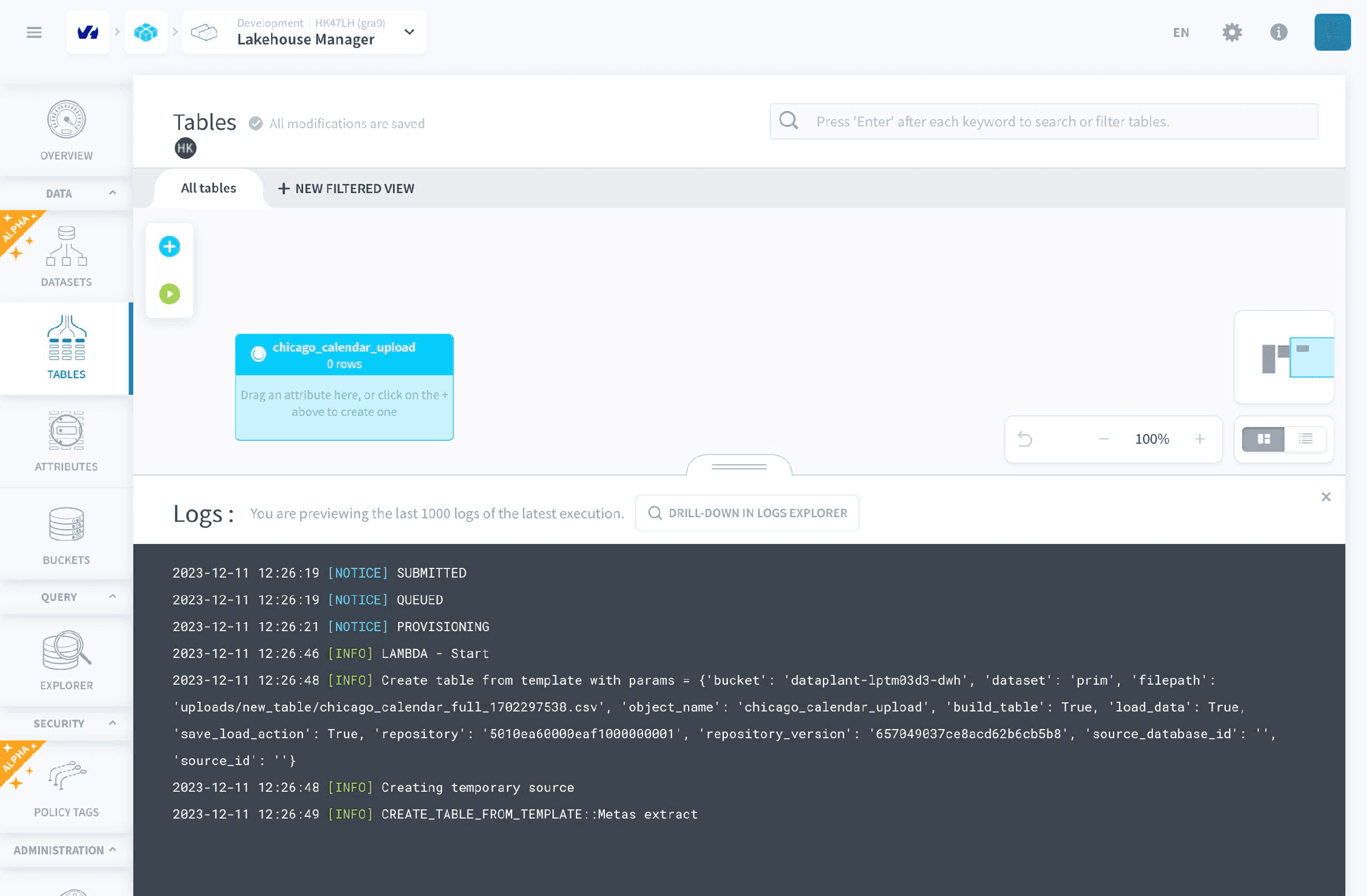

Create table
Now the uploaded file will go through the analyzer and a meta extract process and a job will be triggered which will build the table and load it with data.
Create table Create table

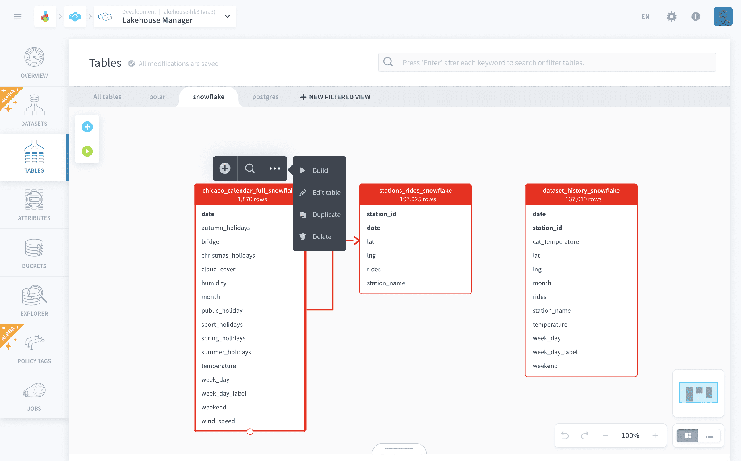

On Lakehouse Manager interface, when you hover over a table (List-view) or click on it (Canvas-view) you will see that a series of buttons are displayed. You can use them to interact with the table; some common interactions are :
  • ➕ - add an attribute (can be a dimension or measure).
  • 🔍 - preview the table within Explorer.
  • ✏️ - edit the table.
  • ▶️ - build the table.
  • 🗑 - delete the table.

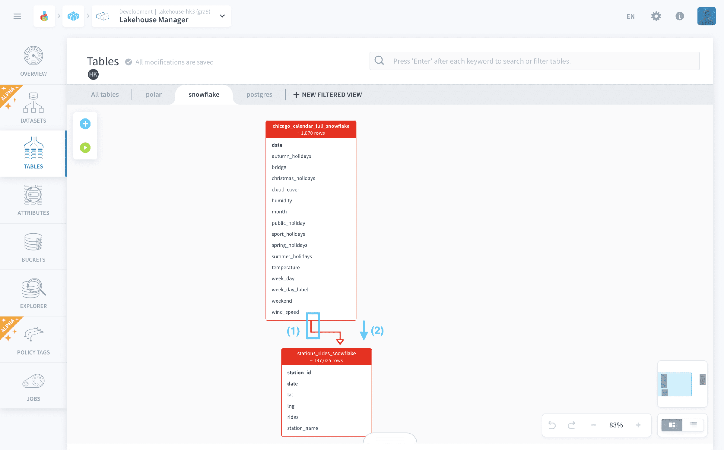

Linking tables is on possible for tables of external datasets
Lakehouse Manager allows you to link a table (the parent) to other tables (children tables) in order to model an 'inheritance-like' system for the information in your data warehouse.
Concretely, this allows you to centralize information in one single referential table - the parent table - which in turn is referenced in many other children table via IDs. Linking tables allows to automate the configuration of Aggregate actions (which allow you to join multiple tables into a single aggregated table when you execute them) when you create them in the Data Processing Engine
The primary key(s) of the parent table must be present in the children table - if they're not, they will be automatically created as you link both tables.
For example, if you are representing a news article in with your data. There is a table called articles with fields for article_id, headline, content, date and author. But instead of placing a name in the author field, you could have the ID value of a user in a separate authors table with fields such as author_id, first_name, and last_name. Therefore, if you need to update an author’s name, you only need to do so in the authors table (parent); because the articles table (child) only contains the ID of the corresponding author record.

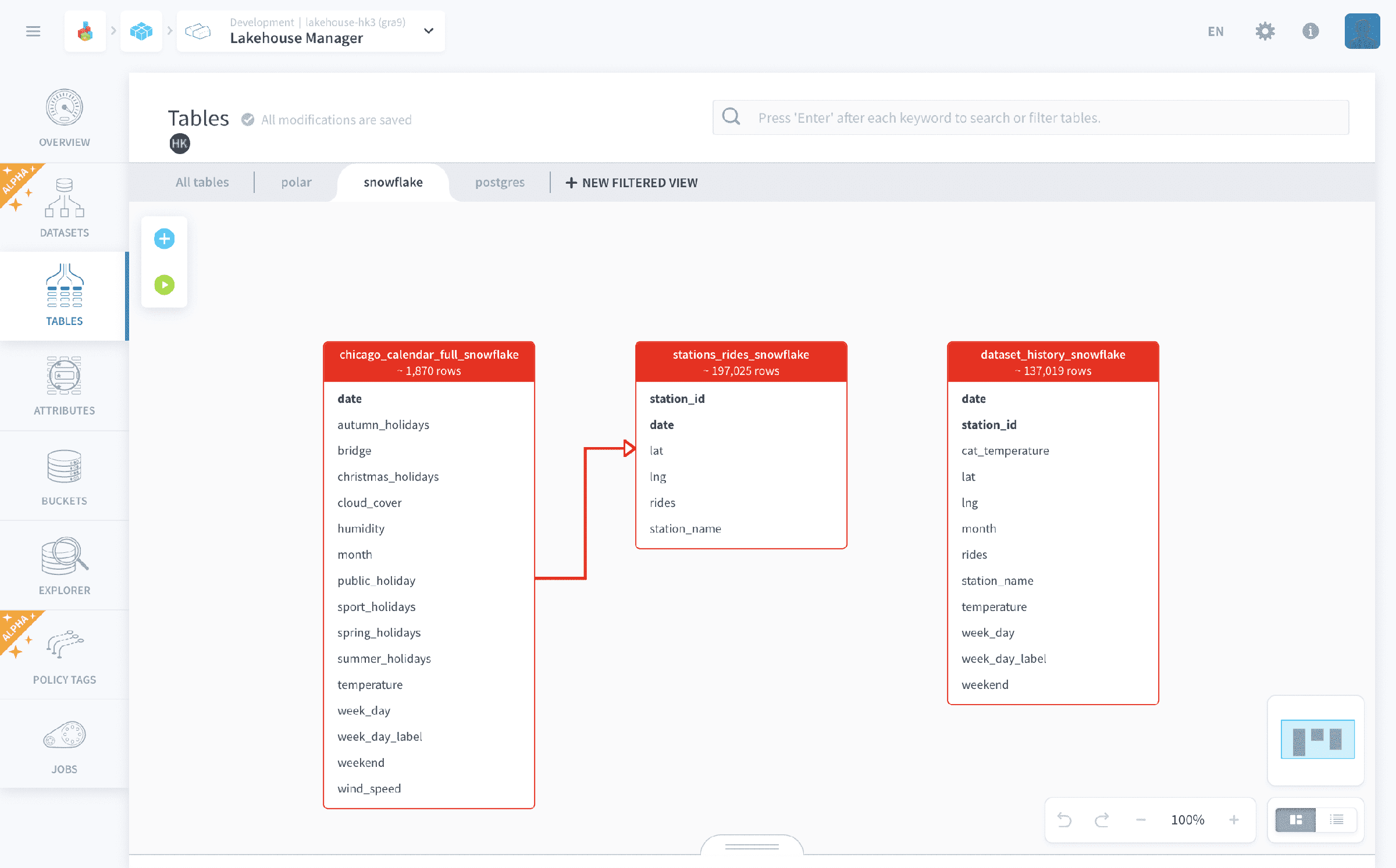

Link a parent table to a child table by clicking on the white circle at the bottom of the parent table (1) and dragging the arrow to the child table (2).
Child Parent
As a rule of thumb, you want to start from the table which contains all the reference data, a link it into a table which only has an ID referencing that initial table.

Tables1

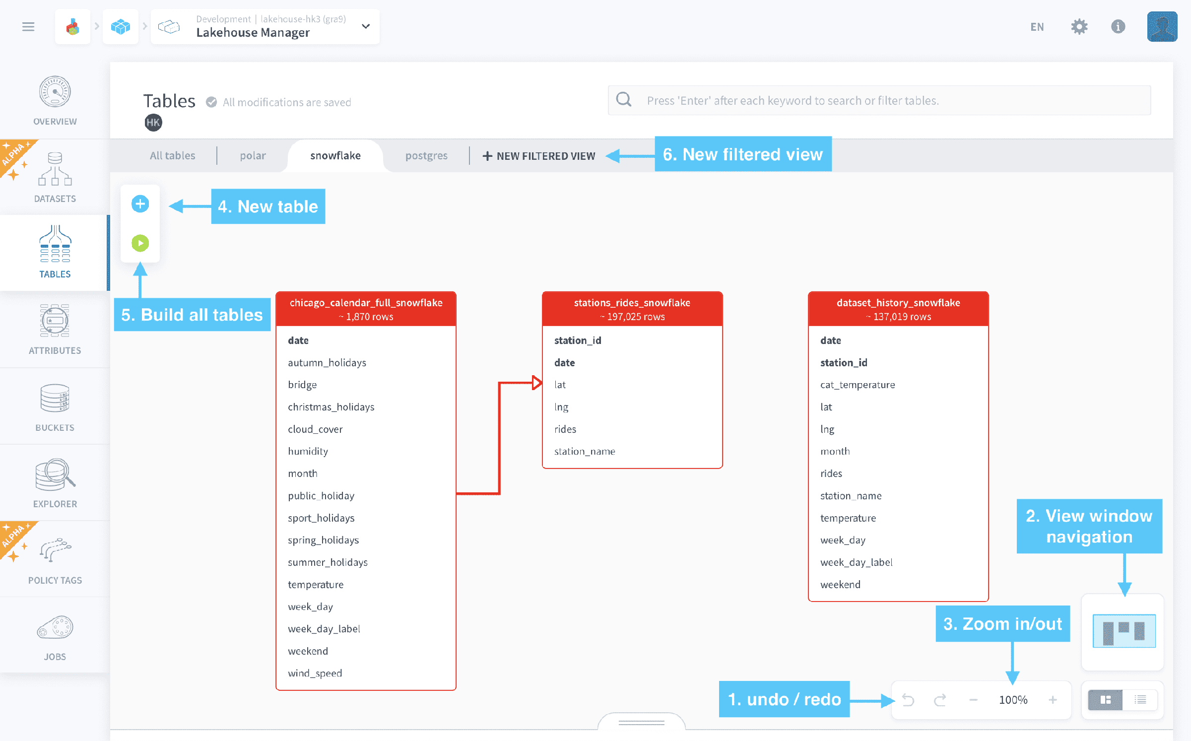

You can navigate the schema by clicking on any blank space in the schema and then moving your cursor. If there are a lot of tables, you can move the view window navigation (indicated by 2) by clicking on it and moving your cursor. Additionally, you can zoom in/out on your data schema (indicated by 3).
At any point of organizing your tables, Lakehouse Manager autosaves all the visual modifications of your data schema.
Use the undo-redo options (indicated by 1) to move back/forward on any change you just made in the schema. You will go back/forward to an immediate previous state of your work.
Filtered tabs
the platform allows you to choose to work on a selected set of tables (which could be specific to a team or Project within your organization). You can add a New Filtered Tab for doing this (indicated by 6).
Note - The default tab has All Tables with All Users.

Hover your mouse over a table to display some table interactions and hover over the ... icon to display the rest.
Access our table interactions documentation to find out more about actions available on a table.

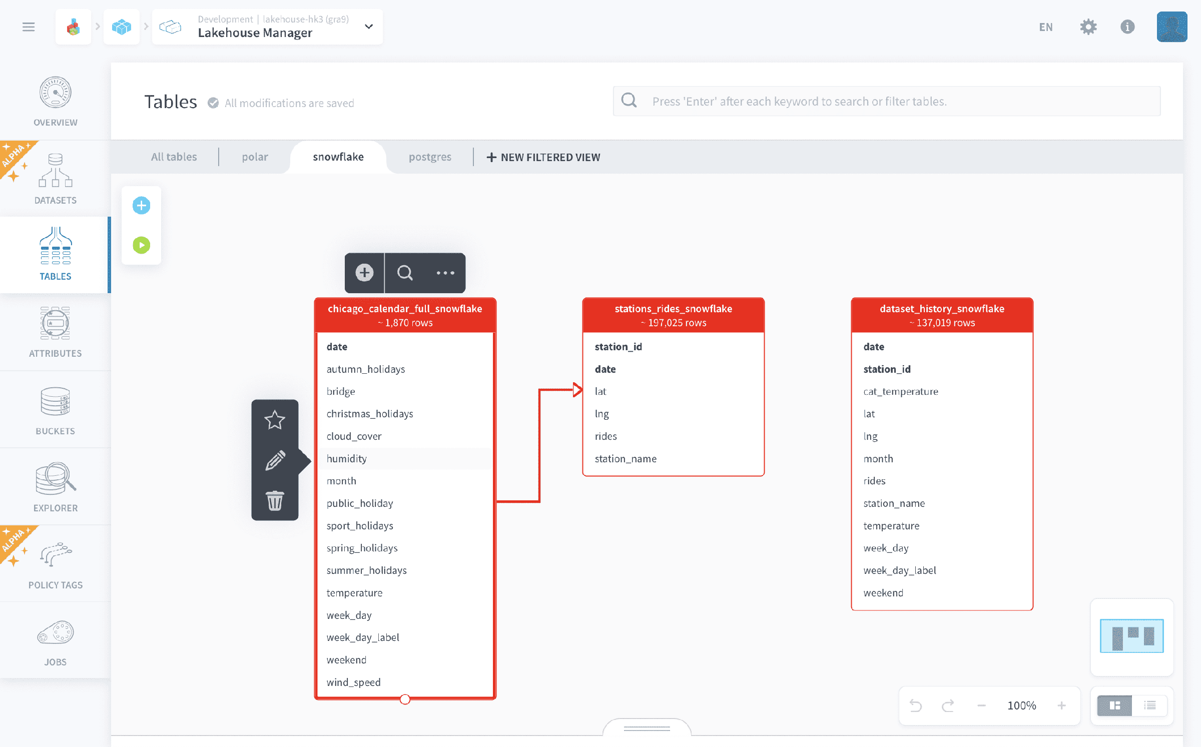

In the Canvas view-mode you can also easily manipulate the attributes of each table. Hovering your cursor over an attribute will display attribute interactions:
  • Set it as a Primary key by clicking on ⭐️ (only available for tables in external datasets)
  • Edit the attribute by clicking on ✏️
  • Delete the attribute 🗑
