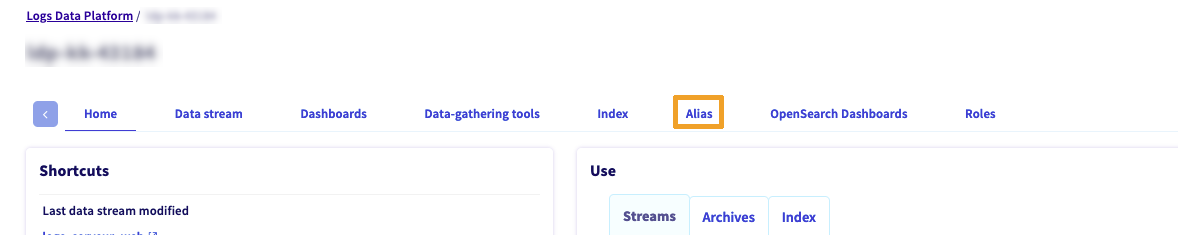

To create an alias in the management interface, go to the Alias section of your Logs Data Platform account as shown in this picture:
Logs Data Platform homepage alias button location

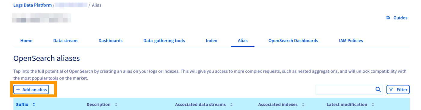

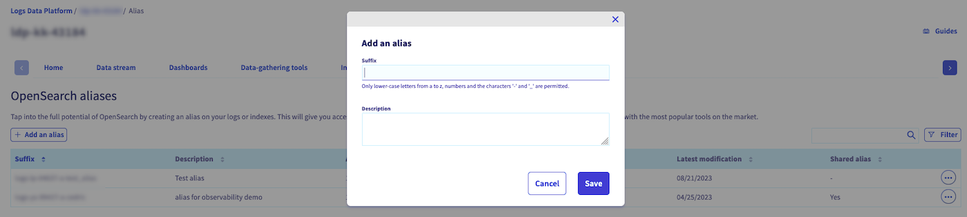

In this section, you can:
  • Create a new alias by clicking on the Add an alias button.
Logs Data Platform homepage alias creation
  • Once created, you can edit the description, access the alias via the OpenSearch web UI or delete the alias via the ... button.

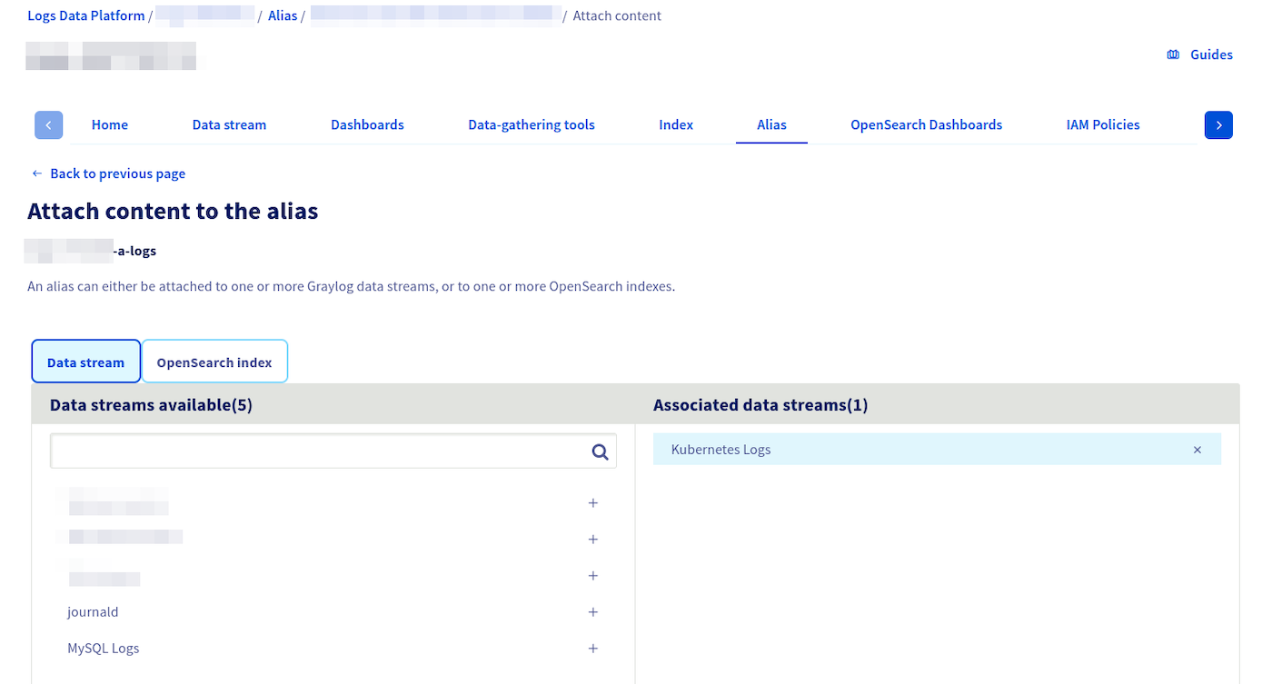

Attach an alias to a stream
  • Attach and detach streams and/or indices to an alias by clicking the ... button and then on the Attach content to the alias button.
  • Then you choose the stream you want to attach to the alias.
Logs Data Platform alias content attachment
Attach an alias to an index
If you use the managed OpenSearch index as a service feature, you can also attach multiple indices to an alias. In that case, attach the alias and configure it as described below.
  • Then you choose the indices tab you want to attach to the alias.
  • Finally you select the indices you want to attach to the alias.

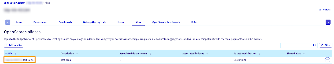

  • An index name. This is your alias name, found on the left column of your alias homepage like in the following picture. It should look like this: <ldp_service_name>-a-<alias_name>.
Logs Data Platform alias name
