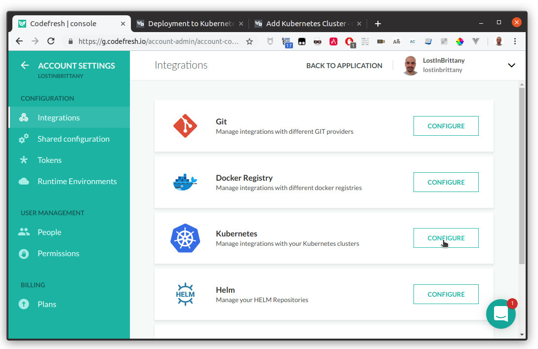

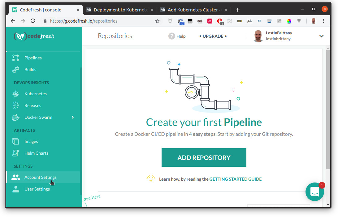

You can use the Codefresh GUI to connect your OVHcloud Managed Kubernetes cluster to Codefresh. In Codefresh GUI, start by going into your Account Configuration, by clicking on Account Settings on the left sidebar. On the first section called Integrations click the Configure button next to Kubernetes.
Connect an OVH Kubernetes cluster to Codefresh dashboard Connect an OVH Kubernetes cluster to Codefresh dashboard

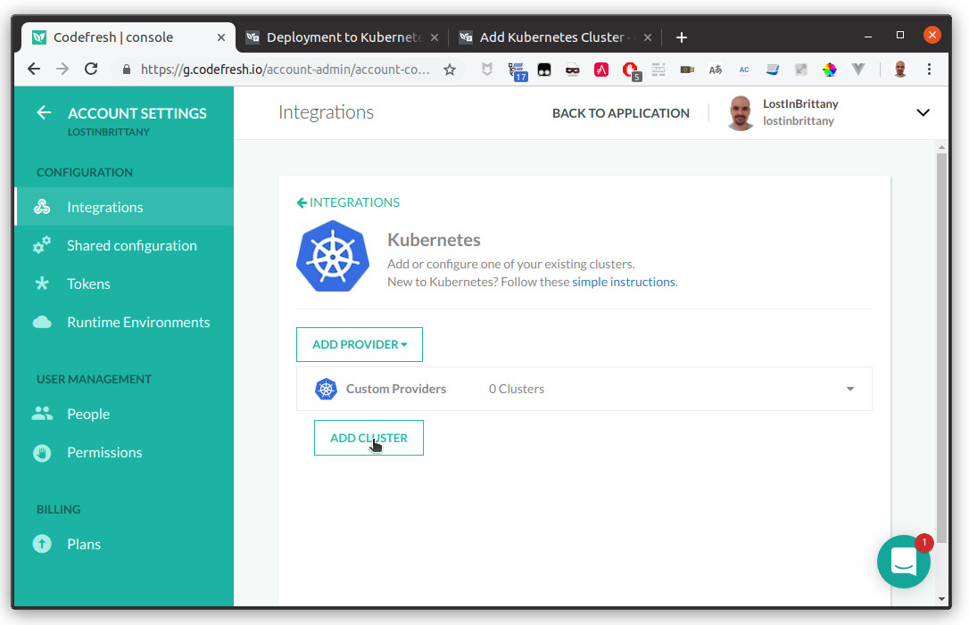

As the current time, Codefresh doesn't propose a direct integration with OVHcloud Managed Kubernetes Service, so you will have to add your cluster manually. To do it, click on the Add provider button and select Custom providers.
Connect an OVH Kubernetes cluster to Codefresh dashboard Connect an OVH Kubernetes cluster to Codefresh dashboard Connect an OVH Kubernetes cluster to Codefresh dashboard

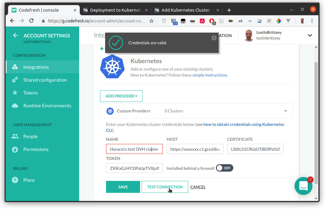

Test and save the connection
Click on the Test connection button to test the configuration. You should get a message telling you that your OVHcloud Managed Kubernetes cluster connects successfully with Codefresh:

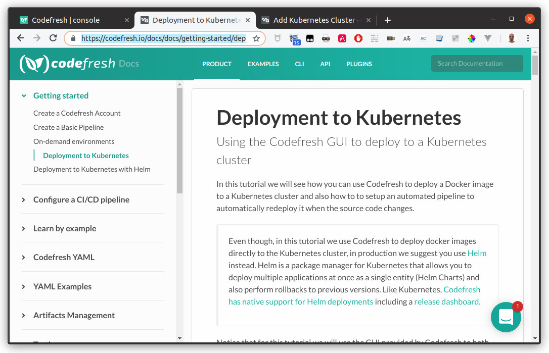

Now you can follow Codefresh official tutorial to deploy a Docker image to a Kubernetes cluster and also how to setup an automated pipeline to automatically redeploy it when the source code changes.
