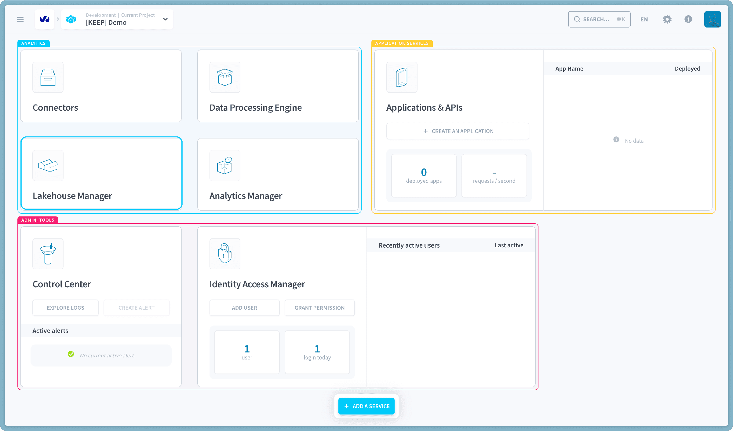

The Lakehouse Manager is the next component you will be using. Using the Lakehouse Manager let us plan out your data structure at the conceptual level
The Lakehouse Manager is the next component you will be using. It is the component that controls:
  • Data warehousing
  • Policy Tag Management
Using the Lakehouse Manager let us plan out your data structure at the conceptual level. This will be done with the help of the Tables functionality.

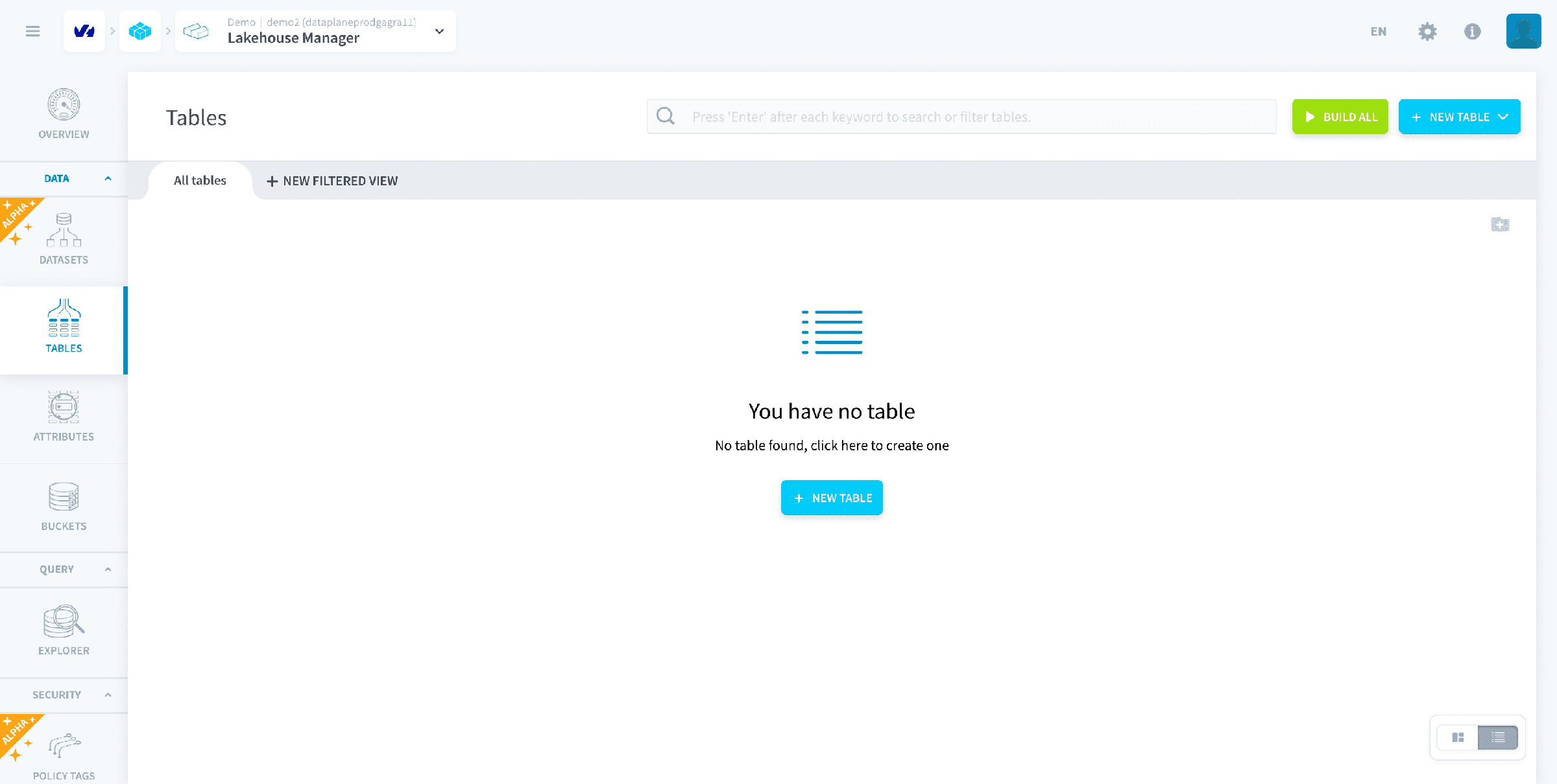

Once that your metadata has been extracted, it's time to head to the Tables dashboard. This is where you will build a unified and queryable view of all your data.
The empty Tables page should look like this.
Lakehouse Manager
The All tables tab is where you have access to the entirety of your data. The New View tab allows you to create views of only a part of your data in order to collaborate better in large teams. Since this is a simple tutorial, you should work in the All tables tab.

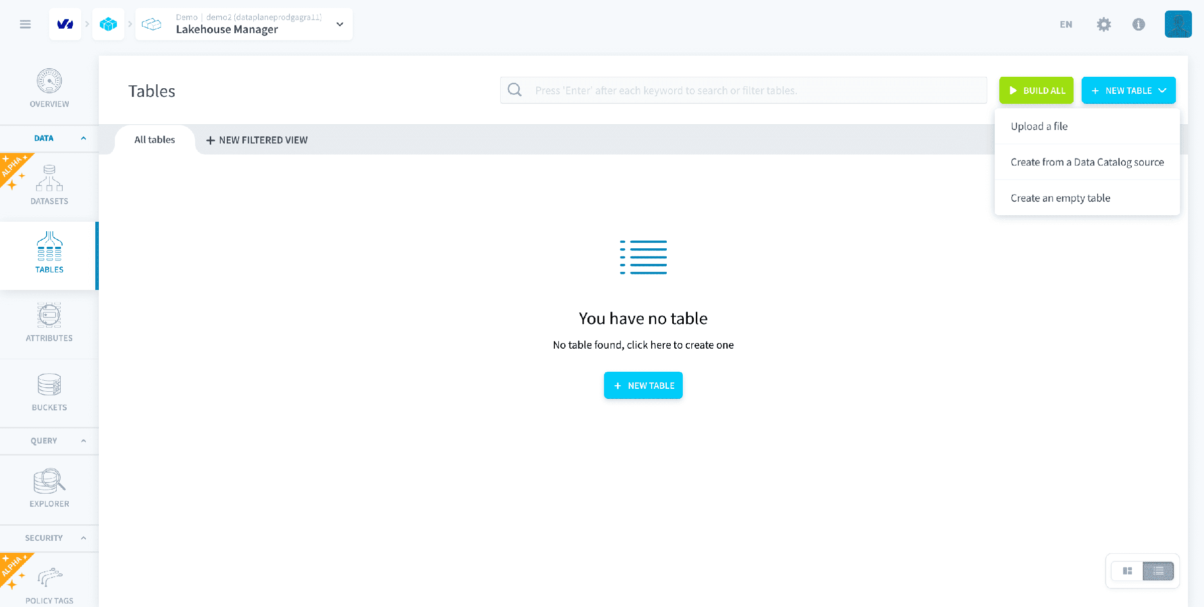

First, hover your cursor over the blue ➕ NEW TABLE button on the right-hand side of the screen. This will reveal the create options :
  • Upload a file
  • Create from Connectors source
  • Create an empty tables
For the purpose of this tutorial, we shall proceed with Create from a Connectors source. To create a table using upload a file refer to the create tables documentation.

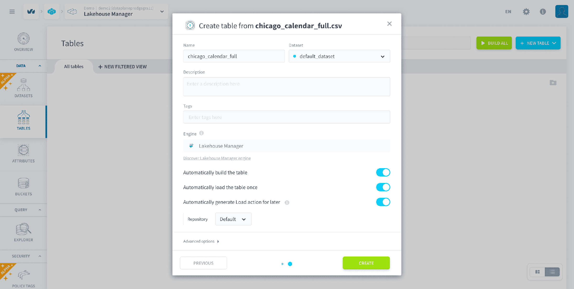

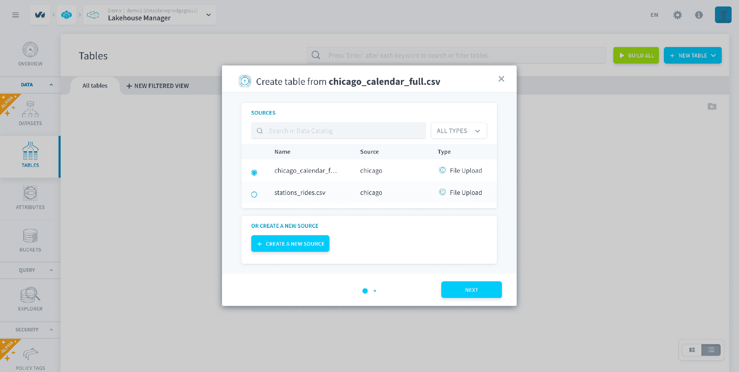

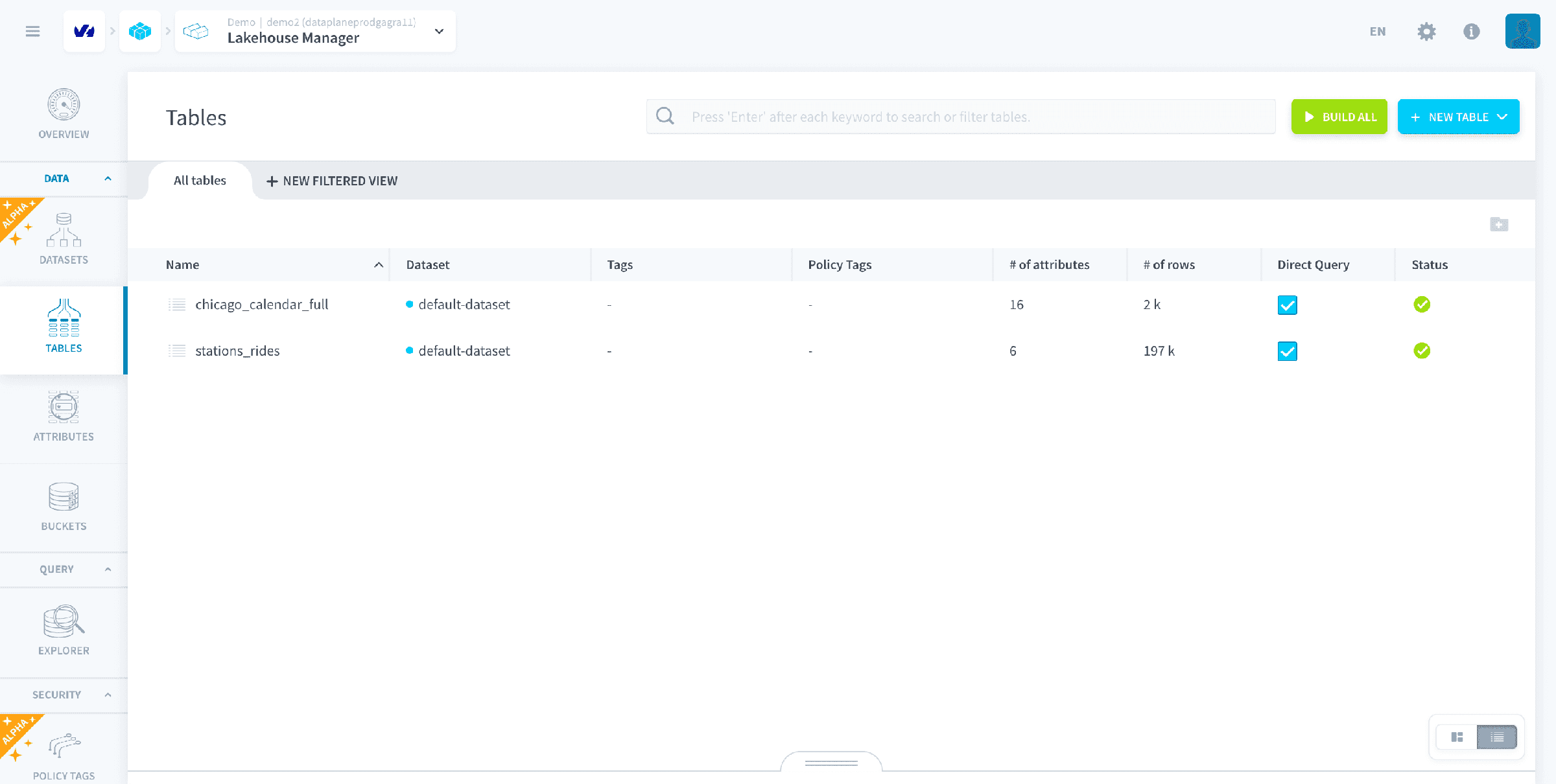

Once you click on create from a connectors source, you will be shown a list of sources from the previous step. Click on source you want to add and proceed further by clicking on Next. No need to change the default settings here.
The options Build the table, load the table once, and generate Load action for later can be disabled and each step can be done individually as well. This can be explored in detail here
Press Create and proceed to repeat the same with the second table as well.
Lakehouse Manager Lakehouse Manager
Note that each time you make a change on the Tables page, your visual configuration is automatically saved.

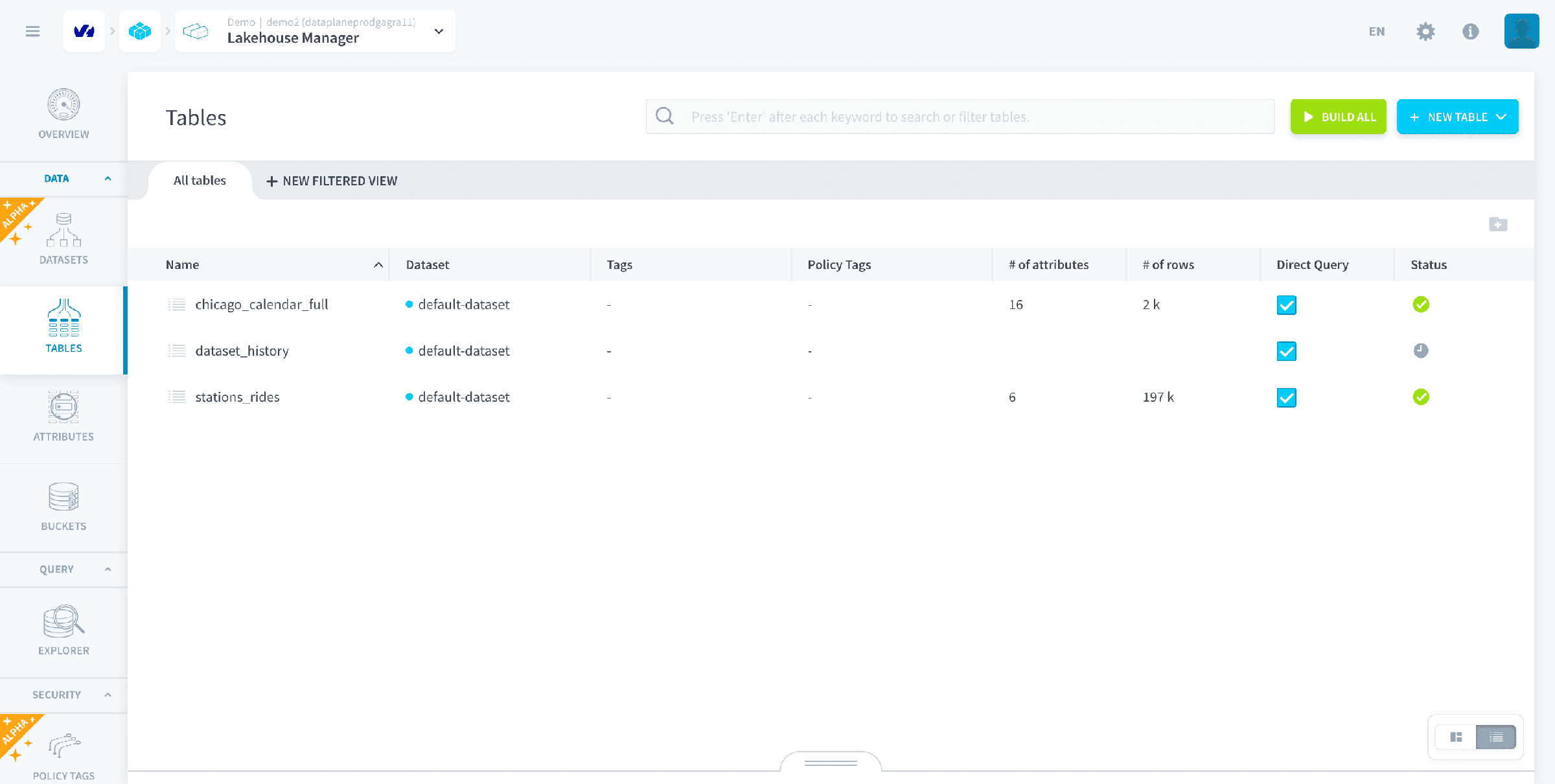

At this stage, your Tables page should look like this.
Lakehouse Manager
Note that the Platform uses the metadata information captured in the Analyzer step to automatically create tables and assign attribute names & types. The source files provided are good to go, however in a real Project you should use the Analyzer to check the data sources, before dragging and dropping them in the Tables page.

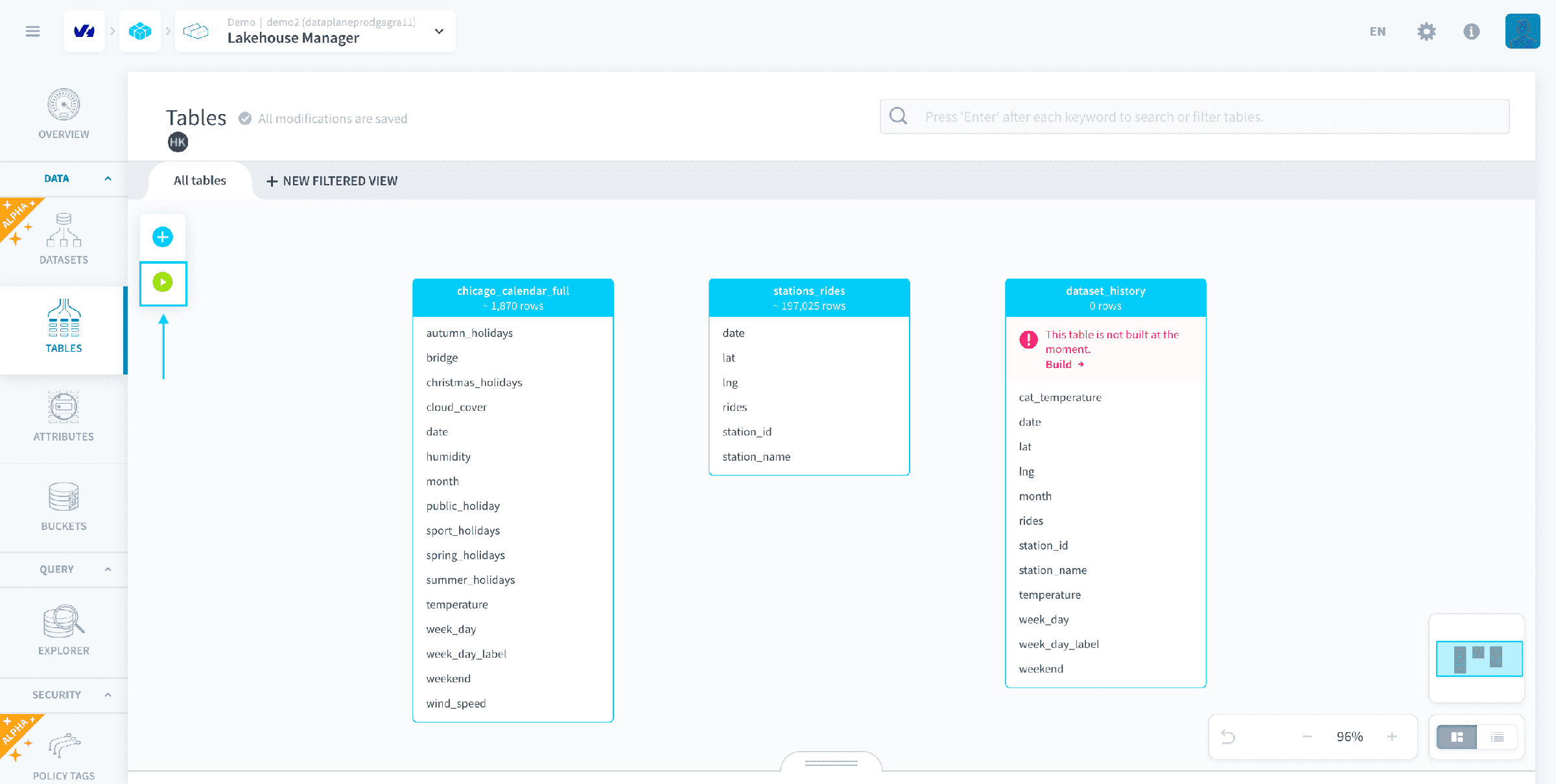

Create your aggregate table

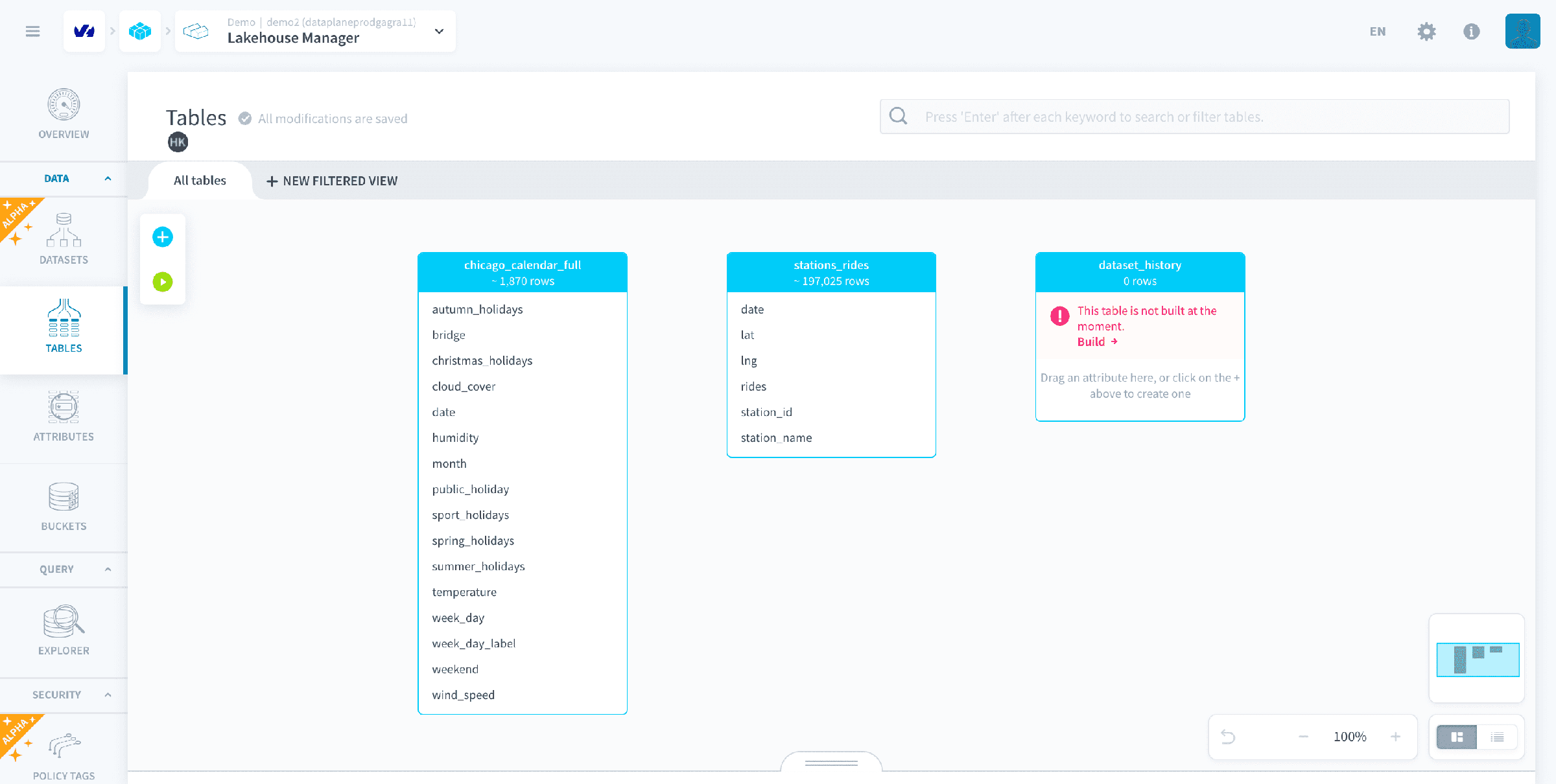

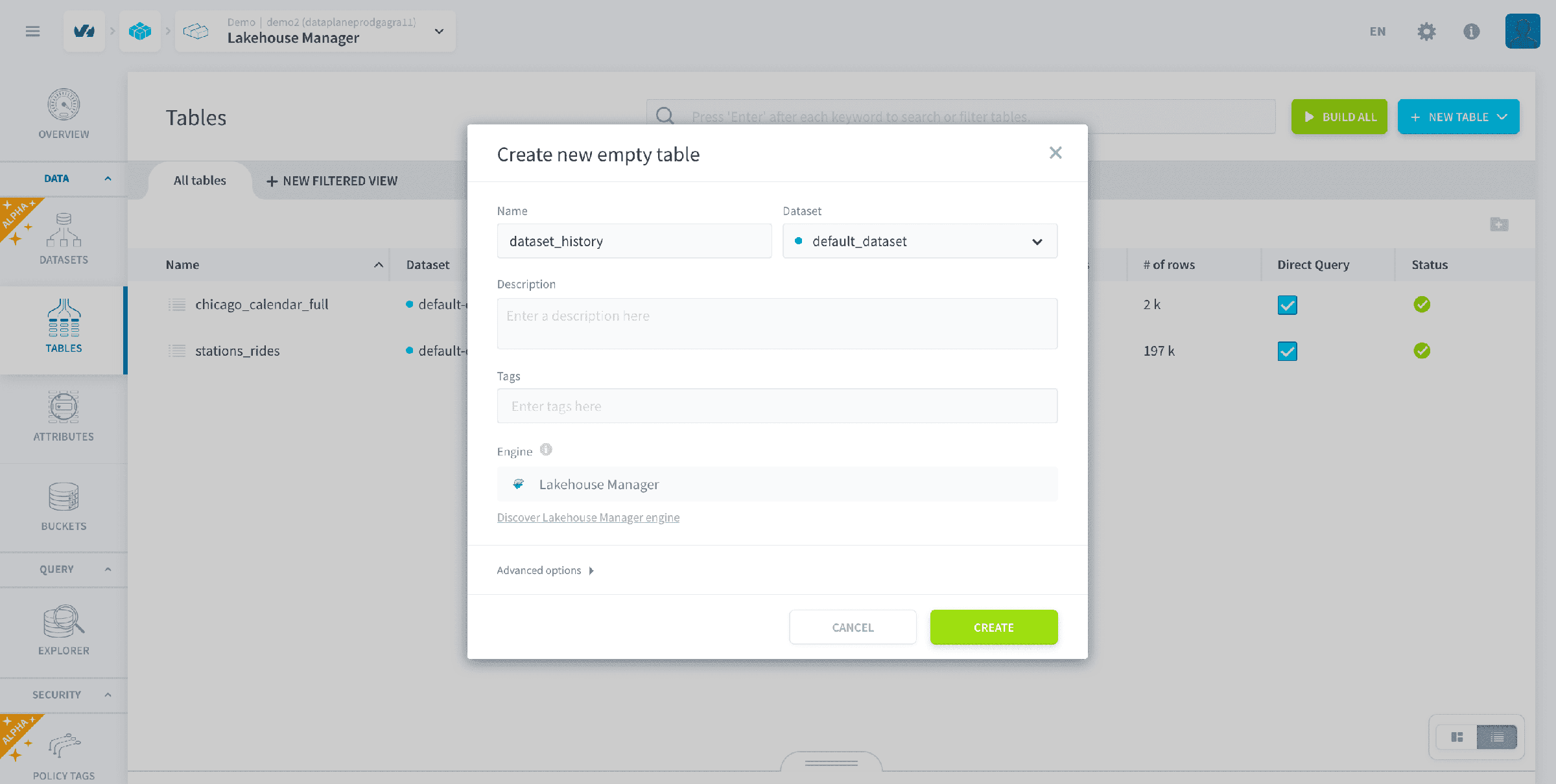

Now, you will aggregate all important data from the sources (namely rides, dates and temperatures) into one table that will be used in the final application.To create your first Aggregate table, click on the blue ➕ icon. Select Create an empty table, and you will be shown a new table configuration. Set a name (dataset_history for example) and save it.
lakehouse manager lakehouse manager

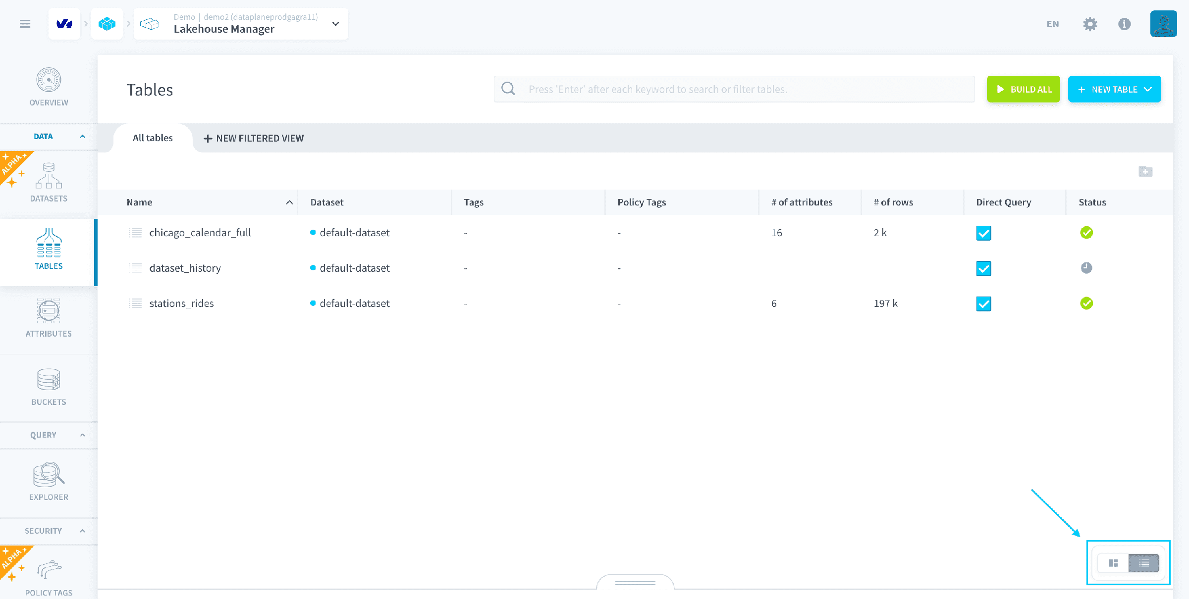

Now, before you start adding attributes to the new empty table you have created you will need to change the view from list to canvas on the bottom right side of the screen to make the next steps easier.

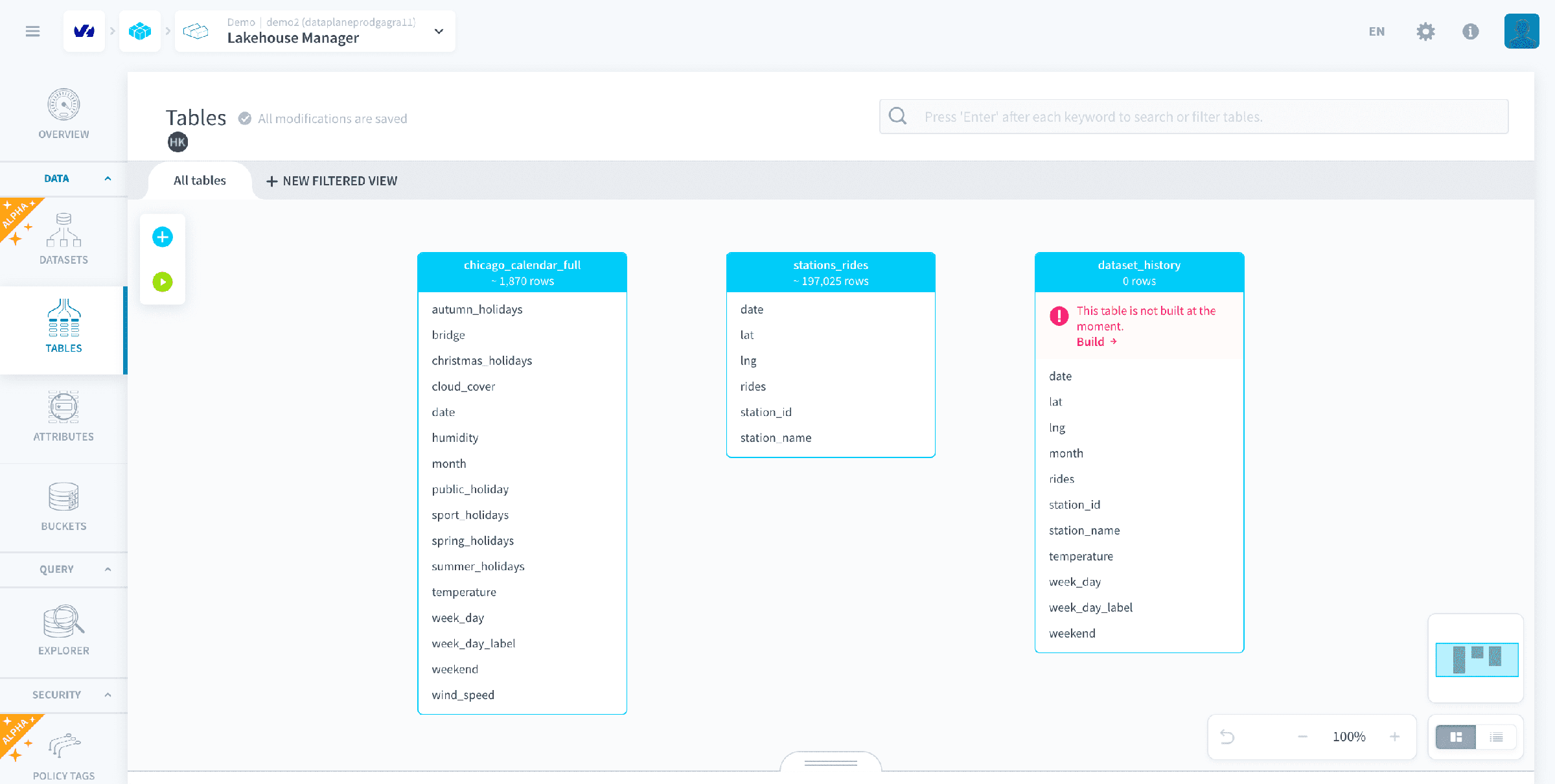

Move the attributes below by drag and drop to dataset_history:
Original tableAttributes to drag-and-drop
stations_ridesdate / lat / lng / rides / station_id / station_name
chicago_calendar_fullmonth / temperature / week_day / week_day_label / weekend /
lakehouse manager

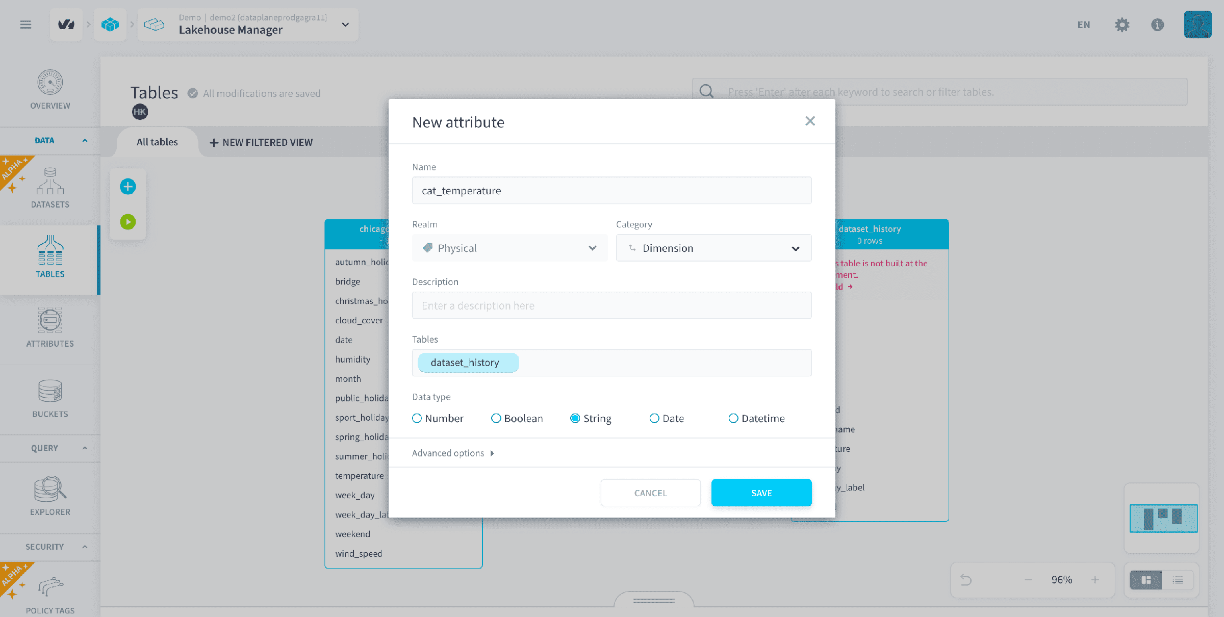

Finally, you will need to create one new attribute to help translate numerical temperature data into understandable categories (cold, hot, ..).
Start by clicking on the ➕ icon that appears at the top of the table dataset_history when you click on it. You can then create or edit an attribute inside a table.
Define the attribute as such:
Attribute nameTypeNature
cat_temperatureStringDimension
lakehouse manager
For the moment, this attribute is not physically specified. This will be done later in another component: the Data Processing Engine.

Finalize the build
One last quick check! Make sure to double-check that your data model looks exactly like the one in the screenshots before moving to the next step. If some attributes are missing you will get stuck in later steps of the tutorial.
Now, click on the Build icon (under the blue ➕ icon) to effectively create/update the tables and attributes in your dataset. This still doesn't load the data into the tables (which will be done in the next article), it simply applies the logical schema to tables and attributes in your underlying dataset.
lakehouse manager
While the visual logical schema of the data is automatically saved, changes to your tables won't be visible in the rest of the Platform as long as they are not built.
The build task for this tutorial shouldn't take more than a few minutes to run. Once it is done, you can move on.

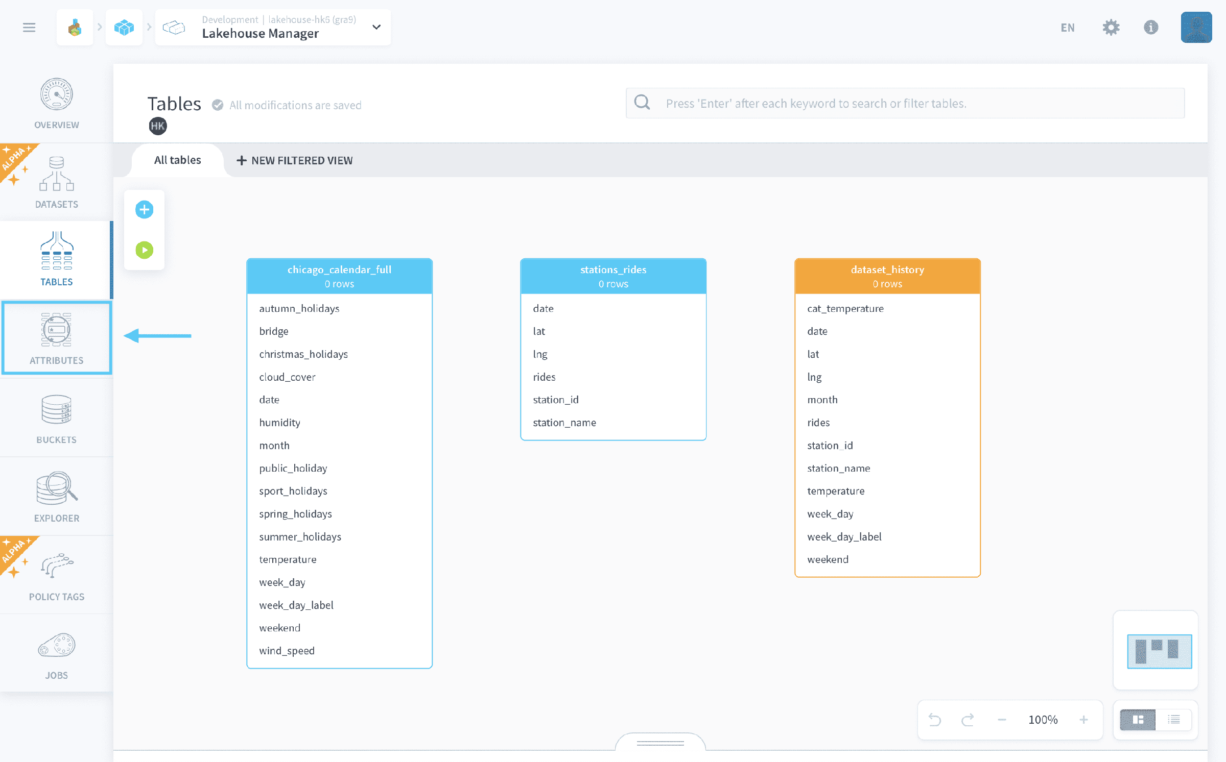

Switch to the Attributes page. This page lists all physical and virtual attributes in your data model, and the lineage in your Project.
lakehouse manager

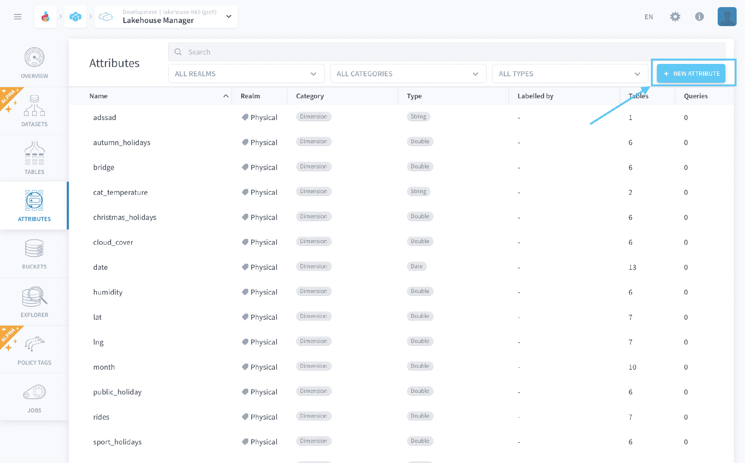

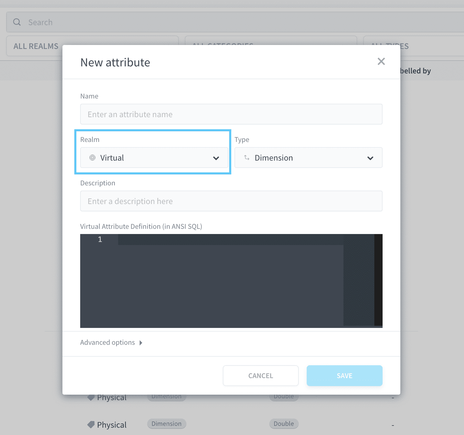

Click on the New Attribute button to create a virtual attribute.
lakehouse manager
In the creation window, make sure to select Virtual as the realm.
lakehouse manager
Now add these two attributes and their respective SQL code:
