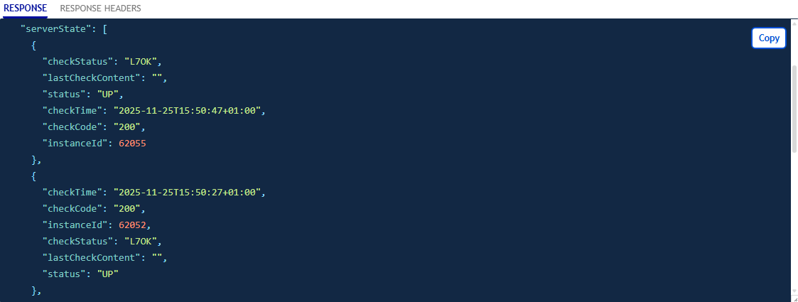

From the OVHcloud API
In the API, the server health status is available in the serverState table:
Result
Result server health status via the API
The image above illustrates the result of the command in the API.

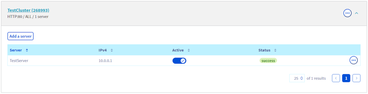

From the OVHcloud Control Panel
In the Server clusters tab, after selecting one of them, the status of each of its servers is displayed on the corresponding line.
Result
Result server health status via the OVHcloud Control Panel

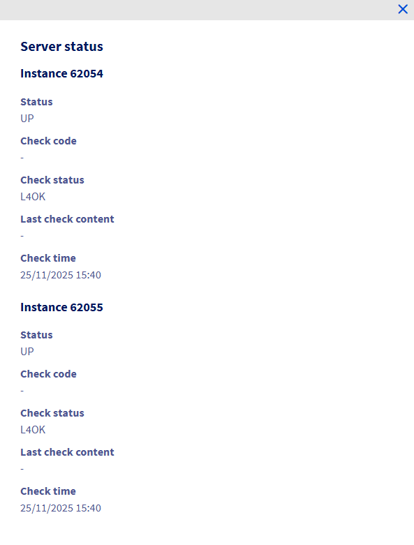

To obtain details on a server's health status, click on the text in the "Status" column, or click the ... button and select See status.
Result server health status via the OVHcloud Control Panel (details)
Explanation of the server status details
As explained previously, we have retrieved the server health status for each instance of your OVHcloud Load Balancer.
For each instance, we have the following information:
FieldDescription
StatusServer status
Check codeReturn code of the health check probe
Check statusStatus of the health check probe
Last check contentContent of the probe's return
Check timeDate and time the probe was executed
