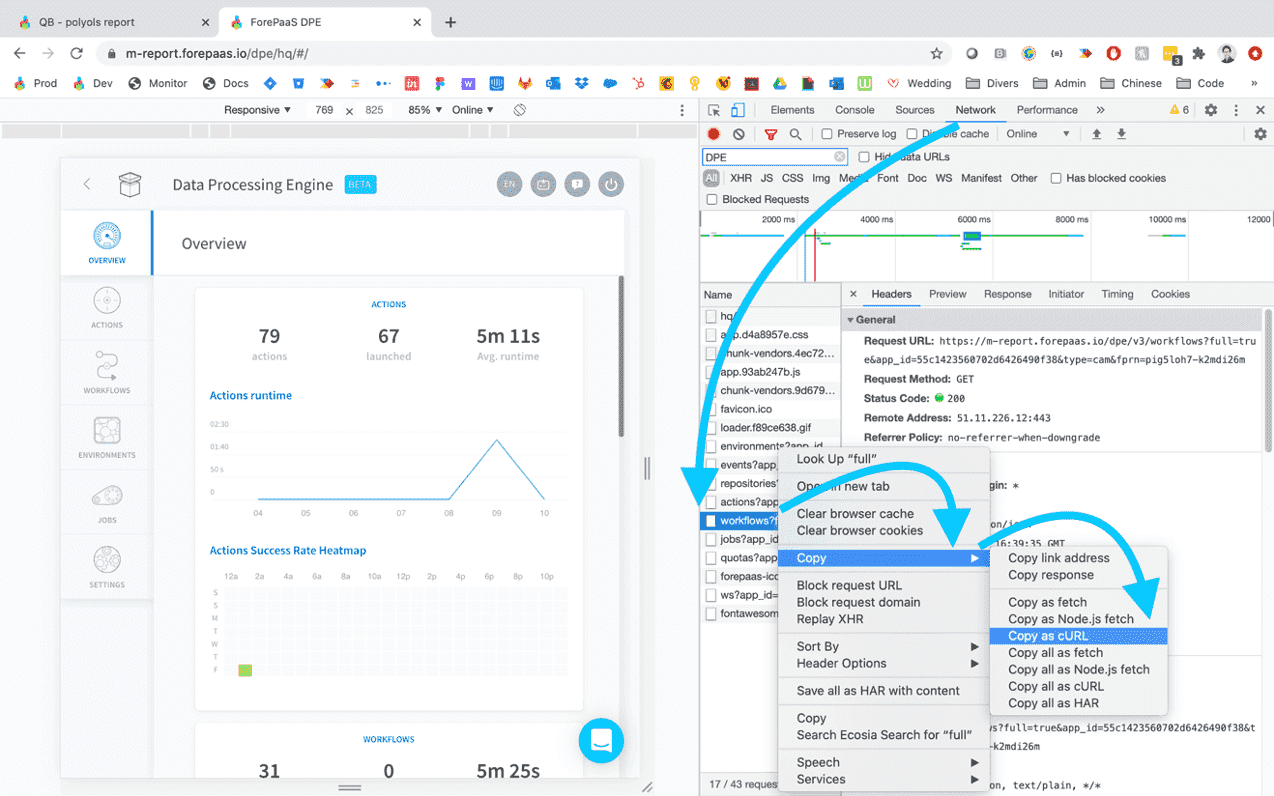

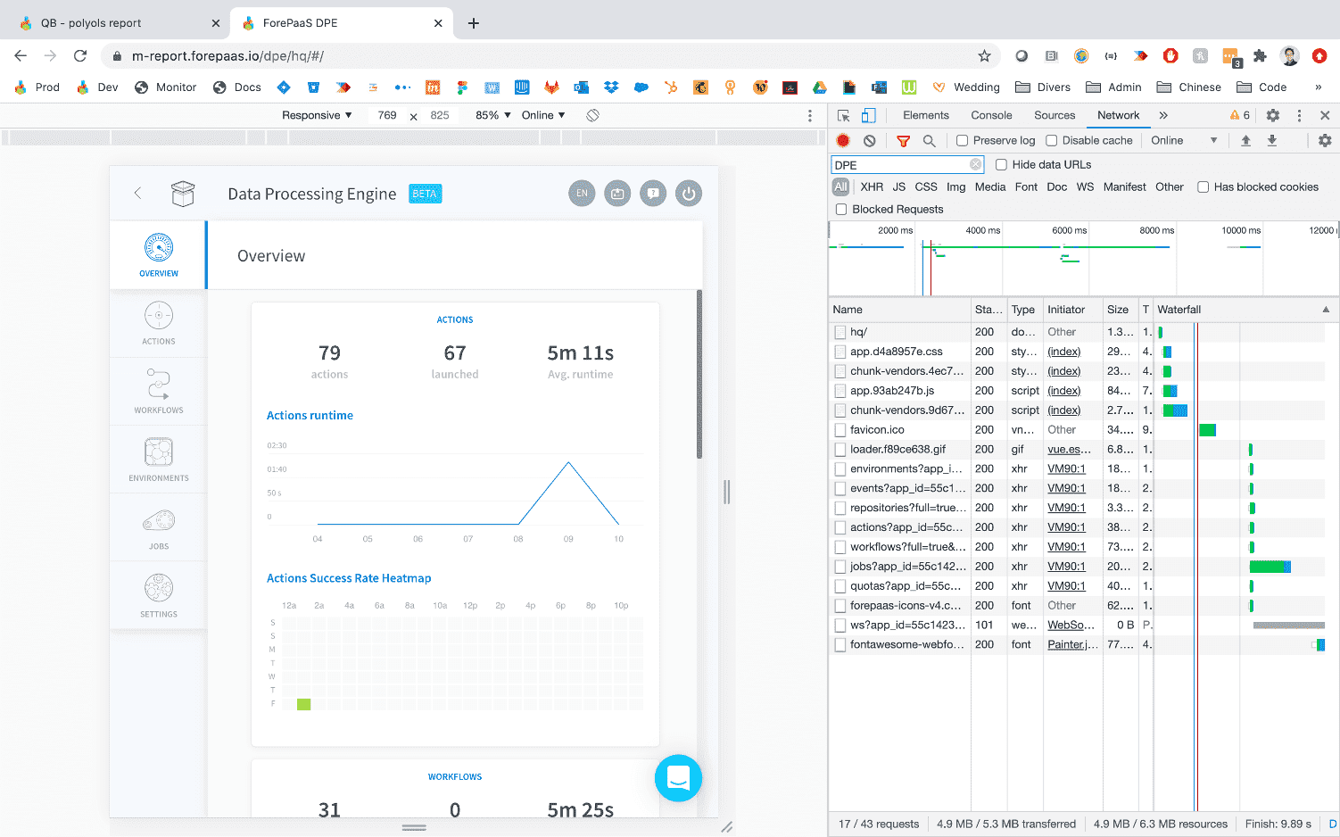

To get an access token easily, start by logging-in to the platform via the interface, and open any component, like here the Data Processing Engine. Right-click on your screen and select Inspect.
Component DPE
This will open your browser’s console window: navigate to the Network tab. If no calls are visible, simply press F5 or refresh your page. You should see a list of calls available like in the screenshot above.
Right-click on the one starting with “workflows” or “actions”, navigate to the option Copy and select Copy as cURL. You have now copied a cURL call which already contains your secret access token to your clipboard.

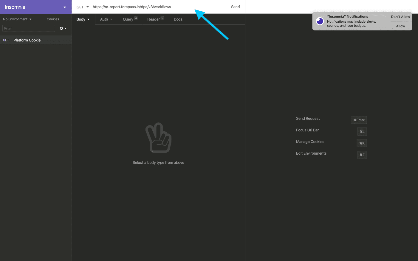

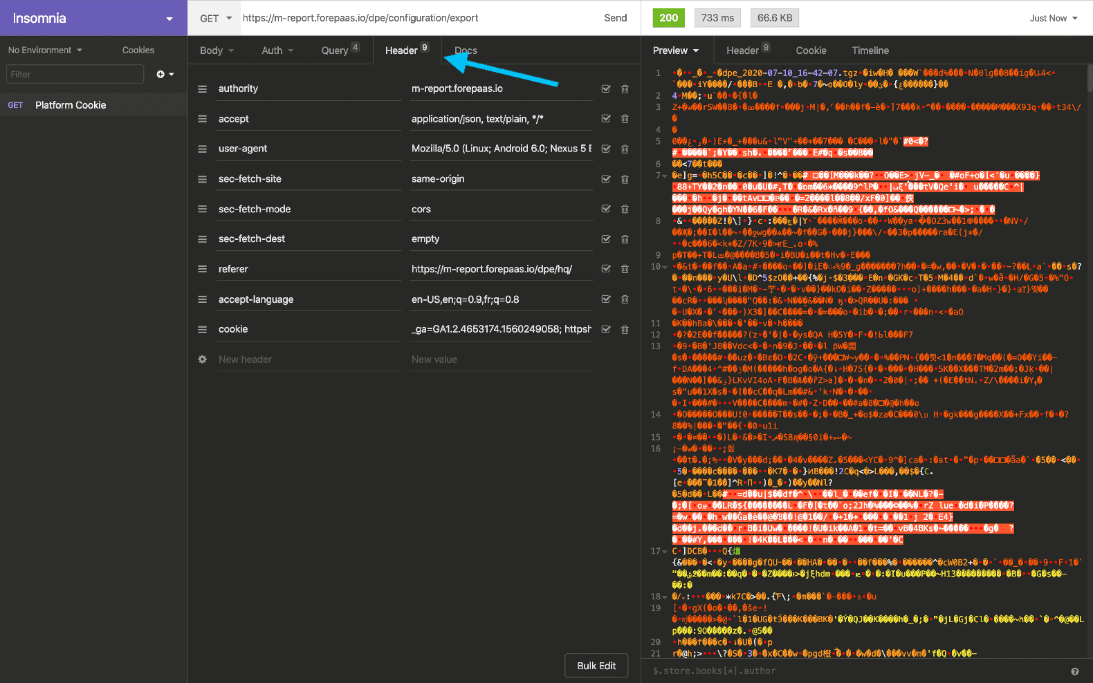

Now open Insomnia and paste the cURL inside the main header at the top of the window (on the right side of the Insomnia title next to the Get dropdown button):
Component DPE
When you copy-paste the cURL, Insomnia will automatically detect all the parameters of the call and fill the form for you. The only thing left for you to do is simply to change the main API call, instead of the one that you’ve just copy-pasted, and keeping the same list of Header parameters.

First, export the configuration by copy-pasting the corresponding URL, change to GET and click on Send.
If the call is successful you will see on the right side the TGZ file in the return response which you can download on your local machine. You can see on the screenshot below that the TGZ (tar gzipped) file is not readable because its compressed.
Component DPE

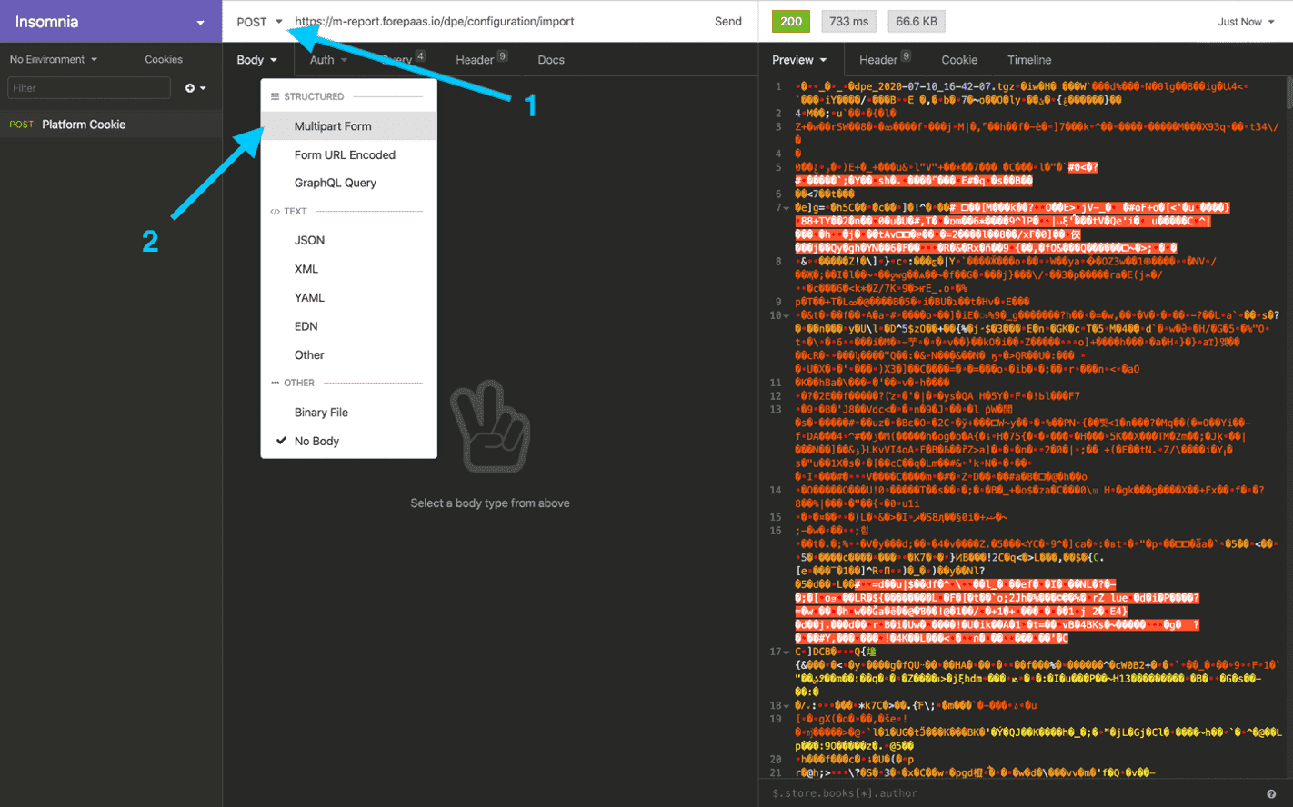

Now, let's import the same TGZ file which contains the Data Processing Engine's configuration. Change the GET method to POST and change the Body type to Multipart Form like shown on the screenshot below.
Component DPE

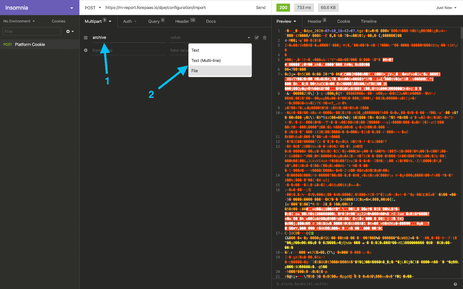

By choosing the Multipart Form you have the option to add parameters in the body and in particular load the TGZ file that you exported earlier as part of the request.
In the first input, type in archive, and on the dropdown arrow next to value select the File option. This will let you select directly a file from your computer to load.
Component DPE

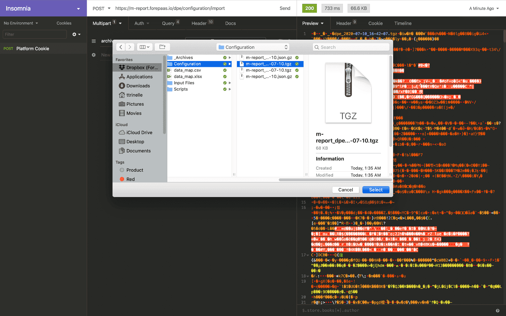

Select the TGZ file you want to load into your Project:
Insomnia

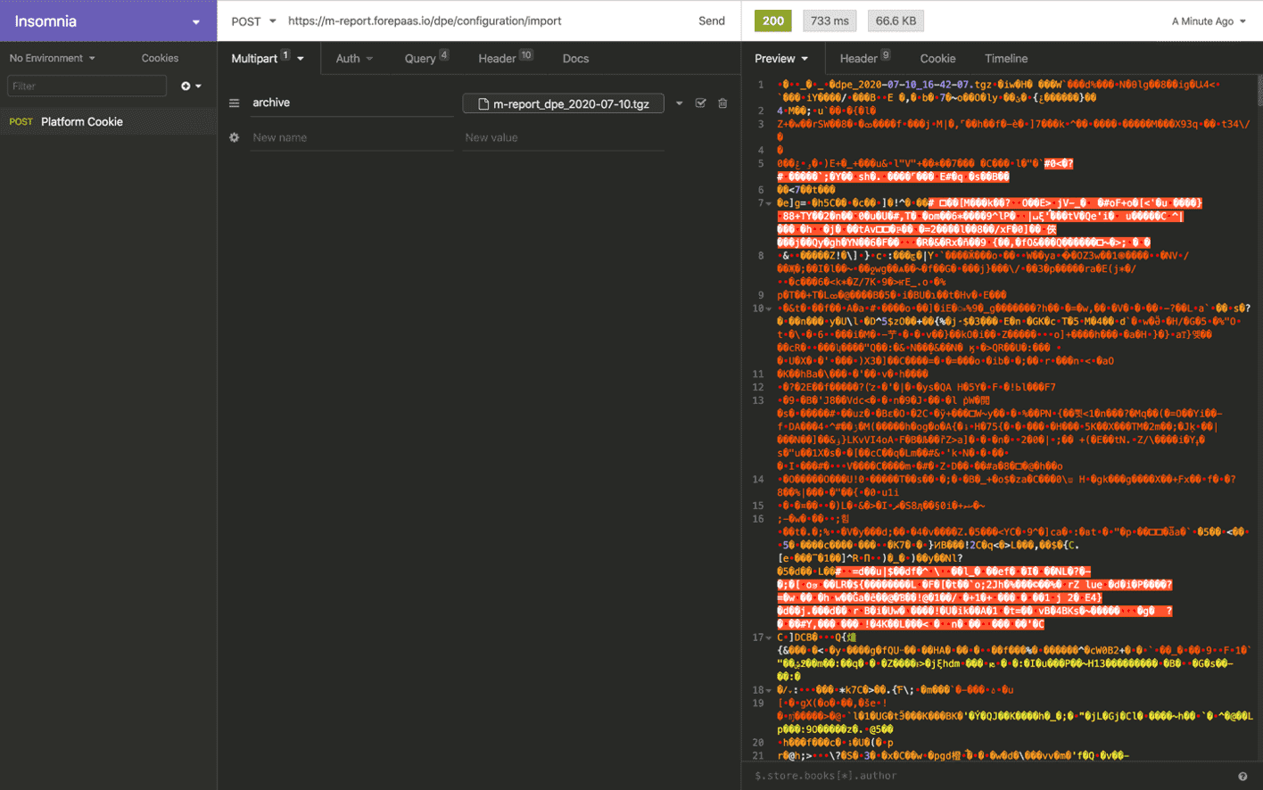

Press Send
Insomnia
That’s it! Now refresh your Project page and you should see all the component configuration updated.
