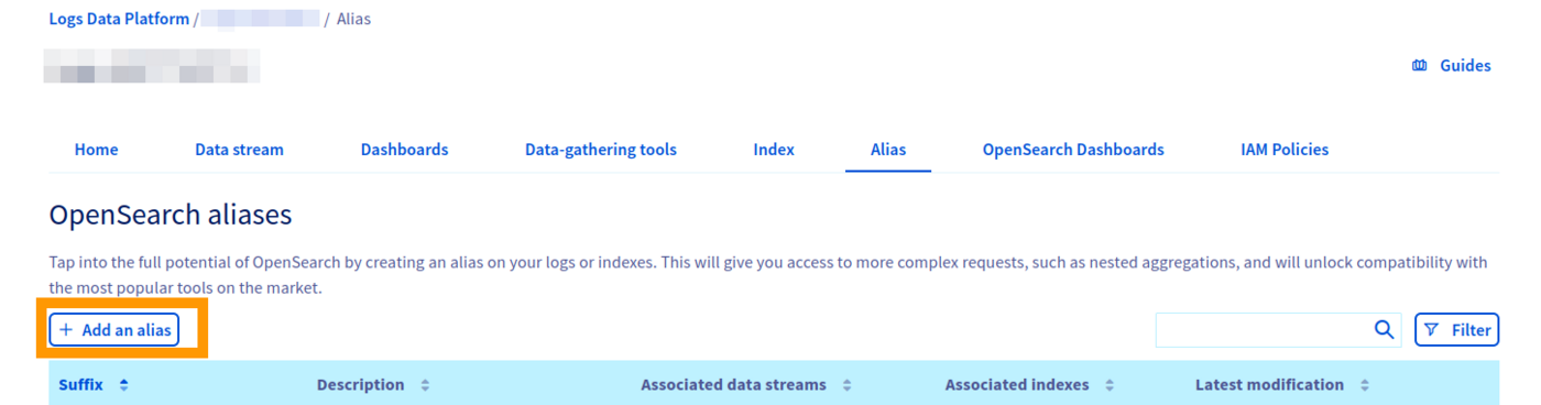

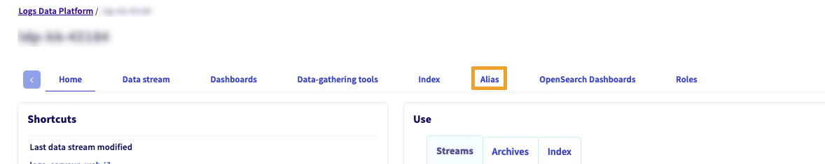

To create an alias in the management interface, go to the Alias section of your Logs Data Platform account as shown in this picture:
Logs Data Platform homepage alias button location
It should look like this:

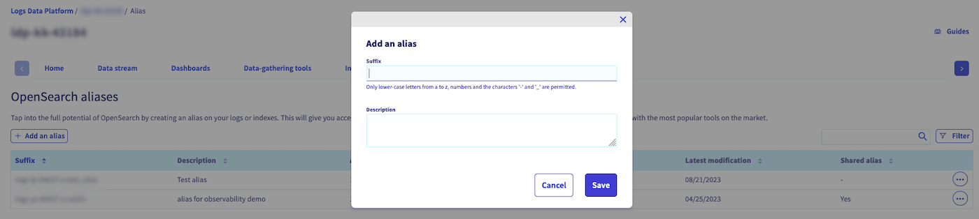

  • Create a new alias by clicking on the Add an alias button.
Logs Data Platform homepage alias creation

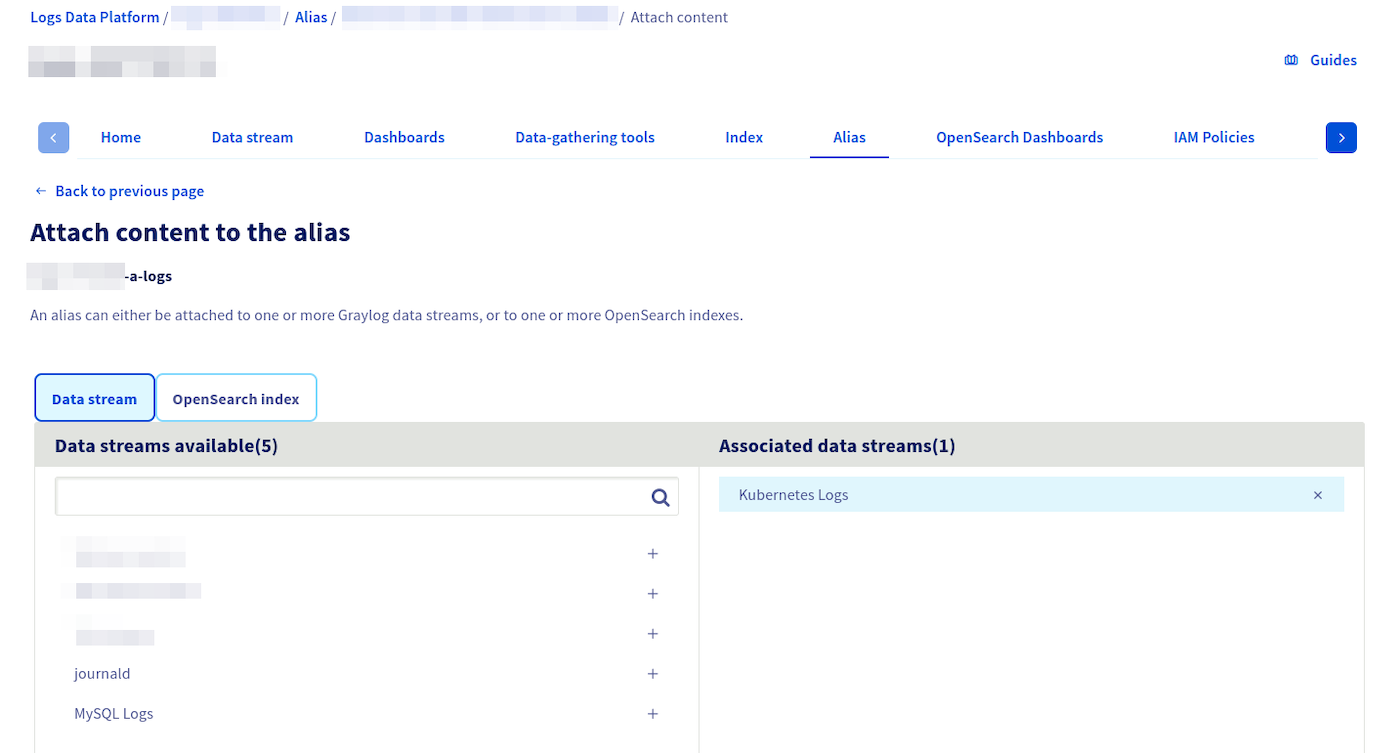

Attach an alias to a stream
  • Attach and detach streams and/or indices to an alias by clicking the ... button and then on the Attach content to the alias button.
  • Then you choose the stream you want to attach to the alias.
Logs Data Platform alias content attachment

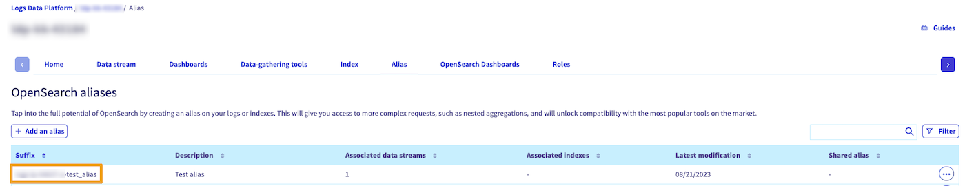

To connect to your alias as if it were an OpenSearch index, third-party tools usually require some information:
  • A URL/Port: this is your cluster's URL, found on your Logs Data Platform account homepage under the "Access point" name in the "Configuration" section. The port is 9200 for OpenSearch. The resulting URL should be https://<your_cluster>.logs.ovh.com:9200.
  • An index name. This is your alias name, found on the left column of your alias homepage like in the following picture. It should look like this: <ldp_service_name>-a-<alias_name>.
