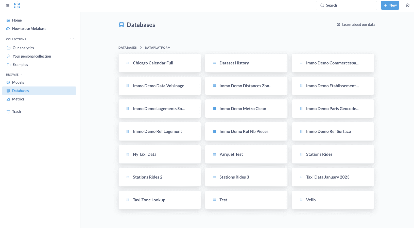

Step 8: Explore and Utilize Metabase Features
Step 8: Explore and Utilize Metabase Features — Metabase
Once the database synchronization is complete, you can fully explore and utilize Metabase's features:
  • Data Exploration: Browse your OVHcloud Data Platform databases and tables directly within Metabase.
  • Querying: Use the Metabase query builder to create custom SQL queries and retrieve specific data.
  • Dashboard Creation: Build interactive dashboards with visualizations to monitor key metrics and trends.
  • Reporting: Generate and schedule reports to share insights with your team.
  • Alerting: Set up alerts to notify you of important changes in your data.
With the connection successfully established, you can now leverage Metabase's powerful features to analyze and visualize your data stored in OVHcloud Data Platform via Trino.
