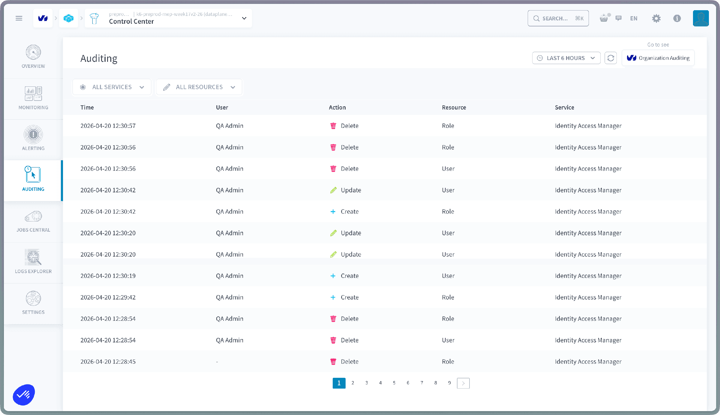

Project-level auditing
In the Control Center of any Project, open the Auditing tab to see every significant event that happened inside that Project.
Project-level auditing page
Each event is displayed with the following columns, in order:
ColumnDescription
TimeWhen the action occurred
UserUser or service account that performed the action
ActionThe operation performed (create, update, delete, etc.)
ResourceThe specific resource acted upon (e.g. a table, workflow, dashboard)
ServiceThe service the event comes from (Connectors, Lakehouse Manager, DPE, Analytics Manager, IAM)
You can search the events by text, filter them by service, resource type and a custom time window, export them as a file, open the Security events tab, and switch to the organization-level view at any time from the same page.

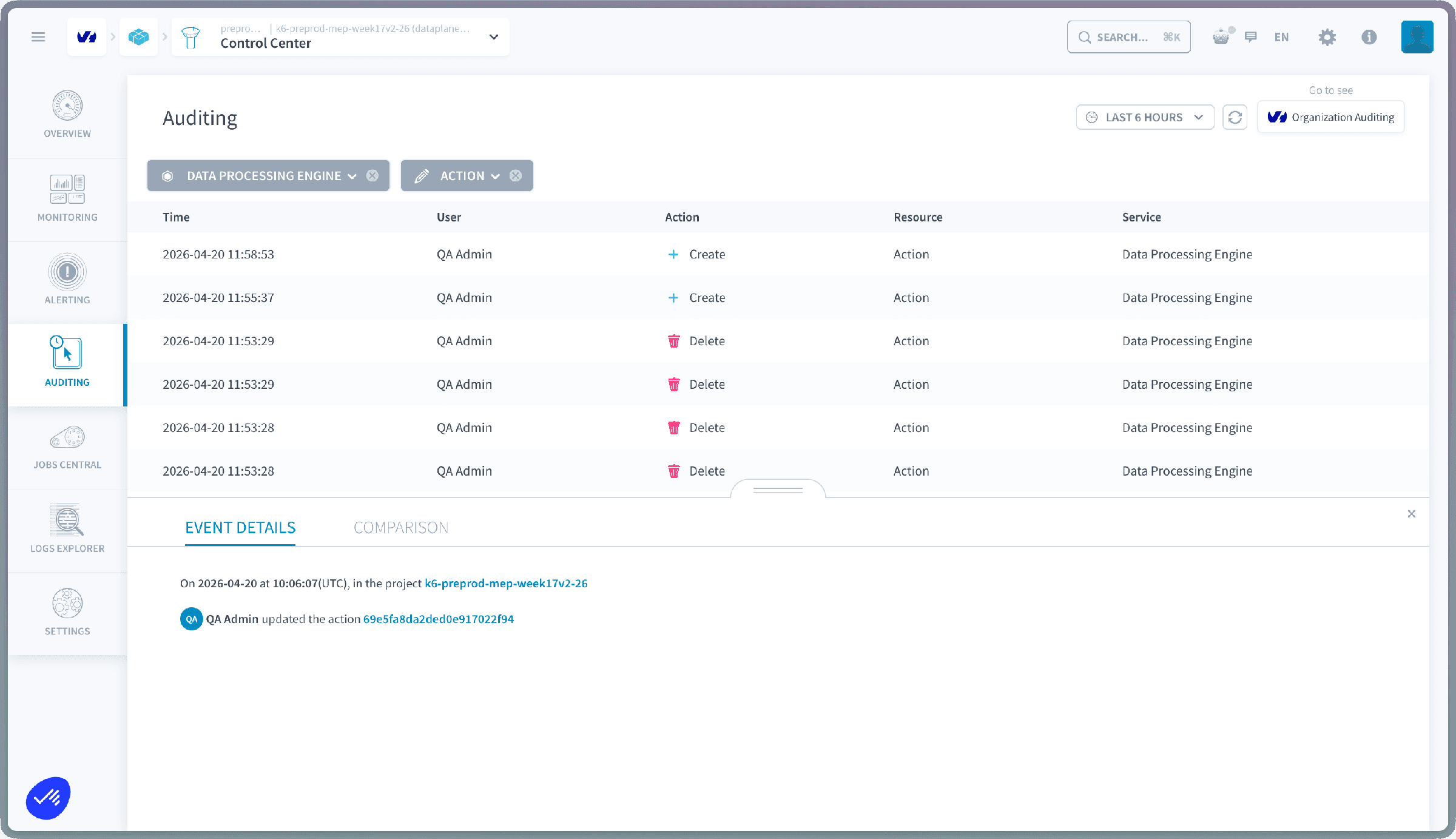

Event details
Click the info icon at the end of any row to open the event detail panel. From there, two views are available:
  • Event details: the full payload of the event: actor, action, target resource, timestamps and any metadata recorded with the event.

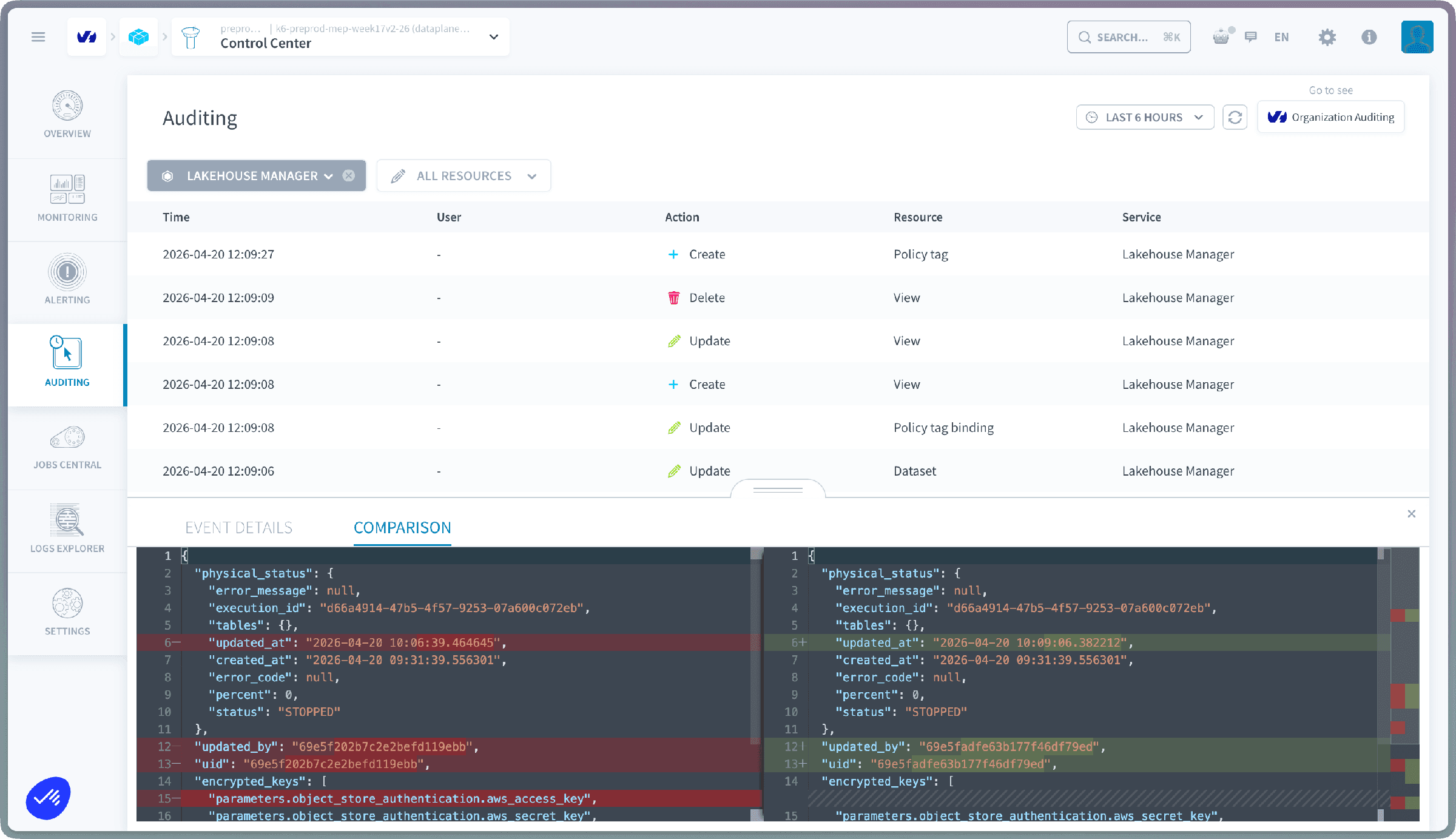

    Event details view
  • Comparison: a side-by-side diff of the resource before and after the action, so you can see exactly what changed.
    Event comparison view

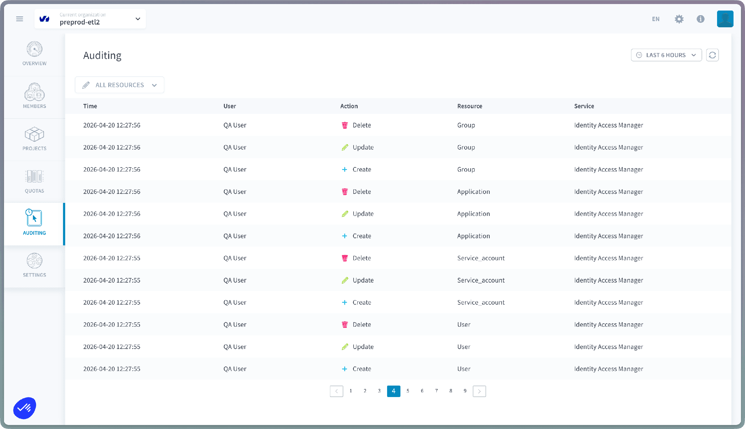

Organization-level auditing
From Organization Settings, open the Auditing tab to see organization-level activity.
Organization-level auditing page
Currently tracked at the organization level:
  • Organization IAM (roles, policies, authentication providers)
  • Member management (invitations, removals, role assignments)

The organization-level view is scoped strictly to organization-level resources. For Project-internal activity, open the Project and use its own Auditing page.
