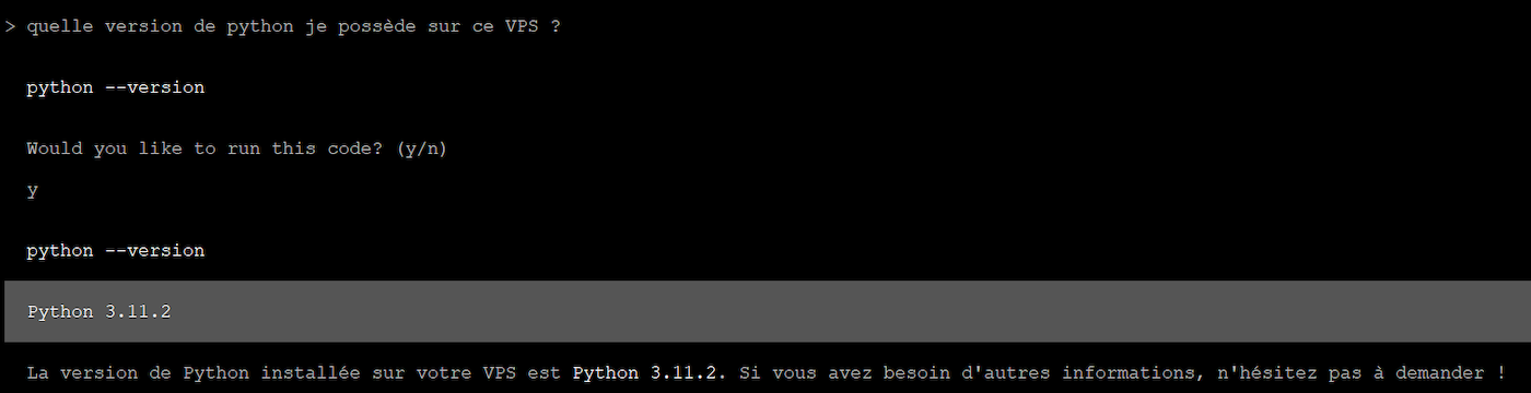

Test your AI Agent
Test the following use cases:
What is in the /tmp folder?
Sample response:
AI agent

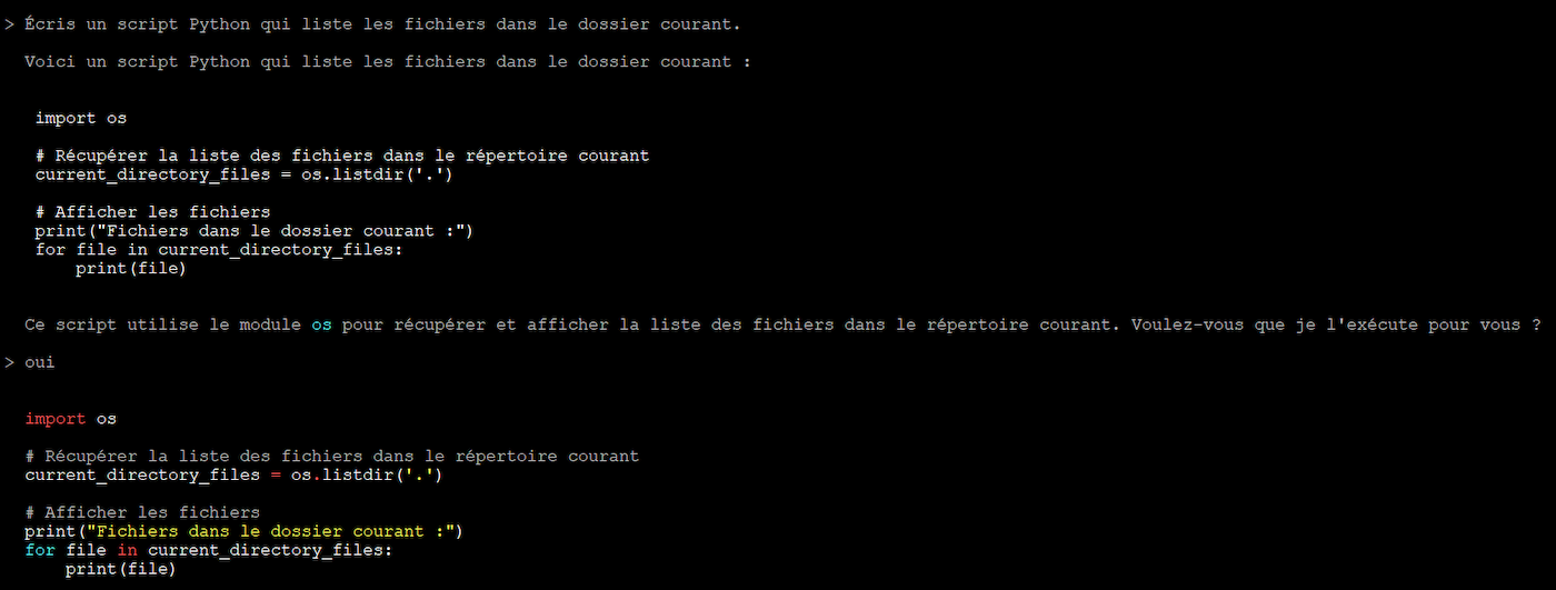

Write a Python script that lists the files in the current folder.
The agent interprets your request, generates code, and executes it locally.
Sample response:
AI agent
