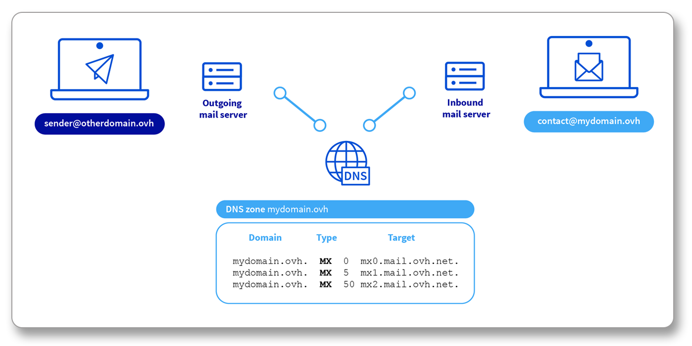

To understand how it works, we will use an example:
  • The address sender@otherdomain.ovh sends an email to contact@mydomain.ovh.
  • The sending email server (Outgoing mail server) queries the DNS zone for the domain name mydomain.ovh and reads the MX records.
  • The email is forwarded to the URL of the MX record that was read.
  • The email is sent to the target mx0.mail.ovh.net, which is preceded by the value 0. This value corresponds to the priority: the lowest value is queried first and the highest last. This means that having multiple MX records helps compensate for a lack of response from the server designated by the record with the lowest priority, by moving on to subsequent servers in order of priority.
email
You can set up multiple MX records for the same domain name. It is then necessary to define a priority number for each of them. MX records are queried in ascending order from lowest number to highest number until a response is received from the receiving server.

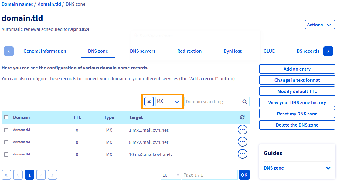

First check whether MX records already exist: use the search field or filter the table by the MX record type.
DNS zone filtered by MX record type
To edit an existing MX record, on its row open the actions menu â‹® and click Edit the entry. The row expands into an edit form: change the values, then confirm.

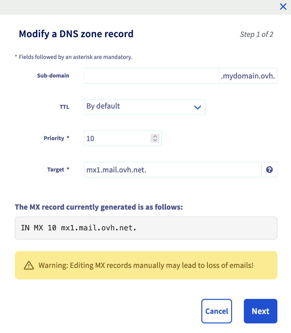

To add a new MX record, click Add an entry above the table. In the form that opens, select the MX type, then fill in the fields depending on the email solution you use:
  • If you have an OVHcloud email solution, use the values provided in the "OVHcloud MX configuration" section above.
  • If you have another email solution, refer to the information provided by your email service provider.
Set the TTL (leave it on By default or choose Customised), then click Add.
Adding an MX record from the DNS zone
The change can take between 4 and 24 hours to propagate fully.
