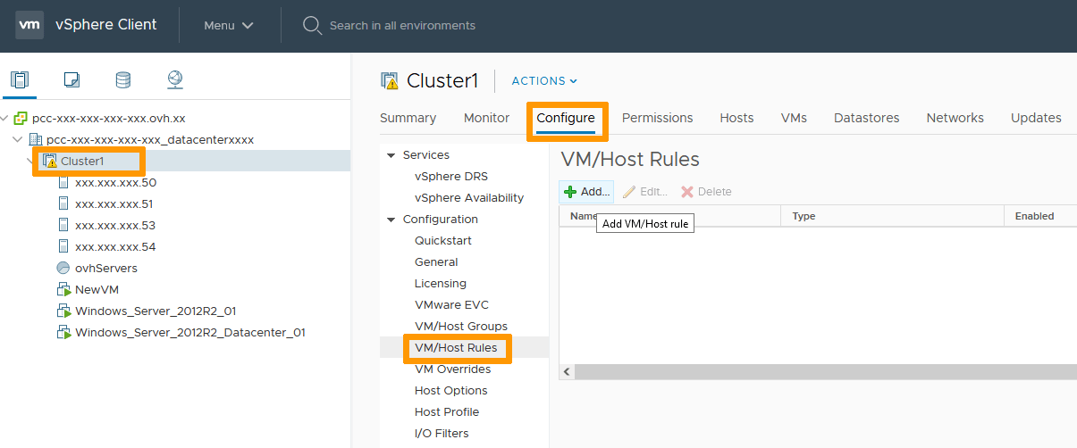

To implement this solution, click on the relevant cluster, then go to the Configure tab and the VM/Host Rules section
vSphere
Add a rule to "Keep virtual machines together" and add VMs with a backup proxy. If you have a large number of VMs to backup, you can create multiple DRS rules, and link them with multiple backup proxies. The OVHcloud algorithm will ensure that the virtual machine backup process is performed by whichever backup proxy is present on the same ESXi host as the VM.
