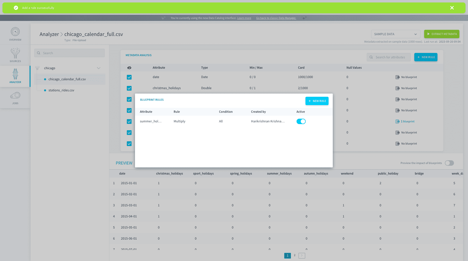

Configure a blueprint rule
Rules require 3 steps to be configured:
- Information: Name of the attribute
- Transformation: If the condition is confirmed, which transformation action to apply to the data (can be chosen from the Platform store)
- Condition: which rule to apply for the condition

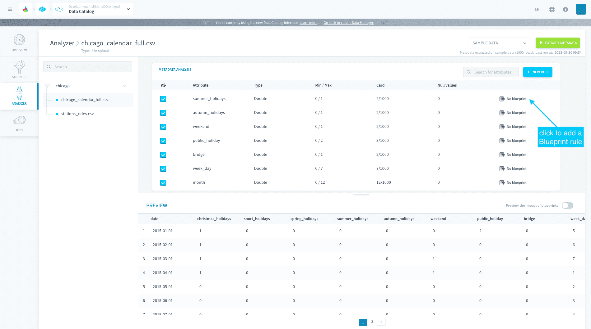

To add a rule on an attribute, on the relevant field, click on the following button:

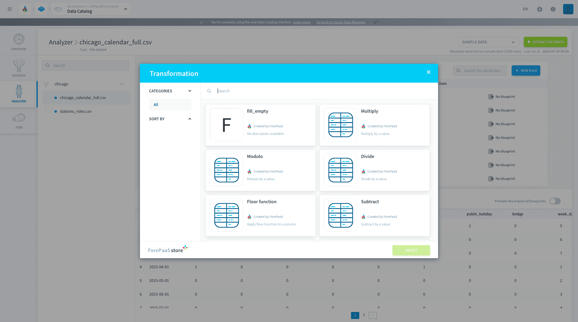

Transformations
Different transformations are available in the Platform store:
Replace by: Replaced values by a single value
Substring: Values will be truncated
Date format: Replace date formats
Keep line: Keep matching values
Skip line: Skip matching values
Throw error: Matching values will trigger an error
Replace substring: Replace matching substrings
Apply regexp: A new regexp will be applied to matching values
Stop workflow: Stop the ongoing workflow

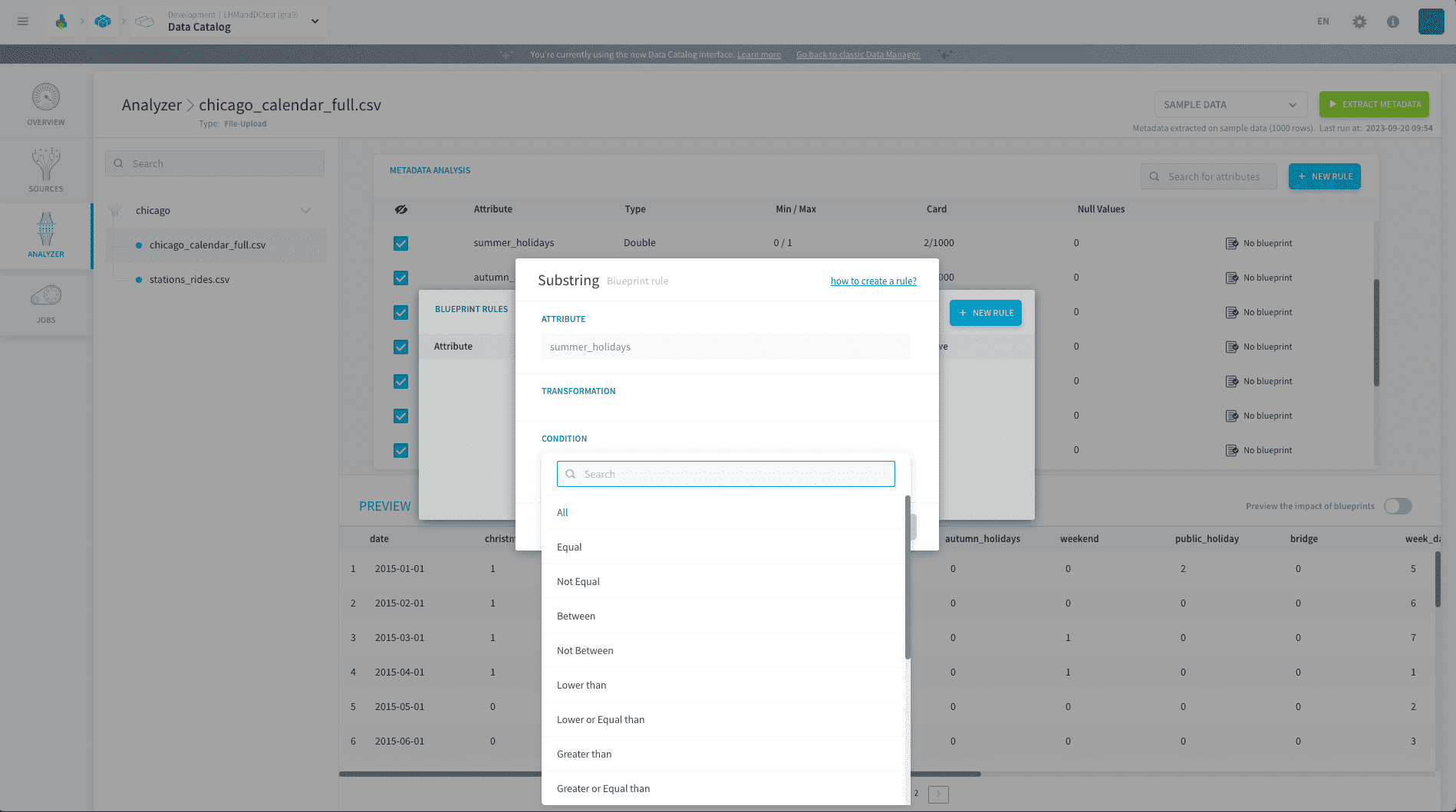

Conditions
Different conditions are available:
The Platform provides you a variety of Conditions you can apply to your chosen transformation. The list includes the following: Equal, Not Equal, Between, Not Between, Lower than, Lower or Equal than, Greater than, Greater or Equal than, REGEXP, NOT REGEXP, Is a number, Is not a number, Is a date, Is not a date, Is null, Is not null
Once the transformation and condition are set, the rule will be applied to the selected attribute.
