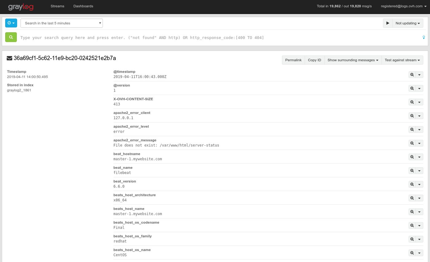

beat_graylog
Note the type value (apache or syslog or apache-error) that indicates the source file of the log message. You can easily display only your apache access logs for example by typing in the search bar fileset_module:apache2.
