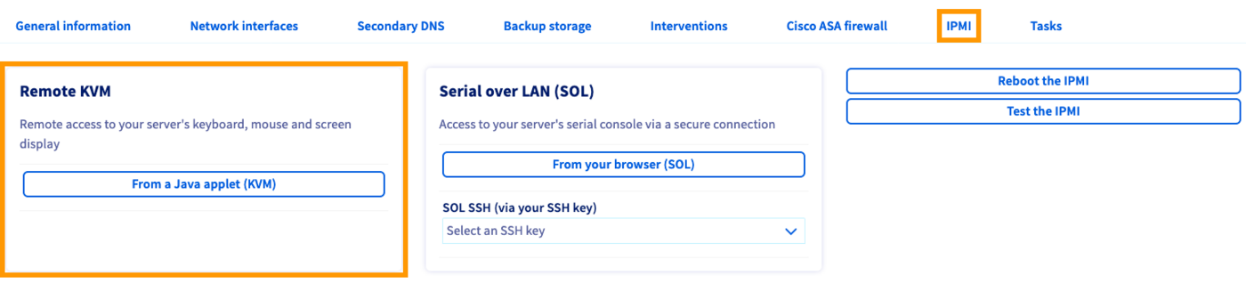

Step 5: Setting a new password (IPMI)
In your , navigate to the IPMI tab to open a KVM session.
IPMI

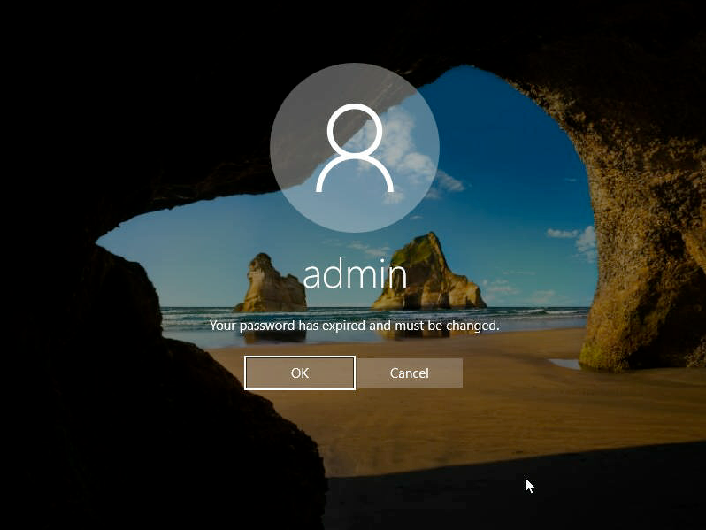

Step 5.1: For a newer version of Windows
There should be a password expiration message in the login interface.

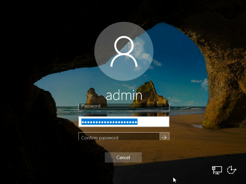

pwreset
The new password for the admin user must now be entered twice. However, the confirmation field is not yet visible, meaning you need to leave the first field blank, type your new password into the second field, then use the tabulator key ("↹") on the (virtual) keyboard to switch to the third field ("Confirm password"). Type the password again and click on the arrow to save it.

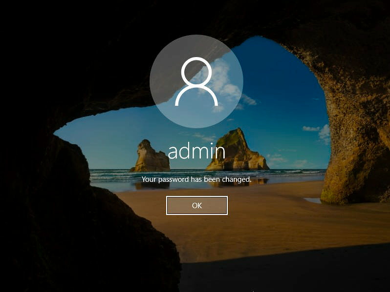

enterpw
Click on OK and you will be logged in.
adminlogin
IPMI

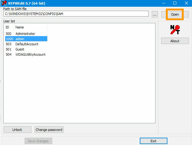

To reset passwords, the tool NTPWEdit is required. Once you are connected via KVM, open the browser and download it from the official website. Navigate to the folder where the downloaded ZIP file is located and extract the contents. Next, open the ntpwedit64 executable to start the application.
ntpwedit
In this interface, you can manipulate the SAM file in order to clear the admin user's password. The default file path in the WINDOWS directory is pre-filled. Open the file to display the list of users by clicking on Open.
The relevant user will either be "admin" or "Administrator", depending on the Windows version. If both are present, choose "admin". Then click on Change password.

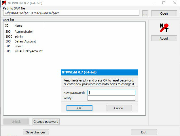

ntpwedit
In the popup window, leave the fields blank and click OK. Finish by clicking on Save changes and Exit.
