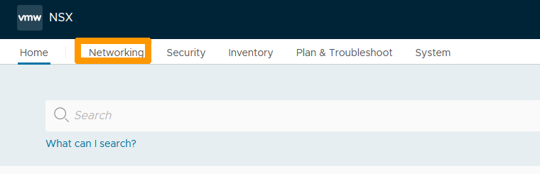

From the NSX interface go to the Networking tab.

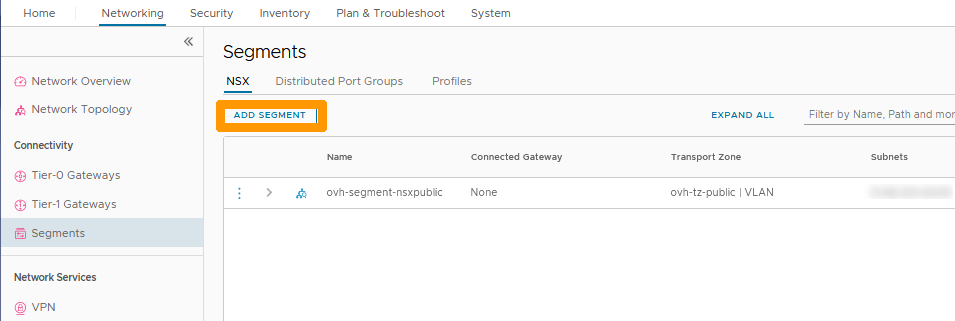

Click on ADD SEGMENT on the right.

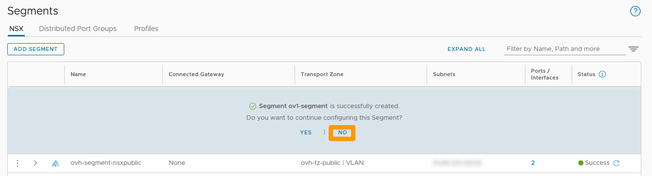

01 Create Segment 04
Click NO when prompted.

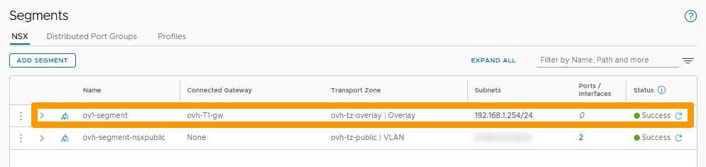

01 Create Segment 05
The new segment appears in the list.

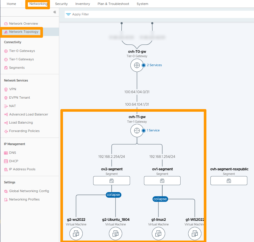

In the Networking tab, click on Network Topology on the left to see the new segment and its location in the network.

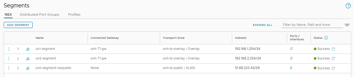

Use the first part of the guide to create a second segment named ov2-segment with these parameters 192.168.2.254/24 in order to have two segments connected to ovh-T1-gw.

Return to the NSX interface in Network Topology to bring up the new network configuration.
05 display four VM on two segment02
Both segments are connected to the gateway ovh-T1-gw. Routing between the two subnets is enabled without any network restrictions by default.
