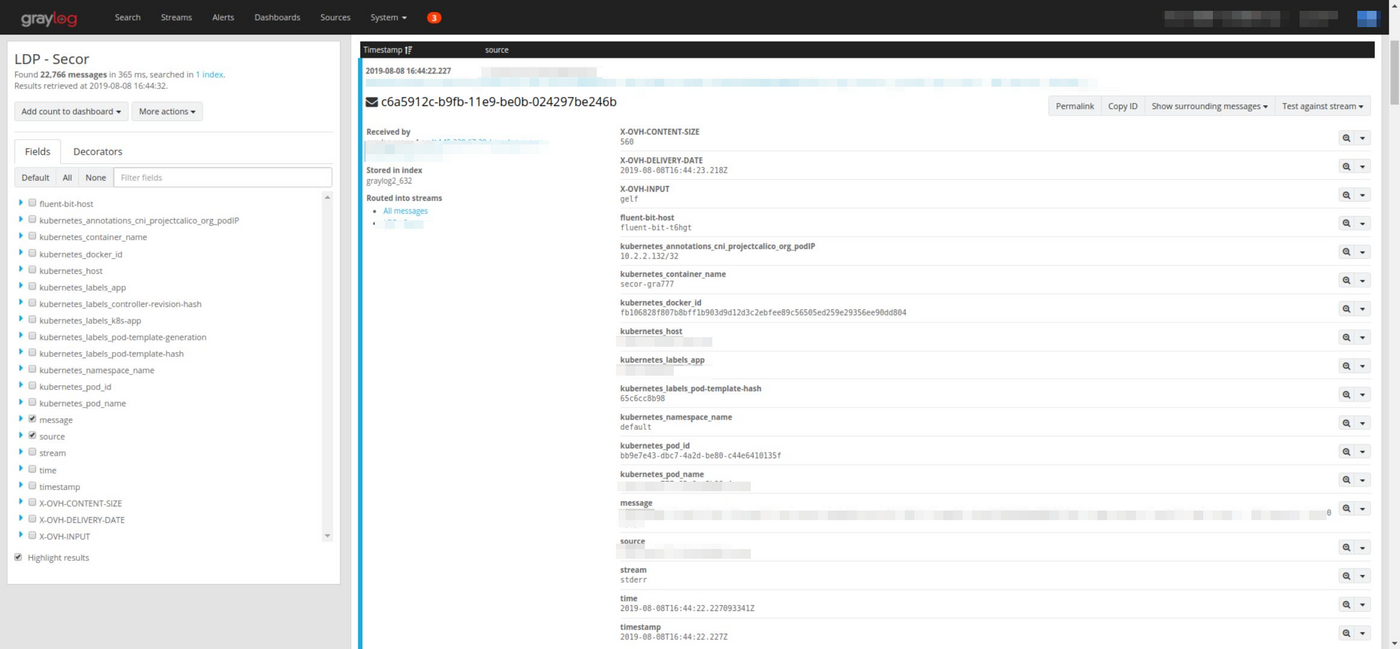

You can now fly to the stream interface to witness your beautifully structured logs.
kube_graylog
And that's it. Your kubernetes activity is now perfectly logged in one place. Happy Logging !!
