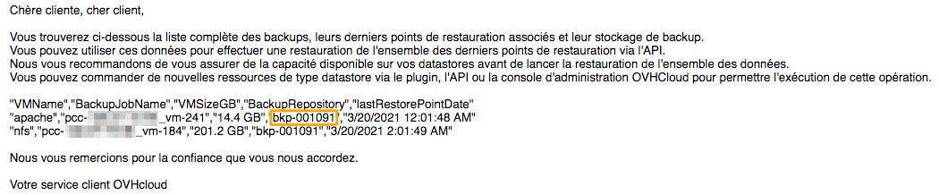

This call will generate a backup report. It will be sent by email to the address listed on the Hosted Private Cloud service administrator account.
The email lists the following:
  • VM name
  • Backups performed (BackupJobName)
  • Size of each backup
  • Storage Folder (BackupRepository)
  • Last restore point
email
Take note of the BackupRepository reference, this will allow you to restore backups in the next step.

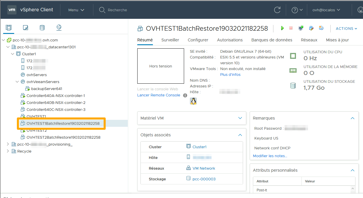

Once the restore is complete, you will find the VMs corresponding to the restored backups in your vSphere interface.
To identify them, their names contain the BatchRestore suffix and a restore timestamp.
VMs are restored and switched off. It is up to you to switch them back on.
