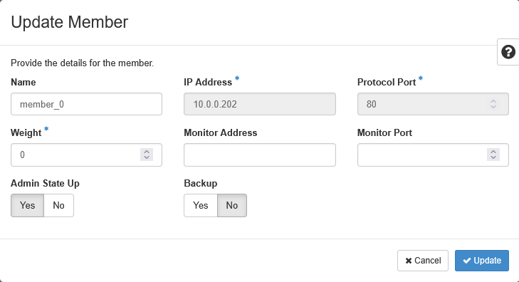

Step 2 - Set the Weight of a member to 0
OVHcloud API
Horizon
CLI

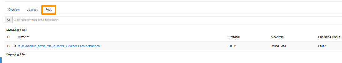

This call retrieves the pool id. Fill in the fields with the previously obtained information:
  • serviceName: The Public Cloud project ID in the form of a 32-character string.
  • regionName: The name of your region.
You can leave the loadbalancerId field blank in order to obtain all the pools created in the region specified/

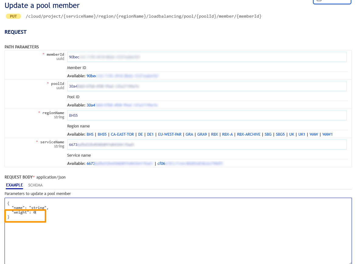

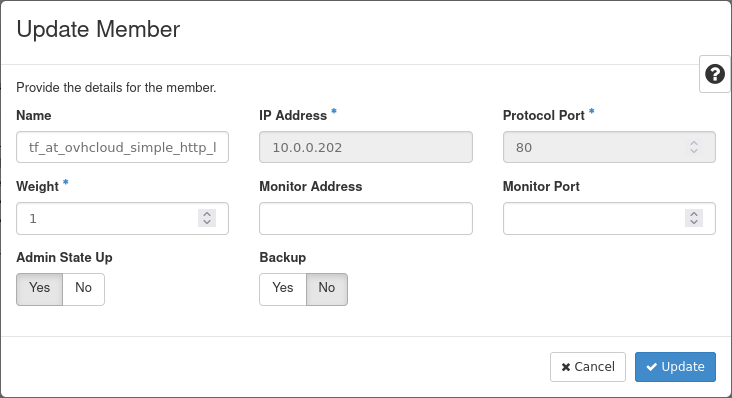

You can update a pool member with the following API call:
  • poolId: The Pool ID in the form of a 32-character string.
  • memberId: The Member ID in the form of a 32-character string.
  • weight: Set the weight to 0.
Click on Execute.

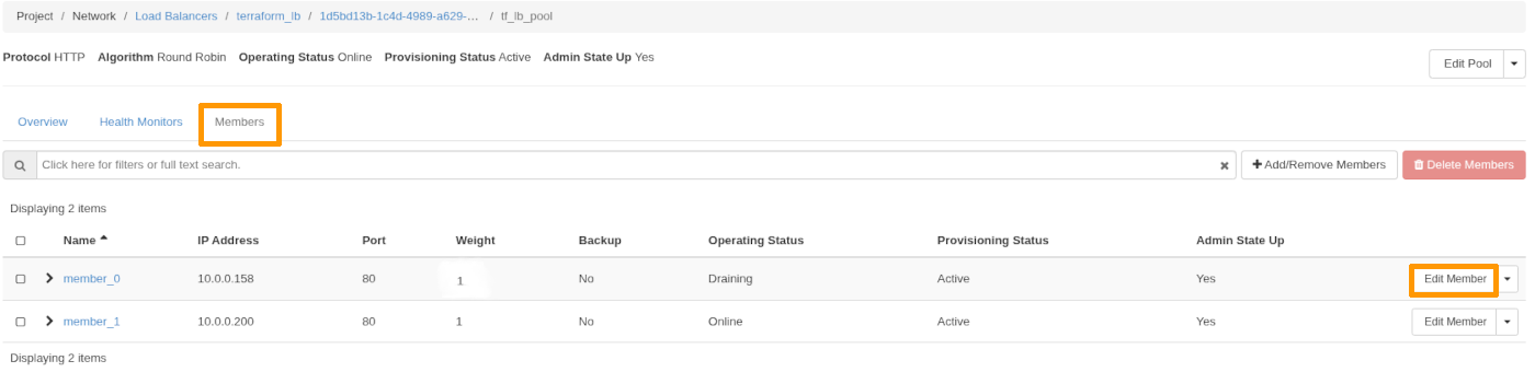

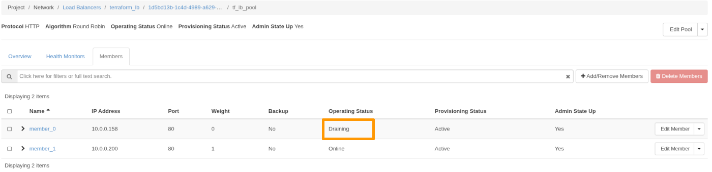

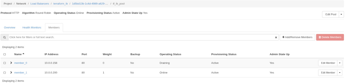

Step 3 - Verify Member Status
After setting the member’s weight to 0, its status will change from ONLINE to DRAINING.
It is important to note that in the current system, the member will remain in the DRAINING state even after all traffic has been drained.
This can be confusing because some users expect a final status of DRAINED once all traffic has been redirected. However, the system does not automatically transition to DRAINED.
  • DRAINING simply means that the member is no longer receiving traffic, not that it is still actively draining traffic.
  • The DRAINED status is not yet supported in the current OpenStack API.
If having a final DRAINED status is critical for your operations, it is recommended to submit a feature request to OVHcloud for this functionality in a future update. However, this will only be possible once this feature is supported by OpenStack.

The member whose weight is 0 will have an Operating Status Draining. Run the test script again:

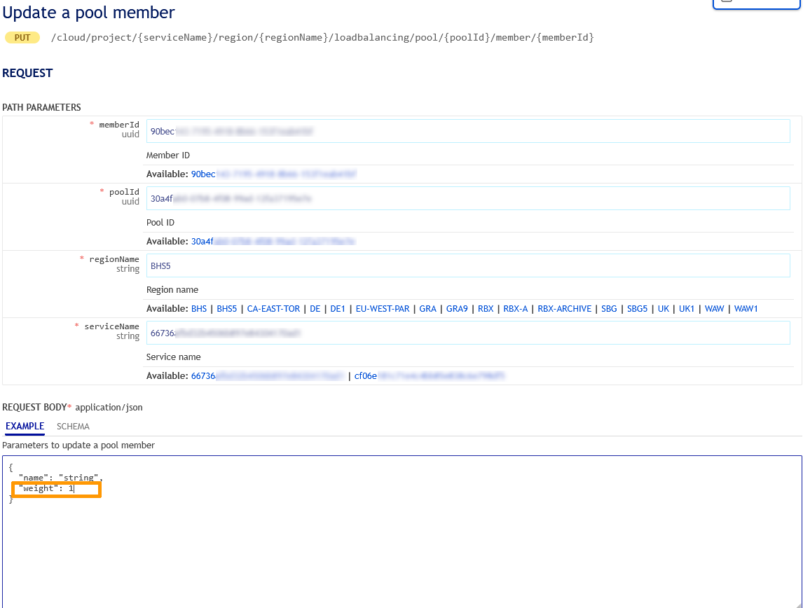

Step 6 - Restore traffic to the member
Once the maintenance is complete, set the weight of member_0 back to its original value (e.g., 1):
OVHcloud API
Horizon
CLI
Terraform
To update the weight, use the following API call:
  • weight: Set the weight to 1.
Click on Execute.
