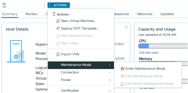

Step 2 : Enable Maintenance Mode (Zerto)
If you are using the Zerto option (Disaster Recovery Plan):
You must first switch the hosts in your cluster to Maintenance Mode before starting the update with vLCM:
Maintenance Mode
