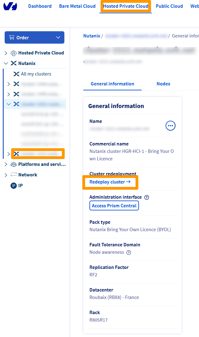

In the OVHcloud Control Panel, click on the Hosted Private Cloud tab, select your cluster below the Nutanix category on the left-hand side, then click on Redeploy cluster.

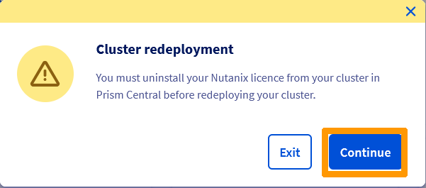

If you have subscribed to the Nutanix BYOL offer, a reminder will tell you not to forget to uninstall your licences. You can use this guide to manage your licences: Manage licences in your Nutanix on OVHcloud BYOL Offer cluster. When your licences are uninstalled, click Continue.

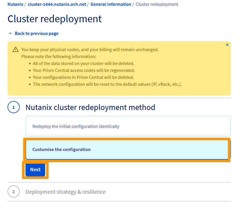

Click Customise the Configuration and click Next

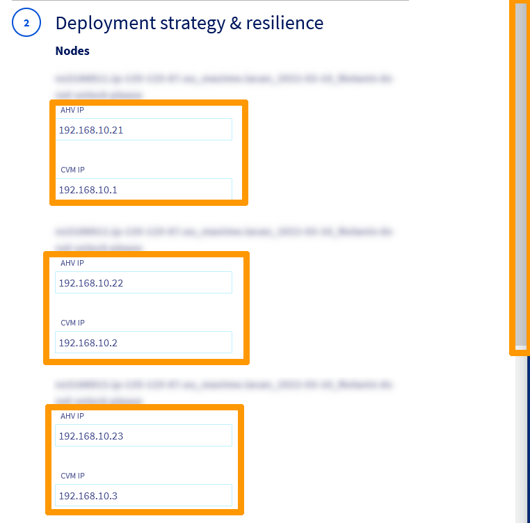

Enter the information for each of your nodes, which are:
  • the private IP address of your AHV hypervisor.
  • the private IP address of the CVM virtual machine.
Then scroll through the window.

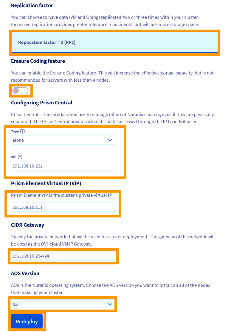

Leave these default settings :
  • Replication Factor : RF2.
  • Erasure Coding feature : Erasure Coding disabled.
  • Prism entral type : Alone.
Modify these values:
  • Prism Central VIP : Prism Central private IP address.
  • Prism Element Virtual IP(VIP) : Prism Element private IP address.
  • CIDR Gateway : Private IP address of the gateway followed by the subnet mask, in the following form XX.XX.XX.XX/XX.
  • AOS Version: Version of AOS chosen during redeployment.
Then click Redeploy.

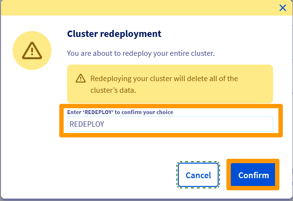

Enter REDEPLOY and click Confirm.

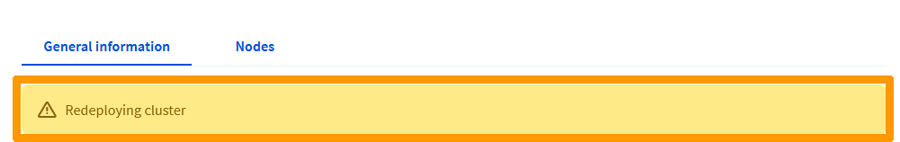

The Cluster redeployment takes a minimum of two hours. Wait until you receive an email to the OVHcloud account holder before using the Cluster again.

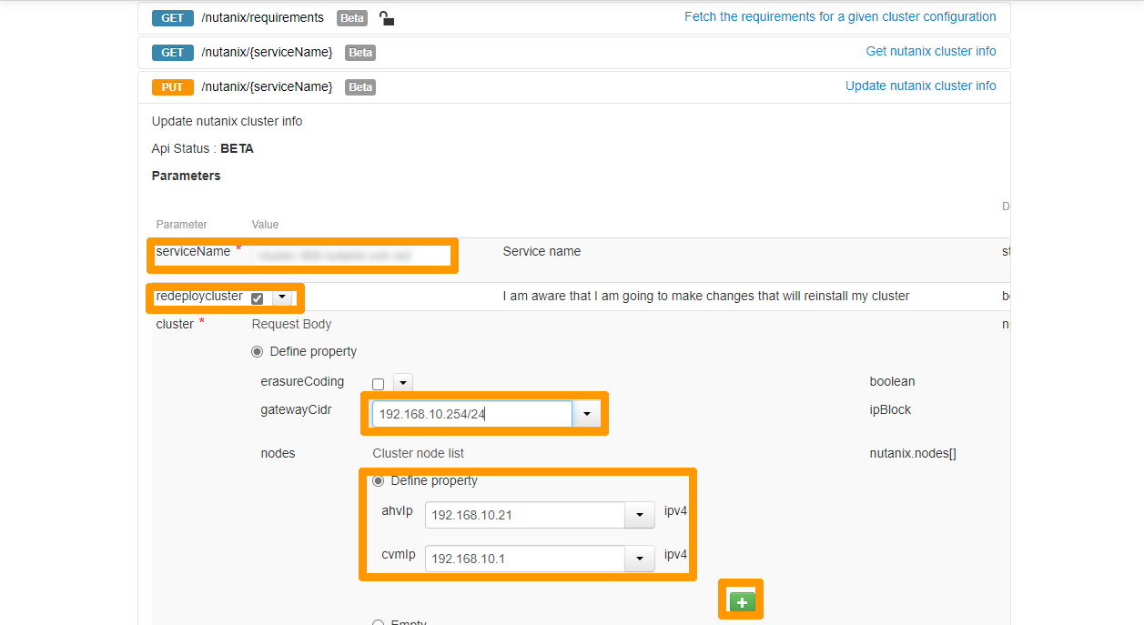

PUT/nutanix/{serviceName}
Enter this data:
  • ServiceName: FQDN name of your Nutanix Cluster.
  • redeploycluster: Check the box.
  • gatewayCidr: The gateway IP address followed by the subnet mask.

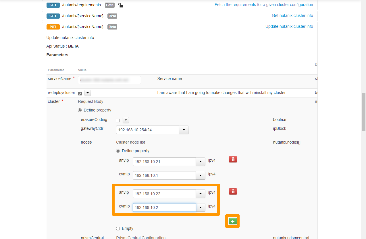

Enter the following information below nodes:
  • ahvip: IP address of the hypervisor of the first node.
  • cvmip: IP address of the first node's CVM.
Then click the + button.
Cluster Redeployment 03

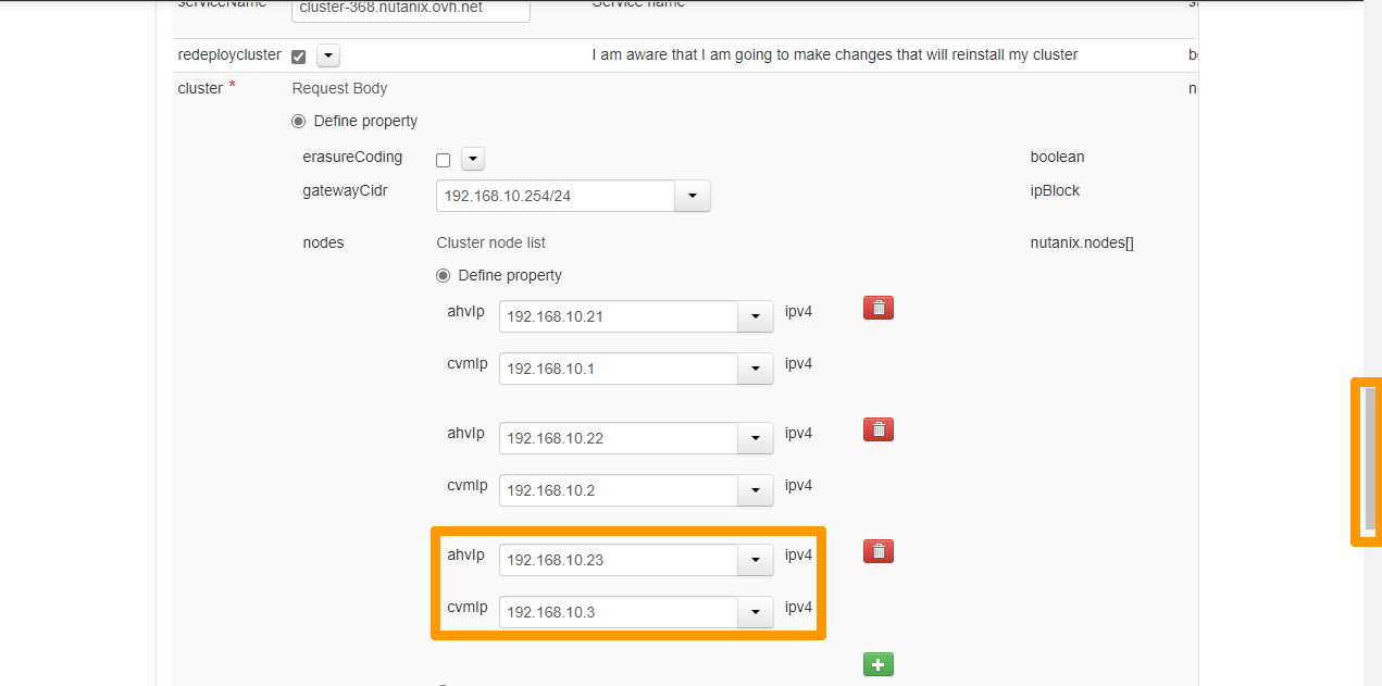

Add the information for the second node:
  • ahvip: IP address of the hypervisor of the second node.
  • cvmip: IP address of the second node's CVM.
Click the + button again.
Cluster Redeployment 04
Then add the information for the last node:
  • ahvip: IP address of the hypervisor of the last node.
  • cvmip: IP address of the last node's CVM.
Then scroll through the browser window with the scroll bar.

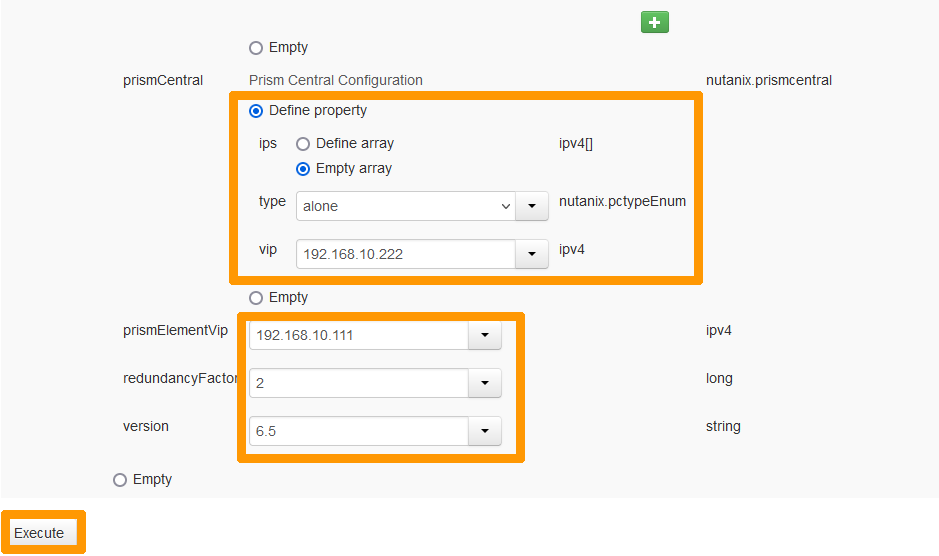

In the Prism Central Configuration section, check Define property and Empty array.
Choose alone from the type drop-down menu and enter The IP address of Prism Central in the vip drop-down menu.
Then enter:
  • The IP address of Prism Element in the prismElementVip drop-down menu.
  • The Number of the redundancy factor in the redundancyFactor drop-down menu.
  • The version number of the cluster in the version dropdown menu.
Click Execute to start the cluster redeployment.
