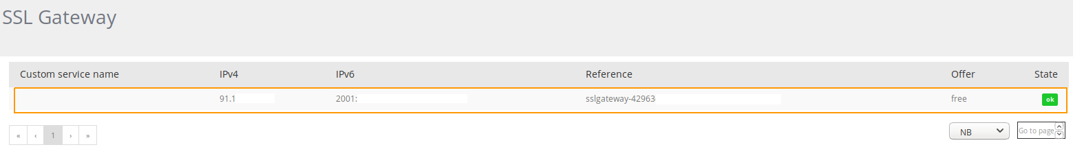

Then click on SSL Gateway to view the service.
ssl gateway button
Select the solution that you wish to configure.
commercial page

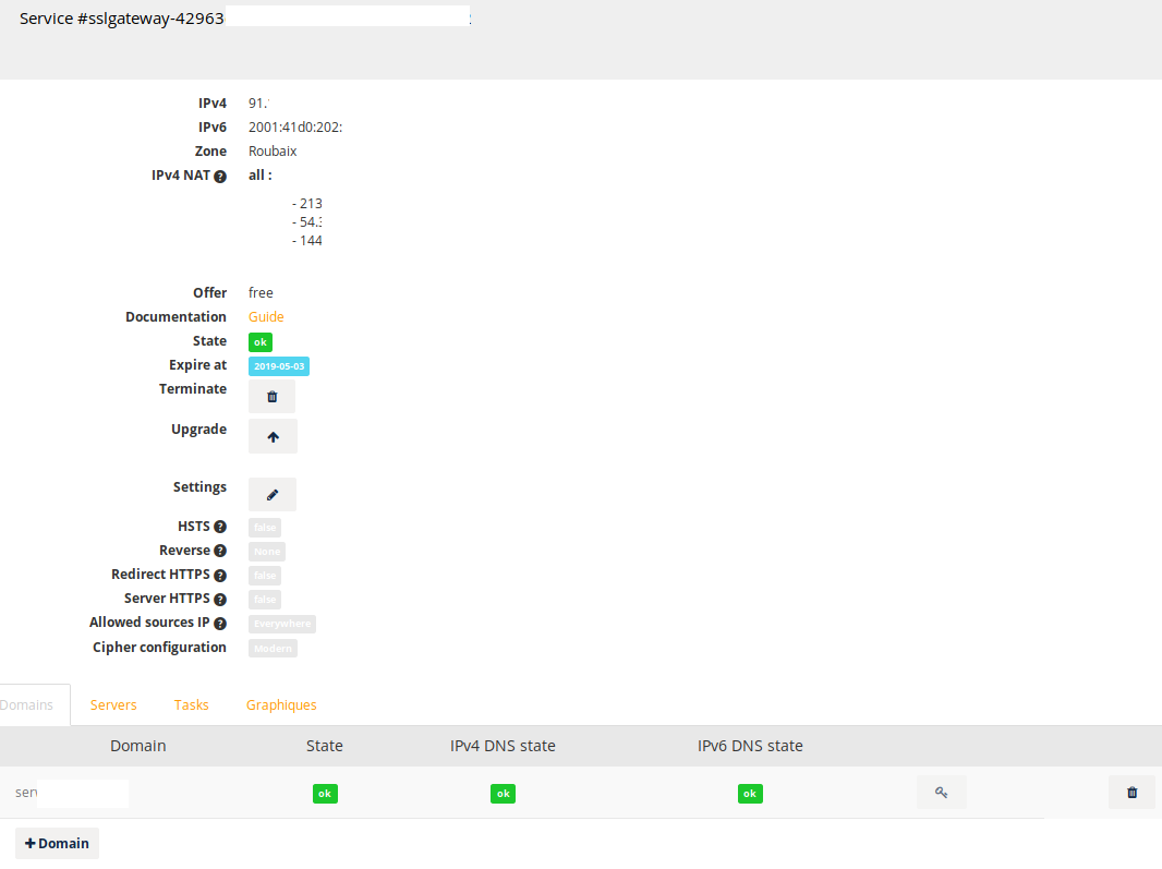

You will then land on the page for managing your solution.
overall config
OptionDescription
IPv4IPv4 address of the OVHcloud gateway you would like to point to
IPv6IPv6 address of the OVHcloud gateway you would like to point to
ZoneGeographic zone of your SSL Gateway IP address
Outgoing IPv4OVHcloud IPv4 addresses that will connect to your server
SolutionSolution subscription type
DocumentationLink to this user guide
StatusYour SSL Gateway service status
Expiry dateExpiry date for your SSL Gateway service
CancelCancellation request button for your SSL Gateway service
Upgrade to Advanced solutionAllows you to upgrade from the Free solution to the Advanced solution
ConfigurationButton that allows you to edit the configuration of your SSL Gateway service
HSTS [1]{.note-ref #id1}Requires the browser to make all future connections to your website in HTTPS
ReverseAllows you to put a host name on your SSL Gateway IP address
HTTPS Redirection [2]{.note-ref #id2}Redirects the visitor to the HTTPS version of your site when they access it in HTTP
HTTPS Server [3]{.note-ref #id3}Enables HTTPS between the SSL Gateway server and your server
Source IP restrictionIf this field is filled in, only the IPs or networks listed can connect to the SSL Gateway
Cipher configuration [4]{.note-ref #id4}Allows you to choose a security level for your SSL/TLS certificate
[1]{.note-ref #id5} - (1) More information on HSTS.
[2]{.note-ref #id6} - (1) Once you have checked that your site is running smoothly with HTTPS protocol, you can redirect all HTTP traffic to HTTPS. We would still recommend that you wait 24 hours after pointing your domain to the SSL Gateway solution before redirecting the traffic, so that visitors to your website definitely have the new functional DNS configuration.
[3]{.note-ref #id7} - (1) Allows the connection to be secured end to end. The SSL Gateway server will connect to your server on the standard HTTPS 443 port. Please note that your server needs to be SSL/TLS certified in order to enable this option. Without this, your website will not function. However, you do not need to renew this certification for your server.
[4]{.note-ref #id8} - (1) The highest level will offer the best protection, but it may not work on older browsers.
For more information on cipher.

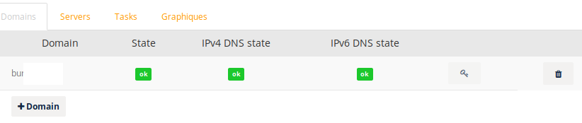

Domains tab

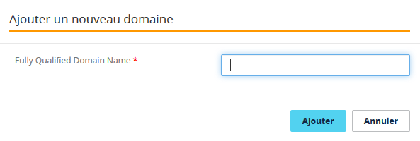

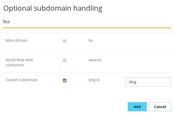

The "Domains" tab allows you to add and delete your domains and subdomains connected to your SSL Gateway.
Click + Domain to add a domain or subdomain.
If you are using a "Free" solution you will only be able to have one domain, as well as its “www” subdomain and a second subdomain of your choice:
NameURL
Domainexample.com
Subdomainwww.example.com
Subdomain of your choiceblog.example.com
  • Free solution: only third level domains (www.example.org) are authorised.
Select your choice, then click Add to validate.
add free domain
If you are using an "Advanced" solution you will be able to add any active domain or subdomain.
  • Advanced solution: fourth level domains (blog.uk.example.org) and higher are authorised.
add advanced domain
Whenever a domain or subdomain is added, you will receive an email prompting you to point it to the SSL Gateway IP within 3 days. This operation is required in order to validate the creation of the SSL/TLS certificate.

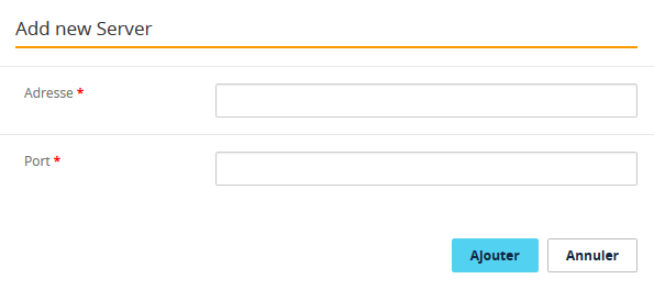

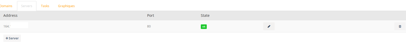

The "Servers" tab allows you to manage the IP address(es) of the server(s) hosting your website.
Click + Server to add an IP address and a port corresponding to your server hosting your website.
servers tab
  • If you are using a "Free" solution: you will only be able to use one IP/PORT address.
  • If you are using an "Advanced" solution: you will be able to add up to 3 IP/PORT addresses for your domains and subdomains.
If you list several IP/PORT addresses, your SSL Gateway will distribute the traffic load with the Round Robin DNS system.
add advanced IP/PORT (internal)
Currently, it is not possible to add IPv6 addresses into your servers. However, this is not an issue, since your domain or subdomain can point to your SSL Gateway in IPv6. Your SSL Gateway will then seamlessly switch the IPv6 traffic over to your server’s IPv4 address.

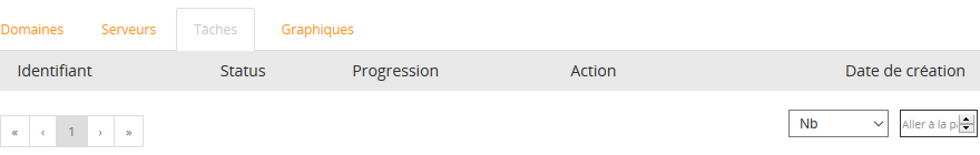

The "Tasks" tab allows you to view the operations in progress on your SSL Gateway.
tasks tab

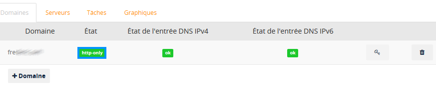

If we have not yet detected your domain pointing to the SSL Gateway IP, then the SSL/TLS certificate will not yet have been created. However, your website will still be accessible in "HTTP". In this case, a small "HTTP" thumbnail image will appear in the "Entering" tab.
http only

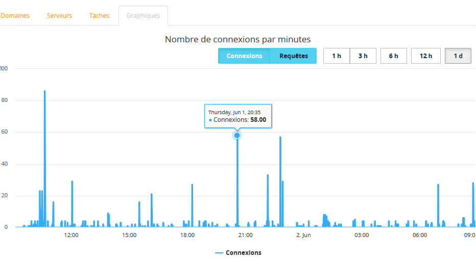

The "Graphs" tab allows you to view the number of connections and requests made per minute to your SSL Gateway.
metrics tab
  • If you are using a "Free" solution: you will be able to view your metrics over a 24 hour period.
  • If you are using an "Advanced" solution: you will be able to view your metrics over a 1 month period.

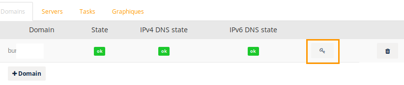

Renewing your SSL certificate
Important note
In order to renew the Let’s Encrypt certificate, the domain or subdomain will need to point to the SSL Gateway solution’s IP.
  • If this is not the case, and our robots detect this 7 days before the SSL/TLS certificate renewal date, an email will be sent, giving you 3 days to carry out this operation.
  • If this operation has not been carried out after 3 days, the certificate will not be renewed. You will need to regenerate it manually using this button:
Regenerate SSL
