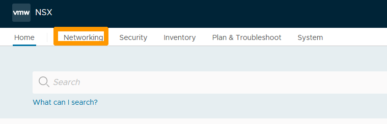

From the NSX interface go to the Networking tab.
01 Create Segment 01

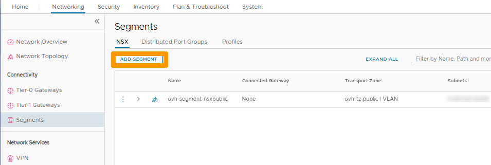

Click on Segments on the left.
01 Create Segment 02
Click on ADD SEGMENT on the right.
01 Create Segment 03

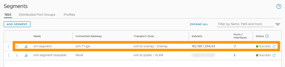

Fill-in this information:
  • Name: Your segment name.
  • Connected Gateway: Predefined gateway ovh-T1-gw | Tier1.
  • Transport Zone: ovh-tz-overlay predefined zone.
  • Subnet: The gateway address of the segment in this format 192.168.1.254/24.

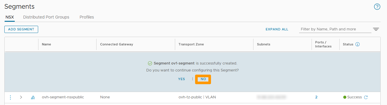

Then click on SAVE on the right.
01 Create Segment 04
Click NO when prompted.
01 Create Segment 05

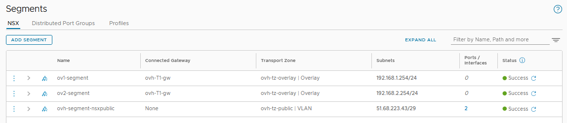

The new segment appears in the list.
01 Create Segment 06

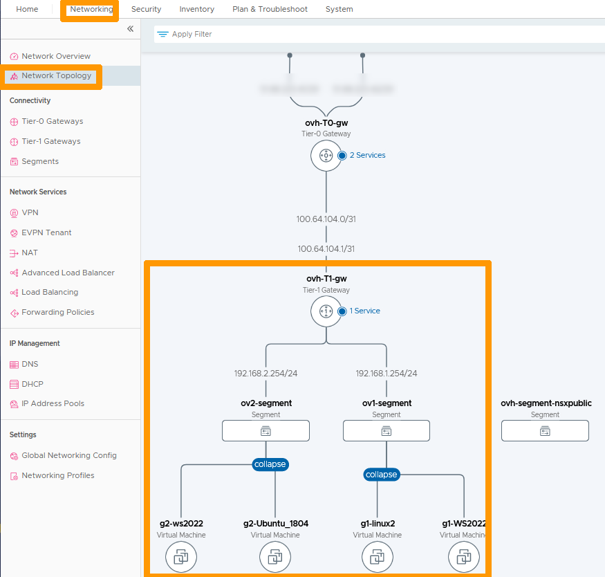

In the Networking tab, click on Network Topology on the left to see the new segment and its location in the network.
02 Display Network Topology 01

Use the first part of the guide to create a second segment named ov2-segment with these parameters 192.168.2.254/24 in order to have two segments connected to ovh-T1-gw.

Displaying a network topology with overlay segments and other segments on VLANs
Go back to the NSX interface, go to the Networking tab and click on Network Topology on the left to view a graphical view of the network. You will see networks of type Overlay and those of type VLAN connected through an interface on ovh-t1-gw.
09 display network topology vlan overlay01
